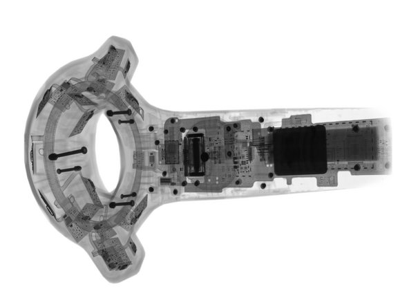

    • We kick things off with an epic X-ray overview of the entire headset, courtesy of the magicians at Creative Electron. This is our roadmap for the teardown ahead.

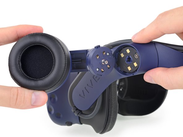

  3. HTC Vive Pro Teardown: crwdns2935265:03crwdnd2935265:01crwdnd2935265:03crwdne2935265:0 HTC Vive Pro Teardown: crwdns2935265:03crwdnd2935265:02crwdnd2935265:03crwdne2935265:0 HTC Vive Pro Teardown: crwdns2935265:03crwdnd2935265:03crwdnd2935265:03crwdne2935265:0
    • We haven't even started disassembly, and already we're seeing some repair-friendly features!
    • Spring contacts and standard Phillips screws connect the modular headphones to the headset, making for easy removal and replacement.
    • And the best part is that HTC even tells you how to remove them!
    • We peel off a couple foam pads and unsnap a plastic compartment cover to find the end of the Vive Pro's fancy custom cable.
    • Though a completely wire-free experience is not yet available, HTC managed to fit all the power and data lines for the Vive into a single cable that routes neatly up and over your left ear—a big improvement from the heavy multi-cable ponytail that dangled from the original.

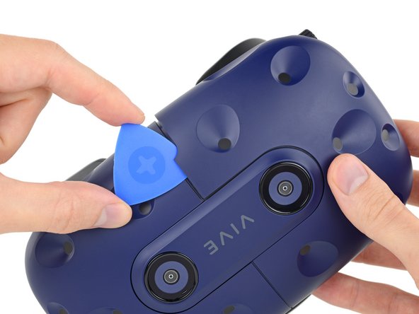

  5. HTC Vive Pro Teardown: crwdns2935265:05crwdnd2935265:01crwdnd2935265:03crwdne2935265:0 HTC Vive Pro Teardown: crwdns2935265:05crwdnd2935265:02crwdnd2935265:03crwdne2935265:0 HTC Vive Pro Teardown: crwdns2935265:05crwdnd2935265:03crwdnd2935265:03crwdne2935265:0
    • Wading through the sea of divots in the front cover, we find a couple (or four) that actually hide Torx screws!
    • While we're not huge fans of hidden or tamper-evident screws, they're a much better option than glue or proprietary heads.
    • After a bit of fancy work with an opening pick to pop the hidden clips free, the outer shell splits down the middle and slides off.
    • The Vive Pro's unsettling new gaze makes us feel a little bad about peeling its face off—sorry, Johnny Vive Five.

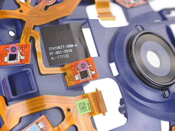

    • Inside the covers, we spot familiar IR-friendly windows. All these purply dots are a bit like sunglasses for the IR sensors underneath—helping to filter out visible light so the sensors can more easily spot the IR beams from the Lighthouse base stations.
    • Much like on the original Vive, there's a spiderweb of photodiodes lying just under the sleek surface of the Pro—32 of them in total.
    • Unlike the Oculus Rift, this headset is looking for IR light—not emitting it.
    • Some day, someone wearing a Vive will bump into someone wearing a Rift, creating an inescapable vortex of recursive IR signals.
    • A couple more screws and we have faceplate liftoff—IR sensor array separation complete.

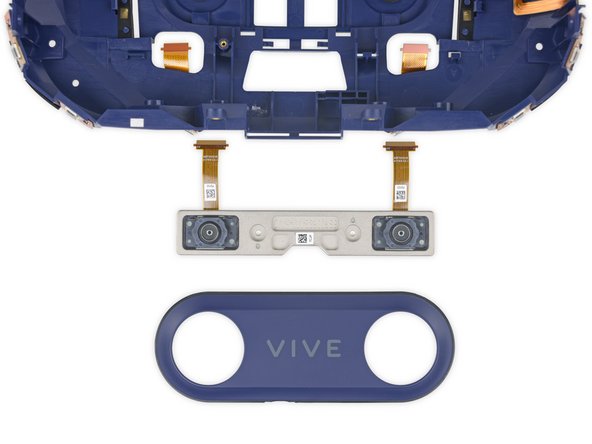

  7. HTC Vive Pro Teardown: crwdns2935265:07crwdnd2935265:01crwdnd2935265:03crwdne2935265:0 HTC Vive Pro Teardown: crwdns2935265:07crwdnd2935265:02crwdnd2935265:03crwdne2935265:0 HTC Vive Pro Teardown: crwdns2935265:07crwdnd2935265:03crwdnd2935265:03crwdne2935265:0
    • First component on the menu: the dual microphone assembly near the bottom of the face plate.
    • It takes some heat and careful spudgering to remove these cleanly. Fortunately, there's no need for this unless you're replacing broken mics, so the risk of collateral damage is low.
    • Where the original Vive got by with a single mic, the Pro's twin mics offer improved noise cancellation during online play.

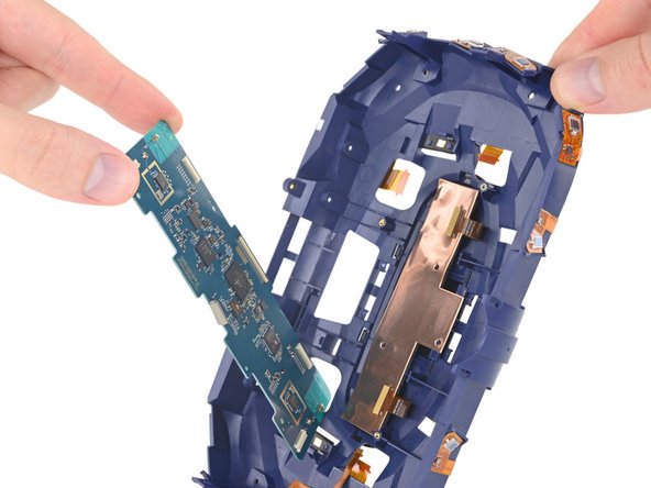

    • Next we snag the faceplate-mounted mainboard, which wrangles signals from the IR sensor arrays, cameras, and microphones.
    • Beneath the board, we find a hefty slab of copper foil, likely used for EMI shielding as well as keeping things cool. (Passive cooling would be the way to go, to keep this device lightweight and quiet enough to wear on your face!)
    • And under that we find the cameras! Two separate units with no identifiable markings. HTC says the additional camera makes for an improved Chaperone feature, as well as some basic hand tracking.

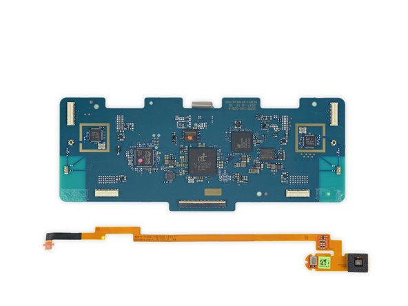

    • Scan complete—chips identified:
    • Two Nordic Semiconductor NRF24LU1P Ultra Low Power 2.4 GHz RF SoC
    • Atmel SAM G55J 32-bit microcontroller
    • Two Winbond 25Q32JV1Q 4 MB flash memory
    • Alpha Imaging Technology AIT8589D—likely an updated version of the Image Signal Processor we saw in the first Vive
    • Lattice Semiconductor iCE40HX8K Ultra Low Power FPGA
    • TDK (formerly Invensense) MPU-6500 3-axis accelerometer/gyroscope
    • In the third image: A Triad Semiconductor TS4231 Light-to-Digital Converter IC nestles close to each IR sensor, ready to convert IR light pulses into digital signals.

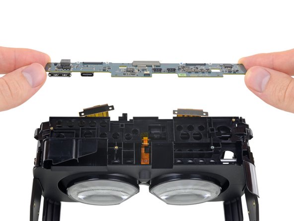

  9. HTC Vive Pro Teardown: crwdns2935265:09crwdnd2935265:01crwdnd2935265:03crwdne2935265:0 HTC Vive Pro Teardown: crwdns2935265:09crwdnd2935265:02crwdnd2935265:03crwdne2935265:0 HTC Vive Pro Teardown: crwdns2935265:09crwdnd2935265:03crwdnd2935265:03crwdne2935265:0
    • After that brief board break, we continue our journey into the headset.
    • Now tethered by just two headphone interconnect cables, the headset is easily lifted away and set aside.

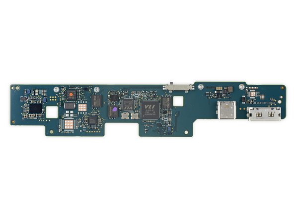

    • Where the original Vive kept nearly all its onboard silicon clustered onto a single board, the sequel uses two smaller boards. This daughterboard services the displays, I/O, and one or two other things we'll show you in just a moment.
    • While we are excited about the chips, we're a little bummed that the ports are still soldered to a board. Non-modular, high-stress components like ports can be a pricey repair.
    • This board also hosts the little linear potentiometer that formerly lived on its own FPC. That small slider tracks where you position the displays when making IPD adjustments.

    • We been hearing this headset is overpriced, but maybe we'll strike gold amongst all this silicon?
    • Analogix ANX7530 Slimport (4K Ultra-HD) Receiver
    • Cirrus Logic CS43130 High Performance DAC
    • Cmedia CM6530N USB 2.0 Full Speed Audio Chip
    • Texas Instruments TPS54541 Step-Down DC Converter
    • ON Semiconductor FSA2275UMX audio analog switches
    • ON Semiconductor FSA4476UCX and FUSB340TMX USB analog switches
    • Texas Instruments TXB0104 4-bit voltage-level shifter

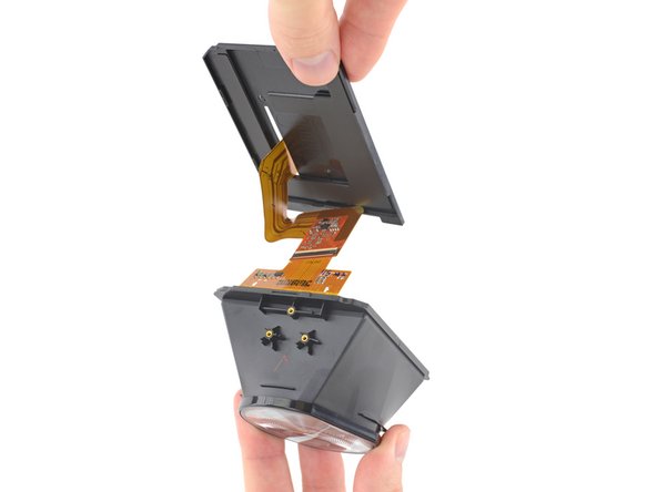

    • Trying to get a look at those fancy displays, we hinge the whole optics assembly out of the midframe.
    • These lenses have the same concentric rings as the standard Vive, and are likely the same Fresnel design.

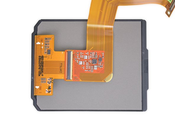

    • We get our greedy hands on one of the lens/display assemblies and carefully thread the display cable out.
    • The display is a Samsung AMS350MU04 AMOLED panel, reportedly the very same that Samsung uses in their own Odyssey mixed reality headset.
    • The display flex cable features a Texas Instruments TPS65633B AMOLED display power supply and a Winbond W25Q40EWUXJE 4 Mb serial NOR flash memory.
