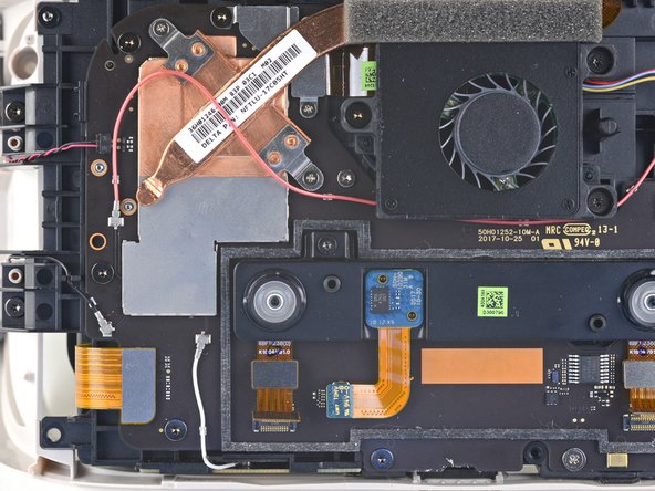

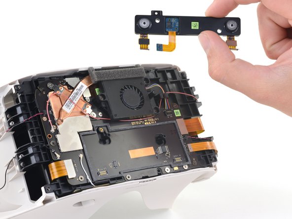

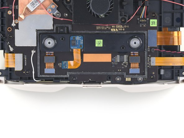

    1. HTC Vive Focus Proximity Sensor Array Replacement, Remove the proximity sensor array: crwdns2935265:019crwdnd2935265:01crwdnd2935265:02crwdne2935265:0 HTC Vive Focus Proximity Sensor Array Replacement, Remove the proximity sensor array: crwdns2935265:019crwdnd2935265:02crwdnd2935265:02crwdne2935265:0
      • Use the flat end of a spudger to disconnect the three ribbon cables connecting the proximity sensor array to the motherboard.
    2. HTC Vive Focus Proximity Sensor Array Replacement: crwdns2935265:020crwdnd2935265:01crwdnd2935265:02crwdne2935265:0 HTC Vive Focus Proximity Sensor Array Replacement: crwdns2935265:020crwdnd2935265:02crwdnd2935265:02crwdne2935265:0
      • Use a T5 Torx screwdriver to remove the 4.5 mm screw from the proximity sensor array.
    3. HTC Vive Focus Proximity Sensor Array Replacement: crwdns2935265:021crwdnd2935265:01crwdnd2935265:02crwdne2935265:0 HTC Vive Focus Proximity Sensor Array Replacement: crwdns2935265:021crwdnd2935265:02crwdnd2935265:02crwdne2935265:0
      • Remove the proximity sensor array from the motherboard.
