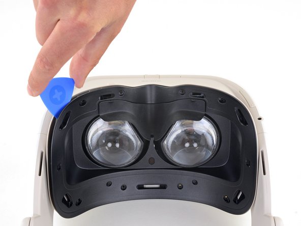

  1. HTC Vive Focus Lens Replacement, Remove the facerest cushion: crwdns2935265:01crwdnd2935265:01crwdnd2935265:03crwdne2935265:0 HTC Vive Focus Lens Replacement, Remove the facerest cushion: crwdns2935265:01crwdnd2935265:02crwdnd2935265:03crwdne2935265:0 HTC Vive Focus Lens Replacement, Remove the facerest cushion: crwdns2935265:01crwdnd2935265:03crwdnd2935265:03crwdne2935265:0

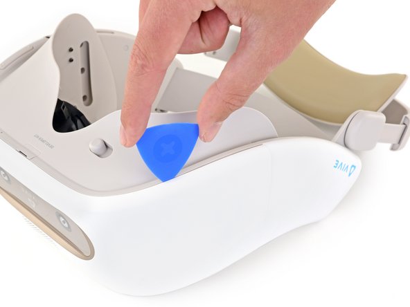

    • Place your device upside-down on your work surface.
    • The facerest cushion is lightly held into place by seven plastic clips.
    • Use your fingers to gently pull the facerest cushion straight off of the facerest to remove it.

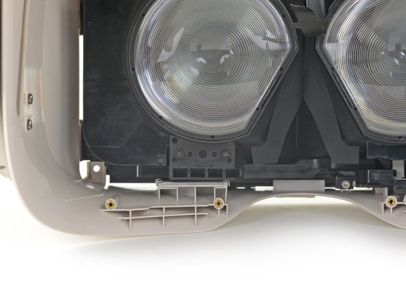

  2. HTC Vive Focus Lens Replacement, Remove the facerest: crwdns2935265:02crwdnd2935265:01crwdnd2935265:01crwdne2935265:0
    • Use a T5 Torx screwdriver to remove the eight 4.5 mm screws securing the facerest.
    • One of the screws will be covered by a tamper-evident sticker. Press the driver through the sticker to remove the screw.

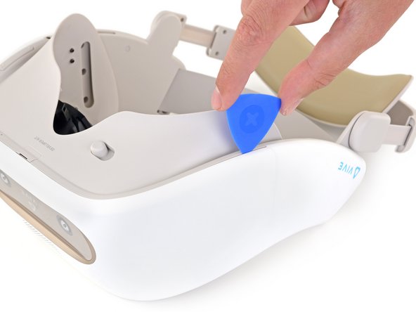

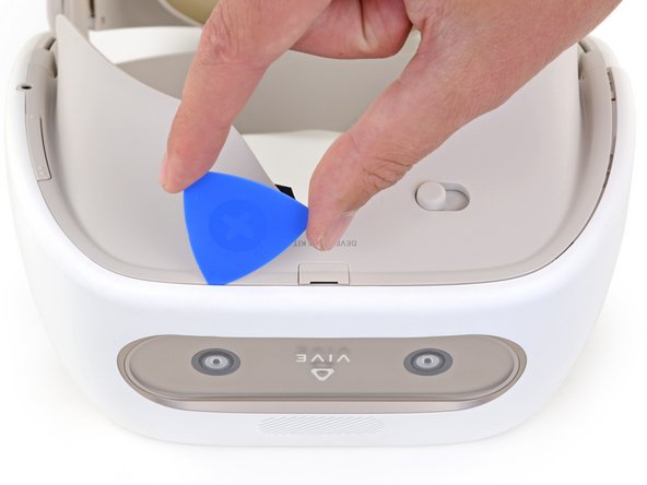

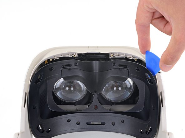

  3. HTC Vive Focus Lens Replacement: crwdns2935265:03crwdnd2935265:01crwdnd2935265:03crwdne2935265:0 HTC Vive Focus Lens Replacement: crwdns2935265:03crwdnd2935265:02crwdnd2935265:03crwdne2935265:0 HTC Vive Focus Lens Replacement: crwdns2935265:03crwdnd2935265:03crwdnd2935265:03crwdne2935265:0

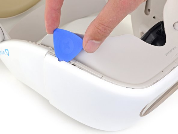

    • Insert an opening pick into the upper-left corner of the facerest.
    • Twist the opening pick to release the plastic clip securing the facerest.
    • Repeat for the upper-right corner.
    • Don't remove the facerest yet. It's still attached by the facerest sensor ribbon cable.

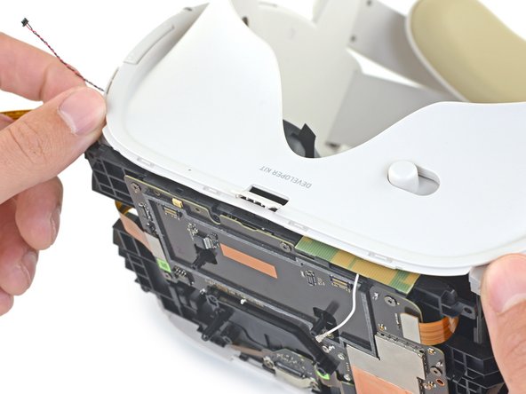

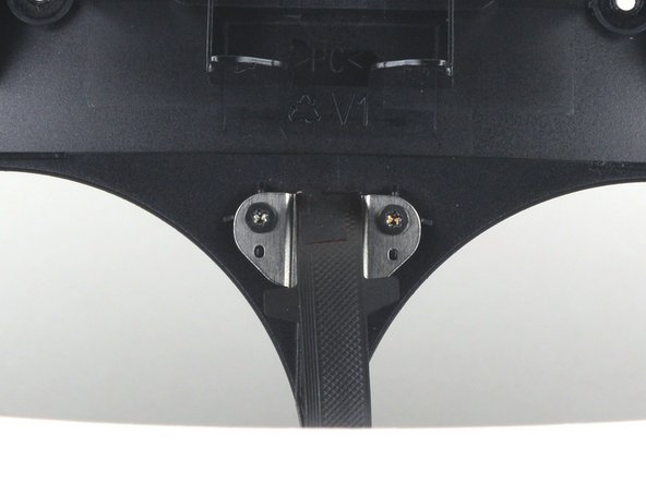

  4. HTC Vive Focus Lens Replacement, Remove the facerest sensor: crwdns2935265:04crwdnd2935265:01crwdnd2935265:03crwdne2935265:0 HTC Vive Focus Lens Replacement, Remove the facerest sensor: crwdns2935265:04crwdnd2935265:02crwdnd2935265:03crwdne2935265:0 HTC Vive Focus Lens Replacement, Remove the facerest sensor: crwdns2935265:04crwdnd2935265:03crwdnd2935265:03crwdne2935265:0
    • Carefully flip your device over.
    • Pull the facerest out just enough to access the screws securing the facerest sensor.
    • Don't put any strain on the facerest sensor ribbon cable.
    • During reassembly, make sure the facerest sensor ribbon cable is positioned between the lenses before reinstalling the facerest.
  5. HTC Vive Focus Lens Replacement: crwdns2935265:05crwdnd2935265:01crwdnd2935265:01crwdne2935265:0
    • Use a T5 Torx screwdriver to remove the two 2.4 mm screws securing the facerest sensor to the facerest.

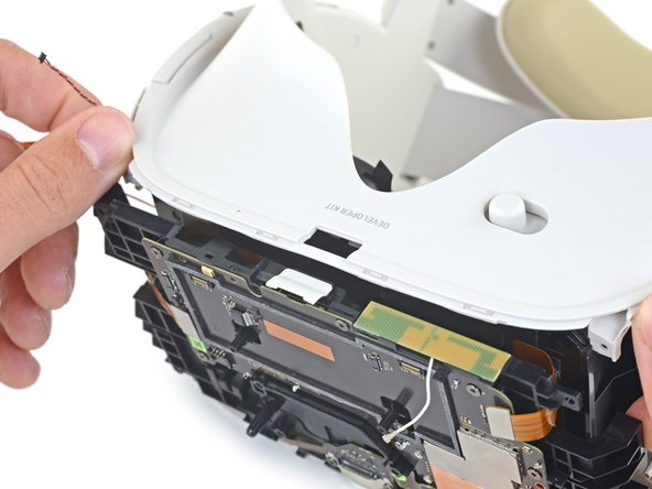

  6. HTC Vive Focus Lens Replacement: crwdns2935265:06crwdnd2935265:01crwdnd2935265:01crwdne2935265:0
    • Remove the facerest.

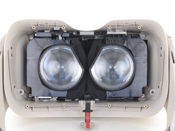

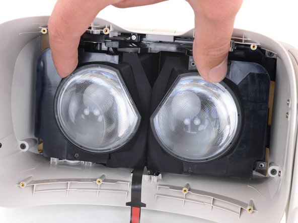

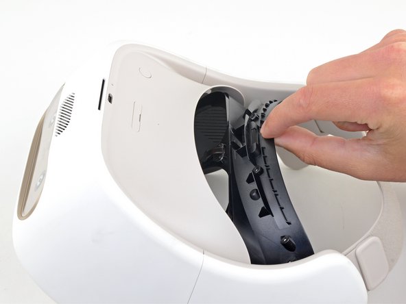

  7. HTC Vive Focus Lens Replacement, Unscrew the front cover: crwdns2935265:07crwdnd2935265:01crwdnd2935265:02crwdne2935265:0 HTC Vive Focus Lens Replacement, Unscrew the front cover: crwdns2935265:07crwdnd2935265:02crwdnd2935265:02crwdne2935265:0
    • Use your fingers to slide the lenses towards each other so that they are positioned towards the center of the device.
  8. HTC Vive Focus Lens Replacement: crwdns2935265:08crwdnd2935265:01crwdnd2935265:02crwdne2935265:0 HTC Vive Focus Lens Replacement: crwdns2935265:08crwdnd2935265:02crwdnd2935265:02crwdne2935265:0
    • Use a T5 Torx screwdriver to remove the four screws securing the front cover from inside the device:
    • Two 5.7 mm screws with fine threads
    • Two 5.5 mm screws with coarse threads
    • The coarse-thread screws can strip easily. During reassembly, tighten the coarse-thread screws until they're hand tight and then no more.

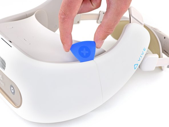

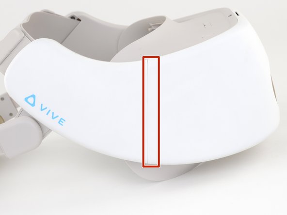

  9. HTC Vive Focus Lens Replacement, Remove the front cover: crwdns2935265:09crwdnd2935265:01crwdnd2935265:02crwdne2935265:0 HTC Vive Focus Lens Replacement, Remove the front cover: crwdns2935265:09crwdnd2935265:02crwdnd2935265:02crwdne2935265:0
    • Note the location of the plastic welds on both vertical edges of the front cover.
    • After reassembly, the gap between the front cover and the side panels may no longer be flush. This is a cosmetic defect only and will not affect operation. The front cover's clips and screws are sufficient to secure it to the rest of the device.

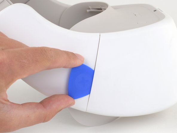

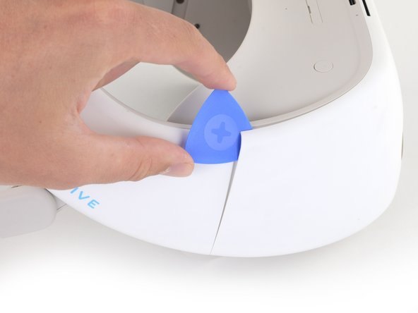

  10. HTC Vive Focus Lens Replacement: crwdns2935265:010crwdnd2935265:01crwdnd2935265:03crwdne2935265:0 HTC Vive Focus Lens Replacement: crwdns2935265:010crwdnd2935265:02crwdnd2935265:03crwdne2935265:0 HTC Vive Focus Lens Replacement: crwdns2935265:010crwdnd2935265:03crwdnd2935265:03crwdne2935265:0
    • Insert an opening pick into the top of the front cover near the upper left corner.
    • Slide the opening pick around the upper left corner of the front cover.
  11. HTC Vive Focus Lens Replacement: crwdns2935265:011crwdnd2935265:01crwdnd2935265:02crwdne2935265:0 HTC Vive Focus Lens Replacement: crwdns2935265:011crwdnd2935265:02crwdnd2935265:02crwdne2935265:0
    • Use the opening pick to separate the weld securing the left side vertical edge of the front cover.
    • The weld may require significant force to separate.

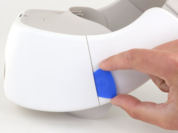

  12. HTC Vive Focus Lens Replacement: crwdns2935265:012crwdnd2935265:01crwdnd2935265:03crwdne2935265:0 HTC Vive Focus Lens Replacement: crwdns2935265:012crwdnd2935265:02crwdnd2935265:03crwdne2935265:0 HTC Vive Focus Lens Replacement: crwdns2935265:012crwdnd2935265:03crwdnd2935265:03crwdne2935265:0
    • Insert an opening pick into the top of the front cover near the upper right corner.
    • Slide the opening pick around the upper right corner of the front cover.
  13. HTC Vive Focus Lens Replacement: crwdns2935265:013crwdnd2935265:01crwdnd2935265:02crwdne2935265:0 HTC Vive Focus Lens Replacement: crwdns2935265:013crwdnd2935265:02crwdnd2935265:02crwdne2935265:0
    • Use the opening pick to separate the weld securing the right side vertical edge of the front cover.

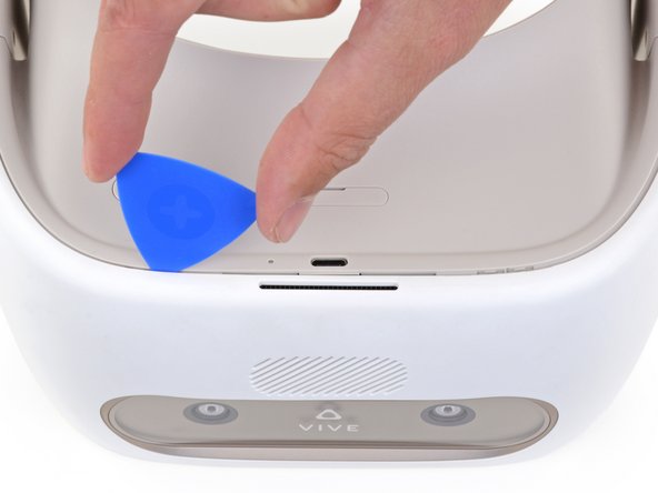

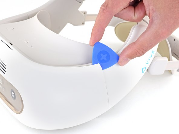

  14. HTC Vive Focus Lens Replacement: crwdns2935265:014crwdnd2935265:01crwdnd2935265:03crwdne2935265:0 HTC Vive Focus Lens Replacement: crwdns2935265:014crwdnd2935265:02crwdnd2935265:03crwdne2935265:0 HTC Vive Focus Lens Replacement: crwdns2935265:014crwdnd2935265:03crwdnd2935265:03crwdne2935265:0

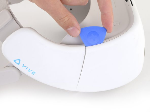

    • Flip the device upside-down.
    • Use an opening pick to disconnect the plastic clips securing the bottom right edge of the front cover to the device.
  15. HTC Vive Focus Lens Replacement: crwdns2935265:015crwdnd2935265:01crwdnd2935265:02crwdne2935265:0 HTC Vive Focus Lens Replacement: crwdns2935265:015crwdnd2935265:02crwdnd2935265:02crwdne2935265:0
    • Slide the opening pick along the bottom edge of the front cover to separate it from the device.
  16. HTC Vive Focus Lens Replacement: crwdns2935265:016crwdnd2935265:01crwdnd2935265:02crwdne2935265:0 HTC Vive Focus Lens Replacement: crwdns2935265:016crwdnd2935265:02crwdnd2935265:02crwdne2935265:0
    • Use the opening pick to disconnect the plastic clips securing the bottom-left edge of the front cover to the device.
  17. HTC Vive Focus Lens Replacement: crwdns2935265:017crwdnd2935265:01crwdnd2935265:02crwdne2935265:0 HTC Vive Focus Lens Replacement: crwdns2935265:017crwdnd2935265:02crwdnd2935265:02crwdne2935265:0
    • Flip the device right-side up.
    • Use the opening pick to separate the last few plastic clips securing the top of the front cover.

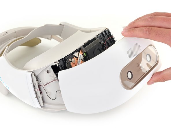

  18. HTC Vive Focus Lens Replacement: crwdns2935265:018crwdnd2935265:01crwdnd2935265:02crwdne2935265:0 HTC Vive Focus Lens Replacement: crwdns2935265:018crwdnd2935265:02crwdnd2935265:02crwdne2935265:0
    • Remove the front cover.

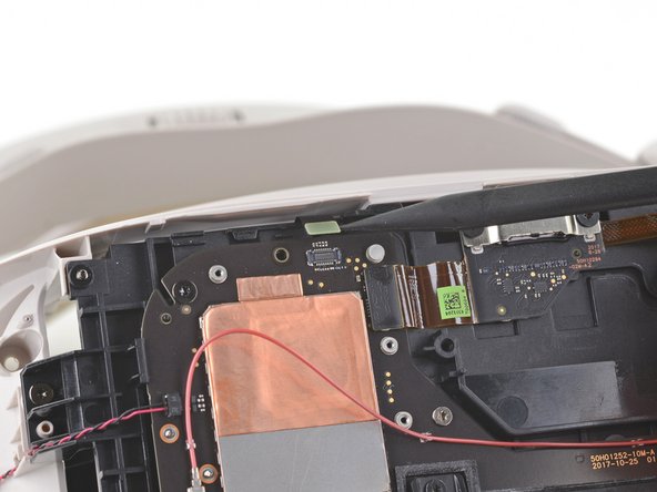

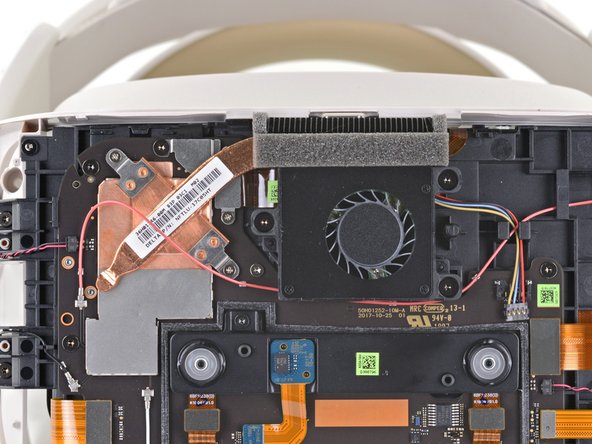

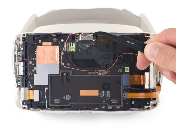

  19. HTC Vive Focus Lens Replacement, Remove the CPU fan: crwdns2935265:019crwdnd2935265:01crwdnd2935265:03crwdne2935265:0 HTC Vive Focus Lens Replacement, Remove the CPU fan: crwdns2935265:019crwdnd2935265:02crwdnd2935265:03crwdne2935265:0 HTC Vive Focus Lens Replacement, Remove the CPU fan: crwdns2935265:019crwdnd2935265:03crwdnd2935265:03crwdne2935265:0
    $3.99
    • Use a pair of angled tweezers to disconnect the CPU fan cable from the motherboard.
    • Lift the CPU fan connector straight up from the motherboard to disconnect it from its socket.
    • During reassembly, align the CPU fan connector with its socket and use your finger to press it straight down into the motherboard.
  20. HTC Vive Focus Lens Replacement: crwdns2935265:020crwdnd2935265:01crwdnd2935265:02crwdne2935265:0 HTC Vive Focus Lens Replacement: crwdns2935265:020crwdnd2935265:02crwdnd2935265:02crwdne2935265:0
    • Use a T5 Torx screwdriver to remove the three 5.5 mm screws securing the CPU fan.
    • Use a Phillips screwdriver to remove the two 2.3 mm screws securing the CPU heatsink.
  21. HTC Vive Focus Lens Replacement: crwdns2935265:021crwdnd2935265:01crwdnd2935265:02crwdne2935265:0 HTC Vive Focus Lens Replacement: crwdns2935265:021crwdnd2935265:02crwdnd2935265:02crwdne2935265:0
    • Remove the CPU fan.
    • During reassembly, do not sandwich the red antenna cable between the heatsink and contact plates.

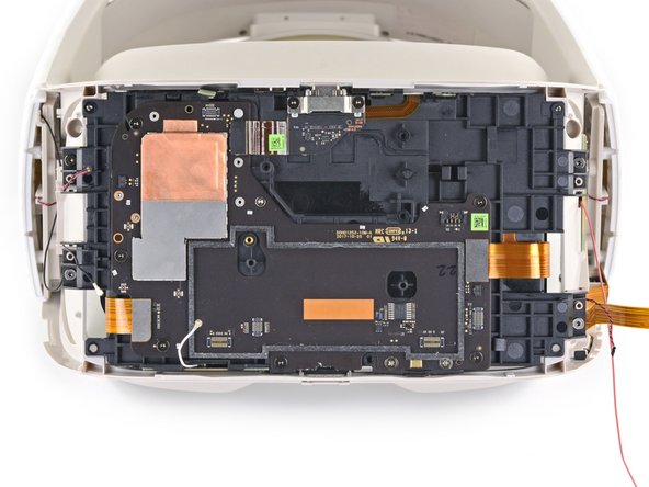

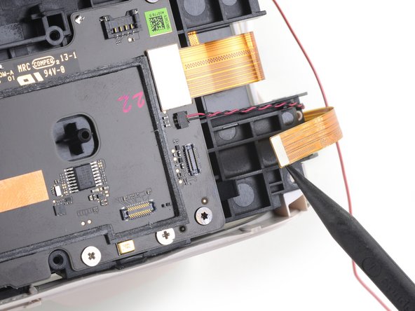

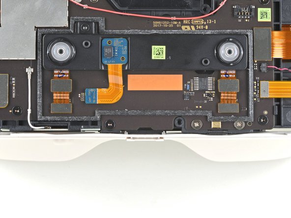

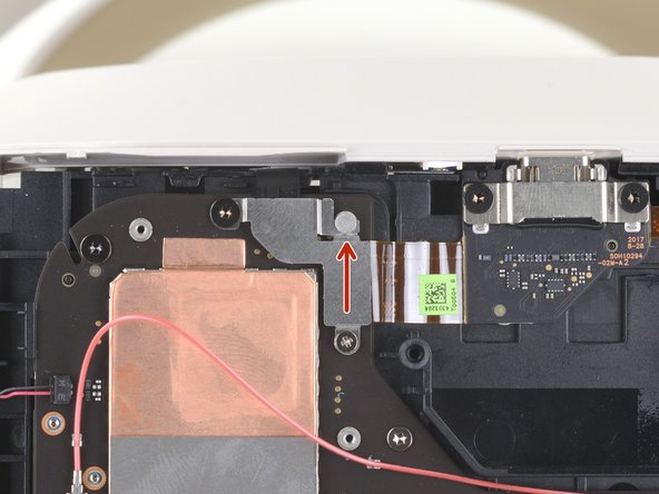

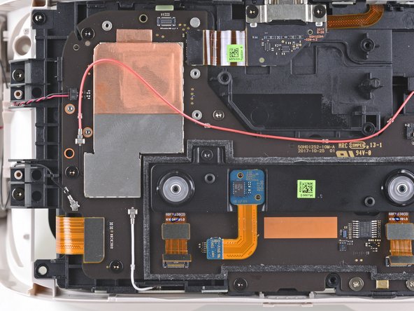

  25. HTC Vive Focus Lens Replacement, Remove the proximity sensor array: crwdns2935265:025crwdnd2935265:01crwdnd2935265:02crwdne2935265:0 HTC Vive Focus Lens Replacement, Remove the proximity sensor array: crwdns2935265:025crwdnd2935265:02crwdnd2935265:02crwdne2935265:0
    • Pry up with the flat end of a spudger to disconnect the three ribbon cables connecting the proximity sensor array to the motherboard.
  26. HTC Vive Focus Lens Replacement: crwdns2935265:026crwdnd2935265:01crwdnd2935265:02crwdne2935265:0 HTC Vive Focus Lens Replacement: crwdns2935265:026crwdnd2935265:02crwdnd2935265:02crwdne2935265:0
    • Use a T5 Torx screwdriver to remove the 4.5 mm screw from the proximity sensor array.
  27. HTC Vive Focus Lens Replacement: crwdns2935265:027crwdnd2935265:01crwdnd2935265:01crwdne2935265:0
    • Remove the proximity sensor array from the motherboard.

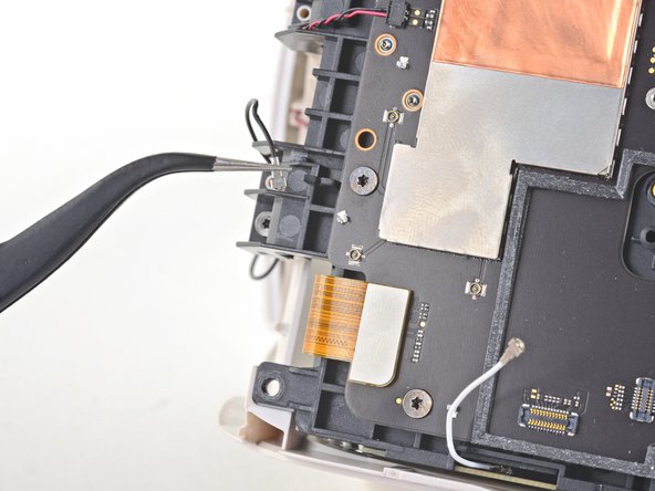

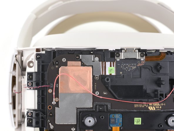

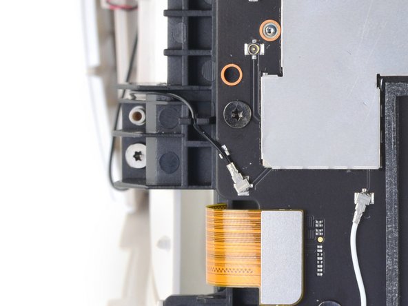

  28. HTC Vive Focus Lens Replacement, Remove the internal assembly: crwdns2935265:028crwdnd2935265:01crwdnd2935265:03crwdne2935265:0 HTC Vive Focus Lens Replacement, Remove the internal assembly: crwdns2935265:028crwdnd2935265:02crwdnd2935265:03crwdne2935265:0 HTC Vive Focus Lens Replacement, Remove the internal assembly: crwdns2935265:028crwdnd2935265:03crwdnd2935265:03crwdne2935265:0
    • Antenna connectors are fragile and can break off of the motherboard. Use this technique when disconnecting antenna cables.
    • Use a spudger or a pair of tweezers to disconnect the red antenna cable from the front of the device.
    • De-route the antenna cable from the front of the device and place it to the side.
    • During reassembly, be sure to re-route the cable through the brackets and clips securing it.
  29. HTC Vive Focus Lens Replacement: crwdns2935265:029crwdnd2935265:01crwdnd2935265:03crwdne2935265:0 HTC Vive Focus Lens Replacement: crwdns2935265:029crwdnd2935265:02crwdnd2935265:03crwdne2935265:0 HTC Vive Focus Lens Replacement: crwdns2935265:029crwdnd2935265:03crwdnd2935265:03crwdne2935265:0
    • Use a spudger or a pair of tweezers to remove the black antenna cable from the motherboard.
    • During reassembly, re-route the black antenna cable through its channel and clip.
  30. HTC Vive Focus Lens Replacement: crwdns2935265:030crwdnd2935265:01crwdnd2935265:02crwdne2935265:0 HTC Vive Focus Lens Replacement: crwdns2935265:030crwdnd2935265:02crwdnd2935265:02crwdne2935265:0

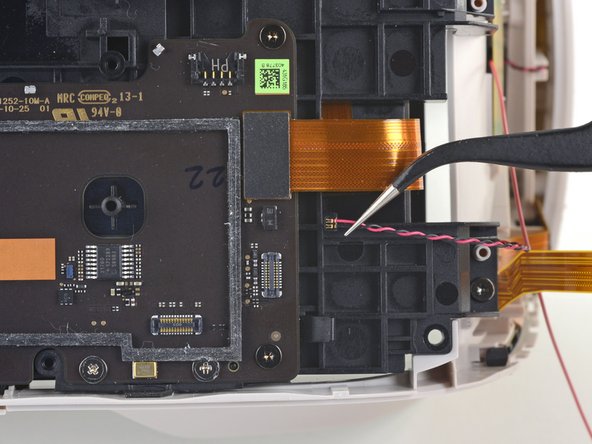

    • Use a spudger to disconnect the ribbon cable connecting the volume buttons and headset jack to the motherboard.
  31. HTC Vive Focus Lens Replacement: crwdns2935265:031crwdnd2935265:01crwdnd2935265:02crwdne2935265:0 HTC Vive Focus Lens Replacement: crwdns2935265:031crwdnd2935265:02crwdnd2935265:02crwdne2935265:0

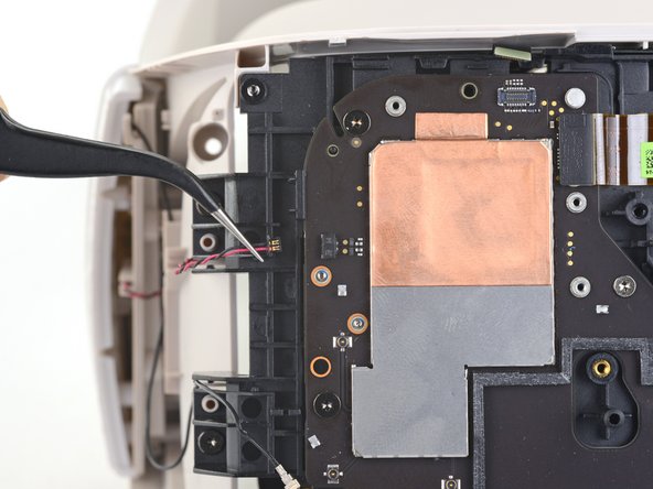

    • Use a pair of tweezers to carefully disconnect the speaker wire from the right side of the motherboard.
    • During reassembly, reinstall the speaker wire with the gold contacts facing towards you and the red wire on top.
  32. HTC Vive Focus Lens Replacement: crwdns2935265:032crwdnd2935265:01crwdnd2935265:02crwdne2935265:0 HTC Vive Focus Lens Replacement: crwdns2935265:032crwdnd2935265:02crwdnd2935265:02crwdne2935265:0
    • Use a pair of tweezers to carefully disconnect the speaker wire from the left side of the motherboard.
    • During reassembly, reinstall the speaker wire with the gold contacts facing towards you and the black wire on top.

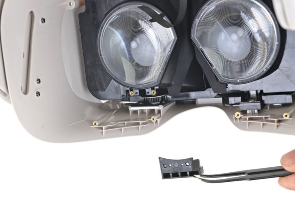

  36. HTC Vive Focus Lens Replacement: crwdns2935265:036crwdnd2935265:01crwdnd2935265:02crwdne2935265:0 HTC Vive Focus Lens Replacement: crwdns2935265:036crwdnd2935265:02crwdnd2935265:02crwdne2935265:0
    • Remove the bracket under the left lens.
    • To ensure correct operation, make sure this piece is properly seated on the adjuster mechanism by sliding the lenses as close together as possible before reinstalling it.

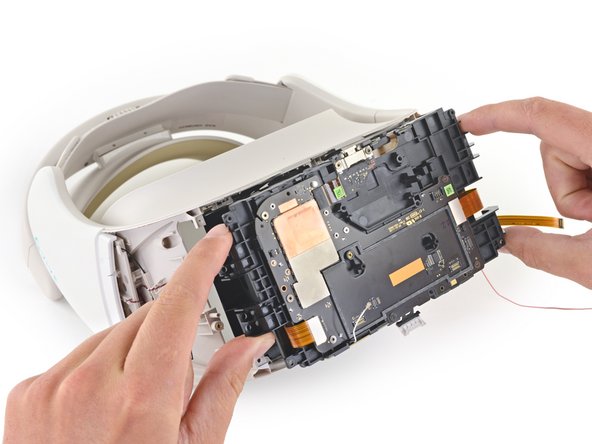

  37. HTC Vive Focus Lens Replacement: crwdns2935265:037crwdnd2935265:01crwdnd2935265:03crwdne2935265:0 HTC Vive Focus Lens Replacement: crwdns2935265:037crwdnd2935265:02crwdnd2935265:03crwdne2935265:0 HTC Vive Focus Lens Replacement: crwdns2935265:037crwdnd2935265:03crwdnd2935265:03crwdne2935265:0
    • Before removing the internal assembly, tilt the front out slightly to feed the microSD card slot cover through the frame.

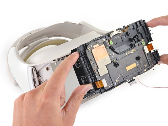

  38. HTC Vive Focus Lens Replacement: crwdns2935265:038crwdnd2935265:01crwdnd2935265:03crwdne2935265:0 HTC Vive Focus Lens Replacement: crwdns2935265:038crwdnd2935265:02crwdnd2935265:03crwdne2935265:0 HTC Vive Focus Lens Replacement: crwdns2935265:038crwdnd2935265:03crwdnd2935265:03crwdne2935265:0
    • Carefully remove the internal assembly through the front of the device.
    • The internal assembly may not come out easily. Gently bend the outer frame as necessary to create space for the edges to clear.
    • Do not force any part of the internal assembly out.
    • During reassembly, feed the microSD slot cover referenced in the previous step back through the frame as you slide the internal assembly back into place.
  39. HTC Vive Focus Lens Replacement, Reassembly tips: crwdns2935265:039crwdnd2935265:01crwdnd2935265:02crwdne2935265:0 HTC Vive Focus Lens Replacement, Reassembly tips: crwdns2935265:039crwdnd2935265:02crwdnd2935265:02crwdne2935265:0
    • During reassembly:
    • Make sure not to trap any of the five loose wires and cables when reinstalling the internal assembly.
    • Hold the lenses as close together as possible and align the rack and pinion with the gear and washer.
    • This will ensure the lenses are properly aligned.

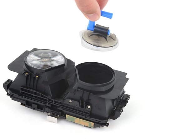

  40. HTC Vive Focus Lens Replacement, Remove the lens: crwdns2935265:040crwdnd2935265:01crwdnd2935265:01crwdne2935265:0
  41. HTC Vive Focus Lens Replacement: crwdns2935265:041crwdnd2935265:01crwdnd2935265:02crwdne2935265:0 HTC Vive Focus Lens Replacement: crwdns2935265:041crwdnd2935265:02crwdnd2935265:02crwdne2935265:0
    • Once a lens is removed, install the new one promptly to avoid contamination from any dust or debris in the air.
    • Apply a suction cup to the center of the lens.
    • Pull up on the suction cup to remove the lens from the frame.
    • If the lens does not remove easily, apply a heated iOpener for one minute and try again.
    • The original adhesive can be reused if it was not damaged during disassembly. Place the new lens into the frame and apply a heated iOpener for one minute to bond the new lens to the old adhesive.
    • If the old adhesive was damaged during disassembly, use a spudger to scrape off any remaining adhesive then apply generic adhesive where the old adhesive used to be before installing the new lens.
