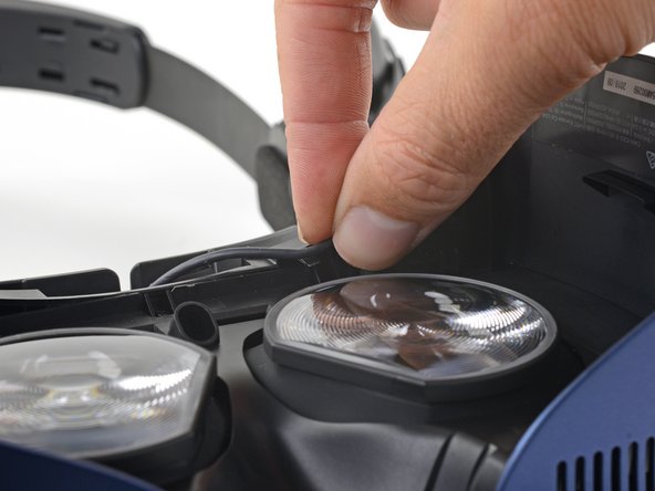

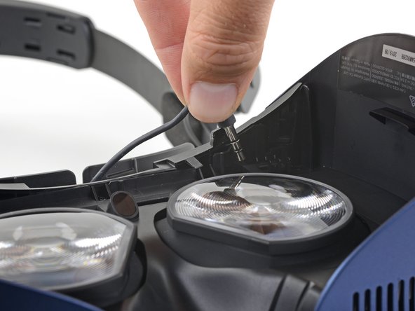

  6. HTC Vive Cosmos Motherboard Replacement, Unplug the audio connector: crwdns2935265:06crwdnd2935265:01crwdnd2935265:03crwdne2935265:0 HTC Vive Cosmos Motherboard Replacement, Unplug the audio connector: crwdns2935265:06crwdnd2935265:02crwdnd2935265:03crwdne2935265:0 HTC Vive Cosmos Motherboard Replacement, Unplug the audio connector: crwdns2935265:06crwdnd2935265:03crwdnd2935265:03crwdne2935265:0
    • Twist the 3.5 mm audio connector counter-clockwise slightly and slide its cable out from under the plastic retaining clip.
    • Lift the audio connector straight up to unplug it.

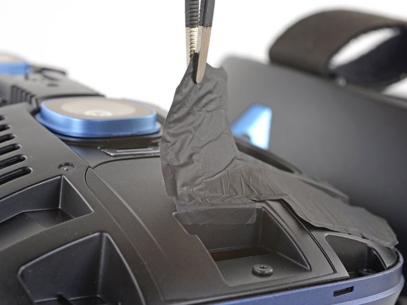

  8. HTC Vive Cosmos Motherboard Replacement: crwdns2935265:08crwdnd2935265:01crwdnd2935265:02crwdne2935265:0 HTC Vive Cosmos Motherboard Replacement: crwdns2935265:08crwdnd2935265:02crwdnd2935265:02crwdne2935265:0
    • Gently peel up the stickers on either side of the front of the Vive. If possible, keep the stickers intact and reuse them.

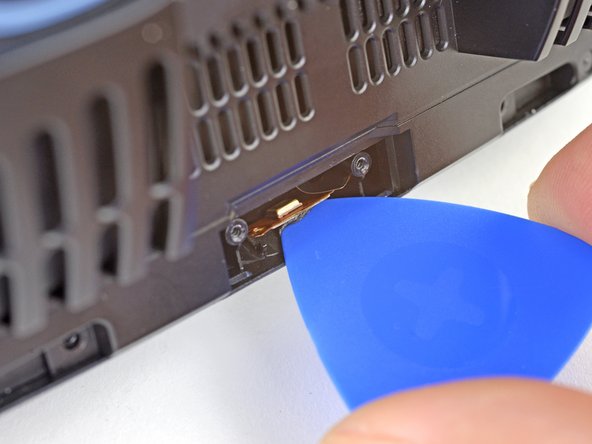

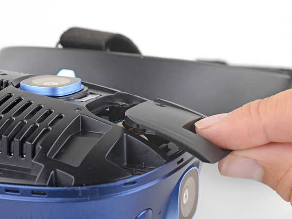

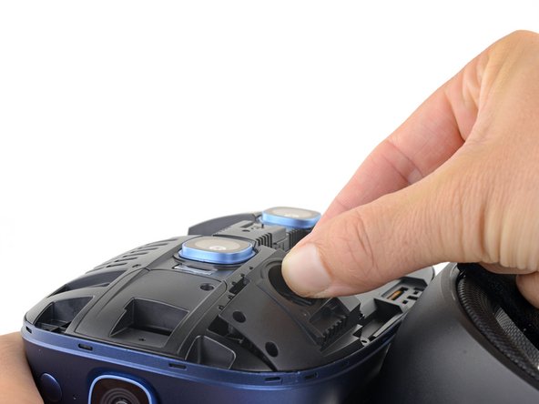

  10. HTC Vive Cosmos Motherboard Replacement, Remove the microphone: crwdns2935265:010crwdnd2935265:01crwdnd2935265:01crwdne2935265:0
    • Remove the microphone cover from the bottom edge of the headset.
  11. HTC Vive Cosmos Motherboard Replacement, Separate the microphone adhesive: crwdns2935265:011crwdnd2935265:01crwdnd2935265:02crwdne2935265:0 HTC Vive Cosmos Motherboard Replacement, Separate the microphone adhesive: crwdns2935265:011crwdnd2935265:02crwdnd2935265:02crwdne2935265:0
    • Slide an opening pick under the microphone to separate the adhesive securing it to the Vive.
    • If this is difficult, use a heated iOpener, hair dryer, or heat gun to apply heat to adhesive.

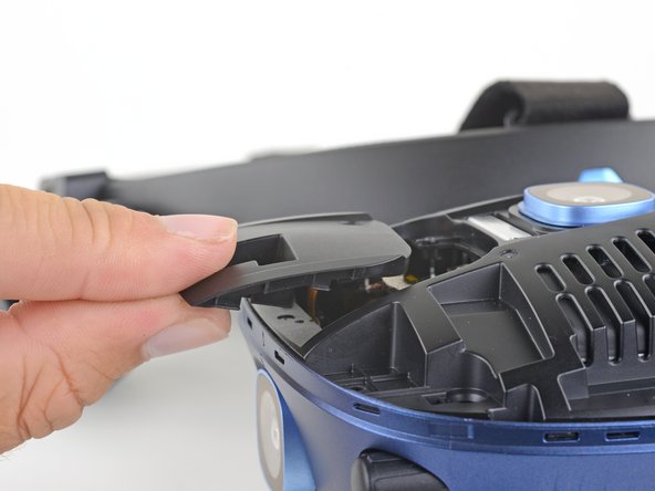

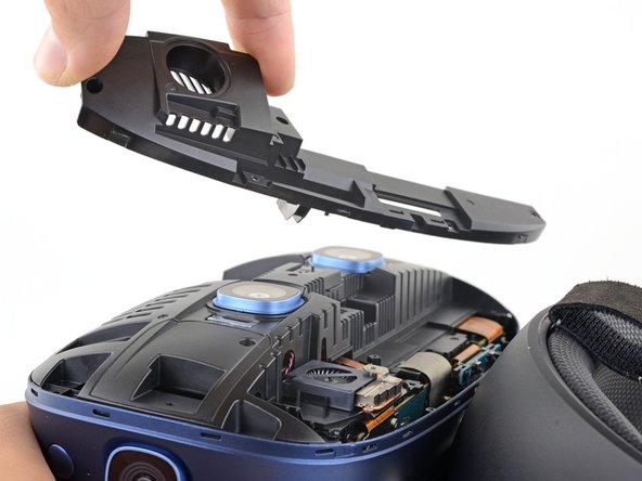

  12. HTC Vive Cosmos Motherboard Replacement, Remove the upper component cover: crwdns2935265:012crwdnd2935265:01crwdnd2935265:03crwdne2935265:0 HTC Vive Cosmos Motherboard Replacement, Remove the upper component cover: crwdns2935265:012crwdnd2935265:02crwdnd2935265:03crwdne2935265:0 HTC Vive Cosmos Motherboard Replacement, Remove the upper component cover: crwdns2935265:012crwdnd2935265:03crwdnd2935265:03crwdne2935265:0
    • Angle the bottom end of the upper component cover away from the front of the Vive.
    • Pull the upper component cover away from the front of the Vive and remove it.

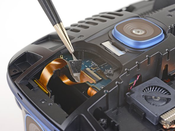

  14. HTC Vive Cosmos Motherboard Replacement, Disconnect the cameras: crwdns2935265:014crwdnd2935265:01crwdnd2935265:03crwdne2935265:0 HTC Vive Cosmos Motherboard Replacement, Disconnect the cameras: crwdns2935265:014crwdnd2935265:02crwdnd2935265:03crwdne2935265:0 HTC Vive Cosmos Motherboard Replacement, Disconnect the cameras: crwdns2935265:014crwdnd2935265:03crwdnd2935265:03crwdne2935265:0
    • Peel the tape over the right camera connector back enough to access the camera's ZIF connector underneath.
    • Repeat the same process to peel back the tape over the left camera ZIF connector.

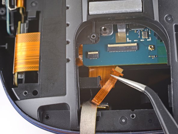

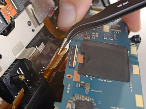

  15. HTC Vive Cosmos Motherboard Replacement: crwdns2935265:015crwdnd2935265:01crwdnd2935265:03crwdne2935265:0 HTC Vive Cosmos Motherboard Replacement: crwdns2935265:015crwdnd2935265:02crwdnd2935265:03crwdne2935265:0 HTC Vive Cosmos Motherboard Replacement: crwdns2935265:015crwdnd2935265:03crwdnd2935265:03crwdne2935265:0
    • Use the point of a spudger to flip up the small locking flap securing the right camera cable ZIF connector.
    • Carefully slide the camera connector cable straight out of its socket on the motherboard.

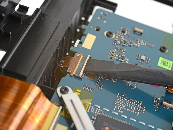

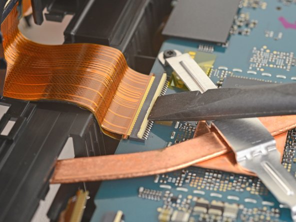

  16. HTC Vive Cosmos Motherboard Replacement: crwdns2935265:016crwdnd2935265:01crwdnd2935265:02crwdne2935265:0 HTC Vive Cosmos Motherboard Replacement: crwdns2935265:016crwdnd2935265:02crwdnd2935265:02crwdne2935265:0
    • Use the point of a spudger to flip up the small locking flap securing the left camera cable ZIF connector.

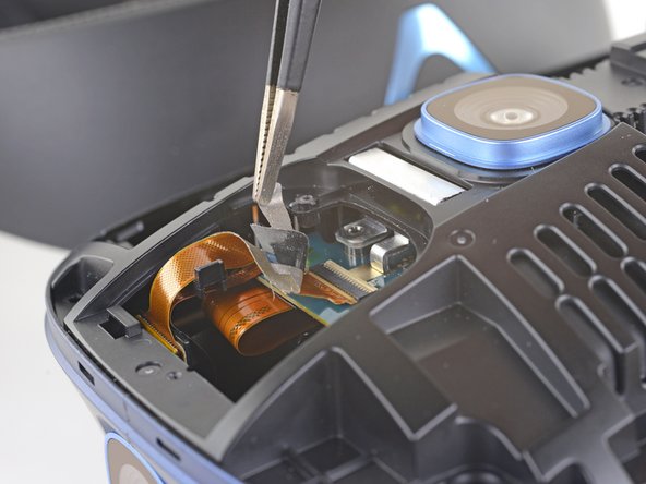

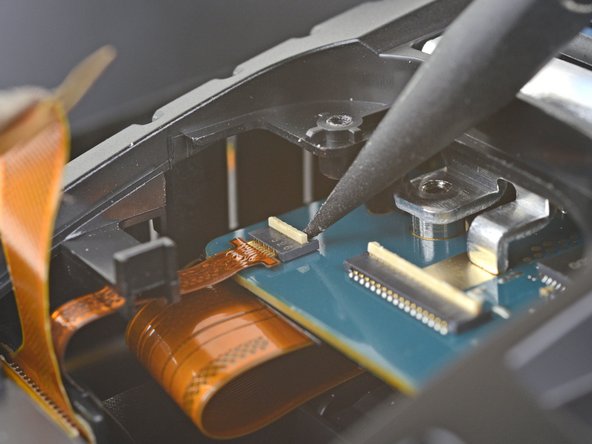

  17. HTC Vive Cosmos Motherboard Replacement, Disconnect the microphone: crwdns2935265:017crwdnd2935265:01crwdnd2935265:01crwdne2935265:0
    • Peel the yellow tape off of the microphone connector.
  18. HTC Vive Cosmos Motherboard Replacement: crwdns2935265:018crwdnd2935265:01crwdnd2935265:02crwdne2935265:0 HTC Vive Cosmos Motherboard Replacement: crwdns2935265:018crwdnd2935265:02crwdnd2935265:02crwdne2935265:0
    • Use the point of a spudger to flip up the small locking flap securing the microphone cable ZIF connector.

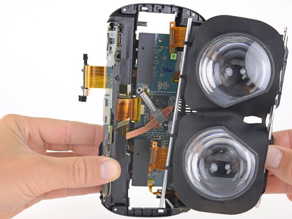

  20. HTC Vive Cosmos Motherboard Replacement, Remove the LCD and motherboard assembly: crwdns2935265:020crwdnd2935265:01crwdnd2935265:02crwdne2935265:0 HTC Vive Cosmos Motherboard Replacement, Remove the LCD and motherboard assembly: crwdns2935265:020crwdnd2935265:02crwdnd2935265:02crwdne2935265:0
    • Lift the LCD and motherboard assembly out of the headset.
    • The assembly is secured by clips around the edges. It may help to release the clips using a thin plastic tool, like an opening tool or a spudger.

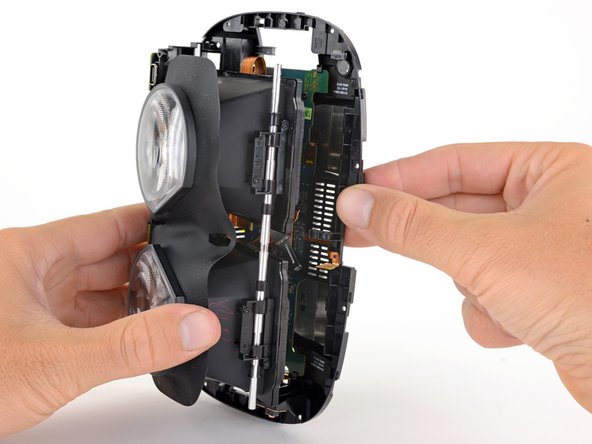

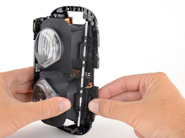

  23. HTC Vive Cosmos Motherboard Replacement, Remove the LCD frame assembly: crwdns2935265:023crwdnd2935265:01crwdnd2935265:03crwdne2935265:0 HTC Vive Cosmos Motherboard Replacement, Remove the LCD frame assembly: crwdns2935265:023crwdnd2935265:02crwdnd2935265:03crwdne2935265:0 HTC Vive Cosmos Motherboard Replacement, Remove the LCD frame assembly: crwdns2935265:023crwdnd2935265:03crwdnd2935265:03crwdne2935265:0
    • Gently pull the bottom edge of the midframe away from the bottom edges of the LCD frames to unclip the LCD frames from the midframe.
  24. HTC Vive Cosmos Motherboard Replacement: crwdns2935265:024crwdnd2935265:01crwdnd2935265:02crwdne2935265:0 HTC Vive Cosmos Motherboard Replacement: crwdns2935265:024crwdnd2935265:02crwdnd2935265:02crwdne2935265:0
    • Remove the LCD frame assembly from the midframe.
    • During reassembly, first seat the support rod in its slots in the midframe. Then gently press the rest of the LCD frame assembly into the midframe so that the bottom edges of the LCD frames clip into the midframe.

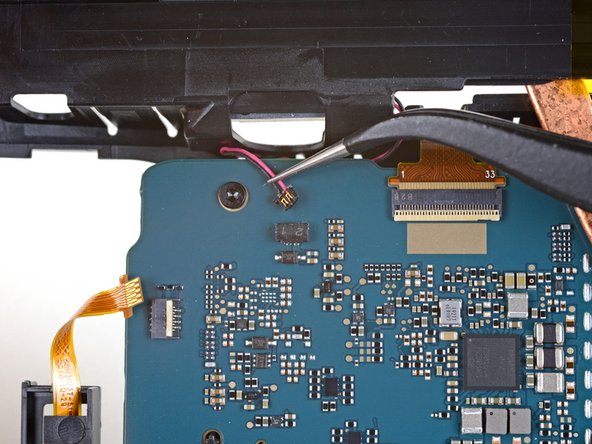

  25. HTC Vive Cosmos Motherboard Replacement, Disconnect the headset button: crwdns2935265:025crwdnd2935265:01crwdnd2935265:01crwdne2935265:0
    • Peel the yellow tape off of the headset button connector.
  26. HTC Vive Cosmos Motherboard Replacement: crwdns2935265:026crwdnd2935265:01crwdnd2935265:03crwdne2935265:0 HTC Vive Cosmos Motherboard Replacement: crwdns2935265:026crwdnd2935265:02crwdnd2935265:03crwdne2935265:0 HTC Vive Cosmos Motherboard Replacement: crwdns2935265:026crwdnd2935265:03crwdnd2935265:03crwdne2935265:0
    • Use the point of a spudger to flip up the small locking flap securing the headset button cable ZIF connector.
    • Carefully slide the headset button connector cable straight out of its socket on the motherboard.

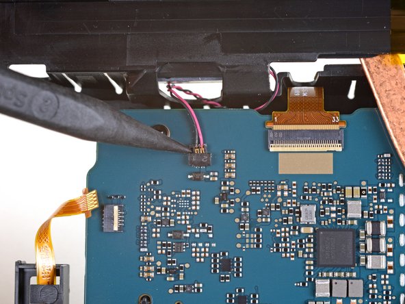

  27. HTC Vive Cosmos Motherboard Replacement, Disconnect the fan cable: crwdns2935265:027crwdnd2935265:01crwdnd2935265:01crwdne2935265:0
    • Peel the black plastic sticker off of the left side of the motherboard.
  28. HTC Vive Cosmos Motherboard Replacement: crwdns2935265:028crwdnd2935265:01crwdnd2935265:03crwdne2935265:0 HTC Vive Cosmos Motherboard Replacement: crwdns2935265:028crwdnd2935265:02crwdnd2935265:03crwdne2935265:0 HTC Vive Cosmos Motherboard Replacement: crwdns2935265:028crwdnd2935265:03crwdnd2935265:03crwdne2935265:0
    • Use the tip of a spudger to push one side of the the fan connector slightly out of its socket on the motherboard, then push on the other side of the connector. Continue alternating pressure on each side to gently ease the connector out of its socket.
    • Apply pressure parallel to the motherboard. Do not pry up on the connector.

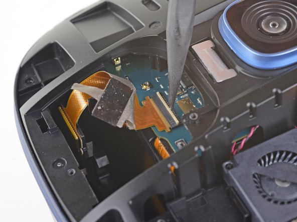

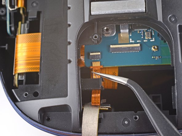

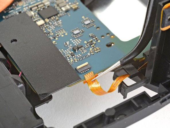

  29. HTC Vive Cosmos Motherboard Replacement, Disconnect the left camera: crwdns2935265:029crwdnd2935265:01crwdnd2935265:03crwdne2935265:0 HTC Vive Cosmos Motherboard Replacement, Disconnect the left camera: crwdns2935265:029crwdnd2935265:02crwdnd2935265:03crwdne2935265:0 HTC Vive Cosmos Motherboard Replacement, Disconnect the left camera: crwdns2935265:029crwdnd2935265:03crwdnd2935265:03crwdne2935265:0
    • Use the flat end of a spudger to flip up the locking flap securing the left camera cable ZIF connector.
    • Carefully slide the camera cable straight out of its socket on the motherboard.

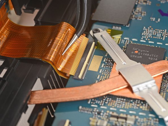

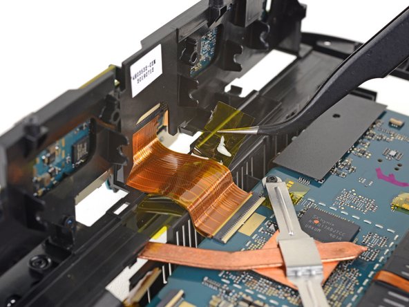

  30. HTC Vive Cosmos Motherboard Replacement, Disconnect the second interconnect cable: crwdns2935265:030crwdnd2935265:01crwdnd2935265:02crwdne2935265:0 HTC Vive Cosmos Motherboard Replacement, Disconnect the second interconnect cable: crwdns2935265:030crwdnd2935265:02crwdnd2935265:02crwdne2935265:0
    • Peel the yellow tape off of both the second interconnect cable and its socket on the motherboard.
  31. HTC Vive Cosmos Motherboard Replacement: crwdns2935265:031crwdnd2935265:01crwdnd2935265:03crwdne2935265:0 HTC Vive Cosmos Motherboard Replacement: crwdns2935265:031crwdnd2935265:02crwdnd2935265:03crwdne2935265:0 HTC Vive Cosmos Motherboard Replacement: crwdns2935265:031crwdnd2935265:03crwdnd2935265:03crwdne2935265:0
    • Use the flat end of a spudger to flip up the locking flap securing the second interconnect cable ZIF connector.
    • Carefully slide the second interconnect cable straight out of its socket on the motherboard.

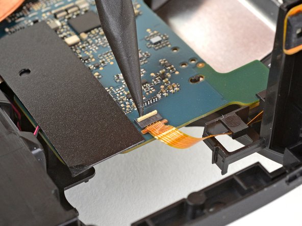

  32. HTC Vive Cosmos Motherboard Replacement, Disconnect the microphone: crwdns2935265:032crwdnd2935265:01crwdnd2935265:01crwdne2935265:0
  33. HTC Vive Cosmos Motherboard Replacement: crwdns2935265:033crwdnd2935265:01crwdnd2935265:03crwdne2935265:0 HTC Vive Cosmos Motherboard Replacement: crwdns2935265:033crwdnd2935265:02crwdnd2935265:03crwdne2935265:0 HTC Vive Cosmos Motherboard Replacement: crwdns2935265:033crwdnd2935265:03crwdnd2935265:03crwdne2935265:0
    • Carefully slide the microphone cable straight out of its socket.

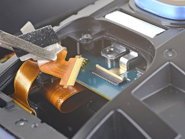

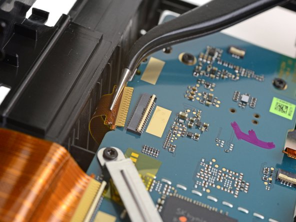

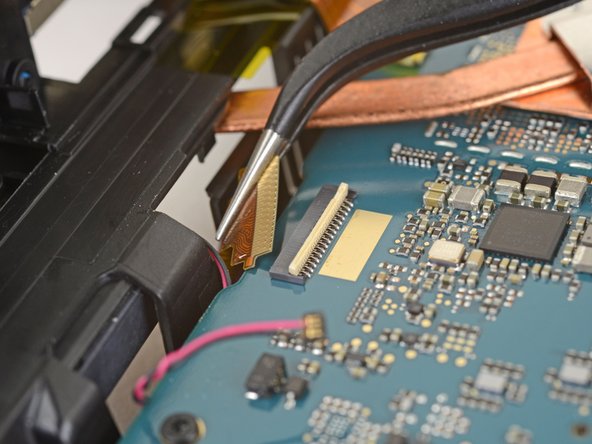

  34. HTC Vive Cosmos Motherboard Replacement, Disconnect the right camera: crwdns2935265:034crwdnd2935265:01crwdnd2935265:01crwdne2935265:0
    • Peel the black plastic sticker off of the right side of the motherboard.

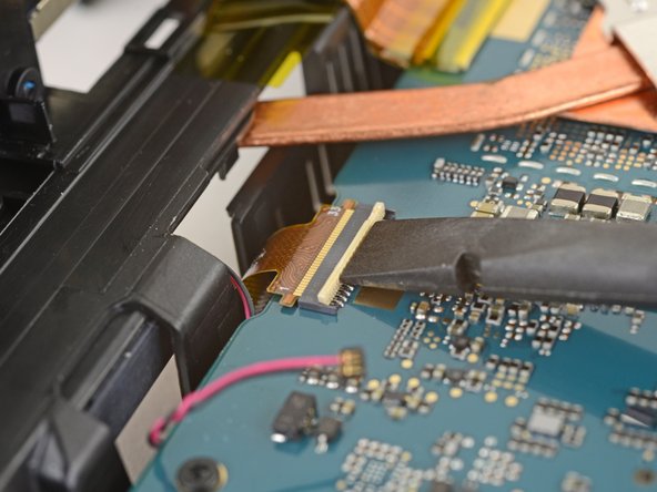

  35. HTC Vive Cosmos Motherboard Replacement: crwdns2935265:035crwdnd2935265:01crwdnd2935265:03crwdne2935265:0 HTC Vive Cosmos Motherboard Replacement: crwdns2935265:035crwdnd2935265:02crwdnd2935265:03crwdne2935265:0 HTC Vive Cosmos Motherboard Replacement: crwdns2935265:035crwdnd2935265:03crwdnd2935265:03crwdne2935265:0
    • Use the flat end of a spudger to flip up the locking flap securing the right camera cable ZIF connector.

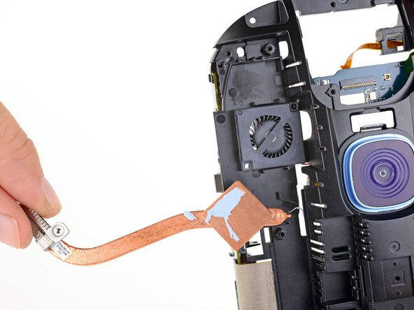

  37. HTC Vive Cosmos Motherboard Replacement, Remove the heat sink bracket: crwdns2935265:037crwdnd2935265:01crwdnd2935265:01crwdne2935265:0
    • Remove the heat sink bracket.

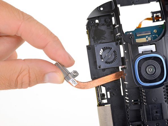

  38. HTC Vive Cosmos Motherboard Replacement, Remove the heat sink: crwdns2935265:038crwdnd2935265:01crwdnd2935265:02crwdne2935265:0 HTC Vive Cosmos Motherboard Replacement, Remove the heat sink: crwdns2935265:038crwdnd2935265:02crwdnd2935265:02crwdne2935265:0
  39. HTC Vive Cosmos Motherboard Replacement: crwdns2935265:039crwdnd2935265:01crwdnd2935265:03crwdne2935265:0 HTC Vive Cosmos Motherboard Replacement: crwdns2935265:039crwdnd2935265:02crwdnd2935265:03crwdne2935265:0 HTC Vive Cosmos Motherboard Replacement: crwdns2935265:039crwdnd2935265:03crwdnd2935265:03crwdne2935265:0
    • Carefully thread the heatsink through its slot in the midframe and remove it.

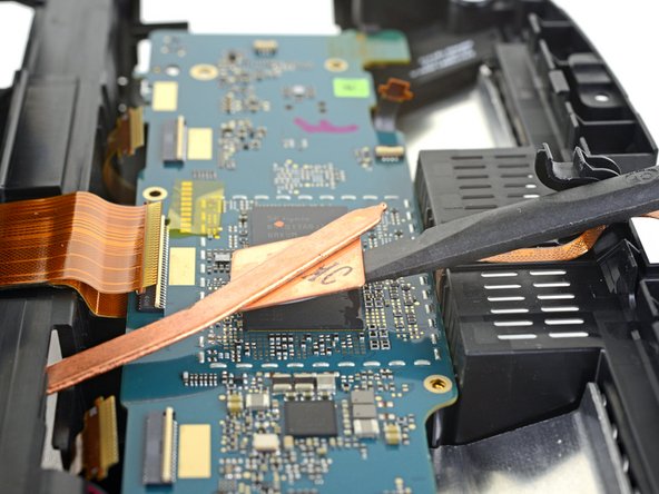

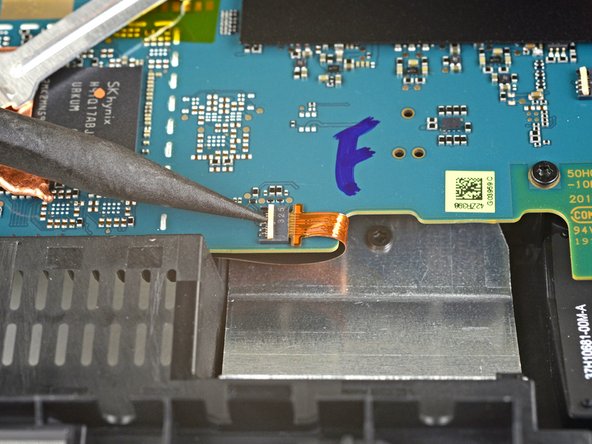

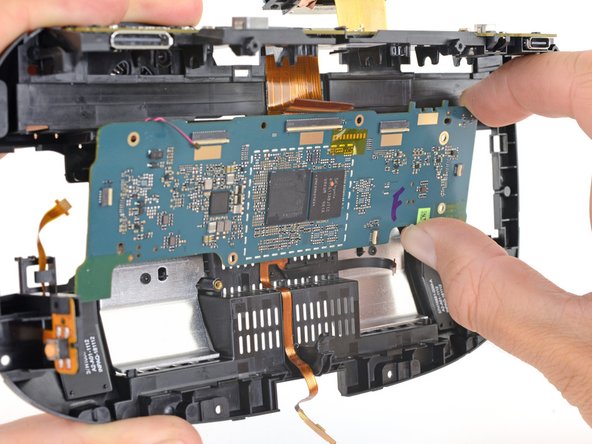

  40. HTC Vive Cosmos Motherboard Replacement, Disconnect the motherboard: crwdns2935265:040crwdnd2935265:01crwdnd2935265:03crwdne2935265:0 HTC Vive Cosmos Motherboard Replacement, Disconnect the motherboard: crwdns2935265:040crwdnd2935265:02crwdnd2935265:03crwdne2935265:0 HTC Vive Cosmos Motherboard Replacement, Disconnect the motherboard: crwdns2935265:040crwdnd2935265:03crwdnd2935265:03crwdne2935265:0
    • Hinge the top end of the motherboard slightly away from the midframe.
    • Slide the motherboard up and out of the clips holding its bottom edge against the midframe.
    • Do not remove the motherboard yet, it is still connected to the daughterboard.

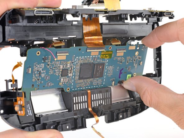

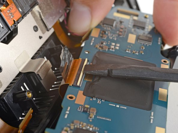

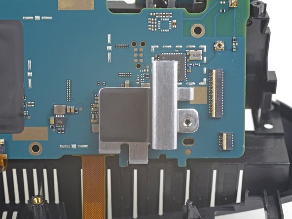

  41. HTC Vive Cosmos Motherboard Replacement: crwdns2935265:041crwdnd2935265:01crwdnd2935265:03crwdne2935265:0 HTC Vive Cosmos Motherboard Replacement: crwdns2935265:041crwdnd2935265:02crwdnd2935265:03crwdne2935265:0 HTC Vive Cosmos Motherboard Replacement: crwdns2935265:041crwdnd2935265:03crwdnd2935265:03crwdne2935265:0
    • Swing the motherboard toward the top of the midframe to access the underside of the motherboard.
    • A metal bracket with a screw boss and thermal paste will likely fall off of the motherboard during this step. Keep track of the bracket and during reassembly return it to its position, shown in the last photo. One of the motherboard screws will thread into it.

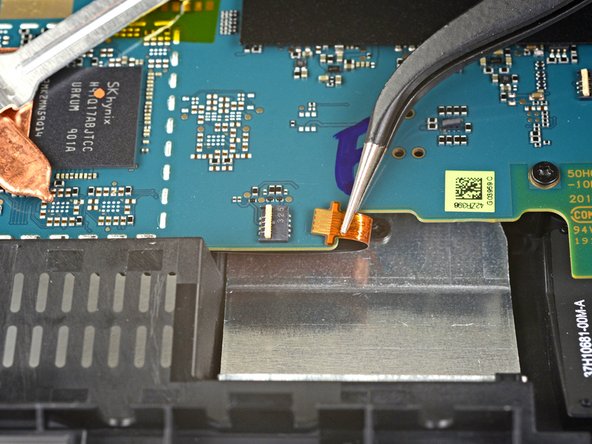

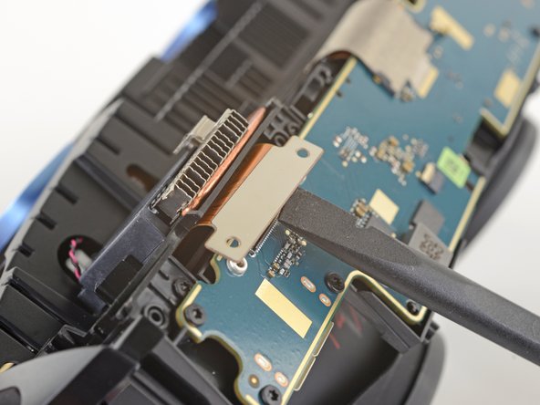

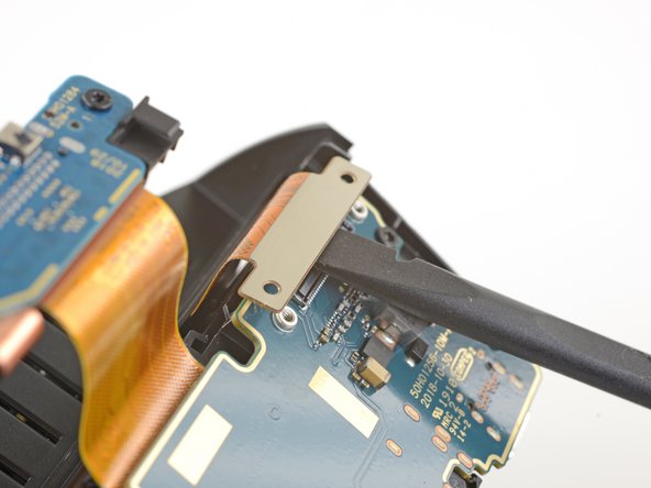

  42. HTC Vive Cosmos Motherboard Replacement: crwdns2935265:042crwdnd2935265:01crwdnd2935265:01crwdne2935265:0
    • Peel the tape over the daughterboard interconnect cable back far enough to access the cable connector.

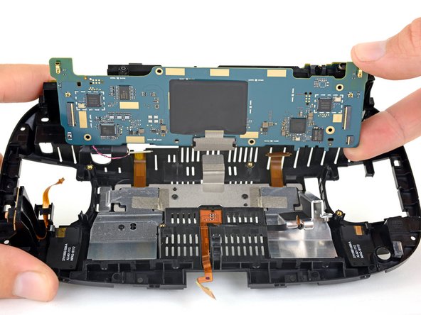

  43. HTC Vive Cosmos Motherboard Replacement: crwdns2935265:043crwdnd2935265:01crwdnd2935265:03crwdne2935265:0 HTC Vive Cosmos Motherboard Replacement: crwdns2935265:043crwdnd2935265:02crwdnd2935265:03crwdne2935265:0 HTC Vive Cosmos Motherboard Replacement: crwdns2935265:043crwdnd2935265:03crwdnd2935265:03crwdne2935265:0
    • Use the flat end of a spudger to flip up the locking flap securing the interconnect cable ZIF connector.
    • Carefully slide the interconnect cable straight out of its socket.
    • Remove the motherboard.
  44. HTC Vive Cosmos Motherboard Replacement, Remove the motherboard: crwdns2935265:044crwdnd2935265:01crwdnd2935265:01crwdne2935265:0
    • Only the motherboard remains.
