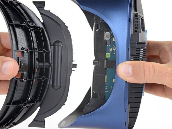

  10. HTC Vive Cosmos Headstrap Hinge Replacement, Remove the headstrap hinge: crwdns2935265:010crwdnd2935265:01crwdnd2935265:01crwdne2935265:0
    • Use a T5 Torx driver to remove the three 4.1 mm long screws securing the headstrap hinge.
  11. HTC Vive Cosmos Headstrap Hinge Replacement: crwdns2935265:011crwdnd2935265:01crwdnd2935265:01crwdne2935265:0
    • Use a T5 Torx driver to unscrew the captive screw securing the headstrap hinge.
    • There is a sticker covering this screw. Poke through it with your driver to access the screw.
  12. HTC Vive Cosmos Headstrap Hinge Replacement: crwdns2935265:012crwdnd2935265:01crwdnd2935265:02crwdne2935265:0 HTC Vive Cosmos Headstrap Hinge Replacement: crwdns2935265:012crwdnd2935265:02crwdnd2935265:02crwdne2935265:0
    • Slide the headstrap hinge out of its slot in the Vive and remove it.
