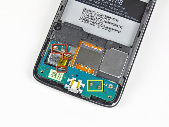

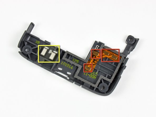

    • After a bit of prying with a plastic opening tool, the bottom inner case can be removed from the Surround.
    • Six pressure contacts on the bottom inner case serve to:
    • Connect the lower speaker to the lower motherboard.
    • Connect to what is presumably an antenna housed in the bottom inner case.

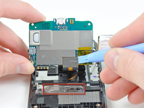

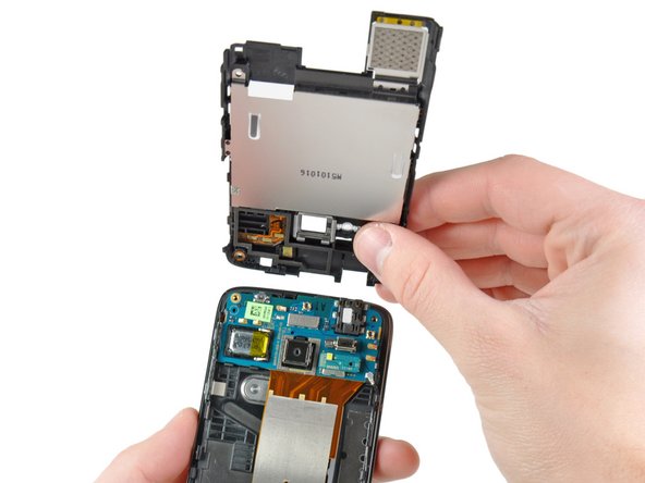

  8. HTC Surround Teardown: crwdns2935265:08crwdnd2935265:01crwdnd2935265:02crwdne2935265:0 HTC Surround Teardown: crwdns2935265:08crwdnd2935265:02crwdnd2935265:02crwdne2935265:0
    • Some more prying with a plastic opening tool and the upper section of the inner case can be removed.
    • The upper section of the inner case also has a small interconnect board to connect the speaker to the top motherboard in addition to an antenna and integrated shields for EMI protection.

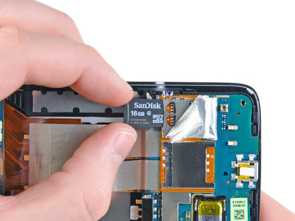

    • More poking and prodding reveals that the "internal storage" in the Surround is no more than a well-hidden MicroSDHC card. And they would've gotten away with it too if it weren't for us meddling kids!
    • Should you decide that 16 GB isn't enough, it definitely seems possible that you could easily swap the card out for a higher capacity MicroSDHC.

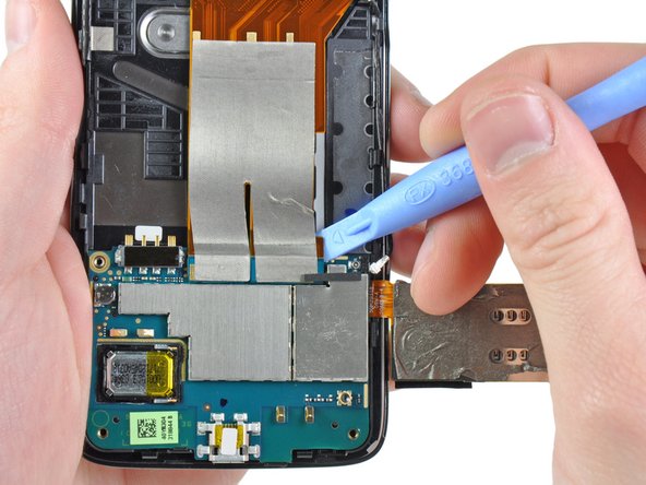

  11. HTC Surround Teardown: crwdns2935265:011crwdnd2935265:01crwdnd2935265:03crwdne2935265:0 HTC Surround Teardown: crwdns2935265:011crwdnd2935265:02crwdnd2935265:03crwdne2935265:0 HTC Surround Teardown: crwdns2935265:011crwdnd2935265:03crwdnd2935265:03crwdne2935265:0
    • A handful of connectors attached to the antenna, motherboard interconnect, and display data cables stand between us and the lower half of the Surround's motherboard. Luckily, we're feeling up to the task.
    • The hefty slider mechanism should hold up to years of opening and closing the speaker grille.

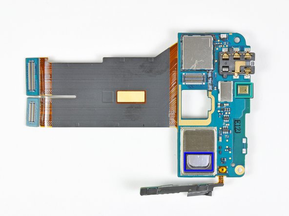

  14. HTC Surround Teardown: crwdns2935265:014crwdnd2935265:01crwdnd2935265:01crwdne2935265:0
    • After prying a few retaining clips out of the way, the upper motherboard can be removed from the Surround.
    • The motherboard interconnect cable is sandwiched between the many layers of the upper motherboard, much like on the Nexus One. This technique eliminates the space requirements for thick connectors and sockets, making the final connection much thinner.

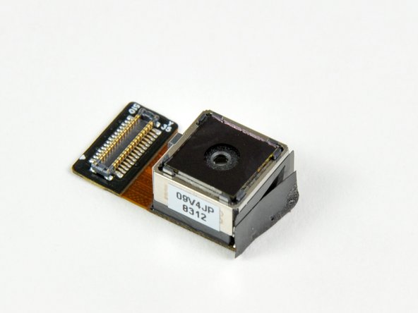

  15. HTC Surround Teardown: crwdns2935265:015crwdnd2935265:01crwdnd2935265:02crwdne2935265:0 HTC Surround Teardown: crwdns2935265:015crwdnd2935265:02crwdnd2935265:02crwdne2935265:0
    • The Surround's camera is easily removable from the top motherboard.
    • This little camera shoots 5 MP stills with autofocus and records 720p video at 24 fps.
