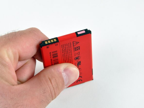

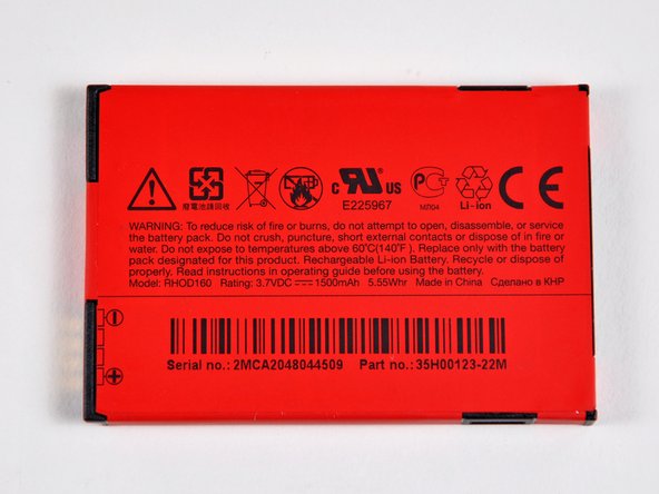

    • Like most reasonable phones, changing the Evo's battery is a snap.
    • The 3.7 V, 1500 mAh rechargeable Li-ion battery weighs in at 31 grams.
    • That's 23% more capacity than an iPhone 3GS, 15% more than a Droid Incredible, and 7% more than a Nexus One.
    • Look out! There's a liquid damage indicator on the battery's top edge.
  5. HTC Evo 4G Teardown: crwdns2935265:05crwdnd2935265:01crwdnd2935265:02crwdne2935265:0 HTC Evo 4G Teardown: crwdns2935265:05crwdnd2935265:02crwdnd2935265:02crwdne2935265:0

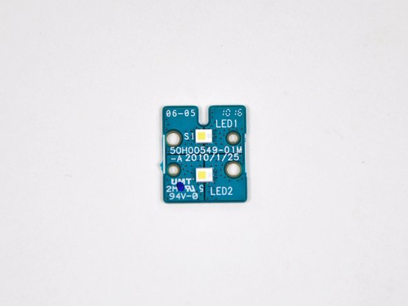

    • Two small Phillips screws secure the LED flash to the internal frame.
    • The dual LED flash assembly consists of no more than two LEDs soldered to a small interconnect board.

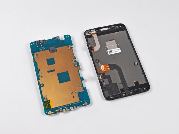

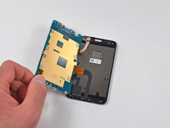

    • A small Phillips screw near the top left corner of the Evo is all that keeps the left side of the logic board snug in its cradle.
  9. HTC Evo 4G Teardown: crwdns2935265:09crwdnd2935265:01crwdnd2935265:02crwdne2935265:0 HTC Evo 4G Teardown: crwdns2935265:09crwdnd2935265:02crwdnd2935265:02crwdne2935265:0
    • After disconnecting ribbon cables for the display, digitizer, and front camera, the logic board can be removed from the front half of the Evo.

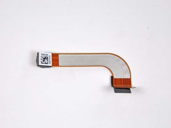

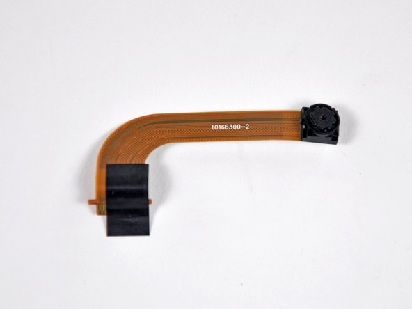

    • The forward facing 1.3 Megapixel camera lifts right out of its enclosure in the top portion of the Evo 4G.

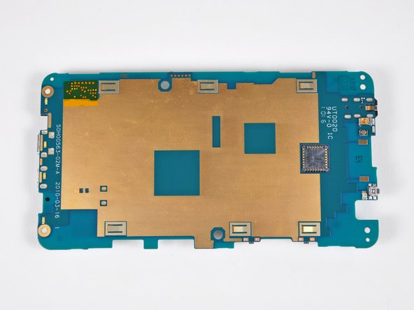

    • Standing out on the board:
    • Several rows of pressure contacts connecting the antennas to the logic board.
    • The vibrator motor for...well...vibrating.
    • 8 Megapixel camera sensor.
    • Battery connector.
    • The other side of the board is about as featureless as it can be.
