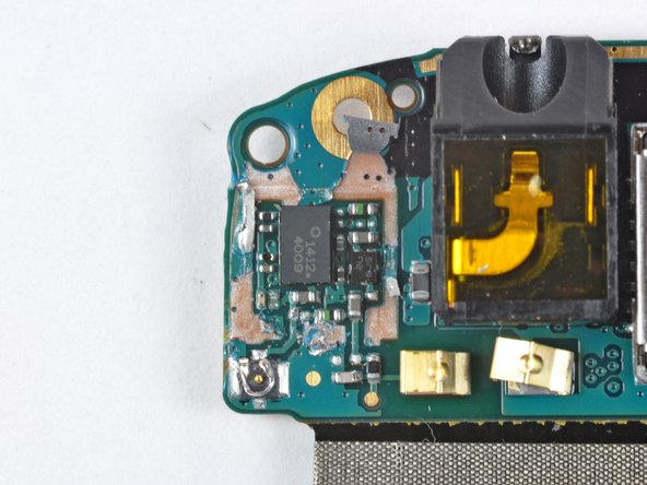

    • We had to take care of one more Phillips screw.
    • After that, the logic board assembly slowly-but-surely slid out from the rest of the phone.
    • The camera and headphone jack are both soldered directly to the main board.

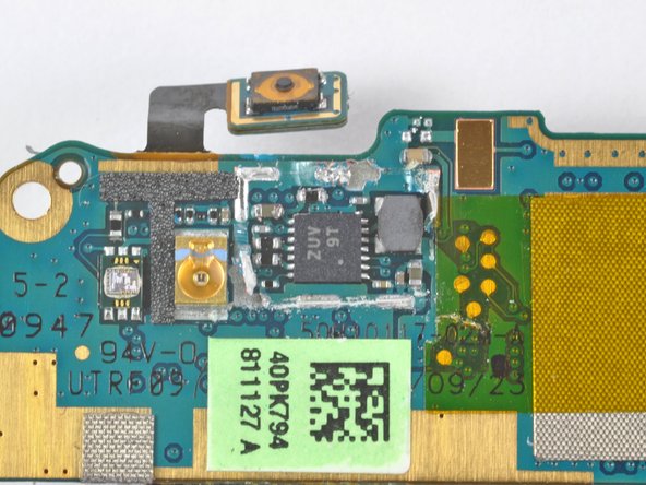

    • Three more chips.
    • Unfortunately these were located underneath soldered EMI covers. For the sake of science and gadget lovers everywhere, we had to be a little forceful to get these covers off.
    • Using the Nexus One post-teardown just became very iffy. Previous to this step, we felt good about its functionality, but no longer...
