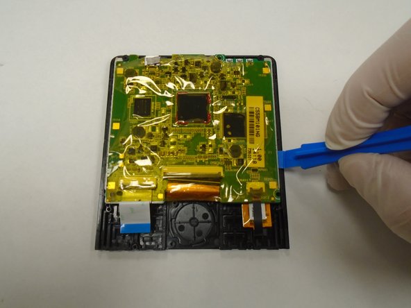

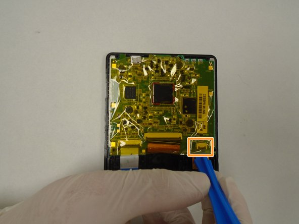

    • Using a Phillips #00 screwdriver, remove the four screws securing the motherboard/display to the front panel.
    • Using a plastic opening tool, pry up the locking tab of the ZIF connector on the right side of the device and pull out the ribbon cable.
    • Using a plastic opening tool, gently pry apart the motherboard and the front panel.
  10. HP Prime Graphing Calculator G8X92A Motherboard/Display Replacement: crwdns2935265:010crwdnd2935265:01crwdnd2935265:02crwdne2935265:0 HP Prime Graphing Calculator G8X92A Motherboard/Display Replacement: crwdns2935265:010crwdnd2935265:02crwdnd2935265:02crwdne2935265:0
    • Remove the motherboard from the display.
