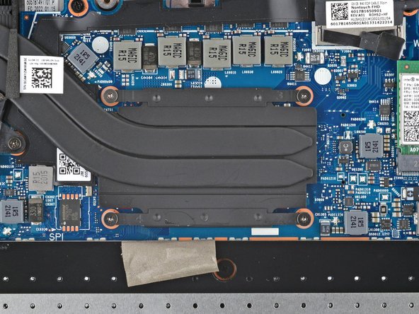

  9. HP EliteBook 845 G9 Heat Sink Replacement, Unfasten the heat sink: crwdns2935265:09crwdnd2935265:01crwdnd2935265:02crwdne2935265:0 HP EliteBook 845 G9 Heat Sink Replacement, Unfasten the heat sink: crwdns2935265:09crwdnd2935265:02crwdnd2935265:02crwdne2935265:0
    • Use a Phillips screwdriver to fully loosen (not remove) the four captive screws securing the heat sink. Loosen the screws in descending order based on the numbers stamped next to each screw.
    • During reassembly, tighten the heat sink screws a few turns at a time in ascending order based on the numbers stamped next to each screw. This will usually be in an "X" pattern.

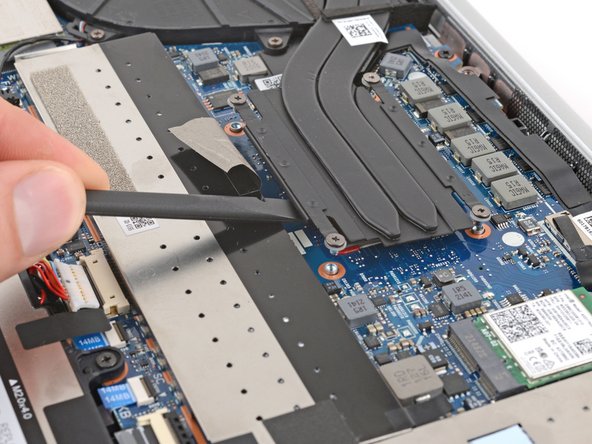

  10. HP EliteBook 845 G9 Heat Sink Replacement, Pry up the heat sink: crwdns2935265:010crwdnd2935265:01crwdnd2935265:02crwdne2935265:0 HP EliteBook 845 G9 Heat Sink Replacement, Pry up the heat sink: crwdns2935265:010crwdnd2935265:02crwdnd2935265:02crwdne2935265:0
    • Use the flat end of a spudger to pry up the bottom edge of the heat sink.
    • Thermal paste bonds the heat sink to the CPU. Depending on the age of your device and condition of the thermal paste, this may take some force. Pull up with constant, steady force to peel the heat sink away from the board.

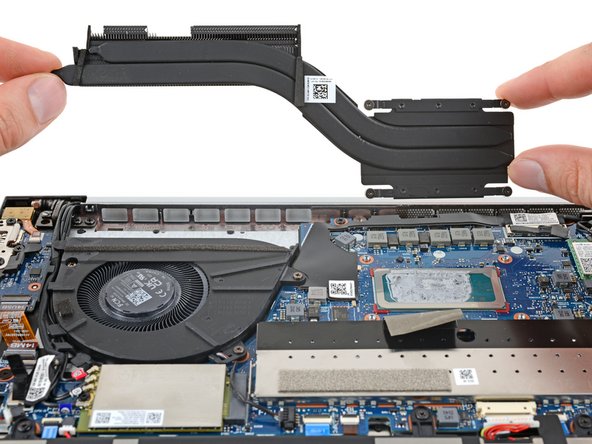

  11. HP EliteBook 845 G9 Heat Sink Replacement, Remove the heatsink: crwdns2935265:011crwdnd2935265:01crwdnd2935265:03crwdne2935265:0 HP EliteBook 845 G9 Heat Sink Replacement, Remove the heatsink: crwdns2935265:011crwdnd2935265:02crwdnd2935265:03crwdne2935265:0 HP EliteBook 845 G9 Heat Sink Replacement, Remove the heatsink: crwdns2935265:011crwdnd2935265:03crwdnd2935265:03crwdne2935265:0
    • Lift and remove the heat sink.
    • During reassembly:

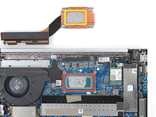

    • Check if your replacement heat sink comes with thermal paste pre‑installed on the bottom. If it does, do not apply new thermal paste.
    • Follow this guide to clean the CPU and apply new thermal paste.
    • If you're reusing the heat sink, make sure to clean it as well.
