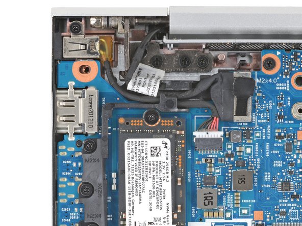

  8. HP EliteBook 840 G7 SSD Replacement, Remove the SSD screw: crwdns2935265:08crwdnd2935265:01crwdnd2935265:02crwdne2935265:0 HP EliteBook 840 G7 SSD Replacement, Remove the SSD screw: crwdns2935265:08crwdnd2935265:02crwdnd2935265:02crwdne2935265:0
    • Depending on your laptop configuration, you may need to remove a metal shield or plastic cover to access the SSD.
    • Use a Phillips screwdriver to remove the 2.4 mm‑long screw securing the SSD.
    • With the screw removed, the SSD may pop up at a slight angle.
    • During reassembly, gently hold down the SSD while installing its screw.

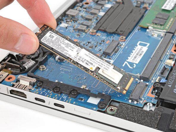

  9. HP EliteBook 840 G7 SSD Replacement, Remove the SSD: crwdns2935265:09crwdnd2935265:01crwdnd2935265:02crwdne2935265:0 HP EliteBook 840 G7 SSD Replacement, Remove the SSD: crwdns2935265:09crwdnd2935265:02crwdnd2935265:02crwdne2935265:0
    • Don't pull up at a sharp angle, or you may damage the SSD and its socket.
    • Grip the SSD by its edges and pull it straight out of its socket to remove it.
    • During reassembly, insert the SSD into its socket at a slight downward angle.
