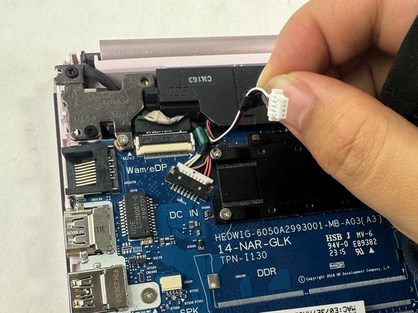

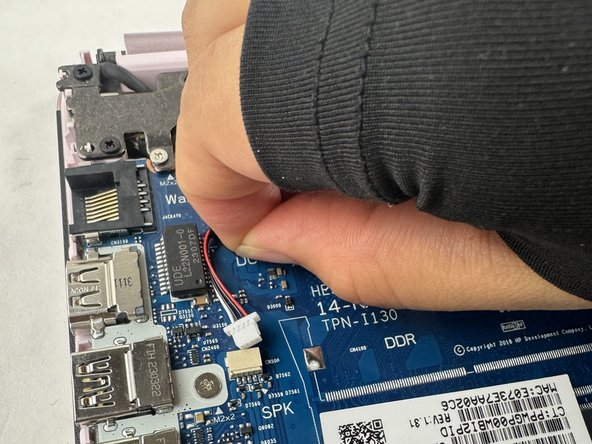

    • Use your fingers or tweezers to pull out the speaker cable from the slide connector socket on the motherboard.
    • Don't pull on the wires as it may damage the connector or cable.
    • If that doesn't work, use the point of a spudger to push on alternating sides of the connector to "walk" it out of its socket.
    • It may take a lot of alternating before the connector comes out.
    • To reconnect the cable, align the connector and use a spudger or clean fingernail to push it fully into the socket.
    • Don't push on the cables themselves, or you may damage the connector.

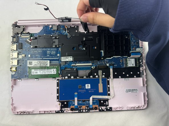

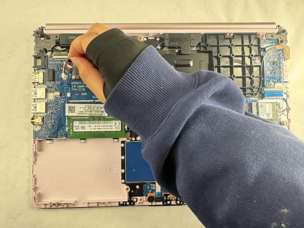

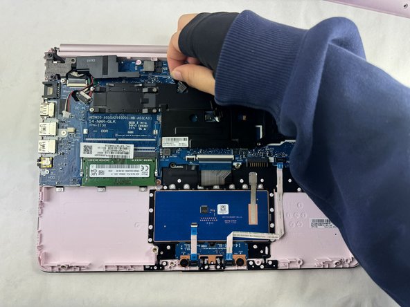

    • Remove the tape holding the cables to the motherboard.
  10. HP 14-cf2112wm Speakers Replacement: crwdns2935265:010crwdnd2935265:01crwdnd2935265:03crwdne2935265:0 HP 14-cf2112wm Speakers Replacement: crwdns2935265:010crwdnd2935265:02crwdnd2935265:03crwdne2935265:0 HP 14-cf2112wm Speakers Replacement: crwdns2935265:010crwdnd2935265:03crwdnd2935265:03crwdne2935265:0
    • Remove the speakers.
    • A loose plastic piece may or may not fall out during this step, but you can press it back in place between the speaker and the motherboard.
