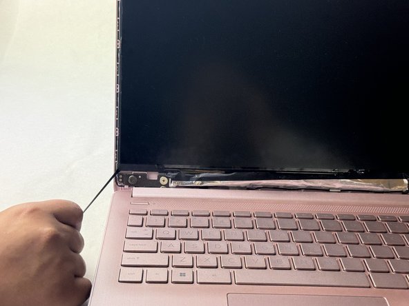

    • Use an opening pick to release the tabs and glue securing the bezel.
    • Gently work your way around the bezel with the pick and remove it from the screen.
    • Use the plastic pick to pry off the hinge cover and remove it.
    • Using both hands, gently pull the bezel away from the screen, unsnapping the tabs underneath as you go.
    • The bottom may be harder to remove, and you may need to use a bit more force.

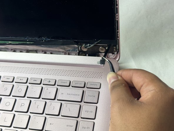

  3. HP 14-cf2112wm Screen Replacement: crwdns2935265:03crwdnd2935265:01crwdnd2935265:03crwdne2935265:0 HP 14-cf2112wm Screen Replacement: crwdns2935265:03crwdnd2935265:02crwdnd2935265:03crwdne2935265:0 HP 14-cf2112wm Screen Replacement: crwdns2935265:03crwdnd2935265:03crwdnd2935265:03crwdne2935265:0
    • Use tweezers to pick the loose tab in the bottom left corner of the screen and gently pull out the adhesive strip.
    • Do the same on the right side.
    • The strips may snap if you pull them too hard or quickly. This is okay because, although you may not get all of it in one pull, you can pick the rest out around the screen using a spudger and the tweezers.
    • You will need new adhesive strips when placing the new screen.

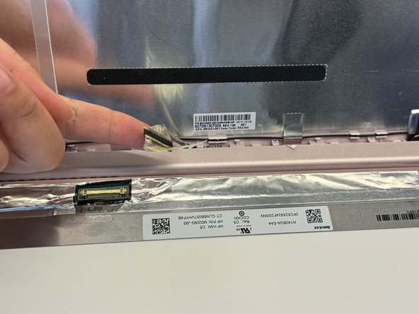

  6. HP 14-cf2112wm Screen Replacement: crwdns2935265:06crwdnd2935265:01crwdnd2935265:02crwdne2935265:0 HP 14-cf2112wm Screen Replacement: crwdns2935265:06crwdnd2935265:02crwdnd2935265:02crwdne2935265:0
    • Peel off the clear tape from the connector.
    • Gently push the tip of a spudger under the metal buckle to unclip it, then swing it over the socket.
    • Hold the buckle and cable together and gently pull the connector straight out of its socket.
    • To reconnect:
    • Grip the cable and buckle together and insert the connector fully into its socket.
    • Aligning the connector can be tricky. Reposition it as necessary and don't try to force it into the socket, or you may damage both the connector and its socket.
    • Flip the buckle over the socket and use a spudger to press the buckle down until it clicks into place. Replace the tape to secure the connector.
    • When replacing the screen, be sure to line up the cable with the display connector socket.
