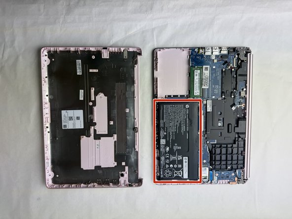

  5. HP 14-cf2112wm RAM Replacement: crwdns2935265:05crwdnd2935265:01crwdnd2935265:01crwdne2935265:0
    • Lift the back cover off the laptop.

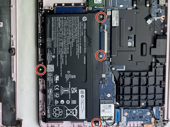

  6. HP 14-cf2112wm RAM Replacement, Battery: crwdns2935265:06crwdnd2935265:01crwdnd2935265:03crwdne2935265:0 HP 14-cf2112wm RAM Replacement, Battery: crwdns2935265:06crwdnd2935265:02crwdnd2935265:03crwdne2935265:0 HP 14-cf2112wm RAM Replacement, Battery: crwdns2935265:06crwdnd2935265:03crwdnd2935265:03crwdne2935265:0
    • Place your opened laptop on a flat surface.
    • Use a Phillips #1 screwdriver to remove the four Phillips 3.0 mm screws securing the battery.
  7. HP 14-cf2112wm RAM Replacement: crwdns2935265:07crwdnd2935265:01crwdnd2935265:02crwdne2935265:0 HP 14-cf2112wm RAM Replacement: crwdns2935265:07crwdnd2935265:02crwdnd2935265:02crwdne2935265:0
    • Slide the battery out from the connector on the motherboard.

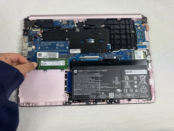

  8. HP 14-cf2112wm RAM Replacement, RAM: crwdns2935265:08crwdnd2935265:01crwdnd2935265:02crwdne2935265:0 HP 14-cf2112wm RAM Replacement, RAM: crwdns2935265:08crwdnd2935265:02crwdnd2935265:02crwdne2935265:0
    • Pull the metal arms (located on both sides of the RAM stick) slightly away from it .
    • The RAM will pop up by a few millimeters.
  9. HP 14-cf2112wm RAM Replacement: crwdns2935265:09crwdnd2935265:01crwdnd2935265:01crwdne2935265:0
    • Gently slide the RAM stick from the socket.
    • Remove it at an angle and not straight up so you don't damage the socket.
    • After you slide the new RAM stick back into the socket, push it down and it will click into place.
