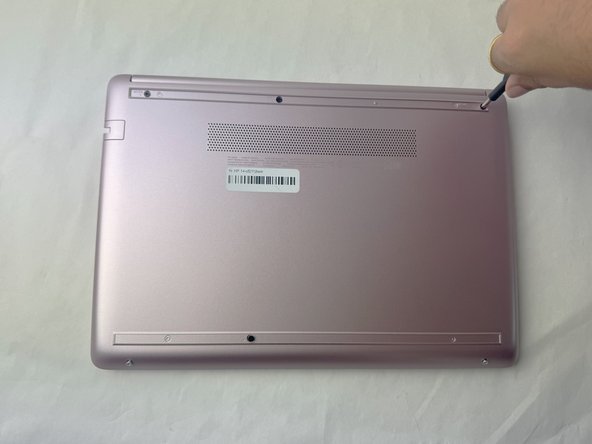

    • Use a Phillips #1 screwdriver to remove six 6 mm screws from the back case.

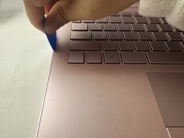

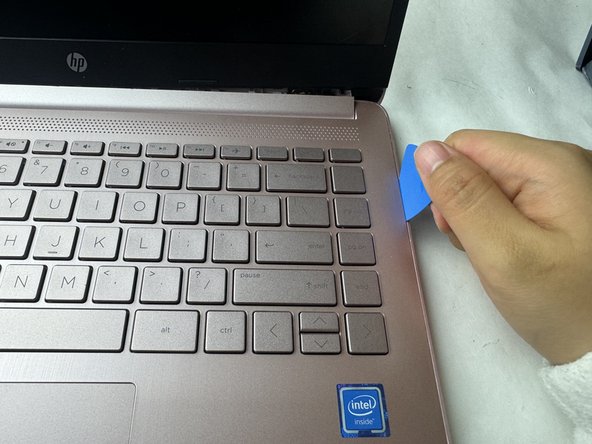

    • Use a pick or opening tool to pry along the edges of the back cover from the keyboard side of the laptop.
    • Be careful as the case edges are sharp.

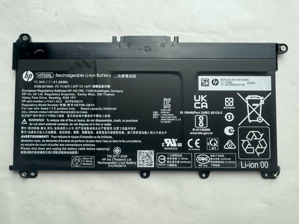

  5. HP 14-cf2112wm Battery Replacement: crwdns2935265:05crwdnd2935265:01crwdnd2935265:01crwdne2935265:0
    • Lift the back cover off the laptop.

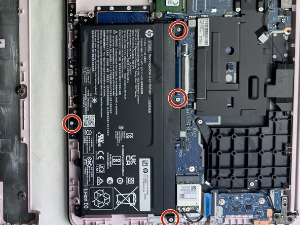

    • Place your opened laptop on a flat surface.
    • Use a Phillips #1 screwdriver to remove the four Phillips 3.0 mm screws securing the battery.

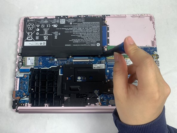

  7. HP 14-cf2112wm Battery Replacement: crwdns2935265:07crwdnd2935265:01crwdnd2935265:02crwdne2935265:0 HP 14-cf2112wm Battery Replacement: crwdns2935265:07crwdnd2935265:02crwdnd2935265:02crwdne2935265:0
    • Slide the battery out from the connector on the motherboard.
