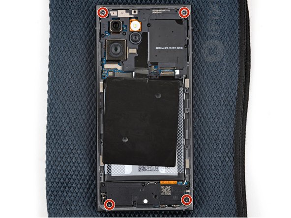

    1. HMD Skyline Screen Replacement, Remove the screen screws: crwdns2935265:06crwdnd2935265:01crwdnd2935265:03crwdne2935265:0 HMD Skyline Screen Replacement, Remove the screen screws: crwdns2935265:06crwdnd2935265:02crwdnd2935265:03crwdne2935265:0 HMD Skyline Screen Replacement, Remove the screen screws: crwdns2935265:06crwdnd2935265:03crwdnd2935265:03crwdne2935265:0
      • Use a T3 Torx screwdriver to remove the thirteen 4.9 mm‑long screws securing the screen to the frame.
      • These screws will be a different color or slightly different shade than the rest.

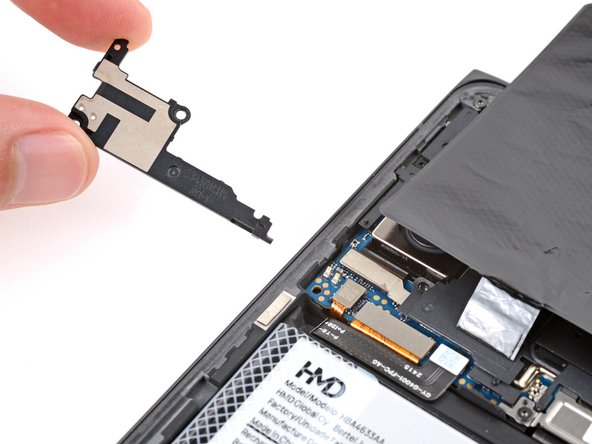

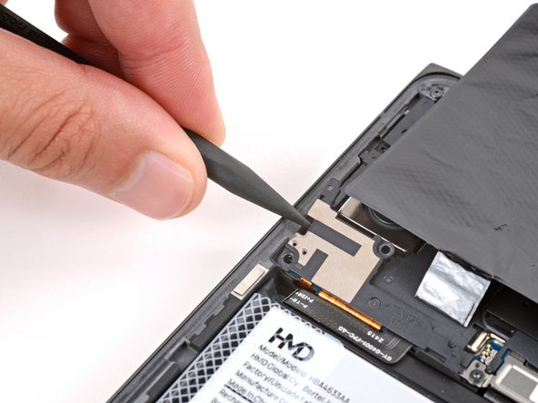

    3. HMD Skyline Screen Replacement, Disconnect the battery: crwdns2935265:08crwdnd2935265:01crwdnd2935265:03crwdne2935265:0 HMD Skyline Screen Replacement, Disconnect the battery: crwdns2935265:08crwdnd2935265:02crwdnd2935265:03crwdne2935265:0 HMD Skyline Screen Replacement, Disconnect the battery: crwdns2935265:08crwdnd2935265:03crwdnd2935265:03crwdne2935265:0
      • Insert the point of a spudger in the notch on the left edge of the battery connector cover and pry up to release its clips.
      • Only insert your tool enough to pry up the cover. Otherwise, you may accidentally disconnect the rear camera press connector.
      • Remove the cover.
      • During reassembly, firmly press the cover into place to engage the clips.

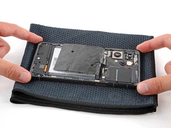

      • During reassembly:
      • Remove any tape or liners from the back of the screen—check the screen cable and front facing camera cutout.
      • Hold the frame in one hand and your replacement screen in the other.
      • Thread the screen cable through its cutout on the front of the frame and press the screen into place so it's flush in the frame.
      • Lay your phone screen side down on a soft cloth, making sure the screen doesn't detach from the frame.
      • Simultaneously press down on all four corners of your phone to fully seat the screen in the frame.
      • Use a T3 Torx screwdriver to install four screen screws in the corners of the frame—this ensures that the screen doesn't detach from the frame during reassembly.
      • If the screws aren't catching, double-check that the screen is fully seated.
