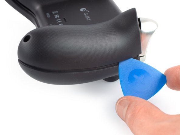

  2. GuliKit KingKong 2 Pro Battery Replacement, Insert an opening pick: crwdns2935265:02crwdnd2935265:01crwdnd2935265:02crwdne2935265:0 GuliKit KingKong 2 Pro Battery Replacement, Insert an opening pick: crwdns2935265:02crwdnd2935265:02crwdnd2935265:02crwdne2935265:0

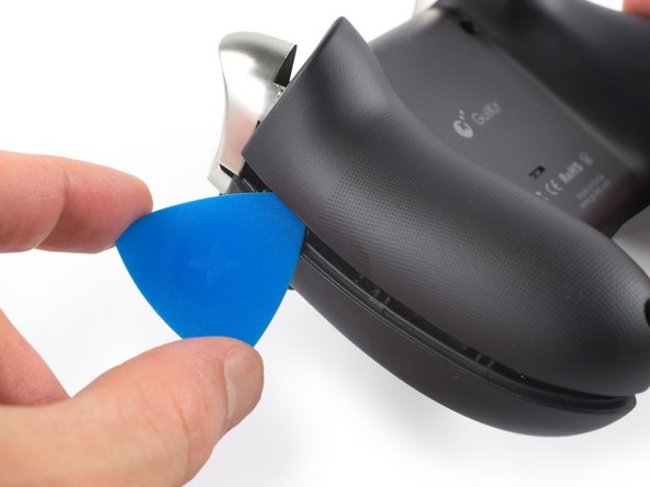

    • The back cover of the GuliKit Kingkong 2 Pro is held in place by plastic clips.
    • Insert an opening pick into the gap between the front assembly and the back cover at the bottom edge of the controller.
    • Tilt your opening pick downwards to widen the gap.

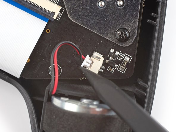

  6. GuliKit KingKong 2 Pro Battery Replacement, Disconnect the right vibration motor: crwdns2935265:06crwdnd2935265:01crwdnd2935265:03crwdne2935265:0 GuliKit KingKong 2 Pro Battery Replacement, Disconnect the right vibration motor: crwdns2935265:06crwdnd2935265:02crwdnd2935265:03crwdne2935265:0 GuliKit KingKong 2 Pro Battery Replacement, Disconnect the right vibration motor: crwdns2935265:06crwdnd2935265:03crwdnd2935265:03crwdne2935265:0

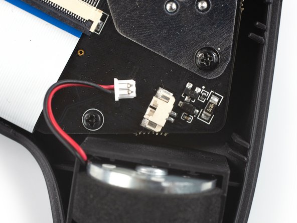

    • It's not mandatory to remove the two vibration motors to remove the mainboard assembly. However, other repairs become much easier with the motors removed. If you want to leave the motors in place, you can jump straight to step 9.
    • Pull on the connectors themselves and not the cables to avoid damaging them.
    • Use the point of a spudger to disconnect the right vibration motor by pushing the connector straight out of its socket.
    • If you can't disconnect the vibration motor with a spudger, use a pair of blunt nose tweezers to pull the connector out of its socket.

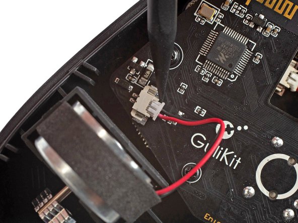

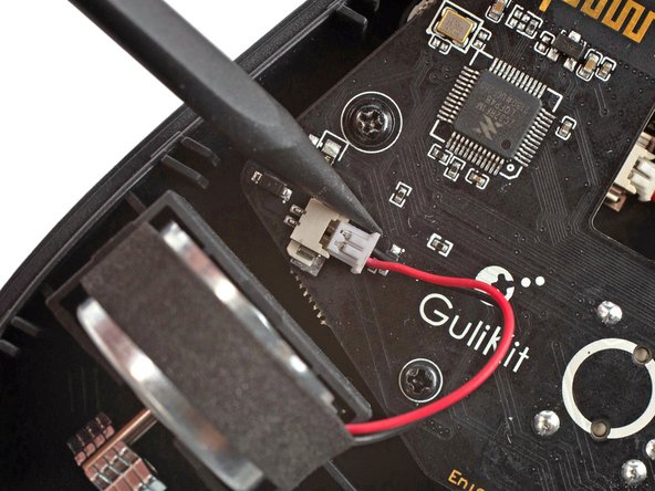

  7. GuliKit KingKong 2 Pro Battery Replacement, Disconnect the left vibration motor: crwdns2935265:07crwdnd2935265:01crwdnd2935265:03crwdne2935265:0 GuliKit KingKong 2 Pro Battery Replacement, Disconnect the left vibration motor: crwdns2935265:07crwdnd2935265:02crwdnd2935265:03crwdne2935265:0 GuliKit KingKong 2 Pro Battery Replacement, Disconnect the left vibration motor: crwdns2935265:07crwdnd2935265:03crwdnd2935265:03crwdne2935265:0
    • Use the point of a spudger to disconnect the left vibration motor by pushing the connector straight out of its socket.

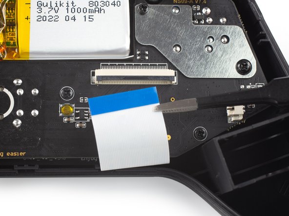

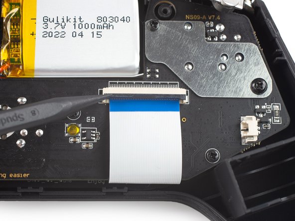

  9. GuliKit KingKong 2 Pro Battery Replacement, Release the interconnect cable ZIF connector: crwdns2935265:09crwdnd2935265:01crwdnd2935265:02crwdne2935265:0 GuliKit KingKong 2 Pro Battery Replacement, Release the interconnect cable ZIF connector: crwdns2935265:09crwdnd2935265:02crwdnd2935265:02crwdne2935265:0
    • Use a spudger, an opening tool, or your fingernail to flip up the small, hinged locking flap on the interconnect cable's ZIF connector.
  10. GuliKit KingKong 2 Pro Battery Replacement, Disconnect the interconnect cable: crwdns2935265:010crwdnd2935265:01crwdnd2935265:02crwdne2935265:0 GuliKit KingKong 2 Pro Battery Replacement, Disconnect the interconnect cable: crwdns2935265:010crwdnd2935265:02crwdnd2935265:02crwdne2935265:0
    • Use a pair of blunt nose tweezers to disconnect the interconnect cable by pulling the cable straight out of the connector.

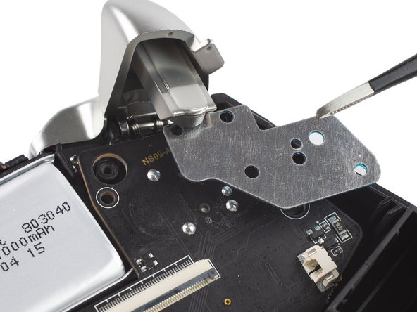

  12. GuliKit KingKong 2 Pro Battery Replacement, Remove the mainboard shield: crwdns2935265:012crwdnd2935265:01crwdnd2935265:02crwdne2935265:0 GuliKit KingKong 2 Pro Battery Replacement, Remove the mainboard shield: crwdns2935265:012crwdnd2935265:02crwdnd2935265:02crwdne2935265:0
    • Use a pair of blunt nose tweezers to remove the metal shield from the mainboard assembly.

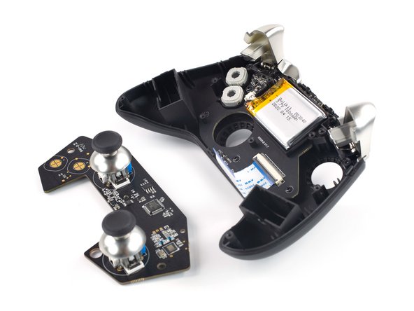

  13. GuliKit KingKong 2 Pro Battery Replacement, Remove the mainboard assembly: crwdns2935265:013crwdnd2935265:01crwdnd2935265:03crwdne2935265:0 GuliKit KingKong 2 Pro Battery Replacement, Remove the mainboard assembly: crwdns2935265:013crwdnd2935265:02crwdnd2935265:03crwdne2935265:0 GuliKit KingKong 2 Pro Battery Replacement, Remove the mainboard assembly: crwdns2935265:013crwdnd2935265:03crwdnd2935265:03crwdne2935265:0
    • Remove the mainboard assembly by lifting it out of the controller housing.

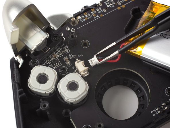

  16. GuliKit KingKong 2 Pro Battery Replacement, Disconnect the battery: crwdns2935265:016crwdnd2935265:01crwdnd2935265:02crwdne2935265:0 GuliKit KingKong 2 Pro Battery Replacement, Disconnect the battery: crwdns2935265:016crwdnd2935265:02crwdnd2935265:02crwdne2935265:0
    • Use a pair of blunt nose tweezers to disconnect the battery connector by pulling it straight out of its socket.
    • Remove the battery and its frame from the controller housing.

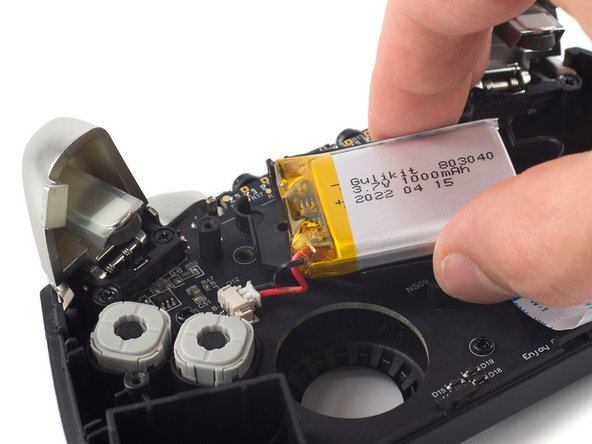

  17. GuliKit KingKong 2 Pro Battery Replacement, Loosen the battery adhesive: crwdns2935265:017crwdnd2935265:01crwdnd2935265:02crwdne2935265:0 GuliKit KingKong 2 Pro Battery Replacement, Loosen the battery adhesive: crwdns2935265:017crwdnd2935265:02crwdnd2935265:02crwdne2935265:0
    • The GuliKit KingKong 2 Pro battery is held in place by mild adhesive.
    • Apply a heated iOpener to the back of the battery frame for two minutes to loosen the adhesive underneath the battery.
    • A hair dryer, heat gun, or hot plate may also be used, but be careful not to overheat the battery.

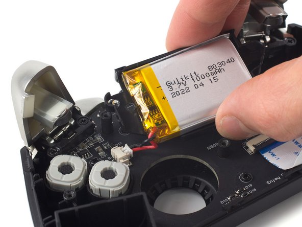

  18. GuliKit KingKong 2 Pro Battery Replacement, Remove the battery: crwdns2935265:018crwdnd2935265:01crwdnd2935265:02crwdne2935265:0 GuliKit KingKong 2 Pro Battery Replacement, Remove the battery: crwdns2935265:018crwdnd2935265:02crwdnd2935265:02crwdne2935265:0
    • Take care not to puncture or bend the battery with your tool—a punctured or bent battery may leak dangerous chemicals or cause a fire.
    • Insert an opening pick into the gap between the battery frame and the battery.
    • Slide the opening pick underneath the battery to cut the adhesive and pry it up.
    • Remove the battery.
    • Do not reinstall a damaged or deformed battery, as doing so is a potential safety hazard.
    • Secure the new battery with pre-cut adhesive or double-sided adhesive tape. In order to position it correctly, apply the new adhesive into the frame at the places where the old adhesive was located, not directly onto the battery. Press the new battery firmly into place.
