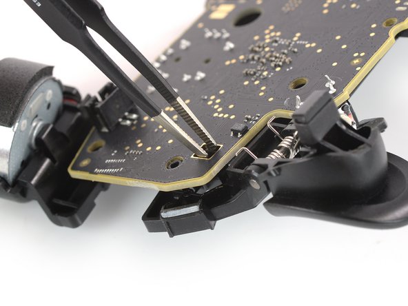

  28. Google Stadia Controller Motherboard Replacement, Free the motherboard clamps: crwdns2935265:028crwdnd2935265:01crwdnd2935265:03crwdne2935265:0 Google Stadia Controller Motherboard Replacement, Free the motherboard clamps: crwdns2935265:028crwdnd2935265:02crwdnd2935265:03crwdne2935265:0 Google Stadia Controller Motherboard Replacement, Free the motherboard clamps: crwdns2935265:028crwdnd2935265:03crwdnd2935265:03crwdne2935265:0
    • The motherboard is held onto the midframe by two tight plastic clamps which require a lot of force to press together.
    • Use a pair of tweezers to press both sides of the plastic clamp beneath the right trigger button together.
    • Slide the motherboard over the closed clamp.

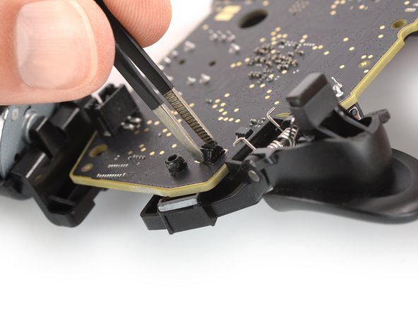

  29. Google Stadia Controller Motherboard Replacement: crwdns2935265:029crwdnd2935265:01crwdnd2935265:03crwdne2935265:0 Google Stadia Controller Motherboard Replacement: crwdns2935265:029crwdnd2935265:02crwdnd2935265:03crwdne2935265:0 Google Stadia Controller Motherboard Replacement: crwdns2935265:029crwdnd2935265:03crwdnd2935265:03crwdne2935265:0
    • Use a pair of tweezers to press both sides of the plastic clamp beneath the left trigger button together.
