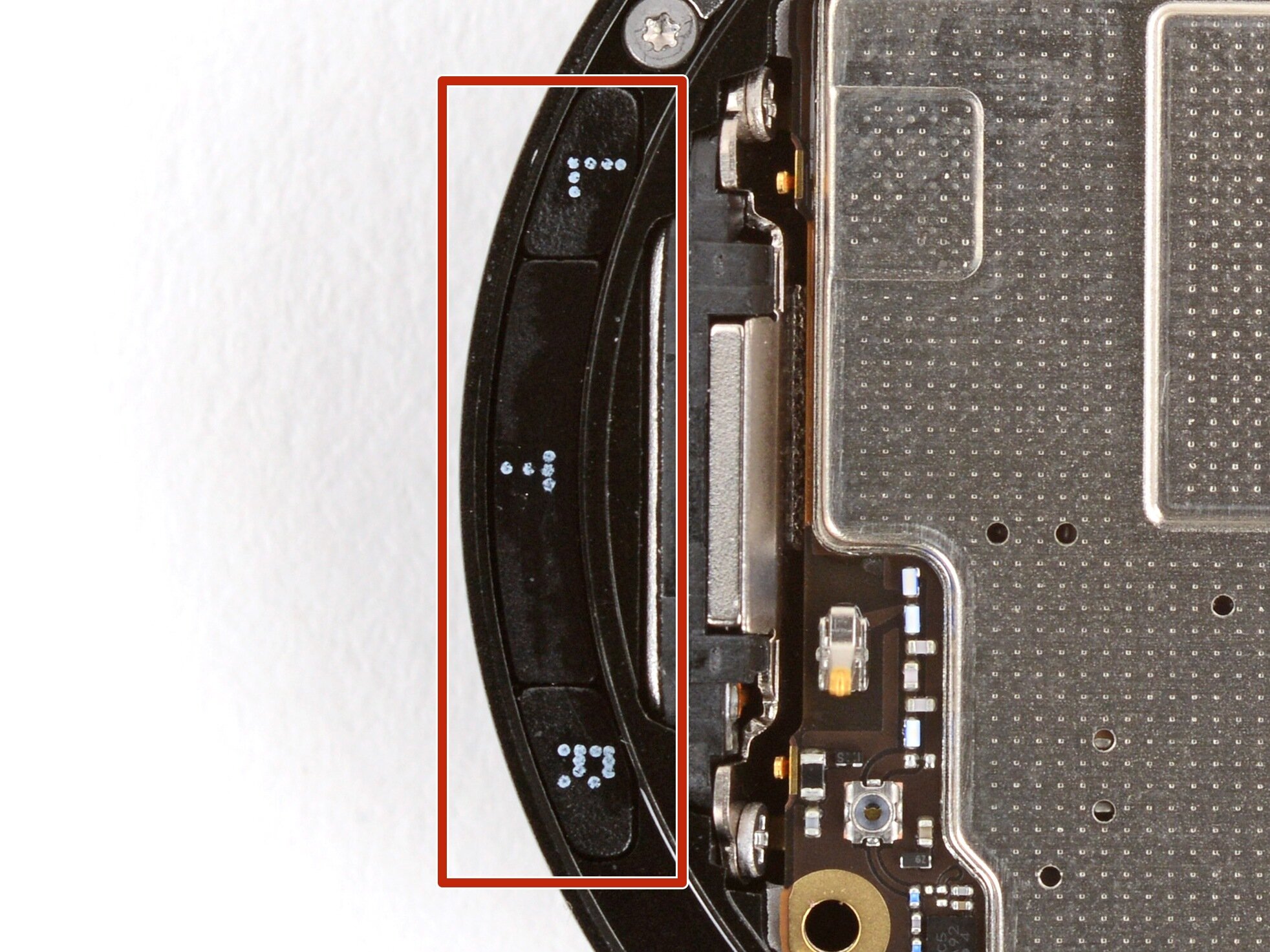

  21. Google Pixel Watch 4 Screen Replacement, O-ring installation: crwdns2935265:021crwdnd2935265:01crwdnd2935265:03crwdne2935265:0 Google Pixel Watch 4 Screen Replacement, O-ring installation: crwdns2935265:021crwdnd2935265:02crwdnd2935265:03crwdne2935265:0 Google Pixel Watch 4 Screen Replacement, O-ring installation: crwdns2935265:021crwdnd2935265:03crwdnd2935265:03crwdne2935265:0
    • If you plan to reuse the existing O-ring, be gentle when handling it—especially with sharp tweezers. Even a small indent may compromise the watch's water and dust resistance.
    • Use a pair of tweezers to remove the screen O‑ring—it will either be stuck to the frame or the underside of the screen.
    • If the O‑ring's groove is dirty or has gunk built up, apply a few drops of high‑concentration (>90%) isopropyl alcohol to a cotton swab and wipe it clean.
    • Avoid applying isopropyl alcohol to the magnetic strip on the side opposite the crown.
    • Place the new O‑ring loosely onto its lip on the frame.
    • Optionally, coat the O-ring in a small amount of O-ring-specific grease during installation.
    • Use your fingers to hold the O-ring in place and use a spudger to slide the opposite side up and over the lip until it seats in its groove.
    • Make sure the entire O‑ring is properly seated in its groove before continuing reassembly.
