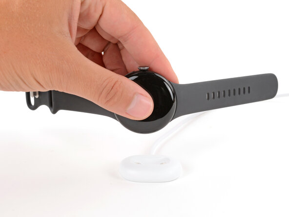

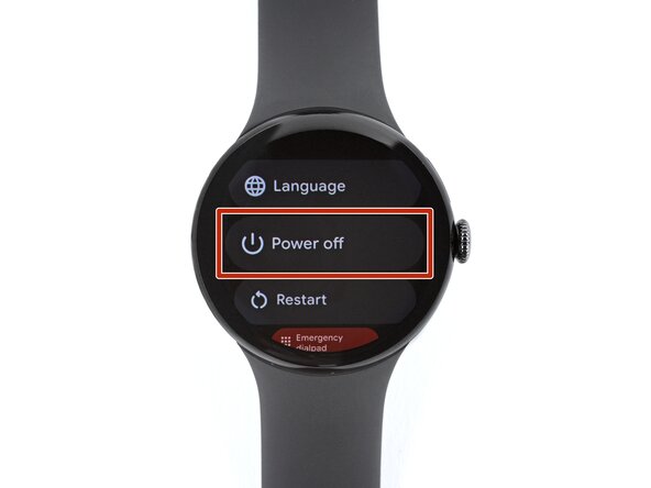

  1. Google Pixel Watch 4 Back Sensor Glass Replacement, Prepare your watch for disassembly: crwdns2935265:01crwdnd2935265:01crwdnd2935265:03crwdne2935265:0 Google Pixel Watch 4 Back Sensor Glass Replacement, Prepare your watch for disassembly: crwdns2935265:01crwdnd2935265:02crwdnd2935265:03crwdne2935265:0 Google Pixel Watch 4 Back Sensor Glass Replacement, Prepare your watch for disassembly: crwdns2935265:01crwdnd2935265:03crwdnd2935265:03crwdne2935265:0
    • Before starting your repair:
    • Remove your watch from the charger.
    • Press and hold the crown button, then tap Power off to shut down your watch.

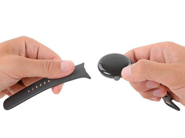

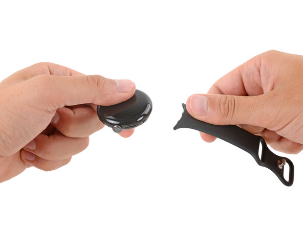

  2. Google Pixel Watch 4 Back Sensor Glass Replacement, Remove the watch bands: crwdns2935265:02crwdnd2935265:01crwdnd2935265:03crwdne2935265:0 Google Pixel Watch 4 Back Sensor Glass Replacement, Remove the watch bands: crwdns2935265:02crwdnd2935265:02crwdnd2935265:03crwdne2935265:0 Google Pixel Watch 4 Back Sensor Glass Replacement, Remove the watch bands: crwdns2935265:02crwdnd2935265:03crwdnd2935265:03crwdne2935265:0
    • Remove each watch band by depressing the release button and sliding the band out of its groove.

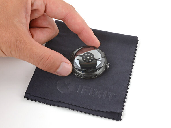

  3. Google Pixel Watch 4 Back Sensor Glass Replacement: crwdns2935265:03crwdnd2935265:01crwdnd2935265:01crwdne2935265:0
    • Throughout the rest of your repair, consider placing your watch on something soft like a clean cloth to help stabilize it and prevent scratches to the front glass.

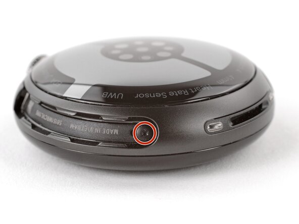

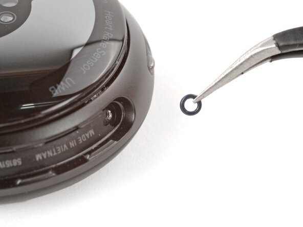

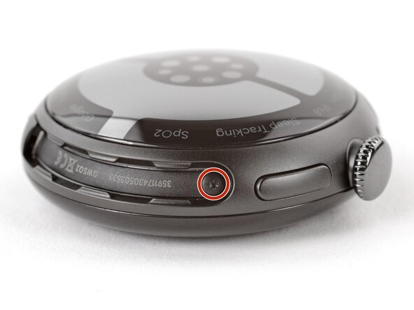

  4. Google Pixel Watch 4 Back Sensor Glass Replacement, Remove the back sensor glass screws: crwdns2935265:04crwdnd2935265:01crwdnd2935265:03crwdne2935265:0 Google Pixel Watch 4 Back Sensor Glass Replacement, Remove the back sensor glass screws: crwdns2935265:04crwdnd2935265:02crwdnd2935265:03crwdne2935265:0 Google Pixel Watch 4 Back Sensor Glass Replacement, Remove the back sensor glass screws: crwdns2935265:04crwdnd2935265:03crwdnd2935265:03crwdne2935265:0
    • Use a Torx Plus 2IP screwdriver to remove the 3.0 mm‑long screw from both watch band grooves (two screws total).
    • Both screws have a tiny O‑ring. If they don't lift away with the screw, use a pair of tweezers to carefully remove them from the band groove and set them aside. These O-rings are required to maintain waterproofing.
    • Handle these O-rings carefully. Avoid pinching or slicing them with your tool.
    • During reassembly:
    • Make sure the O‑rings are on the screws before installing them.
    • Push down firmly on the back glass while installing the screws to make sure the glass gets properly seated.
    • If there's a gap between the back glass and frame, remove the screws and reinstall them.

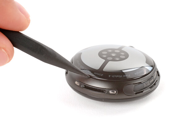

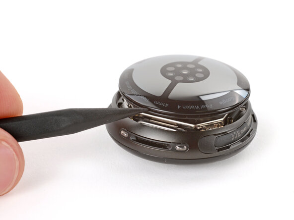

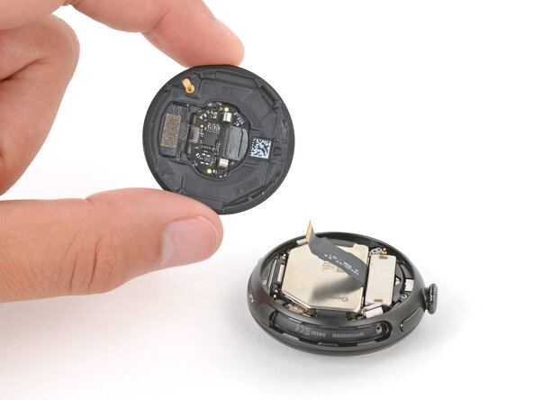

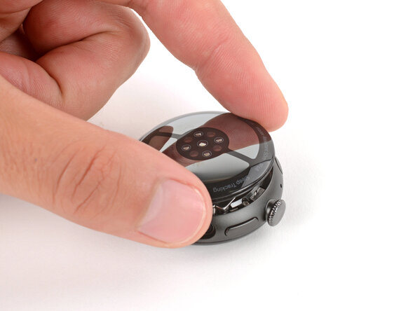

  5. Google Pixel Watch 4 Back Sensor Glass Replacement, Separate the back sensor glass: crwdns2935265:05crwdnd2935265:01crwdnd2935265:02crwdne2935265:0 Google Pixel Watch 4 Back Sensor Glass Replacement, Separate the back sensor glass: crwdns2935265:05crwdnd2935265:02crwdnd2935265:02crwdne2935265:0
    • Insert the point of a spudger (or a clean fingernail) into the seam between the back sensor glass and frame and pry up until the cover detaches.

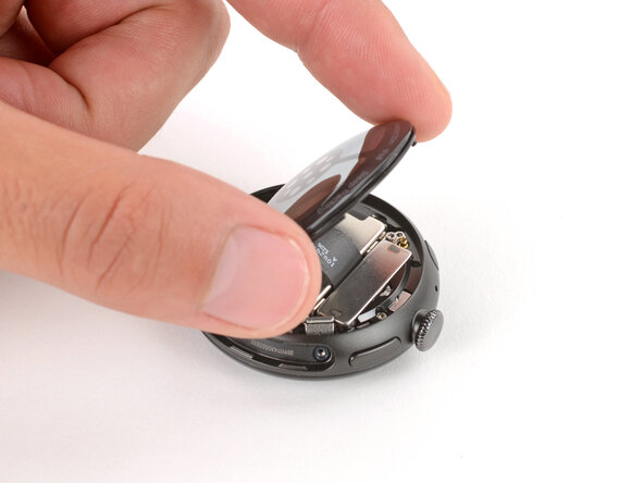

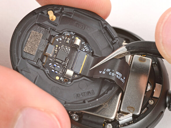

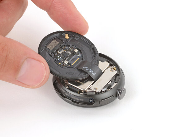

  6. Google Pixel Watch 4 Back Sensor Glass Replacement, Reposition the back sensor glass: crwdns2935265:06crwdnd2935265:01crwdnd2935265:03crwdne2935265:0 Google Pixel Watch 4 Back Sensor Glass Replacement, Reposition the back sensor glass: crwdns2935265:06crwdnd2935265:02crwdnd2935265:03crwdne2935265:0 Google Pixel Watch 4 Back Sensor Glass Replacement, Reposition the back sensor glass: crwdns2935265:06crwdnd2935265:03crwdnd2935265:03crwdne2935265:0
    • Gently lift the back glass and flip it over the side of the watch opposite the crown.
    • Be careful not to strain the cable connecting the back sensor glass.

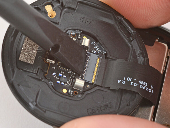

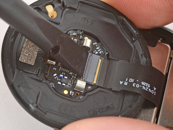

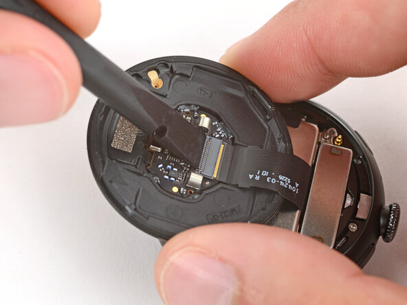

  7. Google Pixel Watch 4 Back Sensor Glass Replacement, Disconnect the back sensor glass: crwdns2935265:07crwdnd2935265:01crwdnd2935265:03crwdne2935265:0 Google Pixel Watch 4 Back Sensor Glass Replacement, Disconnect the back sensor glass: crwdns2935265:07crwdnd2935265:02crwdnd2935265:03crwdne2935265:0 Google Pixel Watch 4 Back Sensor Glass Replacement, Disconnect the back sensor glass: crwdns2935265:07crwdnd2935265:03crwdnd2935265:03crwdne2935265:0
    • Use a spudger to lift the small, hinged locking‑flap on the back sensor glass ZIF connector.

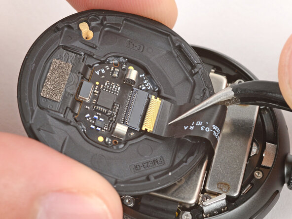

  8. Google Pixel Watch 4 Back Sensor Glass Replacement, Remove the back sensor glass: crwdns2935265:08crwdnd2935265:01crwdnd2935265:03crwdne2935265:0 Google Pixel Watch 4 Back Sensor Glass Replacement, Remove the back sensor glass: crwdns2935265:08crwdnd2935265:02crwdnd2935265:03crwdne2935265:0 Google Pixel Watch 4 Back Sensor Glass Replacement, Remove the back sensor glass: crwdns2935265:08crwdnd2935265:03crwdnd2935265:03crwdne2935265:0
    • Gently slide the cable out of its socket and remove the back sensor glass.
    • During reassembly, make sure the locking flap is lifted before sliding the cable fully into its connector—it should snap into place.
