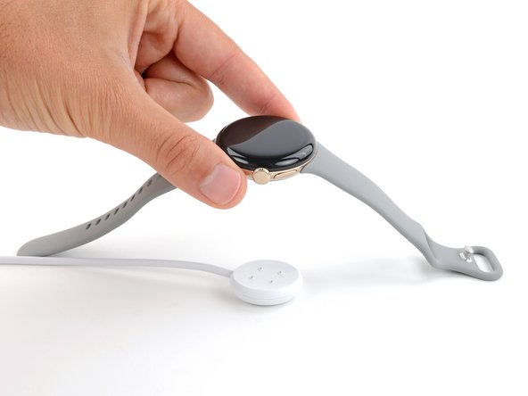

  1. Google Pixel Watch 2 Screen Replacement, Prepare your watch for disassembly: crwdns2935265:01crwdnd2935265:01crwdnd2935265:02crwdne2935265:0 Google Pixel Watch 2 Screen Replacement, Prepare your watch for disassembly: crwdns2935265:01crwdnd2935265:02crwdnd2935265:02crwdne2935265:0
    • Before starting this repair, remove your watch from the charger and let its battery drain completely—the watch should shut down from low battery. A charged lithium‑ion battery may catch fire if damaged.
    • Letting the battery drain completely also prevents accidentally turning your watch back on when gripping it during repair.

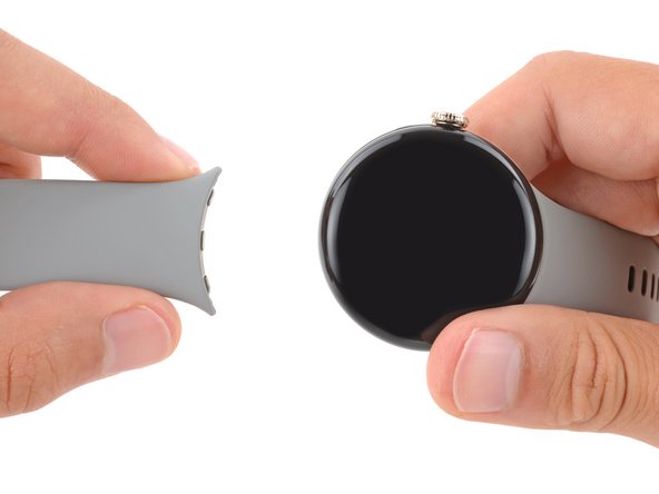

  2. Google Pixel Watch 2 Screen Replacement, Remove both watch bands: crwdns2935265:02crwdnd2935265:01crwdnd2935265:02crwdne2935265:0 Google Pixel Watch 2 Screen Replacement, Remove both watch bands: crwdns2935265:02crwdnd2935265:02crwdnd2935265:02crwdne2935265:0
    • Remove both watch bands by pressing the release button and sliding the band out of its groove.

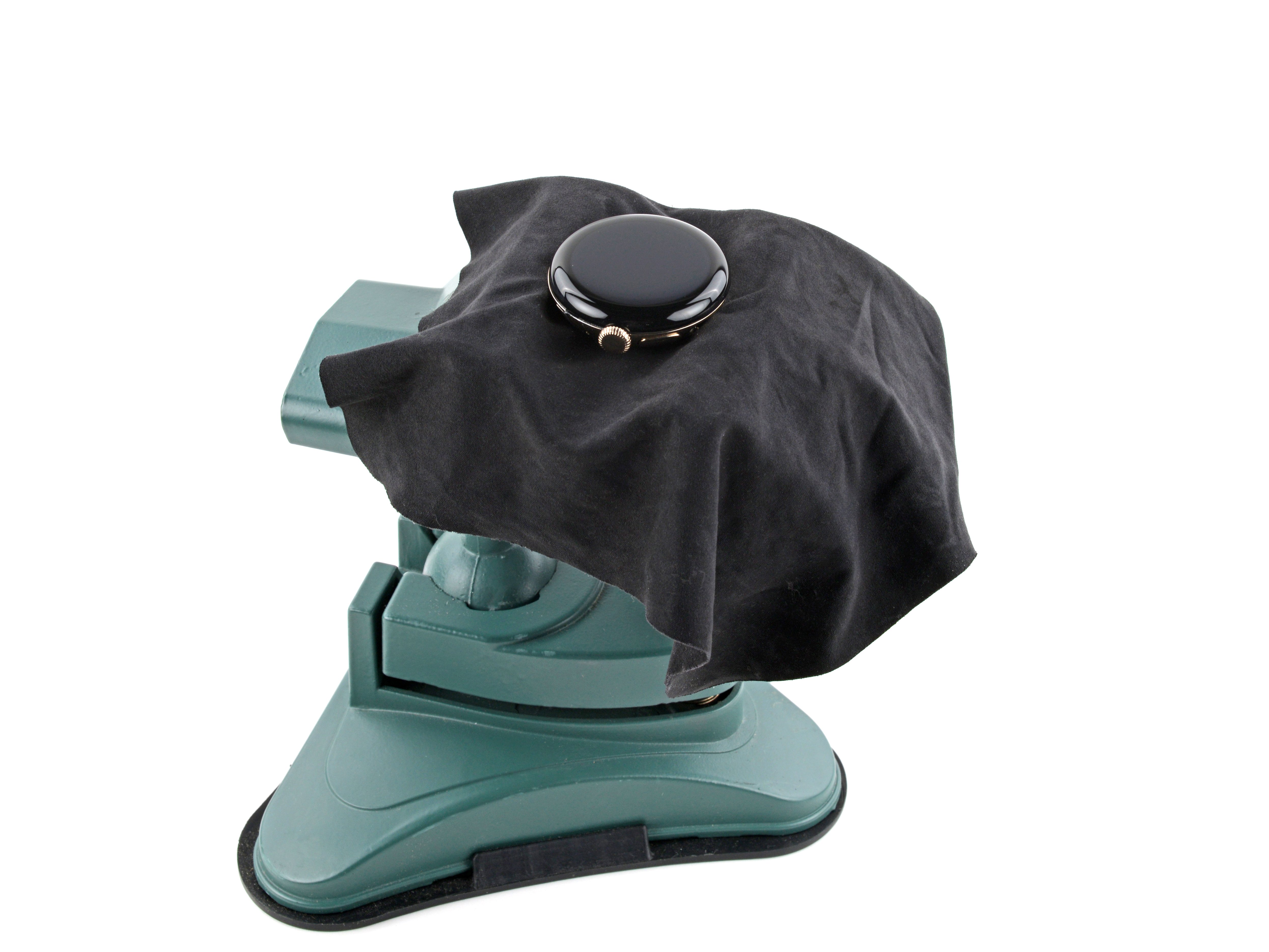

  3. Google Pixel Watch 2 Screen Replacement, Put your watch in the vise: crwdns2935265:03crwdnd2935265:01crwdnd2935265:01crwdne2935265:0
    • Inserting a tool between the screen and frame is very difficult. Using a vise to secure the frame makes it significantly easier.
    • Secure your watch with a small vise so the jaws go into the watch band grooves on the frame.
    • If your vice has sharp or metal jaws, consider wrapping the frame in a thin cloth to prevent scratching or damaging the frame.

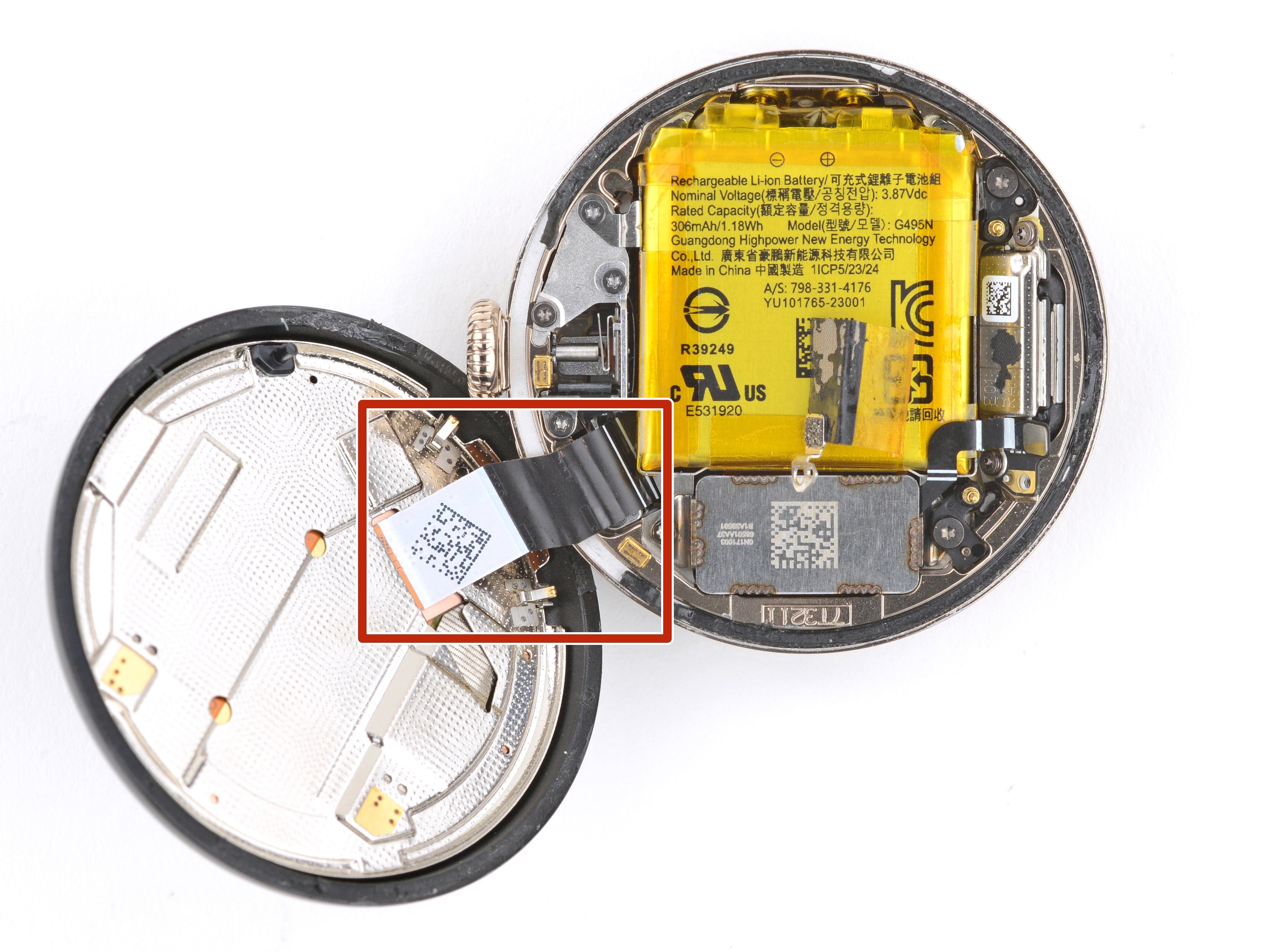

  10. Google Pixel Watch 2 Screen Replacement, Swing open the screen: crwdns2935265:010crwdnd2935265:01crwdnd2935265:03crwdne2935265:0 Google Pixel Watch 2 Screen Replacement, Swing open the screen: crwdns2935265:010crwdnd2935265:02crwdnd2935265:03crwdne2935265:0 Google Pixel Watch 2 Screen Replacement, Swing open the screen: crwdns2935265:010crwdnd2935265:03crwdnd2935265:03crwdne2935265:0
    E6000 Adhesive Glue
    $2.99
    • Be careful not to strain the screen cable during the rest of your repair.
    • Swing open the screen and put it in an upright position next to the watch crown.
    • If the screen feels stuck, go back around the perimeter and carefully separate any remaining adhesive with the iFlex. Be very careful not to damage the screen cable near the crown.

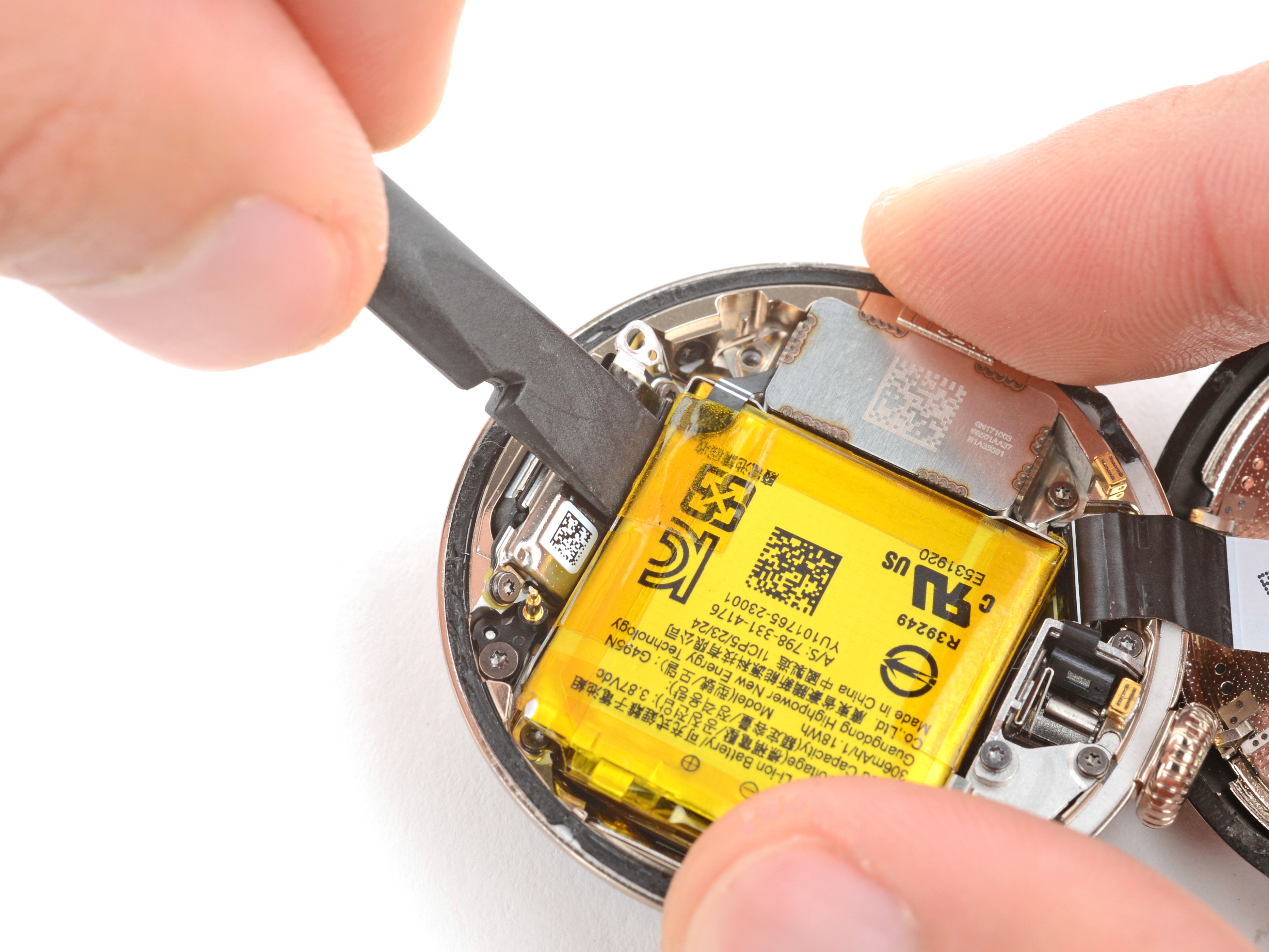

  19. Google Pixel Watch 2 Screen Replacement, Pry up the battery: crwdns2935265:019crwdnd2935265:01crwdnd2935265:02crwdne2935265:0 Google Pixel Watch 2 Screen Replacement, Pry up the battery: crwdns2935265:019crwdnd2935265:02crwdnd2935265:02crwdne2935265:0
    • Light adhesive secures the battery in place.
    • Insert the flat end of a spudger under the top edge of the battery.
    • Pry the battery up to separate the adhesive.
    • Don't try to remove the battery yet, as it's still connected to the watch with a delicate cable.
