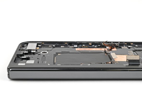

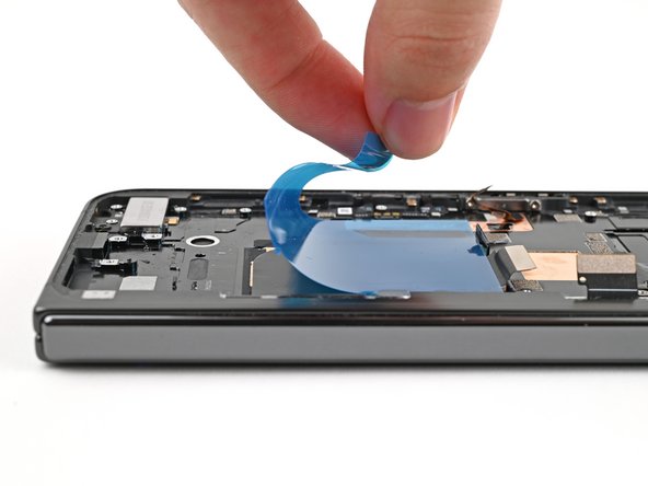

  31. Google Pixel 9 Pro Fold Inner Screen Asssembly Replacement, Remove the graphite sheet: crwdns2935265:031crwdnd2935265:01crwdnd2935265:02crwdne2935265:0 Google Pixel 9 Pro Fold Inner Screen Asssembly Replacement, Remove the graphite sheet: crwdns2935265:031crwdnd2935265:02crwdnd2935265:02crwdne2935265:0
    • Peel the graphite sheet off the bottom speaker to separate the adhesive securing it.
  32. Google Pixel 9 Pro Fold Inner Screen Asssembly Replacement: crwdns2935265:032crwdnd2935265:01crwdnd2935265:03crwdne2935265:0 Google Pixel 9 Pro Fold Inner Screen Asssembly Replacement: crwdns2935265:032crwdnd2935265:02crwdnd2935265:03crwdne2935265:0 Google Pixel 9 Pro Fold Inner Screen Asssembly Replacement: crwdns2935265:032crwdnd2935265:03crwdnd2935265:03crwdne2935265:0
    • Continue peeling the graphite sheet off the logic board to separate the remaining adhesive.
  33. Google Pixel 9 Pro Fold Inner Screen Asssembly Replacement, Disconnect the side buttons: crwdns2935265:033crwdnd2935265:01crwdnd2935265:02crwdne2935265:0 Google Pixel 9 Pro Fold Inner Screen Asssembly Replacement, Disconnect the side buttons: crwdns2935265:033crwdnd2935265:02crwdnd2935265:02crwdne2935265:0
    • Use tweezers, or your fingers, to peel off the yellow tape on the side button cable ZIF connector.
    • Set the tape aside. You'll need it during reassembly.

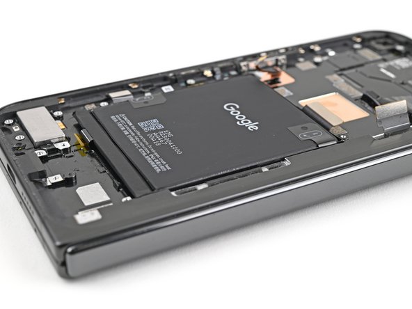

  37. Google Pixel 9 Pro Fold Inner Screen Asssembly Replacement, Remove the logic board screws: crwdns2935265:037crwdnd2935265:01crwdnd2935265:02crwdne2935265:0 Google Pixel 9 Pro Fold Inner Screen Asssembly Replacement, Remove the logic board screws: crwdns2935265:037crwdnd2935265:02crwdnd2935265:02crwdne2935265:0
    • Use a Torx Plus 3IP driver to remove the three screws securing the logic board:
    • One 2.2 mm‑long screw
    • Two 2.6 mm‑long screws

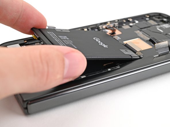

  38. Google Pixel 9 Pro Fold Inner Screen Asssembly Replacement, Remove the logic board: crwdns2935265:038crwdnd2935265:01crwdnd2935265:03crwdne2935265:0 Google Pixel 9 Pro Fold Inner Screen Asssembly Replacement, Remove the logic board: crwdns2935265:038crwdnd2935265:02crwdnd2935265:03crwdne2935265:0 Google Pixel 9 Pro Fold Inner Screen Asssembly Replacement, Remove the logic board: crwdns2935265:038crwdnd2935265:03crwdnd2935265:03crwdne2935265:0
    • Insert the flat end of a spudger under the top left corner of the logic board, next to the inner front camera cutout.
    • You might feel some resistance since the logic board is bonded to the frame by thermal paste.
    • Pry up the logic board enough so you can grip the top edge with your fingers.
  39. Google Pixel 9 Pro Fold Inner Screen Asssembly Replacement: crwdns2935265:039crwdnd2935265:01crwdnd2935265:03crwdne2935265:0 Google Pixel 9 Pro Fold Inner Screen Asssembly Replacement: crwdns2935265:039crwdnd2935265:02crwdnd2935265:03crwdne2935265:0 Google Pixel 9 Pro Fold Inner Screen Asssembly Replacement: crwdns2935265:039crwdnd2935265:03crwdnd2935265:03crwdne2935265:0
    • Lift the top of the logic board out of the frame and remove it.
    • Lay down the logic board upside down on a clean surface.

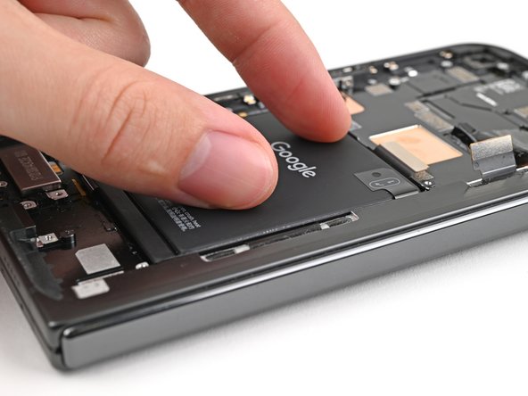

  43. Google Pixel 9 Pro Fold Inner Screen Asssembly Replacement, Separate the cable adhesive: crwdns2935265:043crwdnd2935265:01crwdnd2935265:03crwdne2935265:0 Google Pixel 9 Pro Fold Inner Screen Asssembly Replacement, Separate the cable adhesive: crwdns2935265:043crwdnd2935265:02crwdnd2935265:03crwdne2935265:0 Google Pixel 9 Pro Fold Inner Screen Asssembly Replacement, Separate the cable adhesive: crwdns2935265:043crwdnd2935265:03crwdnd2935265:03crwdne2935265:0
    • Slide one arm of a pair of angled tweezers under the contact pad connected to the loudspeaker.
    • Take care not to puncture the battery—it can leak dangerous chemicals and/or catch fire.
    • Lift the contact pad to separate the adhesive securing it to the frame.

    • Use your fingers to peel both edges of the flip battery pull tabs off the battery.
  84. Google Pixel 9 Pro Fold Inner Screen Asssembly Replacement: crwdns2935265:084crwdnd2935265:01crwdnd2935265:01crwdne2935265:0
    • Unfold your phone and flip it so the inner screen is facing upward.
    • Use a hair dryer, or a heat gun, to heat the section of inner screen behind the flip battery (the side with the SIM card cutout) until it's barely too hot to touch.
    • Don't heat the screen longer than 30 seconds, as it's susceptible to heat damage.
  85. Google Pixel 9 Pro Fold Inner Screen Asssembly Replacement: crwdns2935265:085crwdnd2935265:01crwdnd2935265:03crwdne2935265:0 Google Pixel 9 Pro Fold Inner Screen Asssembly Replacement: crwdns2935265:085crwdnd2935265:02crwdnd2935265:03crwdne2935265:0 Google Pixel 9 Pro Fold Inner Screen Asssembly Replacement: crwdns2935265:085crwdnd2935265:03crwdnd2935265:03crwdne2935265:0
    • Fold your phone and turn it so the flip battery is facing up.
    • Pull up on alternating sides of the pull tab to slice through the adhesive on the upper half of the flip battery, stopping once you get to the top edge.
    • Try to not lose one of the sides of the pull tab under the battery. If you do, don't worry! Move to the next step for an alternate method to remove the battery.
  86. Google Pixel 9 Pro Fold Inner Screen Asssembly Replacement, Apply isopropyl alcohol: crwdns2935265:086crwdnd2935265:01crwdnd2935265:02crwdne2935265:0 Google Pixel 9 Pro Fold Inner Screen Asssembly Replacement, Apply isopropyl alcohol: crwdns2935265:086crwdnd2935265:02crwdnd2935265:02crwdne2935265:0
    • The remaining adhesive is extremely strong. To avoid bending the battery, the next three steps show how to use isopropyl alcohol and a suction handle to remove it.
    • Apply a few drops of isopropyl alcohol (>90%) under the bottom edge of the flip battery.
  87. Google Pixel 9 Pro Fold Inner Screen Asssembly Replacement: crwdns2935265:087crwdnd2935265:01crwdnd2935265:02crwdne2935265:0 Google Pixel 9 Pro Fold Inner Screen Asssembly Replacement: crwdns2935265:087crwdnd2935265:02crwdnd2935265:02crwdne2935265:0
    • Lift the bottom edge of the phone to let the isopropyl alcohol flow under the battery.
    • Wait one minute for the alcohol to soften the adhesive.
  88. Google Pixel 9 Pro Fold Inner Screen Asssembly Replacement, Remove the flip battery: crwdns2935265:088crwdnd2935265:01crwdnd2935265:03crwdne2935265:0 Google Pixel 9 Pro Fold Inner Screen Asssembly Replacement, Remove the flip battery: crwdns2935265:088crwdnd2935265:02crwdnd2935265:03crwdne2935265:0 Google Pixel 9 Pro Fold Inner Screen Asssembly Replacement, Remove the flip battery: crwdns2935265:088crwdnd2935265:03crwdnd2935265:03crwdne2935265:0
    • Apply a suction handle to the center of the flip battery.
    • While securing the phone with one hand, pull up on the suction cup with strong, steady force to separate the flip battery from the frame.
    • If the flip battery doesn't budge after applying constant pressure, apply more isopropyl alcohol and try again.
    • Remove the flip battery.

  96. Google Pixel 9 Pro Fold Inner Screen Asssembly Replacement, Apply the new adhesive: crwdns2935265:096crwdnd2935265:01crwdnd2935265:03crwdne2935265:0 Google Pixel 9 Pro Fold Inner Screen Asssembly Replacement, Apply the new adhesive: crwdns2935265:096crwdnd2935265:02crwdnd2935265:03crwdne2935265:0 Google Pixel 9 Pro Fold Inner Screen Asssembly Replacement, Apply the new adhesive: crwdns2935265:096crwdnd2935265:03crwdnd2935265:03crwdne2935265:0
    • The adhesives for the flip battery cable and connector are separate from the main adhesive strip.
    • Place the flip battery cable and connector adhesives over the frame, using the white outlines to confirm their orientation.
    • The clear liners should face the frame.
    • Peel the adhesive strips off their liners and place them over their respective spots on the frame.

    • Use the pull tab to peel the colored liner off to expose the adhesive.
  101. Google Pixel 9 Pro Fold Inner Screen Asssembly Replacement: crwdns2935265:0101crwdnd2935265:01crwdnd2935265:02crwdne2935265:0 Google Pixel 9 Pro Fold Inner Screen Asssembly Replacement: crwdns2935265:0101crwdnd2935265:02crwdnd2935265:02crwdne2935265:0
    • Peel off the colored liners on the flip battery cable and connector adhesive.
  102. Google Pixel 9 Pro Fold Inner Screen Asssembly Replacement, Secure the flip battery: crwdns2935265:0102crwdnd2935265:01crwdnd2935265:02crwdne2935265:0 Google Pixel 9 Pro Fold Inner Screen Asssembly Replacement, Secure the flip battery: crwdns2935265:0102crwdnd2935265:02crwdnd2935265:02crwdne2935265:0
    • Align the top edge of the flip battery with the top edge of the battery well.
    • Lay the battery over the frame.
  103. Google Pixel 9 Pro Fold Inner Screen Asssembly Replacement: crwdns2935265:0103crwdnd2935265:01crwdnd2935265:03crwdne2935265:0 Google Pixel 9 Pro Fold Inner Screen Asssembly Replacement: crwdns2935265:0103crwdnd2935265:02crwdnd2935265:03crwdne2935265:0 Google Pixel 9 Pro Fold Inner Screen Asssembly Replacement: crwdns2935265:0103crwdnd2935265:03crwdnd2935265:03crwdne2935265:0
    • Press down along the perimeter of the flip battery to adhere it to the frame.
    • Press down the flip battery cable and its connector to adhere it.

  167. Google Pixel 9 Pro Fold Inner Screen Asssembly Replacement, Apply the new graphite sheet: crwdns2935265:0167crwdnd2935265:01crwdnd2935265:03crwdne2935265:0 Google Pixel 9 Pro Fold Inner Screen Asssembly Replacement, Apply the new graphite sheet: crwdns2935265:0167crwdnd2935265:02crwdnd2935265:03crwdne2935265:0 Google Pixel 9 Pro Fold Inner Screen Asssembly Replacement, Apply the new graphite sheet: crwdns2935265:0167crwdnd2935265:03crwdnd2935265:03crwdne2935265:0
    • Peel the clear liner off your replacement graphite sheet to expose the adhesive on the upper half.
    • Align the upper half of the graphite sheet over the logic board and lay it down.
  168. Google Pixel 9 Pro Fold Inner Screen Asssembly Replacement: crwdns2935265:0168crwdnd2935265:01crwdnd2935265:02crwdne2935265:0 Google Pixel 9 Pro Fold Inner Screen Asssembly Replacement: crwdns2935265:0168crwdnd2935265:02crwdnd2935265:02crwdne2935265:0
    • Use your finger to press down the upper half of the graphite sheet and secure it to the logic board.
  169. Google Pixel 9 Pro Fold Inner Screen Asssembly Replacement: crwdns2935265:0169crwdnd2935265:01crwdnd2935265:02crwdne2935265:0 Google Pixel 9 Pro Fold Inner Screen Asssembly Replacement: crwdns2935265:0169crwdnd2935265:02crwdnd2935265:02crwdne2935265:0
    • Remove the blue liner from the bottom of the graphite sheet to expose the adhesive underneath.
  170. Google Pixel 9 Pro Fold Inner Screen Asssembly Replacement: crwdns2935265:0170crwdnd2935265:01crwdnd2935265:03crwdne2935265:0 Google Pixel 9 Pro Fold Inner Screen Asssembly Replacement: crwdns2935265:0170crwdnd2935265:02crwdnd2935265:03crwdne2935265:0 Google Pixel 9 Pro Fold Inner Screen Asssembly Replacement: crwdns2935265:0170crwdnd2935265:03crwdnd2935265:03crwdne2935265:0
    • Drag your finger from the middle section of the graphite sheet to the adhesive spot on the loudspeaker to flatten the graphite sheet and adhere it.
  171. Google Pixel 9 Pro Fold Inner Screen Asssembly Replacement: crwdns2935265:0171crwdnd2935265:01crwdnd2935265:03crwdne2935265:0 Google Pixel 9 Pro Fold Inner Screen Asssembly Replacement: crwdns2935265:0171crwdnd2935265:02crwdnd2935265:03crwdne2935265:0 Google Pixel 9 Pro Fold Inner Screen Asssembly Replacement: crwdns2935265:0171crwdnd2935265:03crwdnd2935265:03crwdne2935265:0
    • Grip the pull tab at the top of the graphite sheet and peel off the remaining liner.
