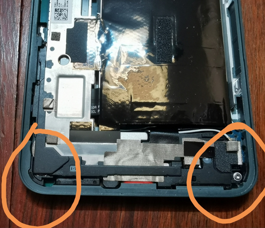

    True, but one may be disassembling the device prior to receiving their replacement 😉
    Niels Klassen -
    I'm not sure why it's recommended to pry at the bezel seam. I followed this guide but the bezel that's held in by clips, provides some additional housing for the front facing camera as well as the ear-speaker grille. I ended up separating the old screen from the bezel and putting the bezel back into the phone first, before installing the replacement screen.
    Kevin Kim - crwdns2934203:0crwdne2934203:0
    My replacement screen did not come with the bezel, and I had to remove it from the old screen. I didn't notice this until i attempted to replace the screen. Be sure to look at your replacement screen prior to reassembly. It will save you some heartache. All was good though and the phone is working.

    Do we use the suction cup before inserting the picks? After applying the I opener 3 plus times, I am having difficulty removing the broken screen. Any tips?
    William Maniss - crwdns2934203:0crwdne2934203:0
    This was the most difficult part. What really helped was putting a piece of packing tape on the screen. It has to be wider than the suction cup. If there is any hint of a crack where the suction cup is located, it will not stick. I had to warm the right side and the top a couple of times to get the screen to give a little bit. It will only give just a little bit and you have to to slide the pick in with more force than I was comfortable with.. It really would help to have a third hand to hold the phone, pull the suction cup and the other to slide the pick in. I had to use my ring finger to apply force to the suction cup and with the same hand slide the pick between the phone and the screen. After this step it was easy peasy!
    Dustin Ashberry - crwdns2934203:0crwdne2934203:0
    Agree this was the hardest part. I heated the right edge of the phone multiple times with the iOpener before the glue was soft enough to flex. My screen only had a crack, was not shattered. I had to wet the suction cup to get it to hold strong enough to pull up to open a gap to insert the pick. Once the first pick was in, heating the other edges and moving around the phone was fairly easy.
    Lisa McManis - crwdns2934203:0crwdne2934203:0
    The screen itself has a large lip that makes it harder to insert the picks. what worked for me was pulling up the screen just enough to insert the pick slightly. next I rotated the pick towards the phone and pushed it down (the phones chassis has a bezel that will catch the tip so you can use a bit more force). Once the pick is inserted like that you can rotate away from the phone, pulling up the screen easily.
    Mason Tate - crwdns2934203:0crwdne2934203:0
    Ended up using Gorilla tape on the screen, a more powerful suction cup from a windshield phone mount, moving it back 1/2 inch from the edge so the tape wouldn't peel from the edge when I pulled.
    Scott Chaney - crwdns2934203:0crwdne2934203:0
    You definitely need a third hand to get the pick in, have someone nearby to help if possible.

    This was by far the most difficult part of the repair hands down. I heated the phone several times before the adhesive softened enough to stick a pick in
    Niels Klassen - crwdns2934203:0crwdne2934203:0
    I was unable to use the technique shown here to lift up the edge. I used the iOpener and suction cup multiple times without being able to lift the edge even a little (might be a testament to my own physical weakness, though, haha). I ended up running a razor blade along the bezel seam until I was able to wiggle it in and then slowly wedge the picks in.
    Mary in CA - crwdns2934203:0crwdne2934203:0
    This took me an 1.5 hrs. Just keep re-heating and re-applying the iOpener, and using your spudger to open it up. Don't give up! You got this!
    ccc - crwdns2934203:0crwdne2934203:0

    This was the most tedious part for me when reassembling. I used the gold colored corners on the board to line up the connector. Also, I recommend using your finger and not the spudger for pressing down when you reattach (even if you don't have small hands); this helps you feel the slight click when it's in place.
    Additionally, you can use the suction cup as a sort of kickstand so you have enough ribbon cable to work with (because there's not a lot.)
    Lol No - crwdns2934203:0crwdne2934203:0
    Just successfully completed my screen replacement & agree with the comments above. This guide would be improved if there was a close-up picture showing the gold alignment marks. Sorry, I would have posted a picture of this myself, but my phone was being operated on at the time. LoL
    CRAIG MCKAY - crwdns2934203:0crwdne2934203:0
    Operation success! Had some trouble when disconnecting and removing the old screen because I didn't know how much range I had when opening it up like a book. Ended up bending the connector on the old screen and bent the connector on the motherboard a little. Be very careful when opening up the screen while the screen is still attached to the frame. Only open it up like 30 degrees at first to see what the cable is doing and how much slack you have.
    This led to me trying to straighten out the pins on the motherboard connector for like 3 painstaking hours because every time I tried to insert the new connector by clicking down on one side at a time it kept popping up on the opposite end and shifting up/down a little bit. Assumed the pins were still misaligned with the screen connector and eventually got frustrated enough to just push down the connector in the middle, which explicitly contradicts the instructions. The connector still popped off with some light pressure but I just put the bracket on & it all works!
    A Husk - crwdns2934203:0crwdne2934203:0
    Reattaching the cable was definitely the hardest part. I've only done this once before but that time there was a much more tangible sensation when all was attached. No matter how carefully I lined things up inside the golden corners it just didn't seem to be clicking as expected. I finally thought I got it so I put the metal cover back and hoped for the best.
    Bonus fun - the "remove this last" plastic that covered the pre-cut adhesive came up with the blue plastic sheet, so I was working around exposed adhesive. I kept a piece of stiff plastic over that and tried not let the phone get glued back together and in the end it worked.
    I wish I'd got a 2nd sheet of adhesive in case once reassembled it turned out the little pins had not connected well enough - I didn't know if it would be ok to start it up again before actually pressing things together. Would that have messed with the calibration? Would be nice to know if I coud have tested the connection and then squeezed it all shut.
    Determined, but distracted - crwdns2934203:0crwdne2934203:0
    Yes, the attaching of the cable is the hardest part. Mine never really stayed , so I did what the determined person before me did: Put the metal part on top and hope for the best.
    I used my fingers to tell if it was on top and also made sure that the square was aligned with the gold corners on the phone.
    You definitely need a second person to hold a light and the screen while you do everything. I couldn’t have finished otherwise.
    It works!!!! I’m so happy 😀 Good luck!

Hi there, everything went well thanks to the kit and the well-made guide until two unexpected little black plastic parts dropped out of nowhere on the table while I was cleaning the edge with ethanol. 1 appr. 5mm in length with a slight arc and the second appr. 8mm in length with a quarter arc and a thin extension on one end. Unfortunately I could not figure out, what those two parts might be. From first an second looks and comparing to the pictures above I could not work out where those might belong and whether the are important. I would appreciate, if someone was able to tell me, whether to ignore those two plastic pieces or what else to do with them before reassembly. Thank You :-)
csm1103 - crwdns2934203:0crwdne2934203:0
the parts look like this: https://i.postimg.cc/fL96fC0t/aa44b1a8-6...
and here is another (maybe more enlightening) picture: https://i.postimg.cc/763KLW2V/629cf7d4-c...
csm1103 -
Hi, in case anyone wonders: I solved the topic by looking at the other repair-descriptions for the Pixel 5a. Those two plastic pieces belong in the lower left and right corners (left: larger one - right: smaller one): if You turn the opened phone upside done (I did it while cleaning and talking at the same time), they just fall out. Maybe this can be added to the instructions. After this the repair was pretty straight forward except for the the connector with which I struggled at least 5 minutes before using a second pair of hands to hold the display while I was connecting it. Thank You again.
