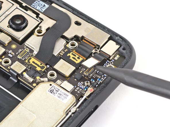

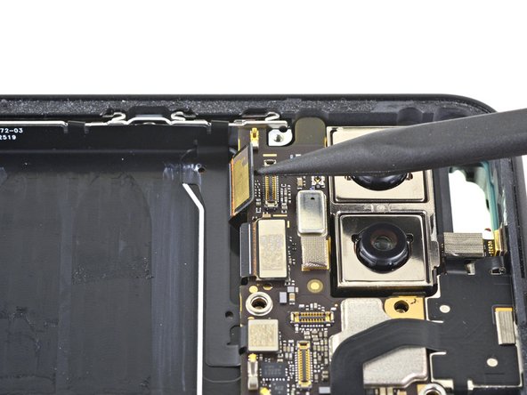

  27. Google Pixel 4 Side Buttons Replacement, Disconnect the camera and sensor connectors: crwdns2935265:027crwdnd2935265:01crwdnd2935265:03crwdne2935265:0 Google Pixel 4 Side Buttons Replacement, Disconnect the camera and sensor connectors: crwdns2935265:027crwdnd2935265:02crwdnd2935265:03crwdne2935265:0 Google Pixel 4 Side Buttons Replacement, Disconnect the camera and sensor connectors: crwdns2935265:027crwdnd2935265:03crwdnd2935265:03crwdne2935265:0
    • Using the pointed end of a spudger, pry the camera and sensor connectors straight up from the motherboard.

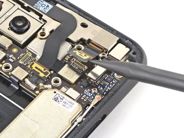

  28. Google Pixel 4 Side Buttons Replacement: crwdns2935265:028crwdnd2935265:01crwdnd2935265:02crwdne2935265:0 Google Pixel 4 Side Buttons Replacement: crwdns2935265:028crwdnd2935265:02crwdnd2935265:02crwdne2935265:0
    • Disconnect the additional sensor connector.

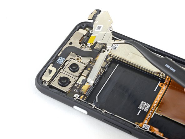

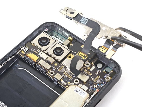

  29. Google Pixel 4 Side Buttons Replacement, Remove the front-facing camera and sensor assembly: crwdns2935265:029crwdnd2935265:01crwdnd2935265:01crwdne2935265:0
    • Use a T3 Torx driver to remove the two 2.4 mm screws securing the front camera and sensor assembly.
  30. Google Pixel 4 Side Buttons Replacement: crwdns2935265:030crwdnd2935265:01crwdnd2935265:02crwdne2935265:0 Google Pixel 4 Side Buttons Replacement: crwdns2935265:030crwdnd2935265:02crwdnd2935265:02crwdne2935265:0
    • Use a pair of tweezers to remove the front camera and sensor assembly.

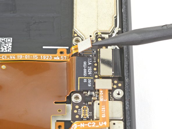

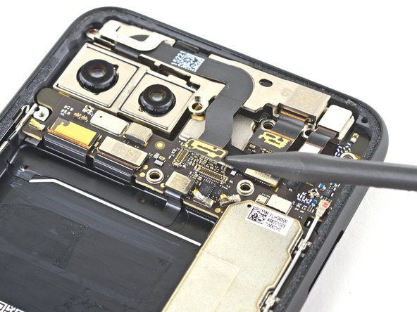

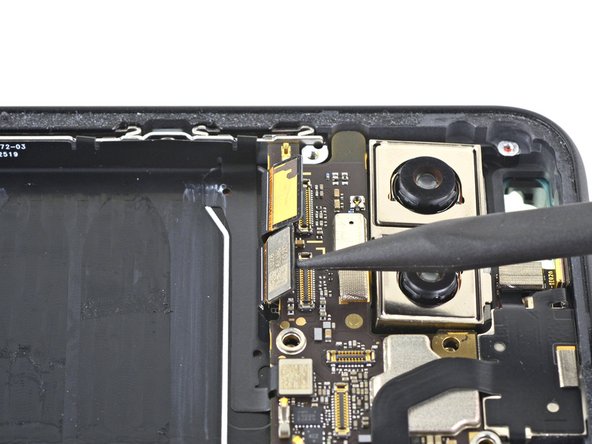

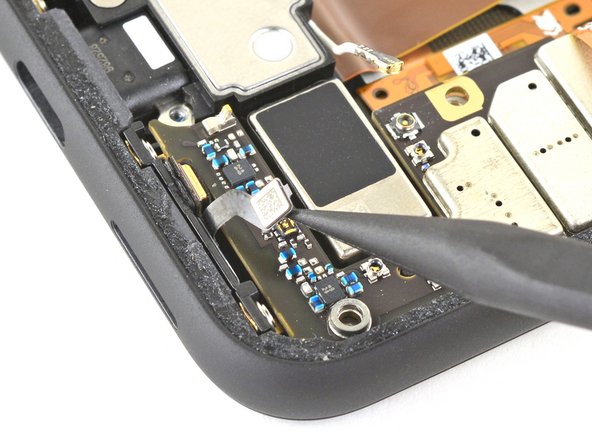

  33. Google Pixel 4 Side Buttons Replacement, Disconnect the motherboard press connectors: crwdns2935265:033crwdnd2935265:01crwdnd2935265:03crwdne2935265:0 Google Pixel 4 Side Buttons Replacement, Disconnect the motherboard press connectors: crwdns2935265:033crwdnd2935265:02crwdnd2935265:03crwdne2935265:0 Google Pixel 4 Side Buttons Replacement, Disconnect the motherboard press connectors: crwdns2935265:033crwdnd2935265:03crwdnd2935265:03crwdne2935265:0
    • Use the pointed end of a spudger to disconnect the two rear-facing camera connectors from the motherboard.
    • Disconnect the side buttons connector from the motherboard.

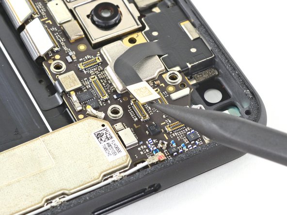

  34. Google Pixel 4 Side Buttons Replacement: crwdns2935265:034crwdnd2935265:01crwdnd2935265:02crwdne2935265:0 Google Pixel 4 Side Buttons Replacement: crwdns2935265:034crwdnd2935265:02crwdnd2935265:02crwdne2935265:0
    • Disconnect the earpiece speaker connector from the motherboard.

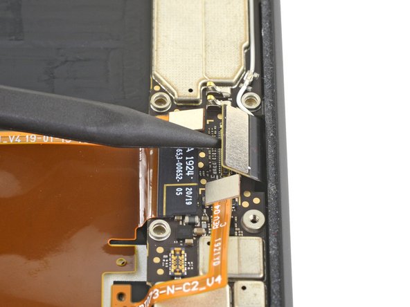

  35. Google Pixel 4 Side Buttons Replacement: crwdns2935265:035crwdnd2935265:01crwdnd2935265:03crwdne2935265:0 Google Pixel 4 Side Buttons Replacement: crwdns2935265:035crwdnd2935265:02crwdnd2935265:03crwdne2935265:0 Google Pixel 4 Side Buttons Replacement: crwdns2935265:035crwdnd2935265:03crwdnd2935265:03crwdne2935265:0
    • Disconnect the left grip sensor connector from the motherboard.
    • Disconnect the charge port connector from the motherboard.

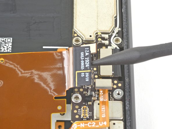

  36. Google Pixel 4 Side Buttons Replacement: crwdns2935265:036crwdnd2935265:01crwdnd2935265:02crwdne2935265:0 Google Pixel 4 Side Buttons Replacement: crwdns2935265:036crwdnd2935265:02crwdnd2935265:02crwdne2935265:0
    • Disconnect the right grip sensor connector from the motherboard.
    • Disconnect the display connector from the motherboard.

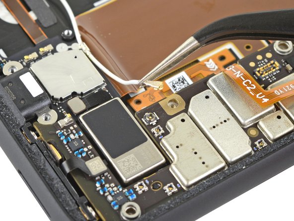

  37. Google Pixel 4 Side Buttons Replacement: crwdns2935265:037crwdnd2935265:01crwdnd2935265:02crwdne2935265:0 Google Pixel 4 Side Buttons Replacement: crwdns2935265:037crwdnd2935265:02crwdnd2935265:02crwdne2935265:0
    • Use a pair of tweezers to disconnect the antenna connector from the charging assembly by pulling it straight up from the motherboard.
  38. Google Pixel 4 Side Buttons Replacement: crwdns2935265:038crwdnd2935265:01crwdnd2935265:02crwdne2935265:0 Google Pixel 4 Side Buttons Replacement: crwdns2935265:038crwdnd2935265:02crwdnd2935265:02crwdne2935265:0
    • Disconnect the bottom microphone connector from the motherboard.

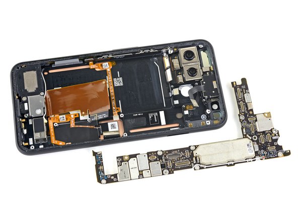

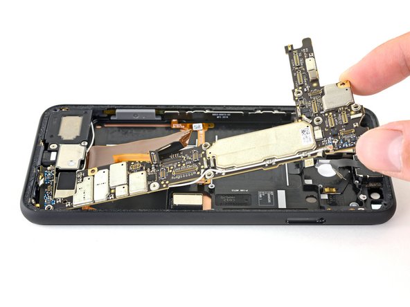

  39. Google Pixel 4 Side Buttons Replacement, Remove the motherboard: crwdns2935265:039crwdnd2935265:01crwdnd2935265:03crwdne2935265:0 Google Pixel 4 Side Buttons Replacement, Remove the motherboard: crwdns2935265:039crwdnd2935265:02crwdnd2935265:03crwdne2935265:0 Google Pixel 4 Side Buttons Replacement, Remove the motherboard: crwdns2935265:039crwdnd2935265:03crwdnd2935265:03crwdne2935265:0
    • Slowly lift out the motherboard, being careful not to snag any ribbon cable connectors.
    • The rear-facing camera module connectors loop around the motherboard, and the camera module is not secured to the phone, so it may lift out with the motherboard during this step.
    • Completely remove the motherboard.
    • When reinstalling the motherboard, check that no ribbon cable connectors are caught underneath.

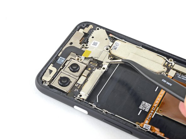

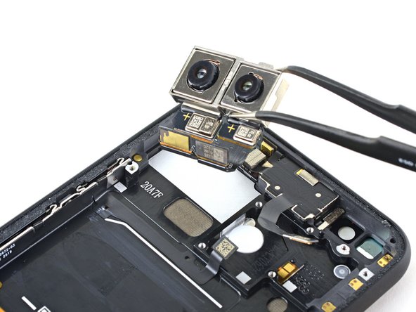

  40. Google Pixel 4 Side Buttons Replacement, Remove the rear-facing camera module: crwdns2935265:040crwdnd2935265:01crwdnd2935265:02crwdne2935265:0 Google Pixel 4 Side Buttons Replacement, Remove the rear-facing camera module: crwdns2935265:040crwdnd2935265:02crwdnd2935265:02crwdne2935265:0
    • Use a pair of tweezers to remove the rear-facing camera module.

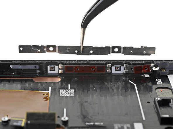

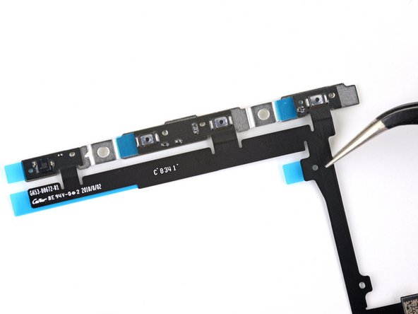

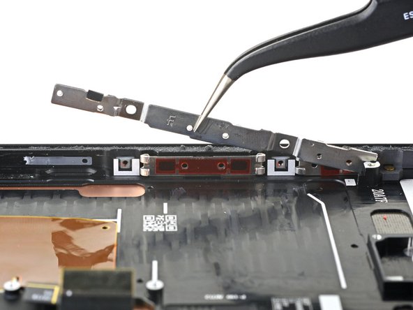

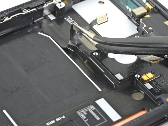

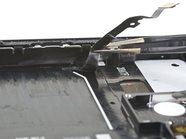

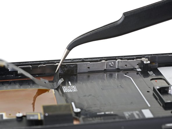

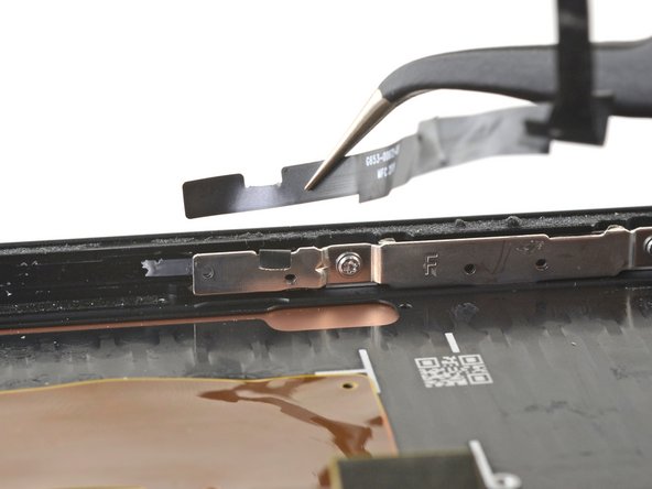

  41. Google Pixel 4 Side Buttons Replacement, Remove the side button flex cable: crwdns2935265:041crwdnd2935265:01crwdnd2935265:02crwdne2935265:0 Google Pixel 4 Side Buttons Replacement, Remove the side button flex cable: crwdns2935265:041crwdnd2935265:02crwdnd2935265:02crwdne2935265:0
    • Use a pair of tweezers to peel the side button flex cable off of the phone's frame. It is secured with some light adhesive.
  42. Google Pixel 4 Side Buttons Replacement: crwdns2935265:042crwdnd2935265:01crwdnd2935265:02crwdne2935265:0 Google Pixel 4 Side Buttons Replacement: crwdns2935265:042crwdnd2935265:02crwdnd2935265:02crwdne2935265:0
    • Continue peeling the flex cable until it is no longer adhered to the back side of the phone.
  43. Google Pixel 4 Side Buttons Replacement: crwdns2935265:043crwdnd2935265:01crwdnd2935265:02crwdne2935265:0 Google Pixel 4 Side Buttons Replacement: crwdns2935265:043crwdnd2935265:02crwdnd2935265:02crwdne2935265:0
    • Use a pair of tweezers to peel away the side button flex cable from the button bracket, on the inside edge of the phone's frame.
    • This process is destructive, so proceed with caution, and have a replacement part ready.
    • Continue to peel away the flex cable until it is no longer adhered to the button bracket.
  44. Google Pixel 4 Side Buttons Replacement: crwdns2935265:044crwdnd2935265:01crwdnd2935265:02crwdne2935265:0 Google Pixel 4 Side Buttons Replacement: crwdns2935265:044crwdnd2935265:02crwdnd2935265:02crwdne2935265:0
    • With the side button flex cable peeled away from the button bracket, completely remove it.
    • The flex may come out in multiple pieces or rip, so make sure there's nothing left behind.
  45. Google Pixel 4 Side Buttons Replacement, Remove the button bracket: crwdns2935265:045crwdnd2935265:01crwdnd2935265:01crwdne2935265:0
    • Use a T3 Torx driver to remove the two 2.4 mm screws securing the button bracket to the frame.
  46. Google Pixel 4 Side Buttons Replacement: crwdns2935265:046crwdnd2935265:01crwdnd2935265:03crwdne2935265:0 Google Pixel 4 Side Buttons Replacement: crwdns2935265:046crwdnd2935265:02crwdnd2935265:03crwdne2935265:0 Google Pixel 4 Side Buttons Replacement: crwdns2935265:046crwdnd2935265:03crwdnd2935265:03crwdne2935265:0
    • Use a pair of tweezers to remove the button bracket.

    • The side button flex cable is adhered to both sides of the button bracket.
    • Using a pair of tweezers, peel away leftover flex cable that's adhered to the back side of the button bracket.
    • The cable is in multiple pieces, so make sure there's nothing left behind.
    • Remove any leftover adhesive before reinstalling a new grip sensor.
