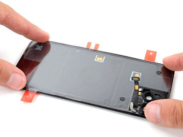

  3. How to Replace the Back Panel Adhesive on Your Google Pixel 4, Orient the adhesive: crwdns2935265:03crwdnd2935265:01crwdnd2935265:01crwdne2935265:0
    • Before peeling off any liners, lay the new adhesive down on the back panel and use the camera cutout to find its proper orientation.

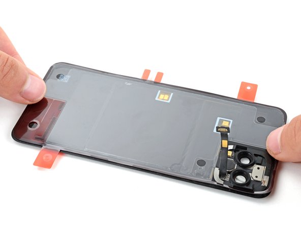

  5. How to Replace the Back Panel Adhesive on Your Google Pixel 4, Apply the adhesive: crwdns2935265:05crwdnd2935265:01crwdnd2935265:03crwdne2935265:0 How to Replace the Back Panel Adhesive on Your Google Pixel 4, Apply the adhesive: crwdns2935265:05crwdnd2935265:02crwdnd2935265:03crwdne2935265:0 How to Replace the Back Panel Adhesive on Your Google Pixel 4, Apply the adhesive: crwdns2935265:05crwdnd2935265:03crwdnd2935265:03crwdne2935265:0
    • Be very careful during this step! The adhesive is very sticky, and once it touches the back panel you won't be able to reposition it. Misaligned adhesive can lead to an improper seal.
    • When laying down the adhesive, make sure the back panel connector cable is threaded through the camera cutout. If the adhesive sticks to the cable, you'll have to restart the repair with new adhesive.
    • With the adhesive in its proper orientation, lay it sticky side down on the back panel.
    • Press down firmly around the perimeter of the back panel, ensuring all the adhesive is secured.

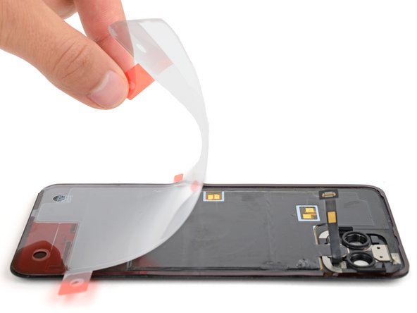

  6. How to Replace the Back Panel Adhesive on Your Google Pixel 4: crwdns2935265:06crwdnd2935265:01crwdnd2935265:02crwdne2935265:0 How to Replace the Back Panel Adhesive on Your Google Pixel 4: crwdns2935265:06crwdnd2935265:02crwdnd2935265:02crwdne2935265:0
    • Use the pull tabs to remove all remaining liners from the adhesive.

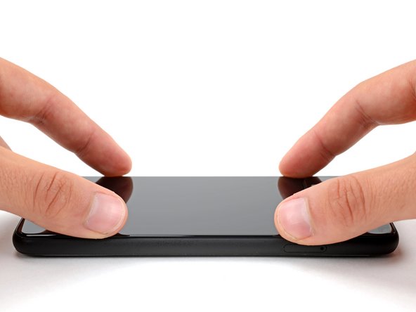

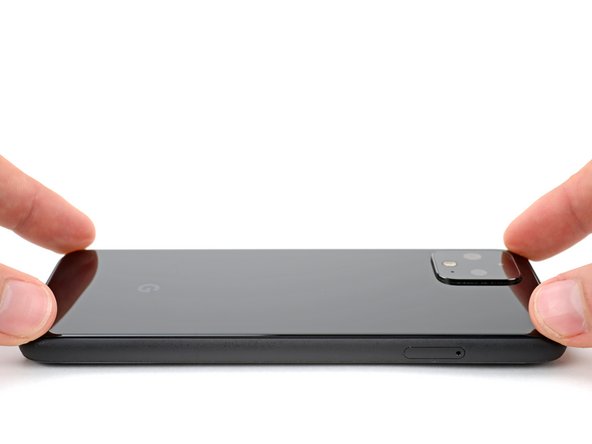

  8. How to Replace the Back Panel Adhesive on Your Google Pixel 4: crwdns2935265:08crwdnd2935265:01crwdnd2935265:03crwdne2935265:0 How to Replace the Back Panel Adhesive on Your Google Pixel 4: crwdns2935265:08crwdnd2935265:02crwdnd2935265:03crwdne2935265:0 How to Replace the Back Panel Adhesive on Your Google Pixel 4: crwdns2935265:08crwdnd2935265:03crwdnd2935265:03crwdne2935265:0
    • Align the back panel over the back of the phone and lay it down.
    • Secure the back panel by firmly pressing along its perimeter for one minute.
