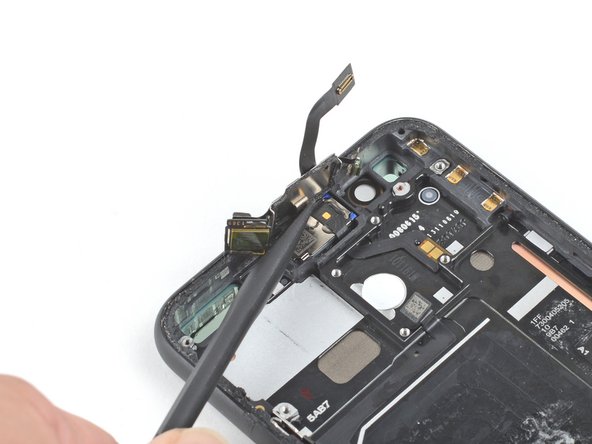

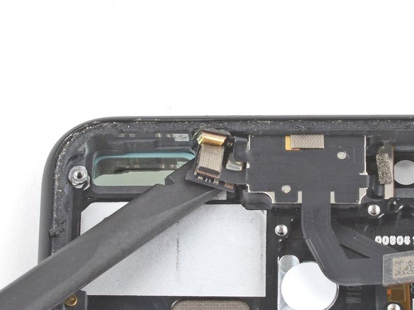

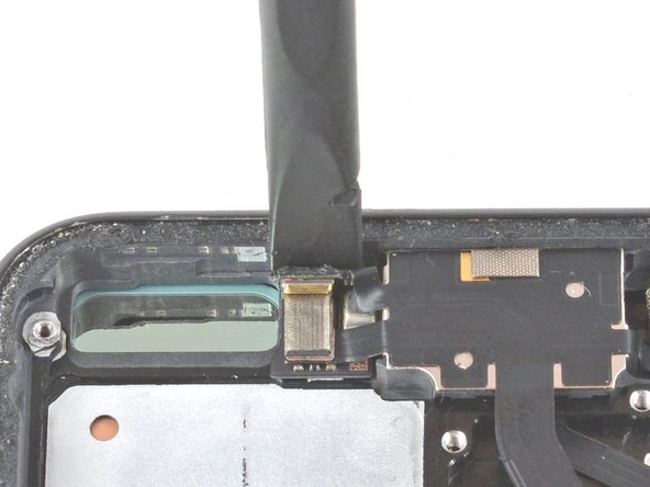

    3. Google Pixel 4 Screen Replacement, Disconnect the camera and sensor connectors: crwdns2935265:027crwdnd2935265:01crwdnd2935265:03crwdne2935265:0 Google Pixel 4 Screen Replacement, Disconnect the camera and sensor connectors: crwdns2935265:027crwdnd2935265:02crwdnd2935265:03crwdne2935265:0 Google Pixel 4 Screen Replacement, Disconnect the camera and sensor connectors: crwdns2935265:027crwdnd2935265:03crwdnd2935265:03crwdne2935265:0
      • Using the pointed end of a spudger, pry the camera and sensor connectors straight up from the motherboard.

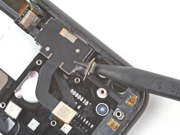

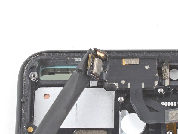

    4. Google Pixel 4 Screen Replacement: crwdns2935265:028crwdnd2935265:01crwdnd2935265:02crwdne2935265:0 Google Pixel 4 Screen Replacement: crwdns2935265:028crwdnd2935265:02crwdnd2935265:02crwdne2935265:0
      • Disconnect the additional sensor connector.

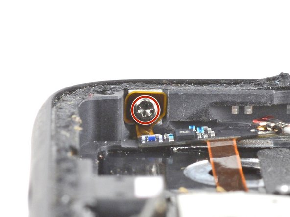

    5. Google Pixel 4 Screen Replacement, Remove the front-facing camera and sensor assembly: crwdns2935265:029crwdnd2935265:01crwdnd2935265:01crwdne2935265:0
      • Use a T3 Torx driver to remove the two 2.4 mm screws securing the front camera and sensor assembly.

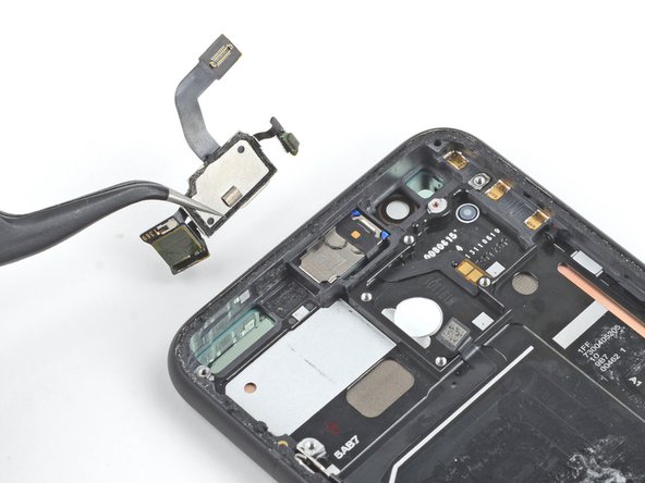

    6. Google Pixel 4 Screen Replacement: crwdns2935265:030crwdnd2935265:01crwdnd2935265:02crwdne2935265:0 Google Pixel 4 Screen Replacement: crwdns2935265:030crwdnd2935265:02crwdnd2935265:02crwdne2935265:0
      • Use a pair of tweezers to remove the front camera and sensor assembly.

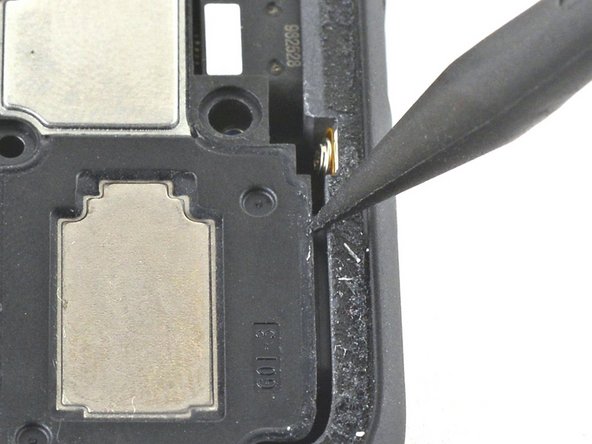

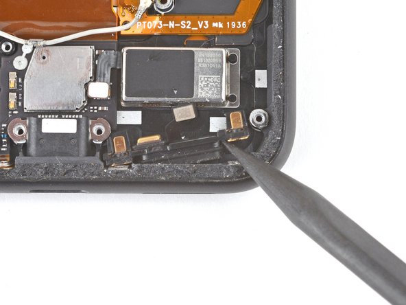

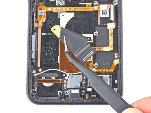

    9. Google Pixel 4 Screen Replacement, Disconnect the motherboard press connectors: crwdns2935265:033crwdnd2935265:01crwdnd2935265:03crwdne2935265:0 Google Pixel 4 Screen Replacement, Disconnect the motherboard press connectors: crwdns2935265:033crwdnd2935265:02crwdnd2935265:03crwdne2935265:0 Google Pixel 4 Screen Replacement, Disconnect the motherboard press connectors: crwdns2935265:033crwdnd2935265:03crwdnd2935265:03crwdne2935265:0
      • Use the pointed end of a spudger to disconnect the two rear-facing camera connectors from the motherboard.
      • Disconnect the side buttons connector from the motherboard.
    10. Google Pixel 4 Screen Replacement: crwdns2935265:034crwdnd2935265:01crwdnd2935265:02crwdne2935265:0 Google Pixel 4 Screen Replacement: crwdns2935265:034crwdnd2935265:02crwdnd2935265:02crwdne2935265:0
      • Disconnect the earpiece speaker connector from the motherboard.
    11. Google Pixel 4 Screen Replacement: crwdns2935265:035crwdnd2935265:01crwdnd2935265:03crwdne2935265:0 Google Pixel 4 Screen Replacement: crwdns2935265:035crwdnd2935265:02crwdnd2935265:03crwdne2935265:0 Google Pixel 4 Screen Replacement: crwdns2935265:035crwdnd2935265:03crwdnd2935265:03crwdne2935265:0
      • Disconnect the left grip sensor connector from the motherboard.
      • Disconnect the charge port connector from the motherboard.

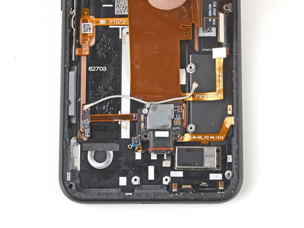

    12. Google Pixel 4 Screen Replacement: crwdns2935265:036crwdnd2935265:01crwdnd2935265:02crwdne2935265:0 Google Pixel 4 Screen Replacement: crwdns2935265:036crwdnd2935265:02crwdnd2935265:02crwdne2935265:0
      • Disconnect the right grip sensor connector from the motherboard.
      • Disconnect the display connector from the motherboard.

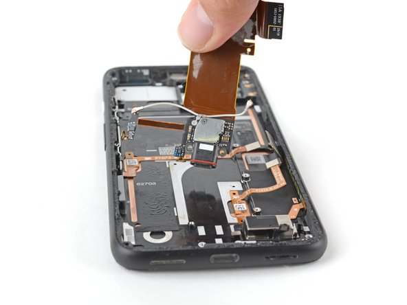

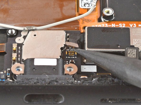

    13. Google Pixel 4 Screen Replacement: crwdns2935265:037crwdnd2935265:01crwdnd2935265:02crwdne2935265:0 Google Pixel 4 Screen Replacement: crwdns2935265:037crwdnd2935265:02crwdnd2935265:02crwdne2935265:0

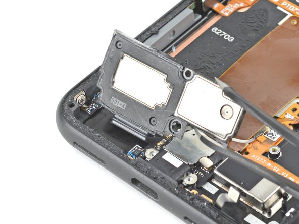

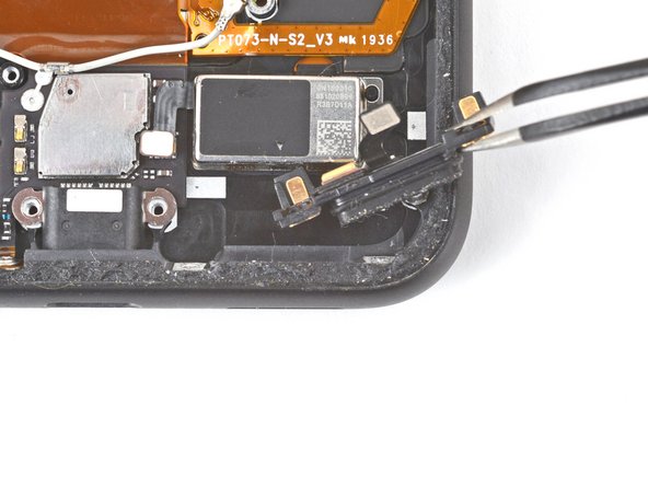

      • Use a pair of tweezers to disconnect the antenna connector from the charging assembly by pulling it straight up from the motherboard.
    14. Google Pixel 4 Screen Replacement: crwdns2935265:038crwdnd2935265:01crwdnd2935265:02crwdne2935265:0 Google Pixel 4 Screen Replacement: crwdns2935265:038crwdnd2935265:02crwdnd2935265:02crwdne2935265:0

      • Slowly lift out the motherboard, being careful not to snag any ribbon cable connectors.
      • The rear-facing camera module connectors loop around the motherboard, and the camera module is not secured to the phone, so it may lift out with the motherboard during this step.
      • Completely remove the motherboard.
      • When reinstalling the motherboard, check that no ribbon cable connectors are caught underneath.

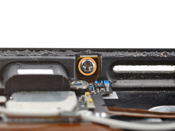

      • Use a T3 Torx driver to remove the two screws securing the loudspeaker:
      • One 4.2 mm screw
      • One 4.4 mm shouldered screw

      • Use the pointed end of a spudger to push the loudspeaker towards the battery, creating a small gap between the loudspeaker and the phone's frame.
      • The loudspeaker is held in place by a small retaining clip hidden underneath the left edge of the frame.
    3. Google Pixel 4 Screen Replacement, Remove the loudspeaker: crwdns2935265:043crwdnd2935265:01crwdnd2935265:02crwdne2935265:0 Google Pixel 4 Screen Replacement, Remove the loudspeaker: crwdns2935265:043crwdnd2935265:02crwdnd2935265:02crwdne2935265:0
      • Use a pair of tweezers to remove the loudspeaker, pivoting it up and out of the phone.
      • If the loudspeaker doesn't want to pivot up, try pushing it closer to the battery.
    4. Google Pixel 4 Screen Replacement, Disconnect the vibration motor: crwdns2935265:044crwdnd2935265:01crwdnd2935265:02crwdne2935265:0 Google Pixel 4 Screen Replacement, Disconnect the vibration motor: crwdns2935265:044crwdnd2935265:02crwdnd2935265:02crwdne2935265:0
      • Use the pointed end of a spudger to disconnect the vibration motor's press connector from the charging assembly.

      • Use a T3 Torx driver to remove the two screws securing the charging assembly to the frame:
      • One 2.1 mm screw on the left side of the frame.
      • One 2.1 mm screw on the bottom side of the frame.
    6. Google Pixel 4 Screen Replacement: crwdns2935265:046crwdnd2935265:01crwdnd2935265:02crwdne2935265:0 Google Pixel 4 Screen Replacement: crwdns2935265:046crwdnd2935265:02crwdnd2935265:02crwdne2935265:0
      • Use your fingers or a pair of tweezers to peel back the ribbon cable that's adhered to the phone's frame.
      • The ribbon cable is secured with some light adhesive.
    7. Google Pixel 4 Screen Replacement, Remove the charging assembly: crwdns2935265:047crwdnd2935265:01crwdnd2935265:03crwdne2935265:0 Google Pixel 4 Screen Replacement, Remove the charging assembly: crwdns2935265:047crwdnd2935265:02crwdnd2935265:03crwdne2935265:0 Google Pixel 4 Screen Replacement, Remove the charging assembly: crwdns2935265:047crwdnd2935265:03crwdnd2935265:03crwdne2935265:0
      • Remove the charging assembly.
    8. Google Pixel 4 Screen Replacement, Remove the microphone assembly: crwdns2935265:048crwdnd2935265:01crwdnd2935265:01crwdne2935265:0
      • Use a T3 Torx driver to remove the two 3.3 mm shouldered screws securing the bottom microphone assembly to the frame's lower edge.
    9. Google Pixel 4 Screen Replacement: crwdns2935265:049crwdnd2935265:01crwdnd2935265:03crwdne2935265:0 Google Pixel 4 Screen Replacement: crwdns2935265:049crwdnd2935265:02crwdnd2935265:03crwdne2935265:0 Google Pixel 4 Screen Replacement: crwdns2935265:049crwdnd2935265:03crwdnd2935265:03crwdne2935265:0
      • Insert the pointed end of a spudger into the divot between the microphone assembly and the frame.
      • Slide the pointed end of the spudger from left to right, separating the microphone assembly and the frame.
      • Remove the microphone assembly using your fingers or a pair of tweezers.
    10. Google Pixel 4 Screen Replacement, Remove the top module: crwdns2935265:050crwdnd2935265:01crwdnd2935265:02crwdne2935265:0 Google Pixel 4 Screen Replacement, Remove the top module: crwdns2935265:050crwdnd2935265:02crwdnd2935265:02crwdne2935265:0
      • Use the flat end of a spudger to slice through the adhesive securing the top module to the top of the frame.
    11. Google Pixel 4 Screen Replacement: crwdns2935265:051crwdnd2935265:01crwdnd2935265:03crwdne2935265:0 Google Pixel 4 Screen Replacement: crwdns2935265:051crwdnd2935265:02crwdnd2935265:03crwdne2935265:0 Google Pixel 4 Screen Replacement: crwdns2935265:051crwdnd2935265:03crwdnd2935265:03crwdne2935265:0
      • Use the flat end of a spudger to slice through the adhesive securing the left side of the top module to the body of the frame.
    12. Google Pixel 4 Screen Replacement: crwdns2935265:052crwdnd2935265:01crwdnd2935265:02crwdne2935265:0 Google Pixel 4 Screen Replacement: crwdns2935265:052crwdnd2935265:02crwdnd2935265:02crwdne2935265:0
      • Use the pointed end of a spudger to separate the right side of the top module from the body of the frame.
    13. Google Pixel 4 Screen Replacement: crwdns2935265:053crwdnd2935265:01crwdnd2935265:03crwdne2935265:0 Google Pixel 4 Screen Replacement: crwdns2935265:053crwdnd2935265:02crwdnd2935265:03crwdne2935265:0 Google Pixel 4 Screen Replacement: crwdns2935265:053crwdnd2935265:03crwdnd2935265:03crwdne2935265:0
      • Use the flat end of a spudger to separate the top module from the top speaker.
      • Remove the top module.

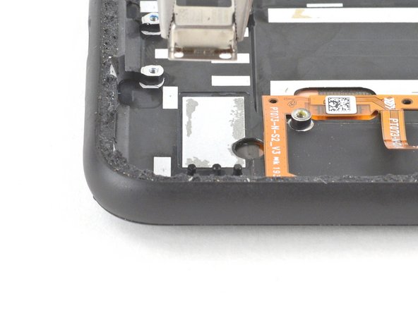

    15. Google Pixel 4 Screen Replacement, Only the screen remains: crwdns2935265:055crwdnd2935265:01crwdnd2935265:01crwdne2935265:0
      • You're now left with the screen.
