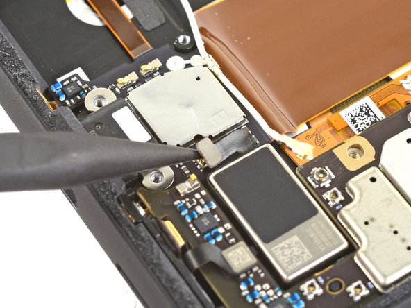

    • Whenever you use the spudger near the battery, be very careful not to puncture the battery.
    • Using the pointed end of a spudger, pry the battery connector straight up from the motherboard to disconnect the battery.
    • To re-attach press connectors like this one, carefully align and press down on one side until it clicks into place, then repeat on the other side. Do not press down on the middle. If the connector is misaligned, the pins can bend, causing permanent damage.

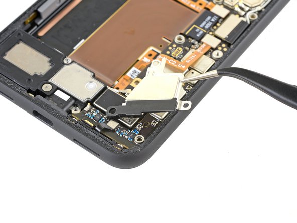

    • Use a pair of tweezers to remove the vibration motor shield.

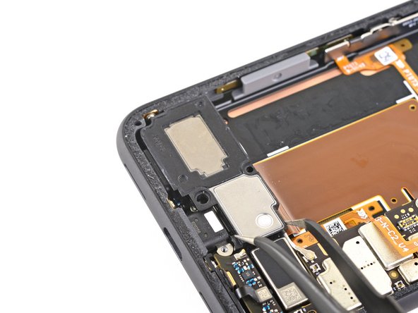

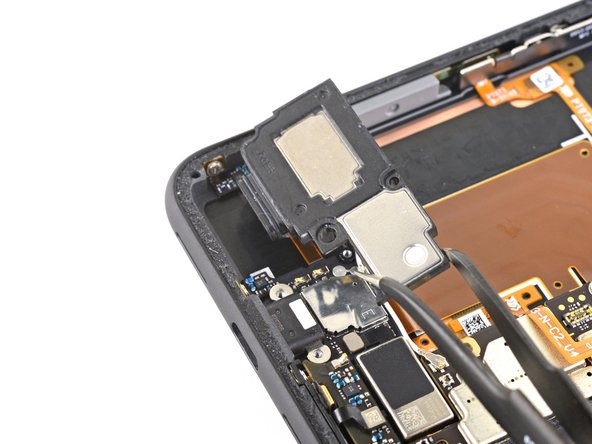

    • Use a pair of tweezers to slide the loudspeaker towards the top of the phone to clear the retention clip.
    • Remove the loudspeaker.
    • Before you install a replacement loudspeaker, check the adhesive gasket:
    • If it is in good condition, you can re-use the gasket. Make sure that the gasket does not cover the exit hole.
    • If the gasket is pulled out of place, remove it and replace the adhesive with a pre-cut strip or Tesa tape.

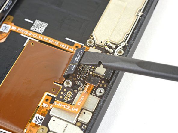

    • Use the flat end of a spudger to disconnect the charging cable connector by prying it straight up from the motherboard.

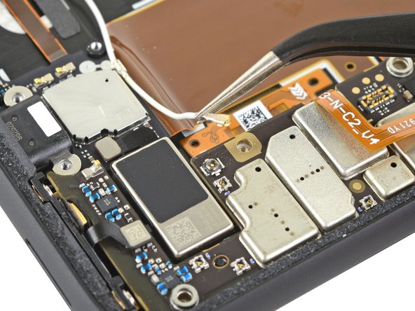

    • Use a pair of tweezers to disconnect the antenna press connector from the charging assembly by pulling it straight up from the motherboard.

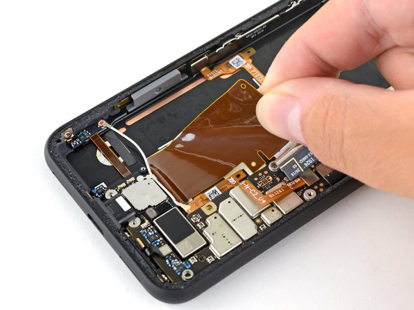

    • Disconnect the vibration motor connector from the charging assembly.
  32. Google Pixel 4 Charging Assembly Replacement: crwdns2935265:032crwdnd2935265:01crwdnd2935265:02crwdne2935265:0 Google Pixel 4 Charging Assembly Replacement: crwdns2935265:032crwdnd2935265:02crwdnd2935265:02crwdne2935265:0

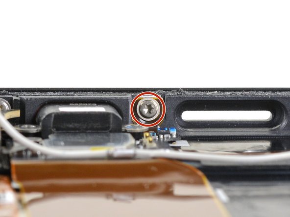

    • Use a T3 Torx driver to remove the two 2.1 mm screws securing the charging assembly to the frame, one on the left side and one on the bottom side.
  33. Google Pixel 4 Charging Assembly Replacement, Remove the charging assembly: crwdns2935265:033crwdnd2935265:01crwdnd2935265:02crwdne2935265:0 Google Pixel 4 Charging Assembly Replacement, Remove the charging assembly: crwdns2935265:033crwdnd2935265:02crwdnd2935265:02crwdne2935265:0

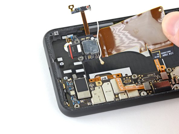

    • Peel back the ribbon cable that's adhered to the phone's frame. It's secured with some light adhesive.

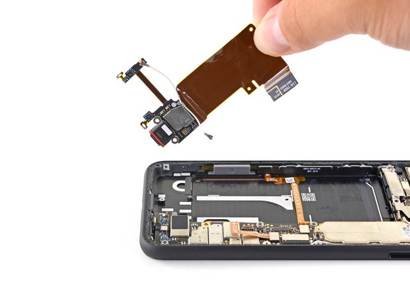

  34. Google Pixel 4 Charging Assembly Replacement: crwdns2935265:034crwdnd2935265:01crwdnd2935265:03crwdne2935265:0 Google Pixel 4 Charging Assembly Replacement: crwdns2935265:034crwdnd2935265:02crwdnd2935265:03crwdne2935265:0 Google Pixel 4 Charging Assembly Replacement: crwdns2935265:034crwdnd2935265:03crwdnd2935265:03crwdne2935265:0
    • Remove the charging assembly.
    • If your replacement charging assembly doesn't come with the white antenna cable, you'll need to transfer it to your new part.
