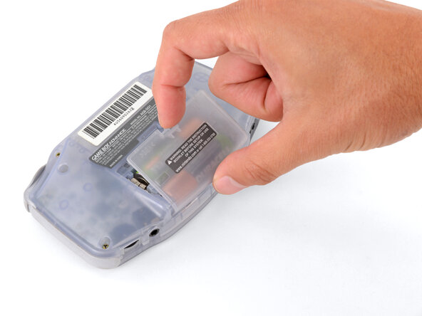

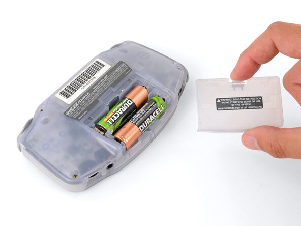

  2. Game Boy Advance Speaker Replacement, Remove the battery cover: crwdns2935265:02crwdnd2935265:01crwdnd2935265:03crwdne2935265:0 Game Boy Advance Speaker Replacement, Remove the battery cover: crwdns2935265:02crwdnd2935265:02crwdnd2935265:03crwdne2935265:0 Game Boy Advance Speaker Replacement, Remove the battery cover: crwdns2935265:02crwdnd2935265:03crwdnd2935265:03crwdne2935265:0
    • Release the battery cover tab with your finger and swing the cover away from your Game Boy to remove it.
    • During reassembly, insert the tabs on the bottom edge of the cover into their cutouts and press the cover into place.

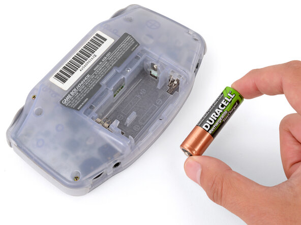

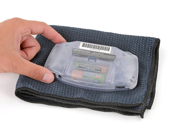

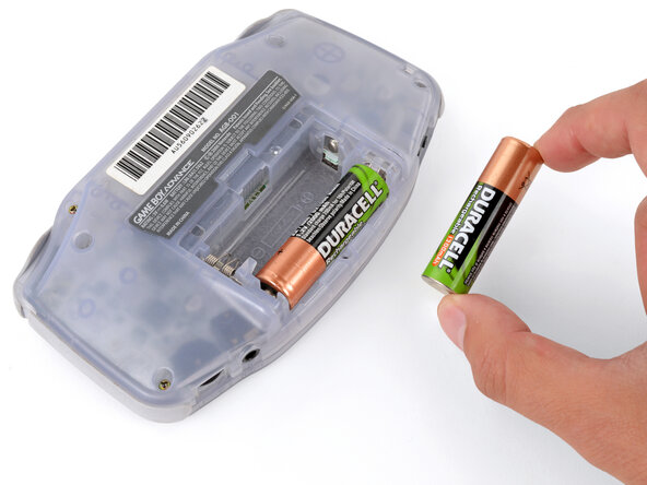

  3. Game Boy Advance Speaker Replacement, Remove the batteries: crwdns2935265:03crwdnd2935265:01crwdnd2935265:03crwdne2935265:0 Game Boy Advance Speaker Replacement, Remove the batteries: crwdns2935265:03crwdnd2935265:02crwdnd2935265:03crwdne2935265:0 Game Boy Advance Speaker Replacement, Remove the batteries: crwdns2935265:03crwdnd2935265:03crwdnd2935265:03crwdne2935265:0
    • Remove the two AA batteries.
    • If the metal terminals are corroded, follow this guide to clean them.
    • When installing batteries, use the diagram in the battery well to properly orient them.

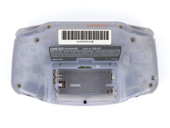

  4. Game Boy Advance Speaker Replacement, Remove the back shell screws: crwdns2935265:04crwdnd2935265:01crwdnd2935265:02crwdne2935265:0 Game Boy Advance Speaker Replacement, Remove the back shell screws: crwdns2935265:04crwdnd2935265:02crwdnd2935265:02crwdne2935265:0
    • Remove the seven screws securing the back shell:
    • Six 9.4 mm‑long tri‑point Y0 screws
    • One 8.5 mm‑long JIS 1 screw
    • You can try to use a non-iFixit Phillips driver in a pinch, but you risk damaging or stripping screws. Push down firmly on the driver and twist slowly.

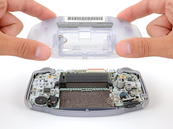

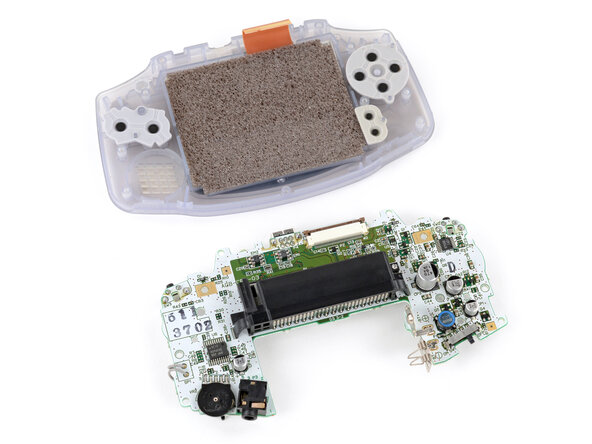

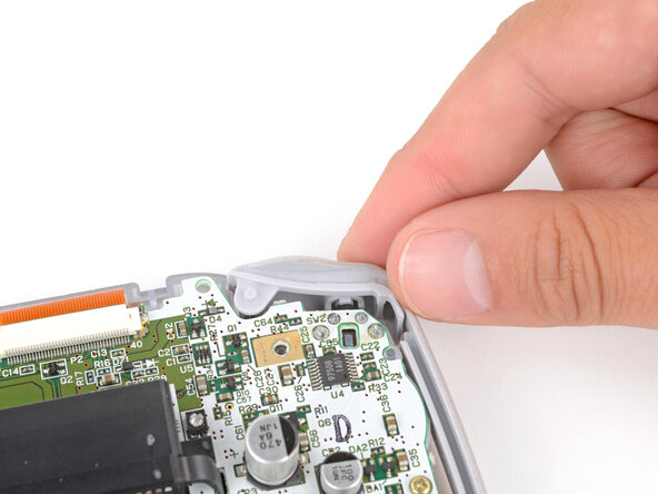

  5. Game Boy Advance Speaker Replacement, Remove the back shell: crwdns2935265:05crwdnd2935265:01crwdnd2935265:02crwdne2935265:0 Game Boy Advance Speaker Replacement, Remove the back shell: crwdns2935265:05crwdnd2935265:02crwdnd2935265:02crwdne2935265:0
    • Lift the back shell straight up and remove it.
    • During reassembly, squeeze the shell firmly around the edges and ensure the shoulder buttons and bumpers are properly seated with no large gaps. Gently test the buttons to make sure everything feels correct.

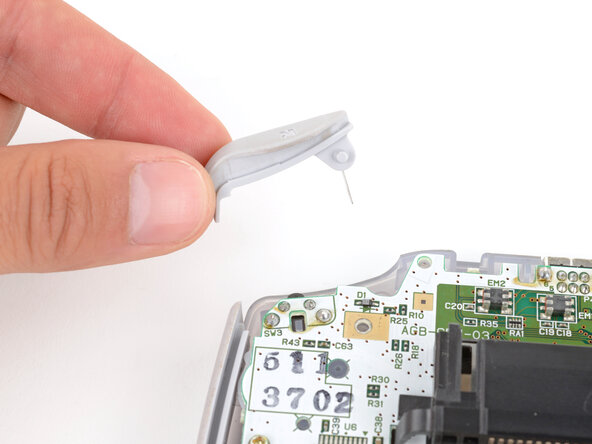

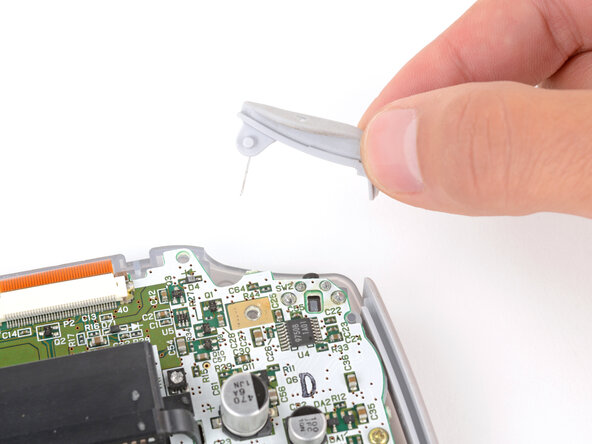

  6. Game Boy Advance Speaker Replacement, Remove the shoulder buttons: crwdns2935265:06crwdnd2935265:01crwdnd2935265:03crwdne2935265:0 Game Boy Advance Speaker Replacement, Remove the shoulder buttons: crwdns2935265:06crwdnd2935265:02crwdnd2935265:03crwdne2935265:0 Game Boy Advance Speaker Replacement, Remove the shoulder buttons: crwdns2935265:06crwdnd2935265:03crwdnd2935265:03crwdne2935265:0
    • Lift the shoulder buttons (aka L and R buttons) straight up to remove them.
    • During reassembly:
    • Since your Game Boy is laying upside down, the L button will go on your right‑hand side, and the R button will go on your left‑hand side.
    • Slide the buttons into place, making sure the peg on the button goes into its circular cutout and the button itself is over the actual button mechanism.
    • The shoulder buttons will sit on the inside edge of the side bumpers.
    • Gently test the buttons to make sure they feel correct. If they don't, reposition them and make sure the metal arms aren't stuck in a weird position under the board.

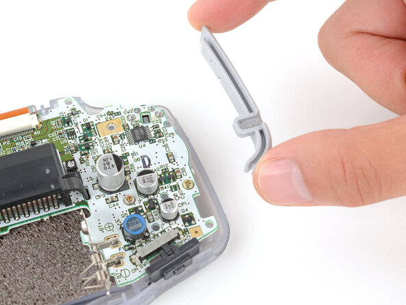

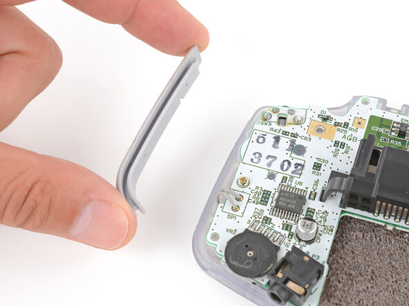

  7. Game Boy Advance Speaker Replacement, Remove the side bumpers: crwdns2935265:07crwdnd2935265:01crwdnd2935265:03crwdne2935265:0 Game Boy Advance Speaker Replacement, Remove the side bumpers: crwdns2935265:07crwdnd2935265:02crwdnd2935265:03crwdne2935265:0 Game Boy Advance Speaker Replacement, Remove the side bumpers: crwdns2935265:07crwdnd2935265:03crwdnd2935265:03crwdne2935265:0
    • Remove the side bumpers.

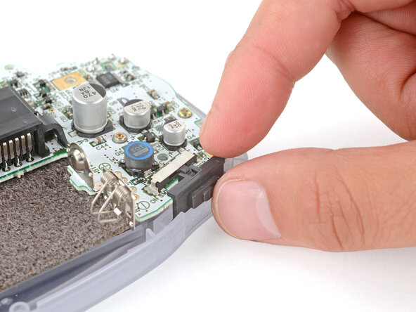

  8. Game Boy Advance Speaker Replacement, Remove the power switch cover: crwdns2935265:08crwdnd2935265:01crwdnd2935265:02crwdne2935265:0 Game Boy Advance Speaker Replacement, Remove the power switch cover: crwdns2935265:08crwdnd2935265:02crwdnd2935265:02crwdne2935265:0
    • Remove the power switch cover.
    • During reassembly, make sure the switch cover is properly slotted around the arm on the switch mechanism.

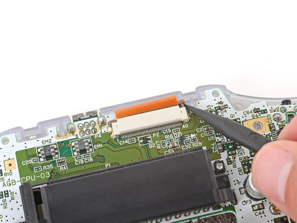

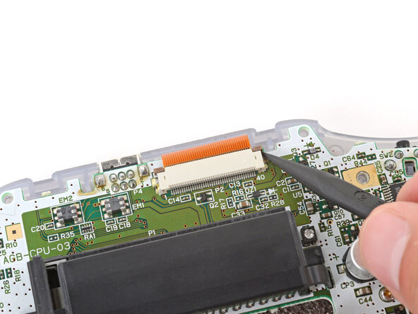

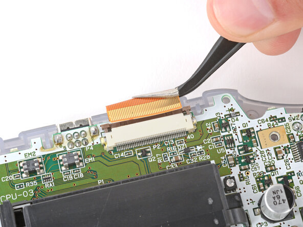

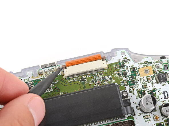

  9. Game Boy Advance Speaker Replacement, Disconnect the screen cable: crwdns2935265:09crwdnd2935265:01crwdnd2935265:03crwdne2935265:0 Game Boy Advance Speaker Replacement, Disconnect the screen cable: crwdns2935265:09crwdnd2935265:02crwdnd2935265:03crwdne2935265:0 Game Boy Advance Speaker Replacement, Disconnect the screen cable: crwdns2935265:09crwdnd2935265:03crwdnd2935265:03crwdne2935265:0
    • Use the point of a spudger to fully push up both locking tabs on either side of the screen cable connector.
    • You should feel the tab click into its unlocked position. Don't push too far, or the tab may slide completely out of the connector.

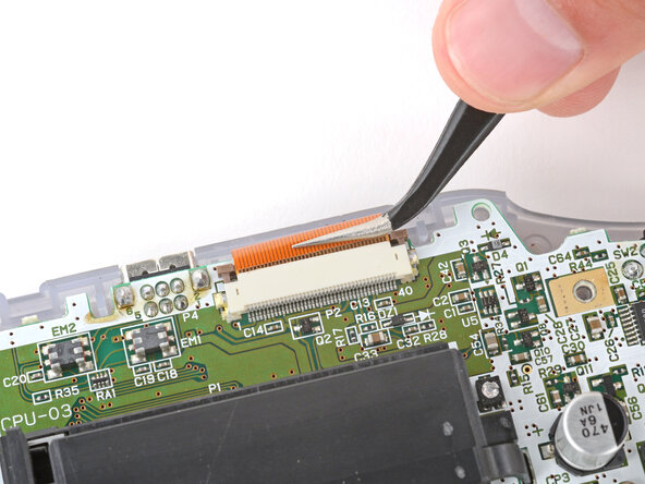

  10. Game Boy Advance Speaker Replacement: crwdns2935265:010crwdnd2935265:01crwdnd2935265:02crwdne2935265:0 Game Boy Advance Speaker Replacement: crwdns2935265:010crwdnd2935265:02crwdnd2935265:02crwdne2935265:0
    • Use tweezers to slide the cable straight out of its socket.
    • The cable should come out with little to no force. If you feel resistance, the tab may not be fully unlocked.

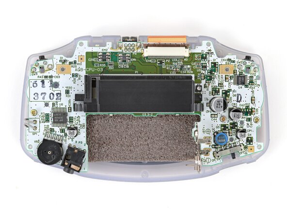

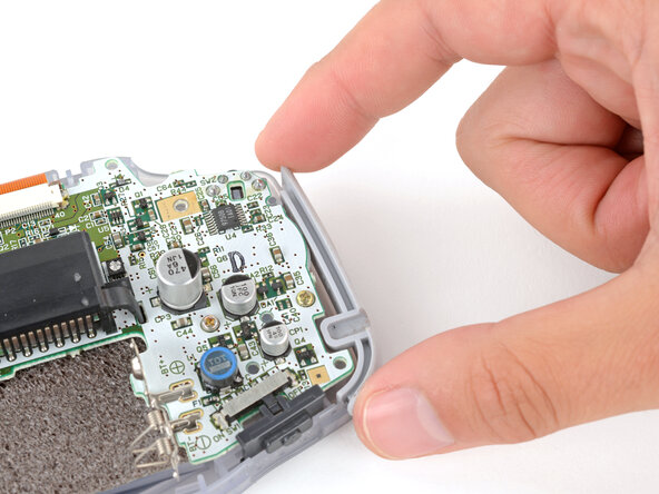

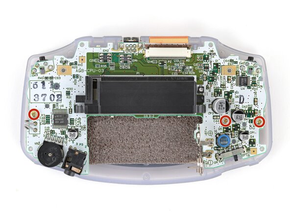

  11. Game Boy Advance Speaker Replacement, Remove the motherboard screws: crwdns2935265:011crwdnd2935265:01crwdnd2935265:02crwdne2935265:0 Game Boy Advance Speaker Replacement, Remove the motherboard screws: crwdns2935265:011crwdnd2935265:02crwdnd2935265:02crwdne2935265:0
    • Use a JIS 1 screwdriver to remove the three 7 mm‑long screws securing the motherboard.

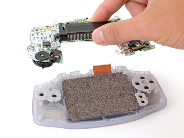

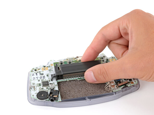

  12. Game Boy Advance Speaker Replacement, Remove the motherboard: crwdns2935265:012crwdnd2935265:01crwdnd2935265:03crwdne2935265:0 Game Boy Advance Speaker Replacement, Remove the motherboard: crwdns2935265:012crwdnd2935265:02crwdnd2935265:03crwdne2935265:0 Game Boy Advance Speaker Replacement, Remove the motherboard: crwdns2935265:012crwdnd2935265:03crwdnd2935265:03crwdne2935265:0
    • Use your fingers to grip the cartridge reader and lift the motherboard straight up to remove it.
    • During reassembly, make sure the speaker gets correctly slotted into its circular cutout (including a small tab on the bottom) when lowering the motherboard into place.

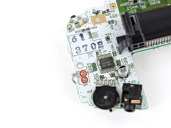

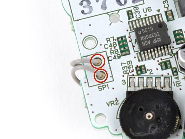

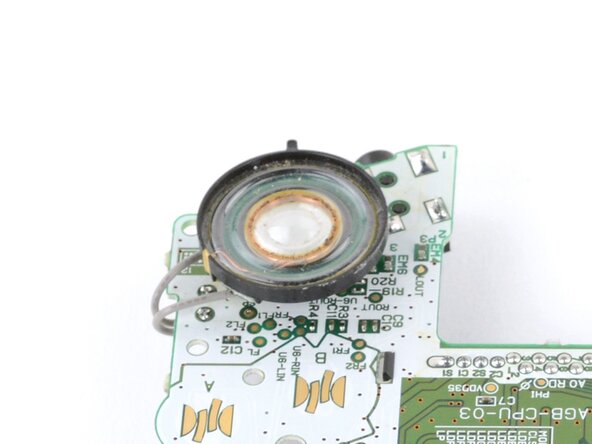

  13. Game Boy Advance Speaker Replacement, Desolder the speaker wires: crwdns2935265:013crwdnd2935265:01crwdnd2935265:03crwdne2935265:0 Game Boy Advance Speaker Replacement, Desolder the speaker wires: crwdns2935265:013crwdnd2935265:02crwdnd2935265:03crwdne2935265:0 Game Boy Advance Speaker Replacement, Desolder the speaker wires: crwdns2935265:013crwdnd2935265:03crwdnd2935265:03crwdne2935265:0
    • Use a soldering iron to desolder the two speaker wires from the motherboard.
    • Remove the speaker.
    • During reassembly, solder your replacement speaker's wires to the motherboard.
