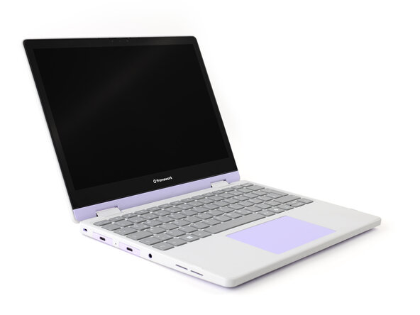

Framework Laptop 12 Mainboard Replacement
