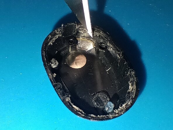

  7. Fix unstable bluetooth connection, Lift antenna: crwdns2935265:08crwdnd2935265:01crwdnd2935265:02crwdne2935265:0 Fix unstable bluetooth connection, Lift antenna: crwdns2935265:08crwdnd2935265:02crwdnd2935265:02crwdne2935265:0
    • Lift up the contact area of the antenna with a scalpel.
    • Be especially careful when pushing it around the mic port(marked in red) that's beneath it.
  8. Fix unstable bluetooth connection, Add piece of foam: crwdns2935265:09crwdnd2935265:01crwdnd2935265:01crwdne2935265:0
    • Put a thin piece of foam the size of the contact area behind it.
  9. Fix unstable bluetooth connection, Push the antenna back in place: crwdns2935265:010crwdnd2935265:01crwdnd2935265:01crwdne2935265:0
    • Fold the contact are back down.
