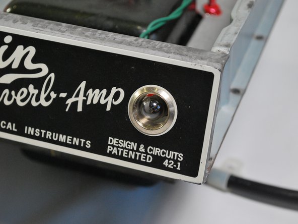

  3. Fender 65 Twin Reverb Light Bulb Replacement: crwdns2935265:03crwdnd2935265:01crwdnd2935265:02crwdne2935265:0 Fender 65 Twin Reverb Light Bulb Replacement: crwdns2935265:03crwdnd2935265:02crwdnd2935265:02crwdne2935265:0
    • Remove the cap covering the light bulb by unscrewing the cap counter clockwise.

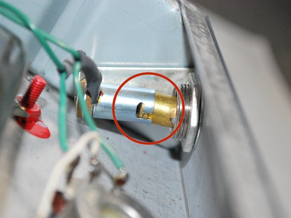

  4. Fender 65 Twin Reverb Light Bulb Replacement: crwdns2935265:04crwdnd2935265:01crwdnd2935265:02crwdne2935265:0 Fender 65 Twin Reverb Light Bulb Replacement: crwdns2935265:04crwdnd2935265:02crwdnd2935265:02crwdne2935265:0
    • Using Needle Nose Pliers twist the light bulb counter clockwise towards the notch in the light bulb housing.
    • To replace the light bulb remove the old one through the front of the amp head.
    • Install the new light bulb through the front of the amp head. Using Needle Nose Pliers twist the light bulb clockwise to complete the installation.

You just did it the hard way. My light went out on my 65 Twin Reissue, and I just unscrewed the red jewel lens and pushed on the bulb slightly while rotating it coumterclockwise, and the bulb came right out. To replace it, I pushed the new bulb in and rotated it clockwise, screwed the jewel lens back on and it was done. This took 1 minute. Glad I could help.

I just replaced the pilot bulb on my Blues DeVille. I couldn’t get the new bulb to twist into the socket after I successfully removed the old bulb. I took the plastic cap from a small marker and cut a small slit so that it fit onto the top of the bulb nicely. I was able to push the bulb into the socket, twist it in, and then pull the marker top off of the bulb, leaving the pilot light securely in the socket.
