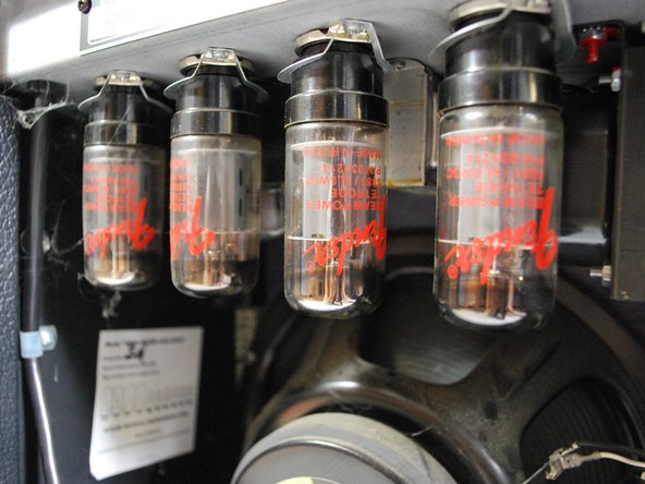

    • Make sure to unplug the power cord!
    • Take off the back panel by unscrewing the four Phillips head screws on the back of the amplifier. You will find the four power vacuum tubes are the largest ones on the left side.
    • Keep the screws in a safe place and mark what part they are for.
  2. Fender 65 Twin Reverb Power Tube Replacement: crwdns2935265:02crwdnd2935265:01crwdnd2935265:03crwdne2935265:0 Fender 65 Twin Reverb Power Tube Replacement: crwdns2935265:02crwdnd2935265:02crwdnd2935265:03crwdne2935265:0 Fender 65 Twin Reverb Power Tube Replacement: crwdns2935265:02crwdnd2935265:03crwdnd2935265:03crwdne2935265:0
    • Using the cloth, you can then remove a tube by pressing up on the two metal flaps near the top of the tubes, while lightly pulling the tube down.

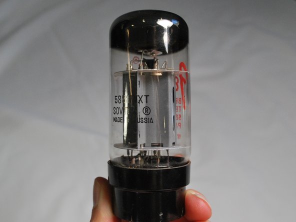

  3. Fender 65 Twin Reverb Power Tube Replacement: crwdns2935265:03crwdnd2935265:01crwdnd2935265:02crwdne2935265:0 Fender 65 Twin Reverb Power Tube Replacement: crwdns2935265:03crwdnd2935265:02crwdnd2935265:02crwdne2935265:0
    • Check the tube for any cracks in the glass. also check to make sure the filaments are not burnt out.
    • A new or working tube should look like the one in the picture, no cracks or broken filaments.
    • If you buy a replacement tube, it is recommended that you buy one that is the same as the original and made by the same company.
  4. Fender 65 Twin Reverb Power Tube Replacement: crwdns2935265:04crwdnd2935265:01crwdnd2935265:02crwdne2935265:0 Fender 65 Twin Reverb Power Tube Replacement: crwdns2935265:04crwdnd2935265:02crwdnd2935265:02crwdne2935265:0
    • Take the new replacement tube (or your old one if it is still working) and insert it into the appropriate slot, pressing lightly but firmly. Make sure that the prongs at the end line up with the correct holes.
    • You should hear a click when the tube is secured in place.
    • Repeat these steps with the other three tubes if necessary.
