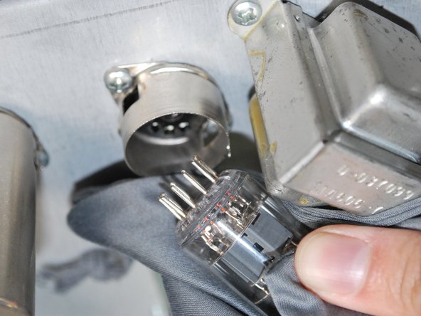

    • Remove the metal casing by gently pressing up against the case and twisting to the right.
  3. Fender 65 Twin Reverb Preamp Tube Replacement: crwdns2935265:03crwdnd2935265:01crwdnd2935265:02crwdne2935265:0 Fender 65 Twin Reverb Preamp Tube Replacement: crwdns2935265:03crwdnd2935265:02crwdnd2935265:02crwdne2935265:0
    • Using the cloth, remove one tube by firmly grasping and gently pulling downwards.
    • Pulling directly downwards prevents damage to the hookup prongs at the bottom of the tube.
  4. Fender 65 Twin Reverb Preamp Tube Replacement: crwdns2935265:04crwdnd2935265:01crwdnd2935265:01crwdne2935265:0
    • Check the tube for any cracks in the glass. Also check to make sure the filaments are not burnt out.
    • If the tube is still functioning or to insert the replacement or, proceed to step five.

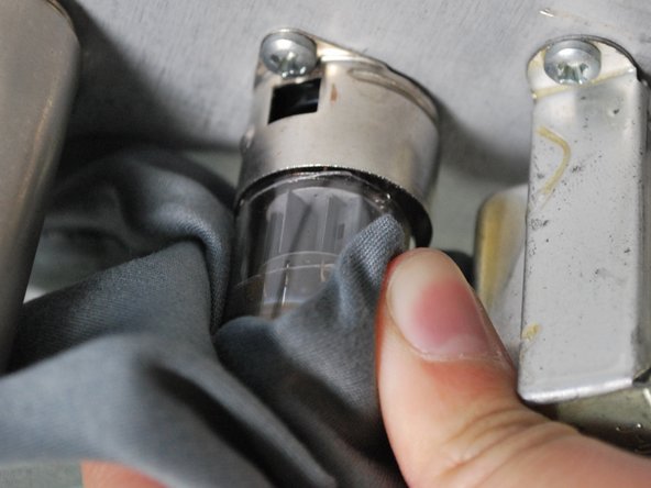

  5. Fender 65 Twin Reverb Preamp Tube Replacement: crwdns2935265:05crwdnd2935265:01crwdnd2935265:02crwdne2935265:0 Fender 65 Twin Reverb Preamp Tube Replacement: crwdns2935265:05crwdnd2935265:02crwdnd2935265:02crwdne2935265:0
    • Take the new replacement tube and insert it into the appropriate slot, making sure that the prongs at the end line up with the correct holes.
    • You should hear a click when the tube is secured in place.
    • Repeat these steps with the other three tubes if necessary.
