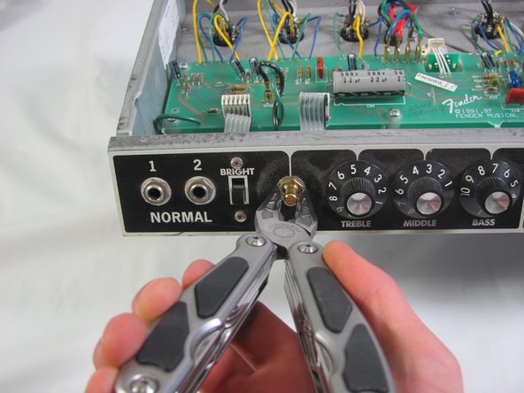

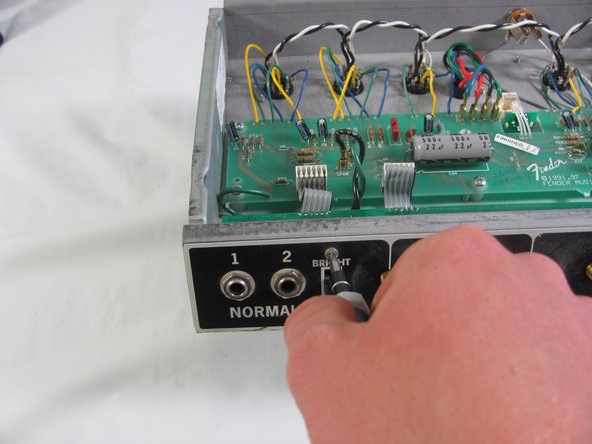

    • It's time to remove the front PCB (Printed Circuit Board)
    • Start by removing all the knobs with a small, flat screwdriver
    • Use a wrench or pliers to remove all the nuts that were under the knobs
    • Use the wrench or pliers to also remove the nuts on the normal and vibrato input jacks
    • Use a screwdriver to remove the screws on the bright switches
  4. Fender 65 Twin Reverb Input Jack Replacement: crwdns2935265:04crwdnd2935265:01crwdnd2935265:03crwdne2935265:0 Fender 65 Twin Reverb Input Jack Replacement: crwdns2935265:04crwdnd2935265:02crwdnd2935265:03crwdne2935265:0 Fender 65 Twin Reverb Input Jack Replacement: crwdns2935265:04crwdnd2935265:03crwdnd2935265:03crwdne2935265:0

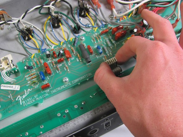

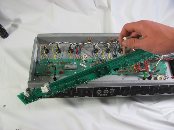

    • Ensure that the front panel is free by pulling back the black cover. If it does not pull back, remove any remaining nuts or screws
    • Caution! While working in the amp head, use only one hand to ensure safety from electrical shock. This is a rare occurrence but only using one hand will protect you. Do not "ground" yourself by touching anything else with your other hand. Do not touch any unfamiliar components.
    • Locate the three pin connecters between the two PCBS. Gently unplug them by pulling straight up.
    • Remove the PCB from the amp head and set it aside to get ready for soldering

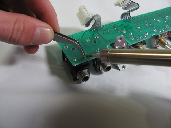

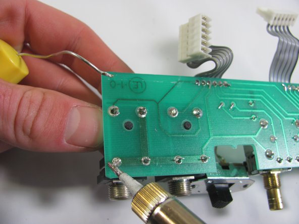

    • Set your soldering iron to a medium to hot setting to adequately melt the solder joints
    • Once the soldering iron is hot enough, touch the tip to the solder joint on the PCB while using tweezers to clear out a big enough hole to pull out the jack
    • Remove the jack once the joints are broken and clean out excess solder

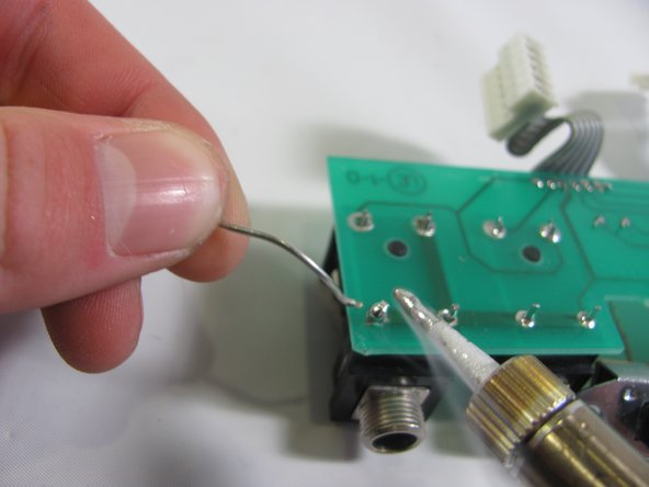

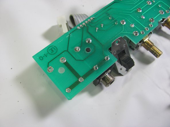

    • Insert the new jack into the holes that were left behind by the old jack
    • Hold the iron tip near the joints with the solder.
    • Melt a bead of solder onto the iron and drop it right on the joint while adequately spreading it to ensure proper connection
