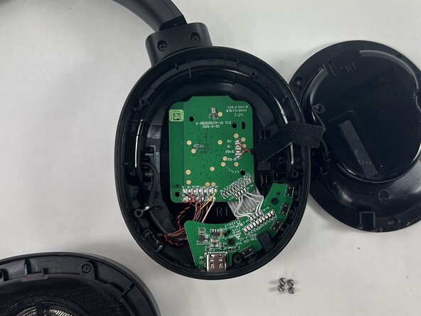

    1. Edifier W820NB Plus Motherboard Replacement, Motherboard: crwdns2935265:010crwdnd2935265:01crwdnd2935265:02crwdne2935265:0 Edifier W820NB Plus Motherboard Replacement, Motherboard: crwdns2935265:010crwdnd2935265:02crwdnd2935265:02crwdne2935265:0
      • Peel off the black strip stuck to the top of the motherboard.

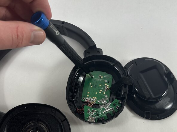

    2. Edifier W820NB Plus Motherboard Replacement: crwdns2935265:011crwdnd2935265:01crwdnd2935265:03crwdne2935265:0 Edifier W820NB Plus Motherboard Replacement: crwdns2935265:011crwdnd2935265:02crwdnd2935265:03crwdne2935265:0 Edifier W820NB Plus Motherboard Replacement: crwdns2935265:011crwdnd2935265:03crwdnd2935265:03crwdne2935265:0
      • Remove the four 2 mm screws that secure the motherboard with a Phillips #0 screwdriver.

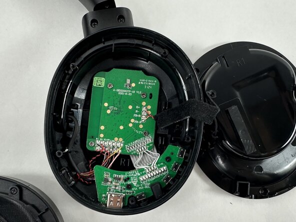

    3. Edifier W820NB Plus Motherboard Replacement: crwdns2935265:012crwdnd2935265:01crwdnd2935265:02crwdne2935265:0 Edifier W820NB Plus Motherboard Replacement: crwdns2935265:012crwdnd2935265:02crwdnd2935265:02crwdne2935265:0

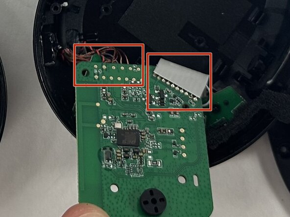

      • Pull the motherboard out.
      • Desolder all motherboard connections.
