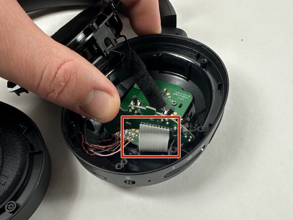

    1. Edifier W820NB Plus I/O Board Replacement, Drivers: crwdns2935265:05crwdnd2935265:01crwdnd2935265:01crwdne2935265:0
      • Identify the driver you wish to replace.
      • This guide will use the left driver as an example but the same steps can be mirrored when replacing or removing the right driver. The battery is under the left driver, while the motherboard and daughterboard are under the right driver.
    2. Edifier W820NB Plus I/O Board Replacement: crwdns2935265:06crwdnd2935265:01crwdnd2935265:02crwdne2935265:0 Edifier W820NB Plus I/O Board Replacement: crwdns2935265:06crwdnd2935265:02crwdnd2935265:02crwdne2935265:0
      • Remove all five 5 mm Phillips #0 screws that secure the driver assembly.
    3. Edifier W820NB Plus I/O Board Replacement: crwdns2935265:07crwdnd2935265:01crwdnd2935265:03crwdne2935265:0 Edifier W820NB Plus I/O Board Replacement: crwdns2935265:07crwdnd2935265:02crwdnd2935265:03crwdne2935265:0 Edifier W820NB Plus I/O Board Replacement: crwdns2935265:07crwdnd2935265:03crwdnd2935265:03crwdne2935265:0
      • Note that the wires for the drivers are on the outermost edge. Try to avoid pushing or cutting them when taking the driver out.
      • Insert a Jimmy in the seam between the driver assembly and driver housing.
      • Rotate the Jimmy along the entire perimeter of the innermost edge to pry it out of place.
    4. Edifier W820NB Plus I/O Board Replacement: crwdns2935265:08crwdnd2935265:01crwdnd2935265:02crwdne2935265:0 Edifier W820NB Plus I/O Board Replacement: crwdns2935265:08crwdnd2935265:02crwdnd2935265:02crwdne2935265:0
      • Gently remove the driver assembly from the rest of the headphone, with care not to strain the connected wire.
    5. Edifier W820NB Plus I/O Board Replacement: crwdns2935265:09crwdnd2935265:01crwdnd2935265:02crwdne2935265:0 Edifier W820NB Plus I/O Board Replacement: crwdns2935265:09crwdnd2935265:02crwdnd2935265:02crwdne2935265:0
      • Skip this step if you are completing a battery replacement.
      • Repeat the procedure for the other driver if necessary.
      • Desolder the four driver connections from the motherboard.
      • Remove the driver assembly.

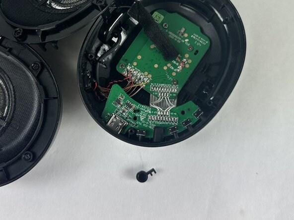

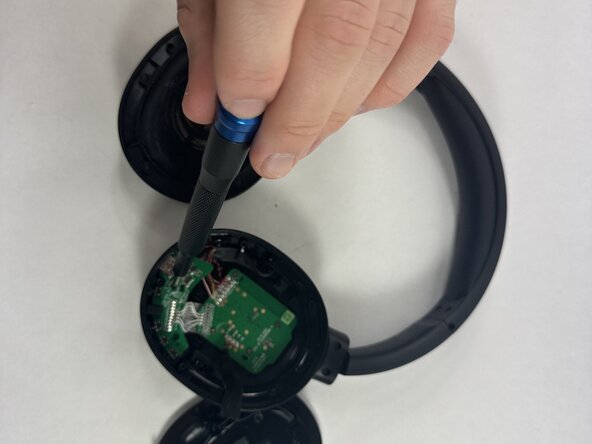

    1. Edifier W820NB Plus I/O Board Replacement, I/O Board: crwdns2935265:010crwdnd2935265:01crwdnd2935265:03crwdne2935265:0 Edifier W820NB Plus I/O Board Replacement, I/O Board: crwdns2935265:010crwdnd2935265:02crwdnd2935265:03crwdne2935265:0 Edifier W820NB Plus I/O Board Replacement, I/O Board: crwdns2935265:010crwdnd2935265:03crwdnd2935265:03crwdne2935265:0
      • Use a Philllips #0 screwdriver to remove the 2 mm screws that secure the I/O board.

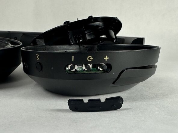

    2. Edifier W820NB Plus I/O Board Replacement: crwdns2935265:011crwdnd2935265:01crwdnd2935265:03crwdne2935265:0 Edifier W820NB Plus I/O Board Replacement: crwdns2935265:011crwdnd2935265:02crwdnd2935265:03crwdne2935265:0 Edifier W820NB Plus I/O Board Replacement: crwdns2935265:011crwdnd2935265:03crwdnd2935265:03crwdne2935265:0
      • Pry out the power and volume buttons cover using a Jimmy.

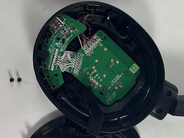

    3. Edifier W820NB Plus I/O Board Replacement: crwdns2935265:012crwdnd2935265:01crwdnd2935265:02crwdne2935265:0 Edifier W820NB Plus I/O Board Replacement: crwdns2935265:012crwdnd2935265:02crwdnd2935265:02crwdne2935265:0
      • Pull the daughter board out.
      • Note that the connections (both in the front and back) will need to be desoldered.
