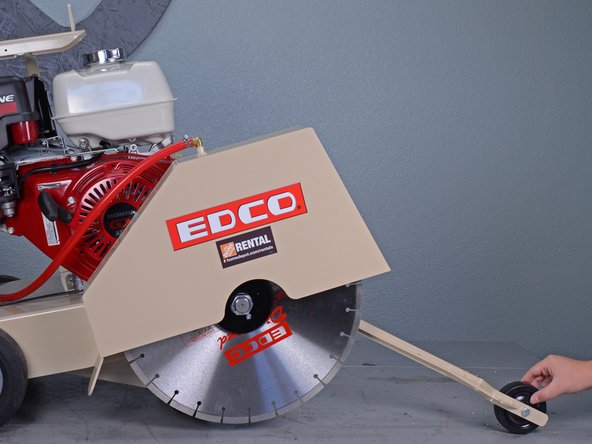

EDCO PRO KL-18 Concrete Saw Belts Replacement
  1. EDCO PRO KL-18 Concrete Saw Belts Replacement, Chock the wheels: crwdns2935265:01crwdnd2935265:01crwdnd2935265:02crwdne2935265:0 EDCO PRO KL-18 Concrete Saw Belts Replacement, Chock the wheels: crwdns2935265:01crwdnd2935265:02crwdnd2935265:02crwdne2935265:0
    • Before you begin, ensure the machine is powered down and cool to the touch.
    • Chock the wheels to prevent the machine from moving while you are working on it.

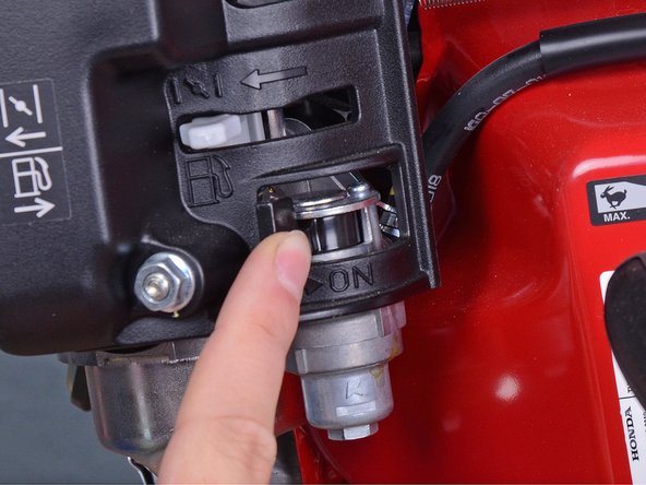

  2. EDCO PRO KL-18 Concrete Saw Belts Replacement, Turn off the ignition switches: crwdns2935265:02crwdnd2935265:01crwdnd2935265:03crwdne2935265:0 EDCO PRO KL-18 Concrete Saw Belts Replacement, Turn off the ignition switches: crwdns2935265:02crwdnd2935265:02crwdnd2935265:03crwdne2935265:0 EDCO PRO KL-18 Concrete Saw Belts Replacement, Turn off the ignition switches: crwdns2935265:02crwdnd2935265:03crwdnd2935265:03crwdne2935265:0
    • Flip the ignition switches on the motor and the handle bar into their "OFF" positions.
  3. EDCO PRO KL-18 Concrete Saw Belts Replacement, Close the fuel valve: crwdns2935265:03crwdnd2935265:01crwdnd2935265:02crwdne2935265:0 EDCO PRO KL-18 Concrete Saw Belts Replacement, Close the fuel valve: crwdns2935265:03crwdnd2935265:02crwdnd2935265:02crwdne2935265:0
    • Flip the fuel cutoff valve switch into the off position.

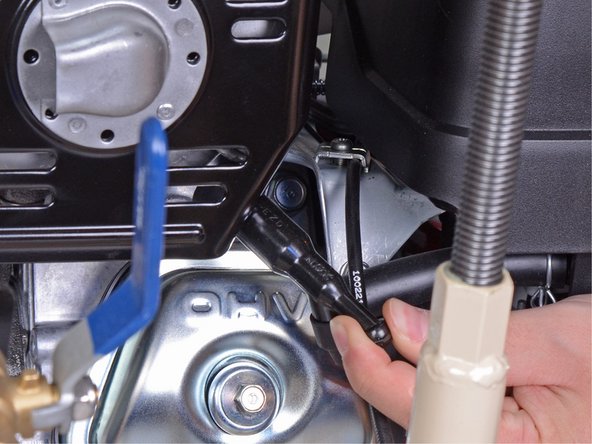

  4. EDCO PRO KL-18 Concrete Saw Belts Replacement, Disconnect the spark plug: crwdns2935265:04crwdnd2935265:01crwdnd2935265:02crwdne2935265:0 EDCO PRO KL-18 Concrete Saw Belts Replacement, Disconnect the spark plug: crwdns2935265:04crwdnd2935265:02crwdnd2935265:02crwdne2935265:0
    • Grab the plastic housing at the end of the spark plug wire.
    • Pull firmly to disconnect the wire from the spark plug.

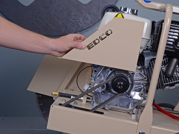

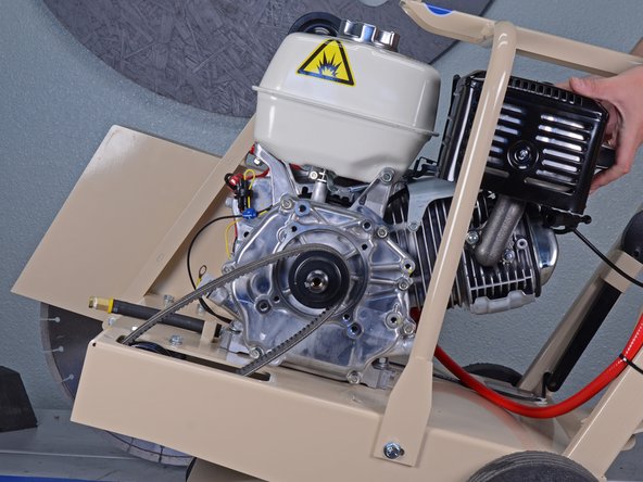

  5. EDCO PRO KL-18 Concrete Saw Belts Replacement, Remove the belt guard: crwdns2935265:05crwdnd2935265:01crwdnd2935265:01crwdne2935265:0
    • Use a 9/16 inch socket to remove the two bolts securing the belt guard to the main frame.
  6. EDCO PRO KL-18 Concrete Saw Belts Replacement: crwdns2935265:06crwdnd2935265:01crwdnd2935265:02crwdne2935265:0 EDCO PRO KL-18 Concrete Saw Belts Replacement: crwdns2935265:06crwdnd2935265:02crwdnd2935265:02crwdne2935265:0
    • Remove the belt guard.

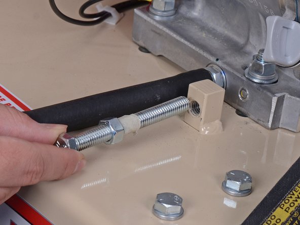

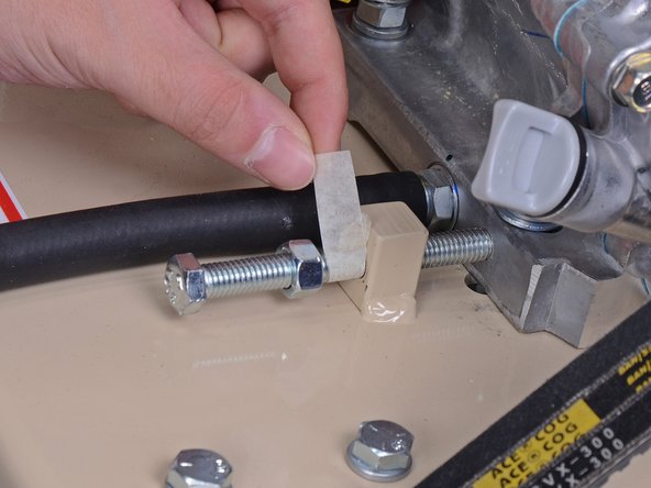

  7. EDCO PRO KL-18 Concrete Saw Belts Replacement, Loosen the belt-tensioner lock nut: crwdns2935265:07crwdnd2935265:01crwdnd2935265:01crwdne2935265:0
    • Use a 9/16 inch wrench to loosen the lock nut on the belt-tensioner bolt.
  8. EDCO PRO KL-18 Concrete Saw Belts Replacement: crwdns2935265:08crwdnd2935265:01crwdnd2935265:02crwdne2935265:0 EDCO PRO KL-18 Concrete Saw Belts Replacement: crwdns2935265:08crwdnd2935265:02crwdnd2935265:02crwdne2935265:0
    • Use your finger to spin the lock nut counterclockwise until there is a about a one inch gap between it and the frame.
    • Wrap a piece of tape around the belt-tensioner bolt where it meets the frame.
    • During reassembly, tighten the belt-tensioner bolt until the tape is flush against the frame (or until the belt is sufficiently tensioned) and then tighten down the belt-tensioner lock nut to the frame.

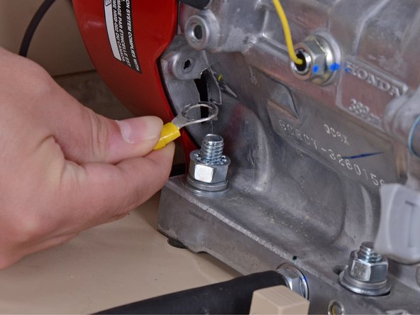

  10. EDCO PRO KL-18 Concrete Saw Belts Replacement, Disconnect the ground wire: crwdns2935265:010crwdnd2935265:01crwdnd2935265:01crwdne2935265:0
    • Use a 9/16 inch wrench to remove the nut securing the ground wire to the engine block.

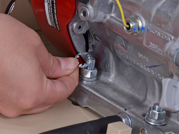

  11. EDCO PRO KL-18 Concrete Saw Belts Replacement: crwdns2935265:011crwdnd2935265:01crwdnd2935265:03crwdne2935265:0 EDCO PRO KL-18 Concrete Saw Belts Replacement: crwdns2935265:011crwdnd2935265:02crwdnd2935265:03crwdne2935265:0 EDCO PRO KL-18 Concrete Saw Belts Replacement: crwdns2935265:011crwdnd2935265:03crwdnd2935265:03crwdne2935265:0
    • Remove the ground wire and tooth washer from the engine mount.

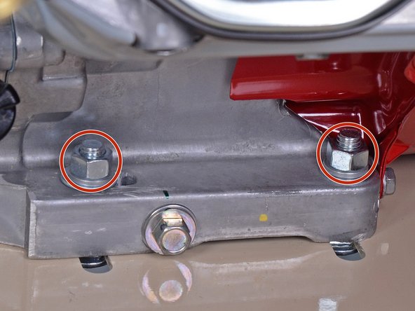

  12. EDCO PRO KL-18 Concrete Saw Belts Replacement, Relieve tension on the bolts: crwdns2935265:012crwdnd2935265:01crwdnd2935265:02crwdne2935265:0 EDCO PRO KL-18 Concrete Saw Belts Replacement, Relieve tension on the bolts: crwdns2935265:012crwdnd2935265:02crwdnd2935265:02crwdne2935265:0
    • Use a 9/16 inch wrench to loosen the four nuts securing the engine block to the frame, two on the front and two on the back.
    • Do not completely remove these nuts.
  13. EDCO PRO KL-18 Concrete Saw Belts Replacement: crwdns2935265:013crwdnd2935265:01crwdnd2935265:02crwdne2935265:0 EDCO PRO KL-18 Concrete Saw Belts Replacement: crwdns2935265:013crwdnd2935265:02crwdnd2935265:02crwdne2935265:0
    • Slide the engine towards the front of the frame to relieve tension on the belts.
    • To keep the motor in the de-tensioned position, tighten a couple of the nuts down.

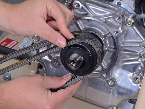

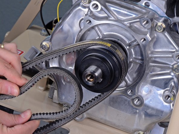

  14. EDCO PRO KL-18 Concrete Saw Belts Replacement, Remove the belts from the motor pulley: crwdns2935265:014crwdnd2935265:01crwdnd2935265:03crwdne2935265:0 EDCO PRO KL-18 Concrete Saw Belts Replacement, Remove the belts from the motor pulley: crwdns2935265:014crwdnd2935265:02crwdnd2935265:03crwdne2935265:0 EDCO PRO KL-18 Concrete Saw Belts Replacement, Remove the belts from the motor pulley: crwdns2935265:014crwdnd2935265:03crwdnd2935265:03crwdne2935265:0
    • Lift the outermost belt out of its pulley groove and rotate the motor pulley to remove it.
    • Repeat for the two remaining belts.

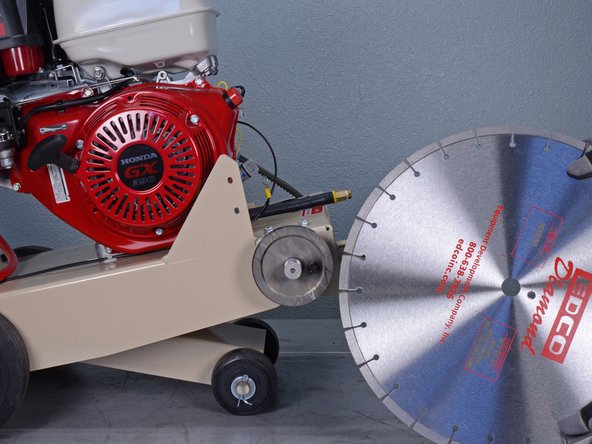

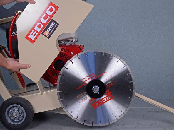

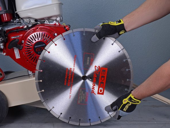

  15. EDCO PRO KL-18 Concrete Saw Belts Replacement, Remove the cutter blade: crwdns2935265:015crwdnd2935265:01crwdnd2935265:02crwdne2935265:0 EDCO PRO KL-18 Concrete Saw Belts Replacement, Remove the cutter blade: crwdns2935265:015crwdnd2935265:02crwdnd2935265:02crwdne2935265:0

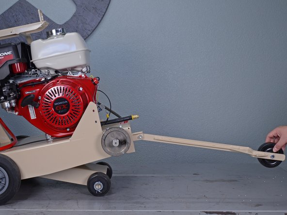

    • Place the guide bar onto the ground out of the way of the blade guard.
  16. EDCO PRO KL-18 Concrete Saw Belts Replacement: crwdns2935265:016crwdnd2935265:01crwdnd2935265:02crwdne2935265:0 EDCO PRO KL-18 Concrete Saw Belts Replacement: crwdns2935265:016crwdnd2935265:02crwdnd2935265:02crwdne2935265:0
    • Lift the blade guide straight up and off of the frame and place it next to the machine.
    • The blade guard is still attached to the device via the water hose.
  17. EDCO PRO KL-18 Concrete Saw Belts Replacement: crwdns2935265:017crwdnd2935265:01crwdnd2935265:03crwdne2935265:0 EDCO PRO KL-18 Concrete Saw Belts Replacement: crwdns2935265:017crwdnd2935265:02crwdnd2935265:03crwdne2935265:0 EDCO PRO KL-18 Concrete Saw Belts Replacement: crwdns2935265:017crwdnd2935265:03crwdnd2935265:03crwdne2935265:0

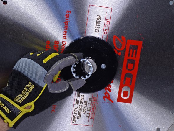

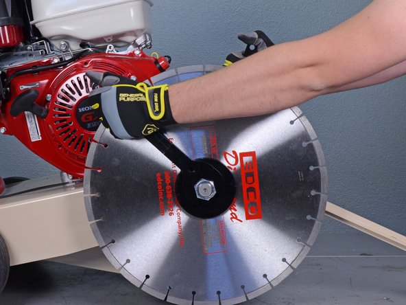

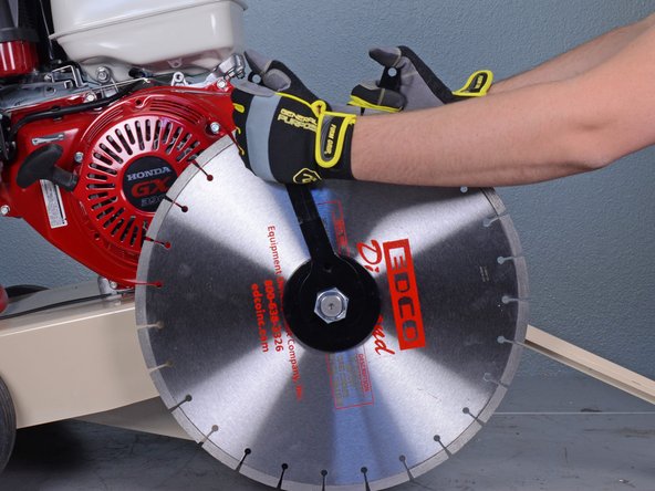

    • When working with the blade, wear gloves. The edges of the blade are sharp. Be careful not to cut your arms on the blade.

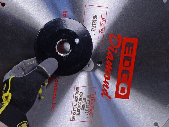

    • Use the two included 1-1/2 inch wrenches to twist the arbor shaft nut counterclockwise while holding the backing plate in place.
  18. EDCO PRO KL-18 Concrete Saw Belts Replacement: crwdns2935265:018crwdnd2935265:01crwdnd2935265:03crwdne2935265:0 EDCO PRO KL-18 Concrete Saw Belts Replacement: crwdns2935265:018crwdnd2935265:02crwdnd2935265:03crwdne2935265:0 EDCO PRO KL-18 Concrete Saw Belts Replacement: crwdns2935265:018crwdnd2935265:03crwdnd2935265:03crwdne2935265:0
    • Remove the arbor shaft nut, lock washer, and blade cap from the arbor shaft.
  19. EDCO PRO KL-18 Concrete Saw Belts Replacement: crwdns2935265:019crwdnd2935265:01crwdnd2935265:03crwdne2935265:0 EDCO PRO KL-18 Concrete Saw Belts Replacement: crwdns2935265:019crwdnd2935265:02crwdnd2935265:03crwdne2935265:0 EDCO PRO KL-18 Concrete Saw Belts Replacement: crwdns2935265:019crwdnd2935265:03crwdnd2935265:03crwdne2935265:0
    • Remove the blade.

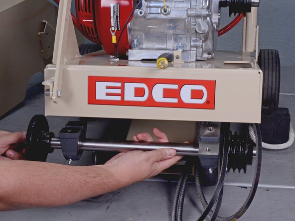

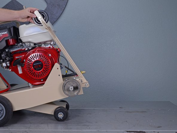

  20. EDCO PRO KL-18 Concrete Saw Belts Replacement, Remove the arbor shaft: crwdns2935265:020crwdnd2935265:01crwdnd2935265:03crwdne2935265:0 EDCO PRO KL-18 Concrete Saw Belts Replacement, Remove the arbor shaft: crwdns2935265:020crwdnd2935265:02crwdnd2935265:03crwdne2935265:0 EDCO PRO KL-18 Concrete Saw Belts Replacement, Remove the arbor shaft: crwdns2935265:020crwdnd2935265:03crwdnd2935265:03crwdne2935265:0
    • Lift the guide bar back up off the ground into its vertical position.
  21. EDCO PRO KL-18 Concrete Saw Belts Replacement: crwdns2935265:021crwdnd2935265:01crwdnd2935265:01crwdne2935265:0

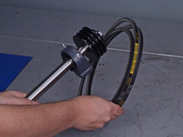

    • Use a 9/16 inch socket to remove the four bolts securing the arbor shaft bearings to the frame.
    • If necessary, have a second person hold the arbor shaft to prevent it from hitting the ground.
  22. EDCO PRO KL-18 Concrete Saw Belts Replacement: crwdns2935265:022crwdnd2935265:01crwdnd2935265:02crwdne2935265:0 EDCO PRO KL-18 Concrete Saw Belts Replacement: crwdns2935265:022crwdnd2935265:02crwdnd2935265:02crwdne2935265:0
    • Remove the arbor shaft.
  23. EDCO PRO KL-18 Concrete Saw Belts Replacement, Remove the belts: crwdns2935265:023crwdnd2935265:01crwdnd2935265:02crwdne2935265:0 EDCO PRO KL-18 Concrete Saw Belts Replacement, Remove the belts: crwdns2935265:023crwdnd2935265:02crwdnd2935265:02crwdne2935265:0
    • Remove the belts from the arbor shaft pulley.
