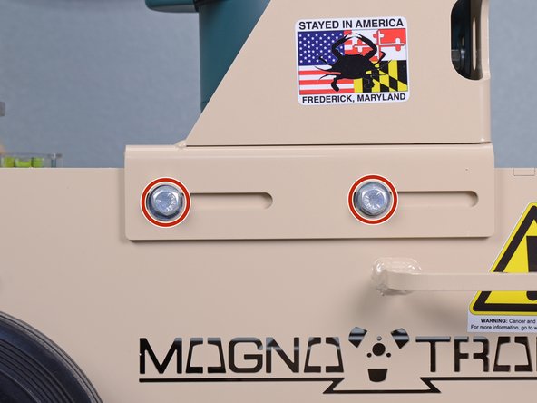

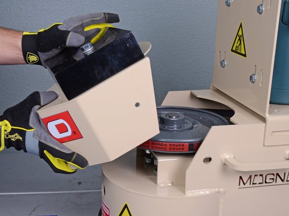

  2. EDCO Disk Grinder 50200-HD Sheave Replacement, Remove the weighted hood: crwdns2935265:02crwdnd2935265:01crwdnd2935265:03crwdne2935265:0 EDCO Disk Grinder 50200-HD Sheave Replacement, Remove the weighted hood: crwdns2935265:02crwdnd2935265:02crwdnd2935265:03crwdne2935265:0 EDCO Disk Grinder 50200-HD Sheave Replacement, Remove the weighted hood: crwdns2935265:02crwdnd2935265:03crwdnd2935265:03crwdne2935265:0

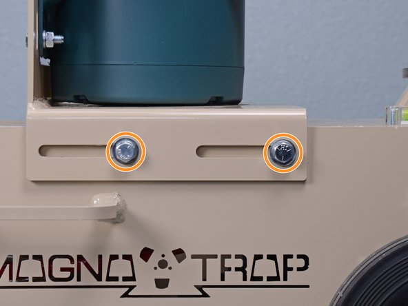

    • Use a 9/16 inch socket to remove the two bolts securing the weighted hood.
    • During reassembly, ensure the bolts are reinstalled with the washers and lock washers in the correct order.

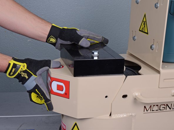

  3. EDCO Disk Grinder 50200-HD Sheave Replacement: crwdns2935265:03crwdnd2935265:01crwdnd2935265:03crwdne2935265:0 EDCO Disk Grinder 50200-HD Sheave Replacement: crwdns2935265:03crwdnd2935265:02crwdnd2935265:03crwdne2935265:0 EDCO Disk Grinder 50200-HD Sheave Replacement: crwdns2935265:03crwdnd2935265:03crwdnd2935265:03crwdne2935265:0
    • Remove the weighted hood.
    • The weighted hood weighs 37 pounds. Wear gloves and handle with caution.

    • Use a 9/16 inch socket to loosen the bolts securing the motor mount.
    • Do not completely remove the bolts.

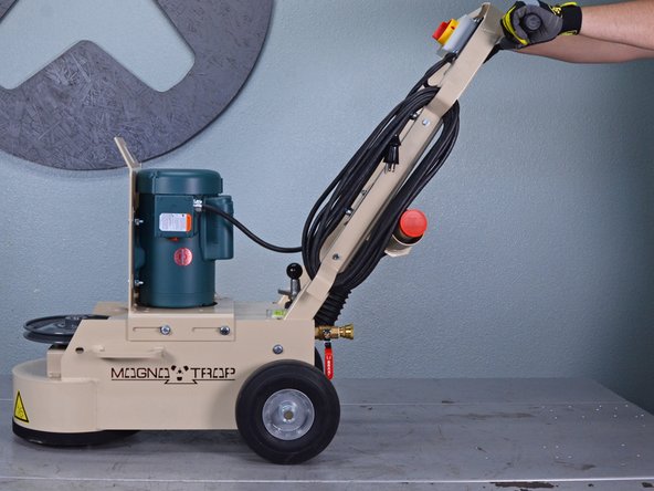

  6. EDCO Disk Grinder 50200-HD Sheave Replacement: crwdns2935265:06crwdnd2935265:01crwdnd2935265:03crwdne2935265:0 EDCO Disk Grinder 50200-HD Sheave Replacement: crwdns2935265:06crwdnd2935265:02crwdnd2935265:03crwdne2935265:0 EDCO Disk Grinder 50200-HD Sheave Replacement: crwdns2935265:06crwdnd2935265:03crwdnd2935265:03crwdne2935265:0

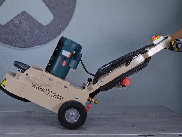

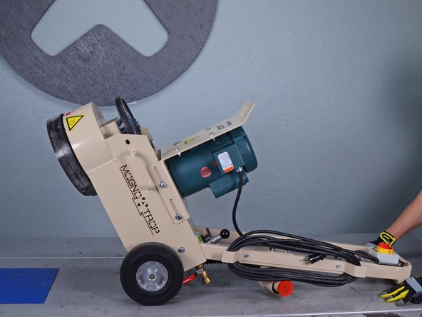

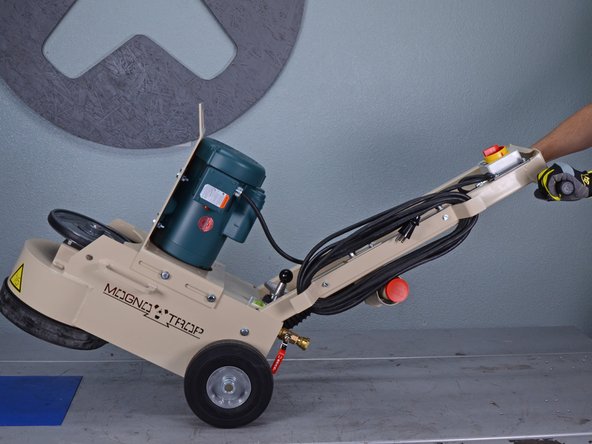

    • Tilt the front of the machine up and rest the handlebars on the ground.
    • Have someone hold down the handlebars to prevent tipping while working on the belt.

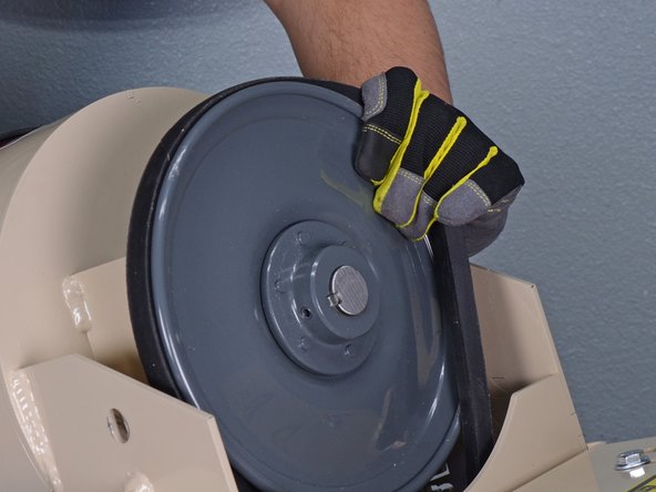

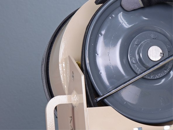

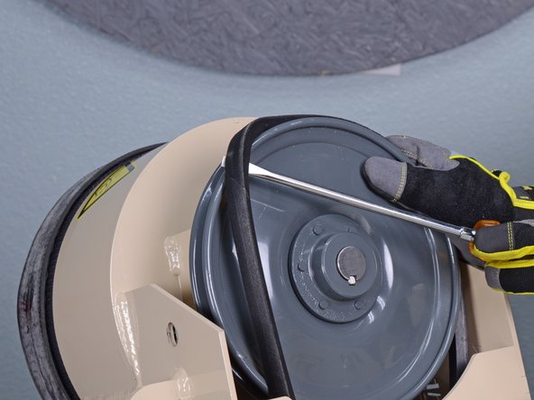

  7. EDCO Disk Grinder 50200-HD Sheave Replacement: crwdns2935265:07crwdnd2935265:01crwdnd2935265:03crwdne2935265:0 EDCO Disk Grinder 50200-HD Sheave Replacement: crwdns2935265:07crwdnd2935265:02crwdnd2935265:03crwdne2935265:0 EDCO Disk Grinder 50200-HD Sheave Replacement: crwdns2935265:07crwdnd2935265:03crwdnd2935265:03crwdne2935265:0

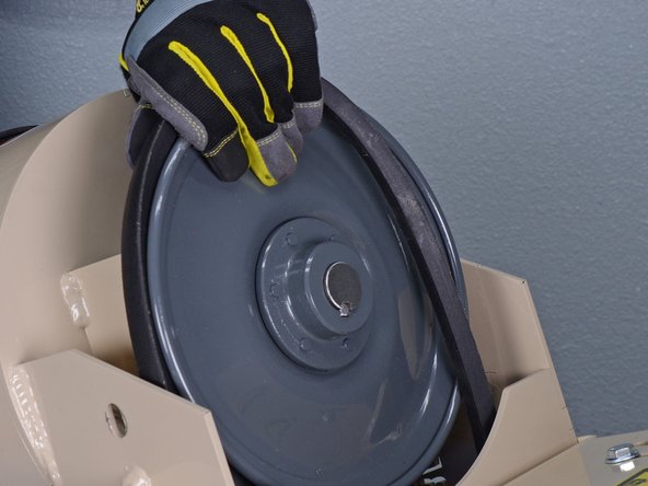

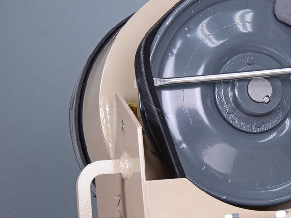

    • Pinch a flathead screwdriver between the belt and sheave.
    • Rotate the sheave and pivot the belt up and away from its groove.
  8. EDCO Disk Grinder 50200-HD Sheave Replacement: crwdns2935265:08crwdnd2935265:01crwdnd2935265:02crwdne2935265:0 EDCO Disk Grinder 50200-HD Sheave Replacement: crwdns2935265:08crwdnd2935265:02crwdnd2935265:02crwdne2935265:0
    • Continue to rotate the sheave with once hand while holding the flathead screwdriver with the other to fully dislodge the belt from the groove.

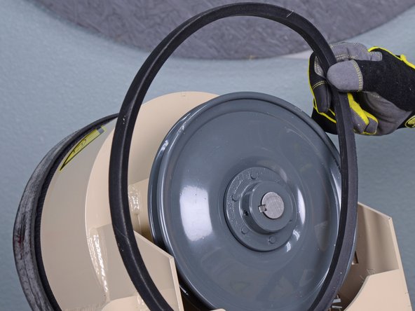

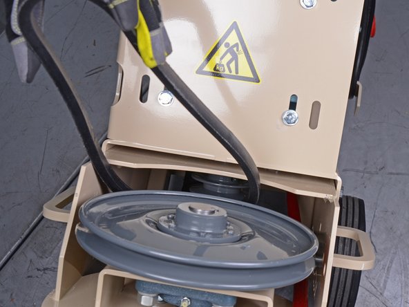

  9. EDCO Disk Grinder 50200-HD Sheave Replacement: crwdns2935265:09crwdnd2935265:01crwdnd2935265:03crwdne2935265:0 EDCO Disk Grinder 50200-HD Sheave Replacement: crwdns2935265:09crwdnd2935265:02crwdnd2935265:03crwdne2935265:0 EDCO Disk Grinder 50200-HD Sheave Replacement: crwdns2935265:09crwdnd2935265:03crwdnd2935265:03crwdne2935265:0
    • Remove the belt from the motor pulley, then fully remove it from the machine.
    • Reassembly tip: loop the belt around the motor pulley before placing it on the sheave.

    • Tilt the machine back into working position.

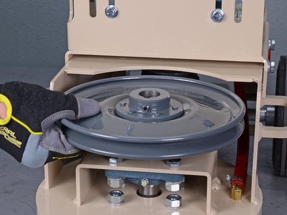

  12. EDCO Disk Grinder 50200-HD Sheave Replacement, Remove the sheave: crwdns2935265:012crwdnd2935265:01crwdnd2935265:01crwdne2935265:0

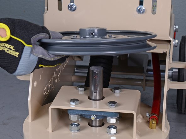

    • Use a 5/32 inch hex wrench to loosen the set screw securing the sheave to the head assembly shaft.
    • If the set screw is seized, use an impact driver with a 5/32 inch hex socket to loosen it.
  13. EDCO Disk Grinder 50200-HD Sheave Replacement: crwdns2935265:013crwdnd2935265:01crwdnd2935265:03crwdne2935265:0 EDCO Disk Grinder 50200-HD Sheave Replacement: crwdns2935265:013crwdnd2935265:02crwdnd2935265:03crwdne2935265:0 EDCO Disk Grinder 50200-HD Sheave Replacement: crwdns2935265:013crwdnd2935265:03crwdnd2935265:03crwdne2935265:0
    • Lift the sheave straight up off of the head assembly shaft.
