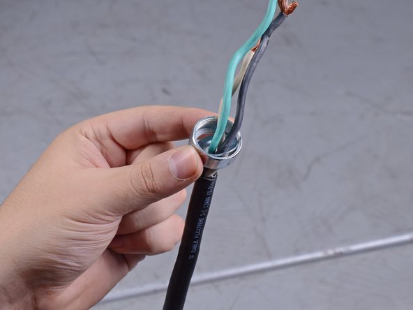

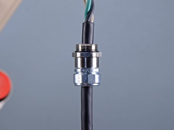

  21. EDCO Disk Grinder 50200-HD Power Cord Replacement, Transfer the strain relief fitting to the new power cord: crwdns2935265:021crwdnd2935265:01crwdnd2935265:02crwdne2935265:0 EDCO Disk Grinder 50200-HD Power Cord Replacement, Transfer the strain relief fitting to the new power cord: crwdns2935265:021crwdnd2935265:02crwdnd2935265:02crwdne2935265:0
    • If the replacement power cord comes with a strain relief fitting pre-installed, skip the remaining steps and begin reassembly.
    • Use two adjustable wrenches to unscrew the strain relief fitting by turning the locknut counterclockwise relative to the strain relief fitting.
    • 1-1/16 inch lock nut
    • 15/16 inch strain relief fitting
    • Reassembly tip: note the length from the end of the power cord to the strain relief fitting. Match this length as close as possible when reinstalling the strain relief fitting.

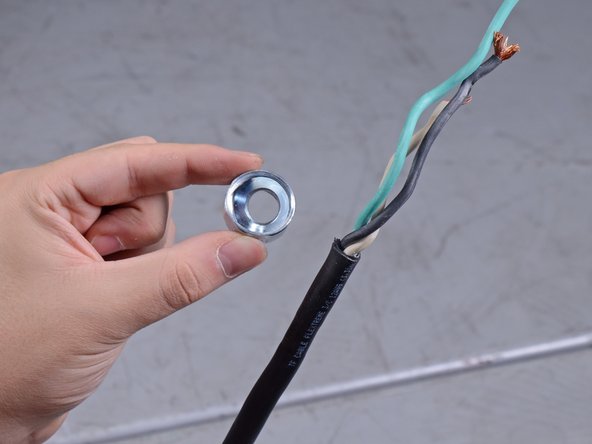

  22. EDCO Disk Grinder 50200-HD Power Cord Replacement: crwdns2935265:022crwdnd2935265:01crwdnd2935265:03crwdne2935265:0 EDCO Disk Grinder 50200-HD Power Cord Replacement: crwdns2935265:022crwdnd2935265:02crwdnd2935265:03crwdne2935265:0 EDCO Disk Grinder 50200-HD Power Cord Replacement: crwdns2935265:022crwdnd2935265:03crwdnd2935265:03crwdne2935265:0

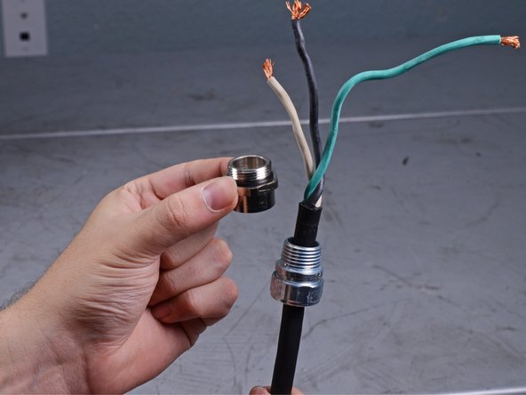

    • Remove the lock nut from the power cord.

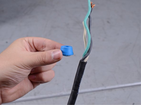

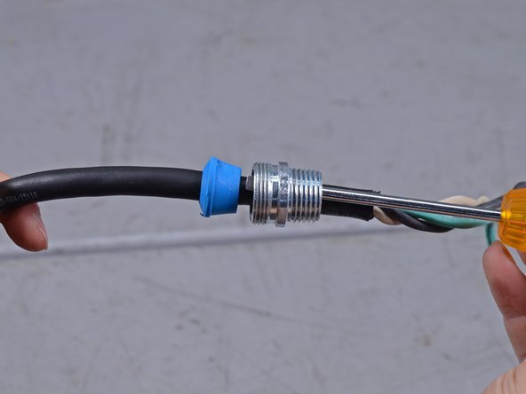

  23. EDCO Disk Grinder 50200-HD Power Cord Replacement: crwdns2935265:023crwdnd2935265:01crwdnd2935265:03crwdne2935265:0 EDCO Disk Grinder 50200-HD Power Cord Replacement: crwdns2935265:023crwdnd2935265:02crwdnd2935265:03crwdne2935265:0 EDCO Disk Grinder 50200-HD Power Cord Replacement: crwdns2935265:023crwdnd2935265:03crwdnd2935265:03crwdne2935265:0

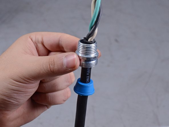

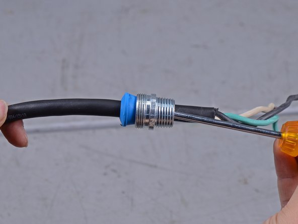

    • Insert a flathead screwdriver into the fitting and push the blue grommet out to remove it from the housing.

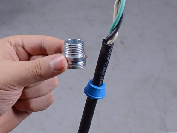

  24. EDCO Disk Grinder 50200-HD Power Cord Replacement: crwdns2935265:024crwdnd2935265:01crwdnd2935265:03crwdne2935265:0 EDCO Disk Grinder 50200-HD Power Cord Replacement: crwdns2935265:024crwdnd2935265:02crwdnd2935265:03crwdne2935265:0 EDCO Disk Grinder 50200-HD Power Cord Replacement: crwdns2935265:024crwdnd2935265:03crwdnd2935265:03crwdne2935265:0
    • Remove the fitting from the power cord.
  25. EDCO Disk Grinder 50200-HD Power Cord Replacement: crwdns2935265:025crwdnd2935265:01crwdnd2935265:03crwdne2935265:0 EDCO Disk Grinder 50200-HD Power Cord Replacement: crwdns2935265:025crwdnd2935265:02crwdnd2935265:03crwdne2935265:0 EDCO Disk Grinder 50200-HD Power Cord Replacement: crwdns2935265:025crwdnd2935265:03crwdnd2935265:03crwdne2935265:0

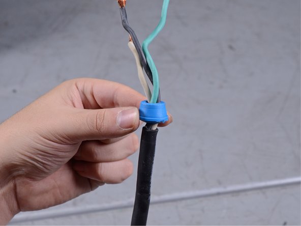

    • Remove the grommet from the power cord.

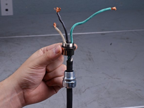

  26. EDCO Disk Grinder 50200-HD Power Cord Replacement: crwdns2935265:026crwdnd2935265:01crwdnd2935265:03crwdne2935265:0 EDCO Disk Grinder 50200-HD Power Cord Replacement: crwdns2935265:026crwdnd2935265:02crwdnd2935265:03crwdne2935265:0 EDCO Disk Grinder 50200-HD Power Cord Replacement: crwdns2935265:026crwdnd2935265:03crwdnd2935265:03crwdne2935265:0
    • Remove the remaining nut and washer from the power cable.
    • These may have slid down the power cable during the previous steps.
  27. EDCO Disk Grinder 50200-HD Power Cord Replacement: crwdns2935265:027crwdnd2935265:01crwdnd2935265:01crwdne2935265:0
    • Only the power cord remains.
