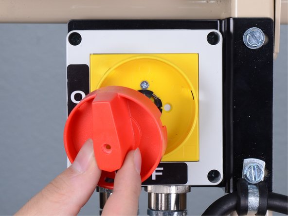

  3. EDCO Disk Grinder 50200-HD On/Off Switch Replacement, Remove the on/off lever screw: crwdns2935265:03crwdnd2935265:01crwdnd2935265:01crwdne2935265:0
    • Use a Phillips screwdriver to remove the screw securing the red on/off lever.
  4. EDCO Disk Grinder 50200-HD On/Off Switch Replacement, Remove the lever: crwdns2935265:04crwdnd2935265:01crwdnd2935265:02crwdne2935265:0 EDCO Disk Grinder 50200-HD On/Off Switch Replacement, Remove the lever: crwdns2935265:04crwdnd2935265:02crwdnd2935265:02crwdne2935265:0
    • Remove the red lever from the on/off switch.

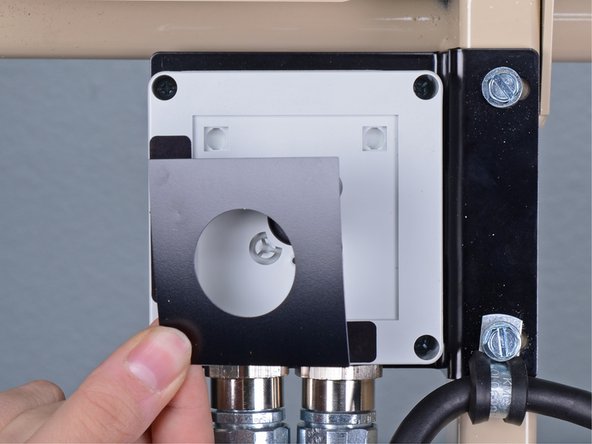

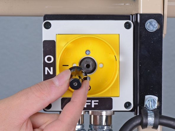

    • Remove the black plastic cap from the center of the switch assembly.
  6. EDCO Disk Grinder 50200-HD On/Off Switch Replacement: crwdns2935265:06crwdnd2935265:01crwdnd2935265:01crwdne2935265:0

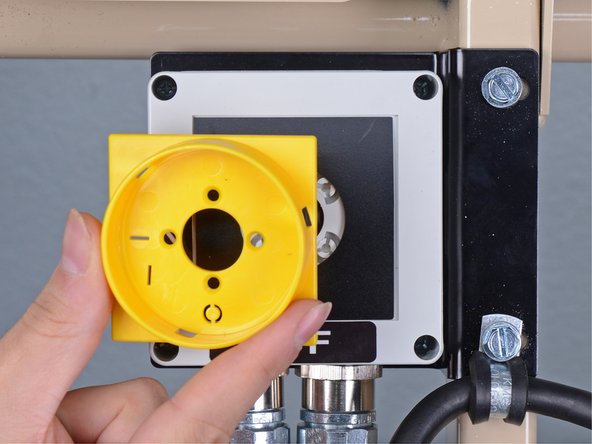

    • Use a Phillips screwdriver to remove the two screws securing the yellow switch guide to the switch assembly.
    • During reassembly, ensure this component is installed in the same orientation, with the circle in the 6 o'clock "OFF" position.
  7. EDCO Disk Grinder 50200-HD On/Off Switch Replacement: crwdns2935265:07crwdnd2935265:01crwdnd2935265:03crwdne2935265:0 EDCO Disk Grinder 50200-HD On/Off Switch Replacement: crwdns2935265:07crwdnd2935265:02crwdnd2935265:03crwdne2935265:0 EDCO Disk Grinder 50200-HD On/Off Switch Replacement: crwdns2935265:07crwdnd2935265:03crwdnd2935265:03crwdne2935265:0
    • Remove the yellow switch guide from the switch assembly.
    • Remove the black plastic spacer from underneath the yellow switch guide.

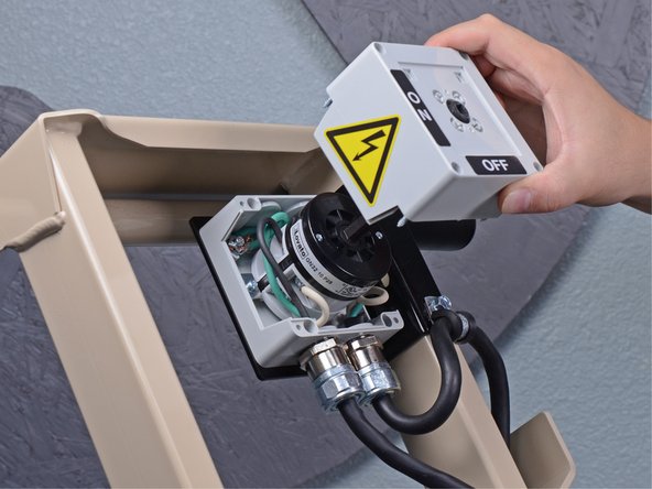

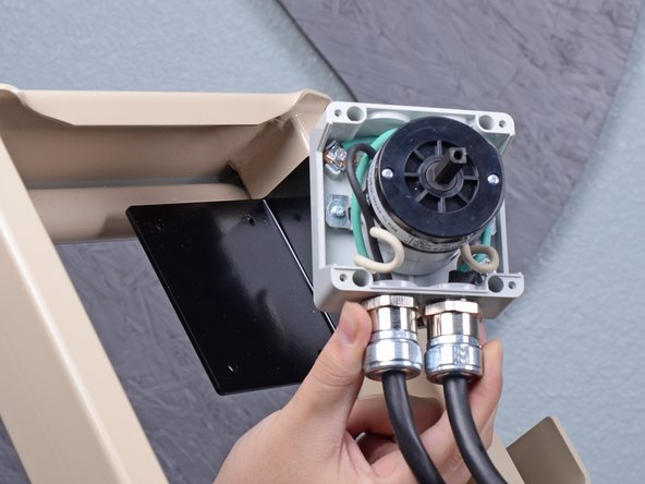

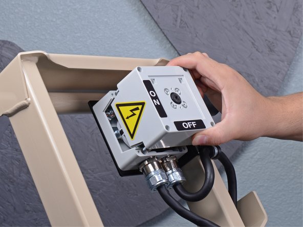

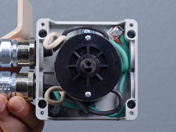

  8. EDCO Disk Grinder 50200-HD On/Off Switch Replacement, Remove the on/off switch housing: crwdns2935265:08crwdnd2935265:01crwdnd2935265:01crwdne2935265:0
    • Use a Phillips screwdriver to remove the four screws securing the upper half of the switch housing to the lower half.
  9. EDCO Disk Grinder 50200-HD On/Off Switch Replacement: crwdns2935265:09crwdnd2935265:01crwdnd2935265:03crwdne2935265:0 EDCO Disk Grinder 50200-HD On/Off Switch Replacement: crwdns2935265:09crwdnd2935265:02crwdnd2935265:03crwdne2935265:0 EDCO Disk Grinder 50200-HD On/Off Switch Replacement: crwdns2935265:09crwdnd2935265:03crwdnd2935265:03crwdne2935265:0
    • Lift the upper half of the housing straight up off of the lower half.

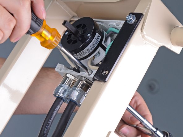

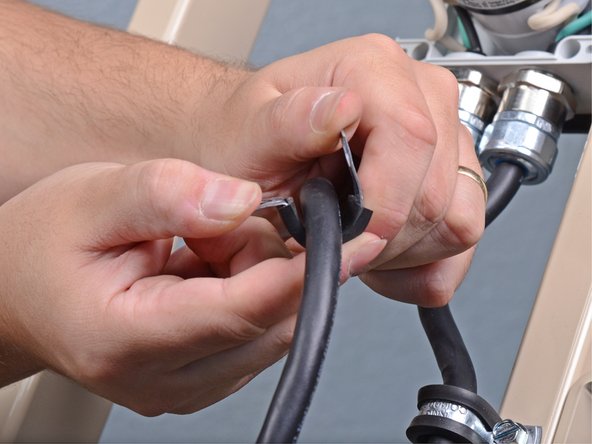

    • Use a 3/8 inch socket to remove the bolt securing the power cord loom clamp to the switch bracket.

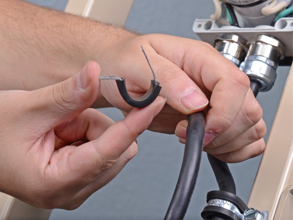

  11. EDCO Disk Grinder 50200-HD On/Off Switch Replacement: crwdns2935265:011crwdnd2935265:01crwdnd2935265:03crwdne2935265:0 EDCO Disk Grinder 50200-HD On/Off Switch Replacement: crwdns2935265:011crwdnd2935265:02crwdnd2935265:03crwdne2935265:0 EDCO Disk Grinder 50200-HD On/Off Switch Replacement: crwdns2935265:011crwdnd2935265:03crwdnd2935265:03crwdne2935265:0
    • Remove the loom clamp from the power cord.
  12. EDCO Disk Grinder 50200-HD On/Off Switch Replacement: crwdns2935265:012crwdnd2935265:01crwdnd2935265:03crwdne2935265:0 EDCO Disk Grinder 50200-HD On/Off Switch Replacement: crwdns2935265:012crwdnd2935265:02crwdnd2935265:03crwdne2935265:0 EDCO Disk Grinder 50200-HD On/Off Switch Replacement: crwdns2935265:012crwdnd2935265:03crwdnd2935265:03crwdne2935265:0

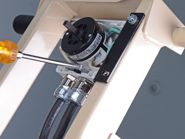

    • Use a 11/32 inch socket to remove the four nuts from the on/off switch bracket.
    • During reassembly, use a Phillips screwdriver in combination with the 11/32 inch socket wrench to tighten the bolts securing the switch to the bracket.
  13. EDCO Disk Grinder 50200-HD On/Off Switch Replacement: crwdns2935265:013crwdnd2935265:01crwdnd2935265:02crwdne2935265:0 EDCO Disk Grinder 50200-HD On/Off Switch Replacement: crwdns2935265:013crwdnd2935265:02crwdnd2935265:02crwdne2935265:0
    • Lift the switch assembly off the switch bracket.

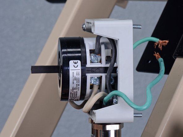

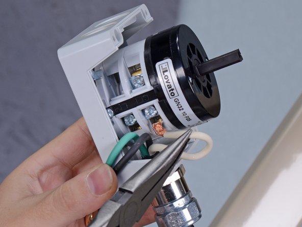

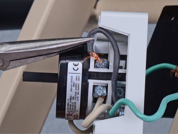

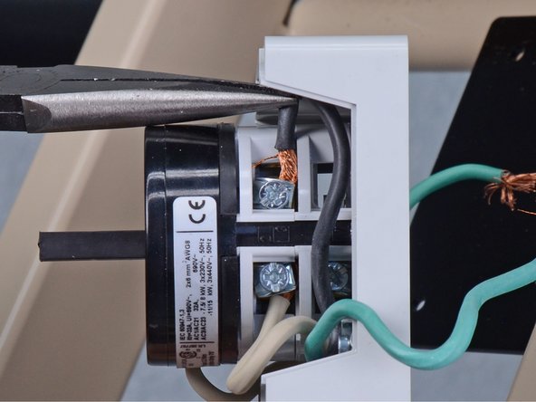

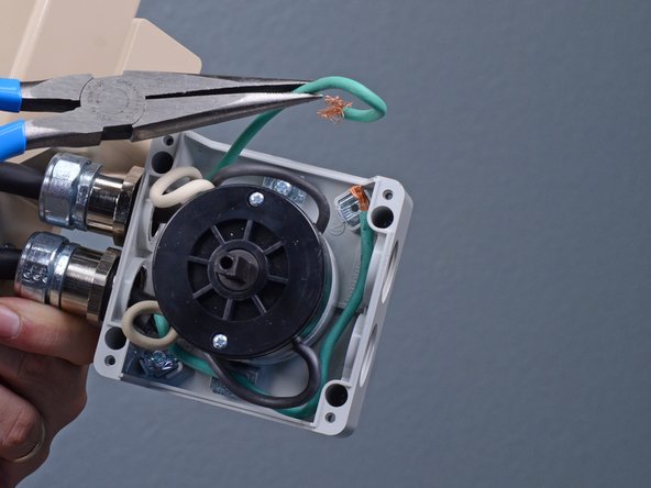

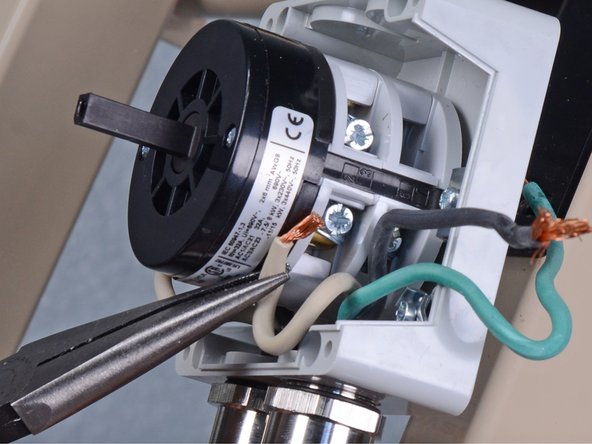

    • Use a flathead screwdriver to remove the screw securing the two green ground wires to the switch housing.
  15. EDCO Disk Grinder 50200-HD On/Off Switch Replacement: crwdns2935265:015crwdnd2935265:01crwdnd2935265:03crwdne2935265:0 EDCO Disk Grinder 50200-HD On/Off Switch Replacement: crwdns2935265:015crwdnd2935265:02crwdnd2935265:03crwdne2935265:0 EDCO Disk Grinder 50200-HD On/Off Switch Replacement: crwdns2935265:015crwdnd2935265:03crwdnd2935265:03crwdne2935265:0
    • Separate the green wires from each other and move them away from the switch housing.
  16. EDCO Disk Grinder 50200-HD On/Off Switch Replacement: crwdns2935265:016crwdnd2935265:01crwdnd2935265:02crwdne2935265:0 EDCO Disk Grinder 50200-HD On/Off Switch Replacement: crwdns2935265:016crwdnd2935265:02crwdnd2935265:02crwdne2935265:0

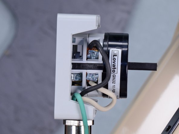

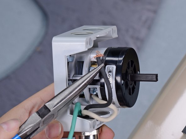

    • Use a flathead screwdriver to loosen the two screws securing the black and white wires running from the power cord to the switch.
    • During reassembly, ensure each wire in installed in its correct location on the switch.
  17. EDCO Disk Grinder 50200-HD On/Off Switch Replacement: crwdns2935265:017crwdnd2935265:01crwdnd2935265:03crwdne2935265:0 EDCO Disk Grinder 50200-HD On/Off Switch Replacement: crwdns2935265:017crwdnd2935265:02crwdnd2935265:03crwdne2935265:0 EDCO Disk Grinder 50200-HD On/Off Switch Replacement: crwdns2935265:017crwdnd2935265:03crwdnd2935265:03crwdne2935265:0
    • Remove the black wire from the switch.
  18. EDCO Disk Grinder 50200-HD On/Off Switch Replacement: crwdns2935265:018crwdnd2935265:01crwdnd2935265:03crwdne2935265:0 EDCO Disk Grinder 50200-HD On/Off Switch Replacement: crwdns2935265:018crwdnd2935265:02crwdnd2935265:03crwdne2935265:0 EDCO Disk Grinder 50200-HD On/Off Switch Replacement: crwdns2935265:018crwdnd2935265:03crwdnd2935265:03crwdne2935265:0
    • Remove the white wire from the switch.
  19. EDCO Disk Grinder 50200-HD On/Off Switch Replacement: crwdns2935265:019crwdnd2935265:01crwdnd2935265:03crwdne2935265:0 EDCO Disk Grinder 50200-HD On/Off Switch Replacement: crwdns2935265:019crwdnd2935265:02crwdnd2935265:03crwdne2935265:0 EDCO Disk Grinder 50200-HD On/Off Switch Replacement: crwdns2935265:019crwdnd2935265:03crwdnd2935265:03crwdne2935265:0

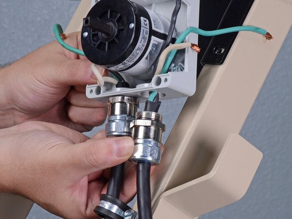

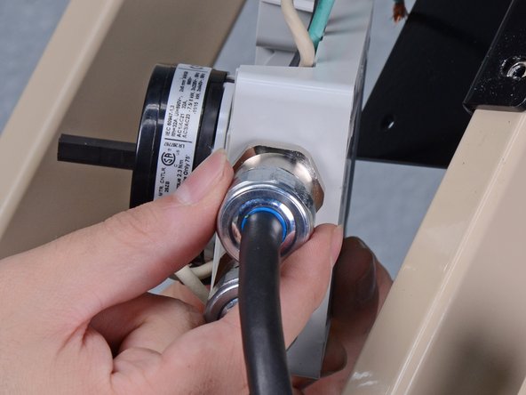

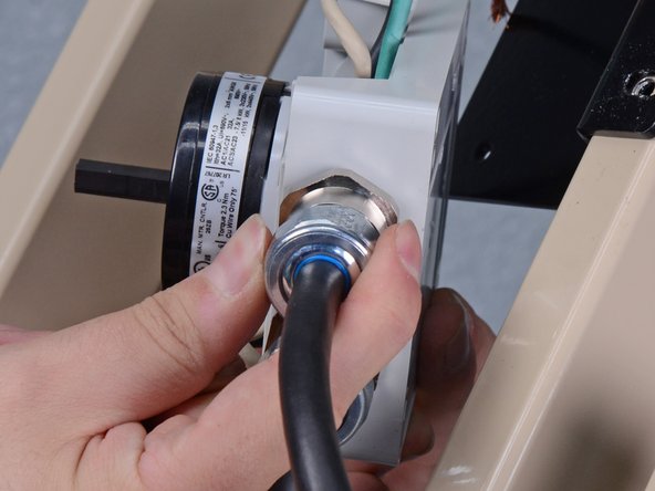

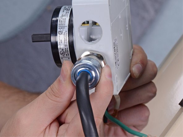

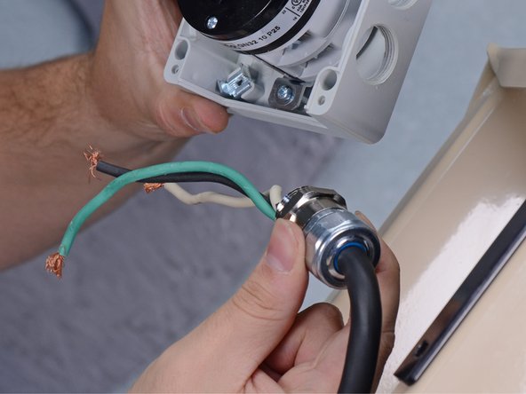

    • Use a 1-1/16 inch wrench or an adjustable wrench to loosen the power cord's strain relief fitting from the switch housing.
    • Once the fitting is loose enough to turn by hand, twist the power cord and fitting counterclockwise until it is fully unthreaded from the switch housing.
  20. EDCO Disk Grinder 50200-HD On/Off Switch Replacement: crwdns2935265:020crwdnd2935265:01crwdnd2935265:03crwdne2935265:0 EDCO Disk Grinder 50200-HD On/Off Switch Replacement: crwdns2935265:020crwdnd2935265:02crwdnd2935265:03crwdne2935265:0 EDCO Disk Grinder 50200-HD On/Off Switch Replacement: crwdns2935265:020crwdnd2935265:03crwdnd2935265:03crwdne2935265:0
    • Remove the power cord from the switch.

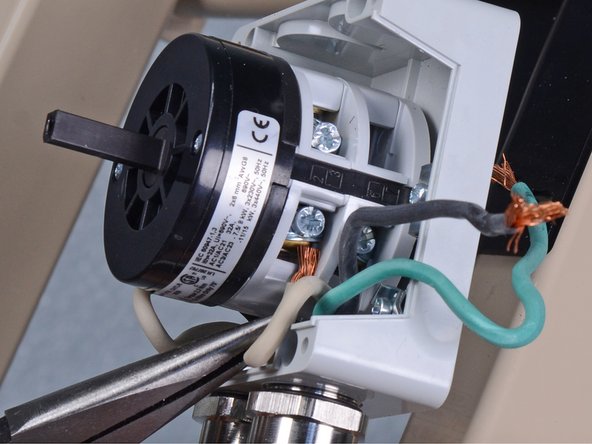

  21. EDCO Disk Grinder 50200-HD On/Off Switch Replacement, Remove the on/off switch: crwdns2935265:021crwdnd2935265:01crwdnd2935265:02crwdne2935265:0 EDCO Disk Grinder 50200-HD On/Off Switch Replacement, Remove the on/off switch: crwdns2935265:021crwdnd2935265:02crwdnd2935265:02crwdne2935265:0

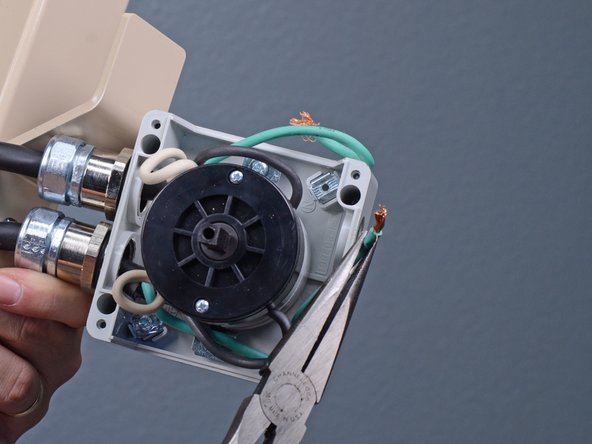

    • Use a flathead screwdriver to loosen the two screws securing the harness's black and white wires to the switch.
  22. EDCO Disk Grinder 50200-HD On/Off Switch Replacement: crwdns2935265:022crwdnd2935265:01crwdnd2935265:02crwdne2935265:0 EDCO Disk Grinder 50200-HD On/Off Switch Replacement: crwdns2935265:022crwdnd2935265:02crwdnd2935265:02crwdne2935265:0
  23. EDCO Disk Grinder 50200-HD On/Off Switch Replacement: crwdns2935265:023crwdnd2935265:01crwdnd2935265:02crwdne2935265:0 EDCO Disk Grinder 50200-HD On/Off Switch Replacement: crwdns2935265:023crwdnd2935265:02crwdnd2935265:02crwdne2935265:0
  24. EDCO Disk Grinder 50200-HD On/Off Switch Replacement: crwdns2935265:024crwdnd2935265:01crwdnd2935265:03crwdne2935265:0 EDCO Disk Grinder 50200-HD On/Off Switch Replacement: crwdns2935265:024crwdnd2935265:02crwdnd2935265:03crwdne2935265:0 EDCO Disk Grinder 50200-HD On/Off Switch Replacement: crwdns2935265:024crwdnd2935265:03crwdnd2935265:03crwdne2935265:0

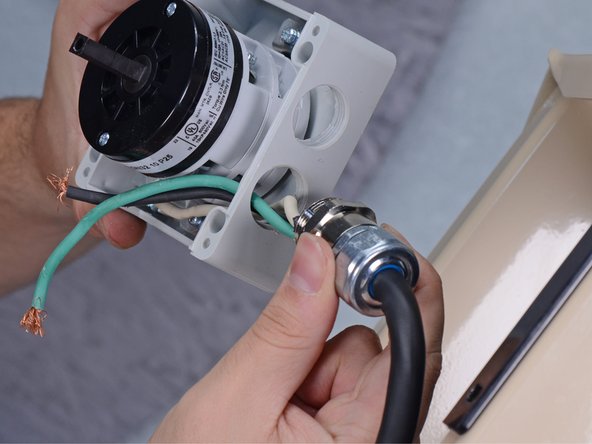

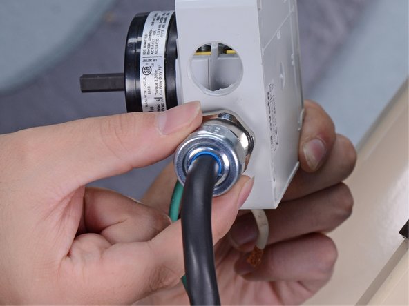

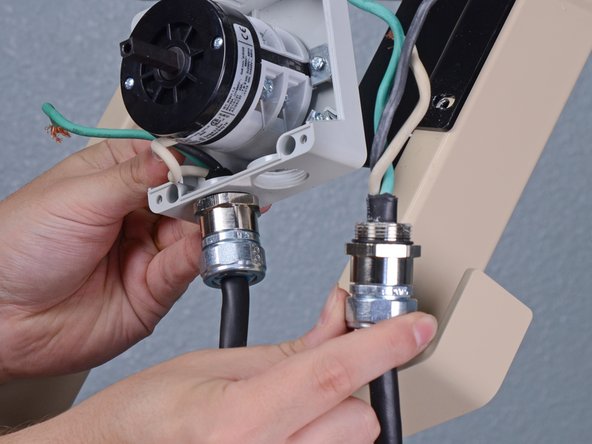

    • Use a 1-1/6 inch wrench or an adjustable wrench to loosen the wiring harness cable's strain relief fitting from the switch housing.
    • Once the fitting is loose enough to turn by hand, twist the wiring harness cable and fitting counterclockwise until it is fully unthreaded from the switch housing.
    • You may need to rotate the switch assembly itself since the wiring harness cable is connected to the device, preventing it from rotating freely.
  25. EDCO Disk Grinder 50200-HD On/Off Switch Replacement: crwdns2935265:025crwdnd2935265:01crwdnd2935265:03crwdne2935265:0 EDCO Disk Grinder 50200-HD On/Off Switch Replacement: crwdns2935265:025crwdnd2935265:02crwdnd2935265:03crwdne2935265:0 EDCO Disk Grinder 50200-HD On/Off Switch Replacement: crwdns2935265:025crwdnd2935265:03crwdnd2935265:03crwdne2935265:0
    • Remove the on/off switch from the auxiliary cable.
