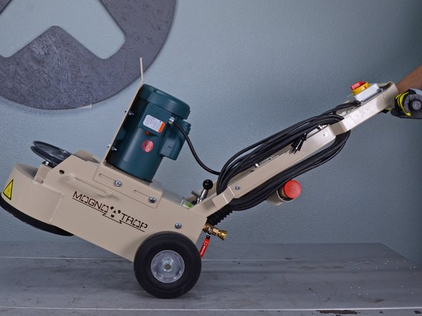

    • Tilt the front of the machine up and rest the handlebars on the ground.
    • Have someone hold down the handlebars to prevent tipping while working on the belt.

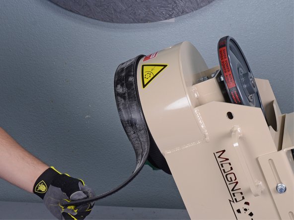

    • Pinch a flathead screwdriver between the belt and sheave.
    • Rotate the sheave and pivot the belt up and away from its groove.
  8. EDCO Disk Grinder 50200-HD Head Assembly Replacement: crwdns2935265:08crwdnd2935265:01crwdnd2935265:02crwdne2935265:0 EDCO Disk Grinder 50200-HD Head Assembly Replacement: crwdns2935265:08crwdnd2935265:02crwdnd2935265:02crwdne2935265:0
    • Continue to rotate the sheave with once hand while holding the flathead screwdriver with the other to fully dislodge the belt from the groove.

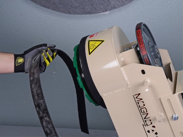

  9. EDCO Disk Grinder 50200-HD Head Assembly Replacement: crwdns2935265:09crwdnd2935265:01crwdnd2935265:03crwdne2935265:0 EDCO Disk Grinder 50200-HD Head Assembly Replacement: crwdns2935265:09crwdnd2935265:02crwdnd2935265:03crwdne2935265:0 EDCO Disk Grinder 50200-HD Head Assembly Replacement: crwdns2935265:09crwdnd2935265:03crwdnd2935265:03crwdne2935265:0
    • Remove the belt from the motor pulley, then fully remove it from the machine.
    • Reassembly tip: loop the belt around the motor pulley before placing it on the sheave.
  10. EDCO Disk Grinder 50200-HD Head Assembly Replacement, Reassembly tip: crwdns2935265:010crwdnd2935265:01crwdnd2935265:03crwdne2935265:0 EDCO Disk Grinder 50200-HD Head Assembly Replacement, Reassembly tip: crwdns2935265:010crwdnd2935265:02crwdnd2935265:03crwdne2935265:0 EDCO Disk Grinder 50200-HD Head Assembly Replacement, Reassembly tip: crwdns2935265:010crwdnd2935265:03crwdnd2935265:03crwdne2935265:0
    • Reassembly tip: place the belt over the rim and rotate the sheave to guide the belt into the groove.

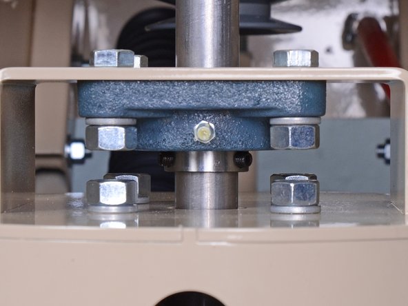

  13. EDCO Disk Grinder 50200-HD Head Assembly Replacement, Remove the sheave: crwdns2935265:013crwdnd2935265:01crwdnd2935265:01crwdne2935265:0
    • Use a 5/32 inch hex wrench to loosen the set screw securing the sheave to the head assembly shaft.
    • If the set screw is seized, use an impact driver with a 5/32 inch hex socket to loosen it.
  14. EDCO Disk Grinder 50200-HD Head Assembly Replacement: crwdns2935265:014crwdnd2935265:01crwdnd2935265:03crwdne2935265:0 EDCO Disk Grinder 50200-HD Head Assembly Replacement: crwdns2935265:014crwdnd2935265:02crwdnd2935265:03crwdne2935265:0 EDCO Disk Grinder 50200-HD Head Assembly Replacement: crwdns2935265:014crwdnd2935265:03crwdnd2935265:03crwdne2935265:0
    • Lift the sheave straight up off of the head assembly shaft.
  15. EDCO Disk Grinder 50200-HD Head Assembly Replacement, Remove the head assembly: crwdns2935265:015crwdnd2935265:01crwdnd2935265:01crwdne2935265:0
    • Remove the key from the head assembly shaft.
  16. EDCO Disk Grinder 50200-HD Head Assembly Replacement: crwdns2935265:016crwdnd2935265:01crwdnd2935265:02crwdne2935265:0 EDCO Disk Grinder 50200-HD Head Assembly Replacement: crwdns2935265:016crwdnd2935265:02crwdnd2935265:02crwdne2935265:0

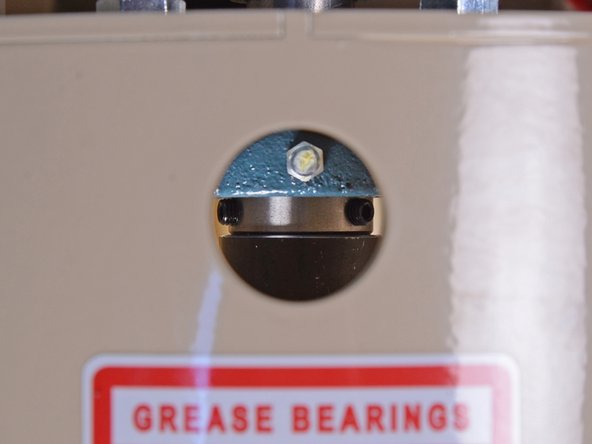

    • Use a 5/32 inch hex bit with an extension to loosen the two set screws securing the head assembly shaft to the upper bearing.
  17. EDCO Disk Grinder 50200-HD Head Assembly Replacement: crwdns2935265:017crwdnd2935265:01crwdnd2935265:02crwdne2935265:0 EDCO Disk Grinder 50200-HD Head Assembly Replacement: crwdns2935265:017crwdnd2935265:02crwdnd2935265:02crwdne2935265:0
    • Use a 5/32 inch hex bit with an extension to loosen the two set screws securing the head assembly shaft to the lower bearing.
    • The set screws can be accessed through the opening in the shroud on the front of the machine.

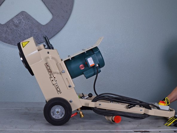

  18. EDCO Disk Grinder 50200-HD Head Assembly Replacement, Tilt the machine: crwdns2935265:018crwdnd2935265:01crwdnd2935265:03crwdne2935265:0 EDCO Disk Grinder 50200-HD Head Assembly Replacement, Tilt the machine: crwdns2935265:018crwdnd2935265:02crwdnd2935265:03crwdne2935265:0 EDCO Disk Grinder 50200-HD Head Assembly Replacement, Tilt the machine: crwdns2935265:018crwdnd2935265:03crwdnd2935265:03crwdne2935265:0
    • Tilt the front of the machine up off the ground.
    • Have someone hold down the handlebars to prevent tipping while working on the head assembly.

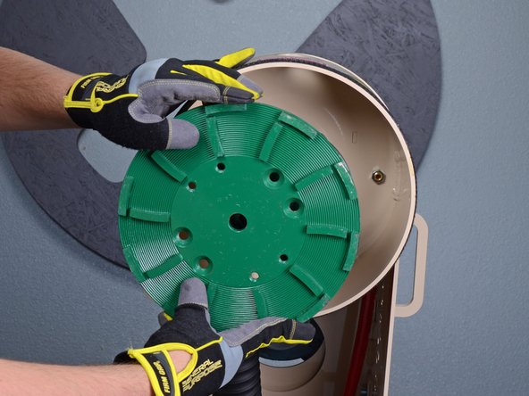

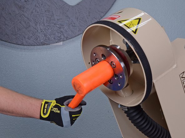

  19. EDCO Disk Grinder 50200-HD Head Assembly Replacement, Remove the disk: crwdns2935265:019crwdnd2935265:01crwdnd2935265:01crwdne2935265:0
    • Use a 7/32 inch hex key to remove the four flat screws securing the disk to the head assembly.
  20. EDCO Disk Grinder 50200-HD Head Assembly Replacement: crwdns2935265:020crwdnd2935265:01crwdnd2935265:02crwdne2935265:0 EDCO Disk Grinder 50200-HD Head Assembly Replacement: crwdns2935265:020crwdnd2935265:02crwdnd2935265:02crwdne2935265:0
    • Wear gloves. The edges of the disk can be sharp.
    • Remove the disk.

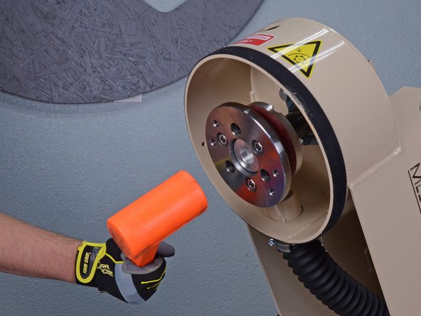

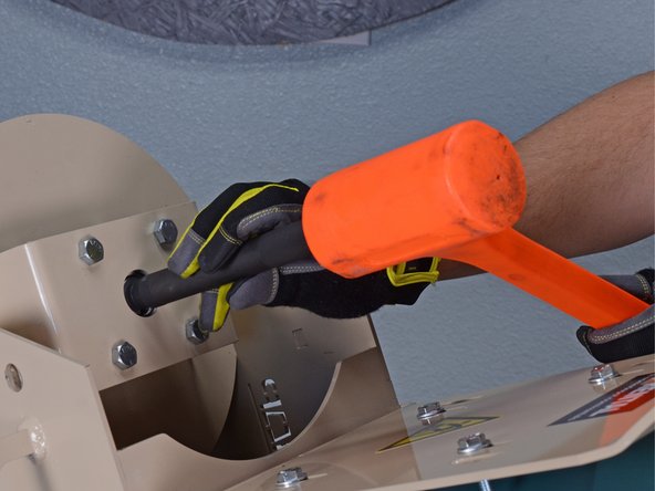

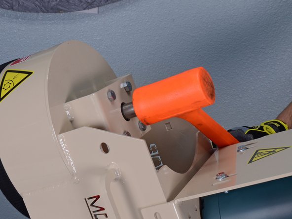

  21. EDCO Disk Grinder 50200-HD Head Assembly Replacement, Hammer the head assembly shaft: crwdns2935265:021crwdnd2935265:01crwdnd2935265:03crwdne2935265:0 EDCO Disk Grinder 50200-HD Head Assembly Replacement, Hammer the head assembly shaft: crwdns2935265:021crwdnd2935265:02crwdnd2935265:03crwdne2935265:0 EDCO Disk Grinder 50200-HD Head Assembly Replacement, Hammer the head assembly shaft: crwdns2935265:021crwdnd2935265:03crwdnd2935265:03crwdne2935265:0
    • Use a dead blow hammer to hit the head assembly shaft straight down until it is flush with the upper bearing bracket, or as far as it will go.

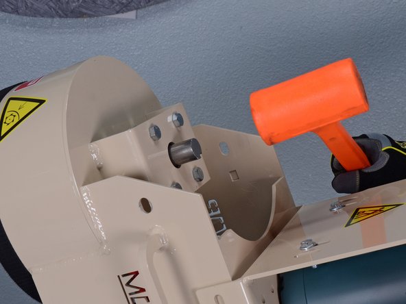

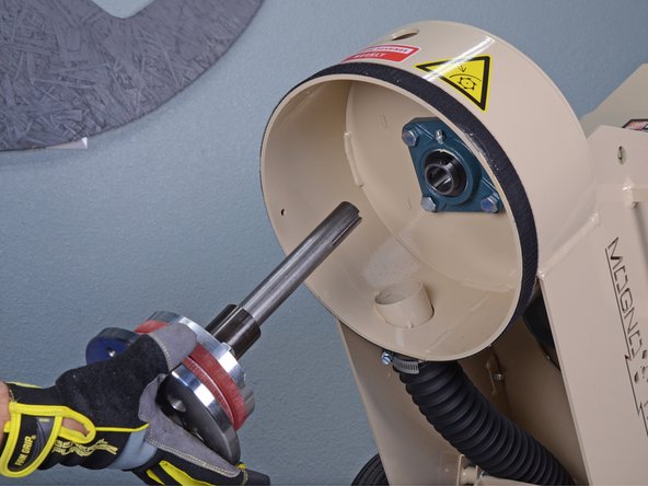

  22. EDCO Disk Grinder 50200-HD Head Assembly Replacement: crwdns2935265:022crwdnd2935265:01crwdnd2935265:02crwdne2935265:0 EDCO Disk Grinder 50200-HD Head Assembly Replacement: crwdns2935265:022crwdnd2935265:02crwdnd2935265:02crwdne2935265:0
    • Use an appropriately-sized punch to knock the head assembly the rest of the way out.
    • Once the head assembly shaft clears the last bearing, it will fall out. If necessary, have someone hold it to prevent it from hitting the ground.
  23. EDCO Disk Grinder 50200-HD Head Assembly Replacement: crwdns2935265:023crwdnd2935265:01crwdnd2935265:02crwdne2935265:0 EDCO Disk Grinder 50200-HD Head Assembly Replacement: crwdns2935265:023crwdnd2935265:02crwdnd2935265:02crwdne2935265:0
    • Remove the head assembly.
  24. EDCO Disk Grinder 50200-HD Head Assembly Replacement, Reassembly tip: crwdns2935265:024crwdnd2935265:01crwdnd2935265:03crwdne2935265:0 EDCO Disk Grinder 50200-HD Head Assembly Replacement, Reassembly tip: crwdns2935265:024crwdnd2935265:02crwdnd2935265:03crwdne2935265:0 EDCO Disk Grinder 50200-HD Head Assembly Replacement, Reassembly tip: crwdns2935265:024crwdnd2935265:03crwdnd2935265:03crwdne2935265:0
    • During reassembly:
    • Insert the new head assembly up into the bearing as far as you can by hand.
    • Use a dead blow hammer to knock the head assembly up into the machine until there is no play in the shaft spacer.
    • Ensure there is no play in the shaft spacer before tightening the set screws onto the new head assembly.
