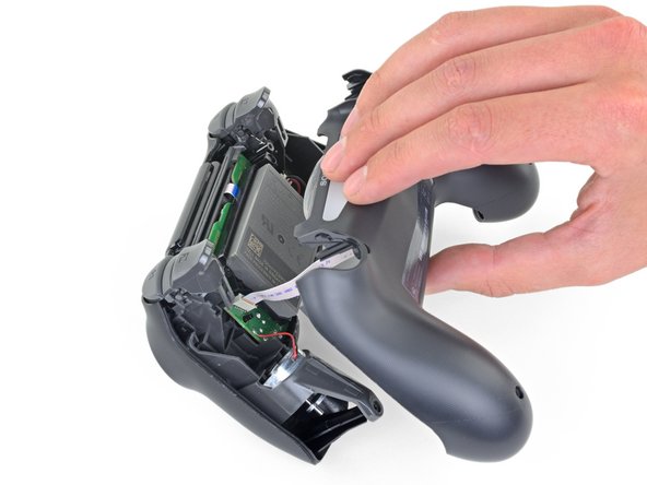

  4. DualShock 4 CUH-ZCT2 Joystick Covers Replacement, Remove the rear panel: crwdns2935265:04crwdnd2935265:01crwdnd2935265:02crwdne2935265:0 DualShock 4 CUH-ZCT2 Joystick Covers Replacement, Remove the rear panel: crwdns2935265:04crwdnd2935265:02crwdnd2935265:02crwdne2935265:0
    • Lift the rear panel directly away from the controller.
    • Do not completely remove the rear panel. It is still attached to the controller by a ribbon cable.
  5. DualShock 4 CUH-ZCT2 Joystick Covers Replacement: crwdns2935265:05crwdnd2935265:01crwdnd2935265:02crwdne2935265:0 DualShock 4 CUH-ZCT2 Joystick Covers Replacement: crwdns2935265:05crwdnd2935265:02crwdnd2935265:02crwdne2935265:0
    • Use your fingers to gently pull the ribbon cable straight out of its connector on the motherboard.
    • Since this cable's pull tab is too small to grab with fingers or tweezers, grab the cable itself. Otherwise utilize pull tabs whenever possible.
    • During reassembly, grab the ribbon cable by the blue tab and gently press the cable straight into the connector. Push the blue tab rather than the ribbon cable itself.

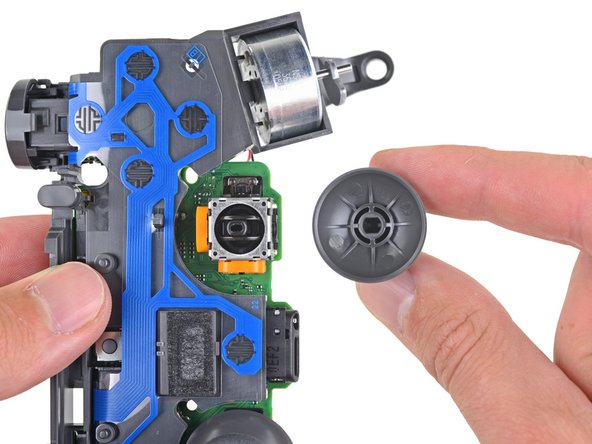

  12. DualShock 4 CUH-ZCT2 Joystick Covers Replacement, Remove the joystick covers: crwdns2935265:012crwdnd2935265:01crwdnd2935265:02crwdne2935265:0 DualShock 4 CUH-ZCT2 Joystick Covers Replacement, Remove the joystick covers: crwdns2935265:012crwdnd2935265:02crwdnd2935265:02crwdne2935265:0
    • Pull the right joystick cover straight off the joystick module to remove it.
  13. DualShock 4 CUH-ZCT2 Joystick Covers Replacement: crwdns2935265:013crwdnd2935265:01crwdnd2935265:02crwdne2935265:0 DualShock 4 CUH-ZCT2 Joystick Covers Replacement: crwdns2935265:013crwdnd2935265:02crwdnd2935265:02crwdne2935265:0
    • Pull the left joystick cover straight off the joystick module to remove it.
  14. DualShock 4 CUH-ZCT2 Joystick Covers Replacement, Reassembly tip: crwdns2935265:014crwdnd2935265:01crwdnd2935265:02crwdne2935265:0 DualShock 4 CUH-ZCT2 Joystick Covers Replacement, Reassembly tip: crwdns2935265:014crwdnd2935265:02crwdnd2935265:02crwdne2935265:0
    • During reassembly, ensure the new joystick covers properly align with the shafts on the joystick modules before pressing them into place.
