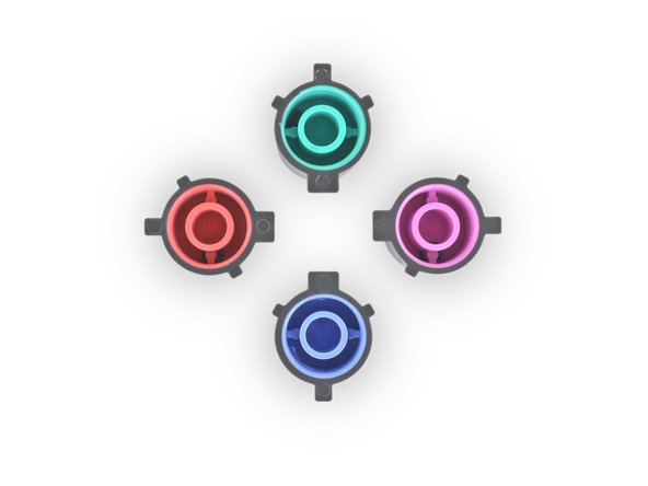

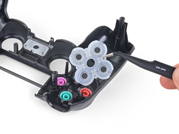

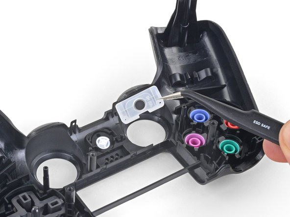

  13. DualShock 4 CUH-ZCT2 Front Panel Replacement, Remove the buttons: crwdns2935265:013crwdnd2935265:01crwdnd2935265:03crwdne2935265:0 DualShock 4 CUH-ZCT2 Front Panel Replacement, Remove the buttons: crwdns2935265:013crwdnd2935265:02crwdnd2935265:03crwdne2935265:0 DualShock 4 CUH-ZCT2 Front Panel Replacement, Remove the buttons: crwdns2935265:013crwdnd2935265:03crwdnd2935265:03crwdne2935265:0
    • Use your fingers or a pair of tweezers to remove the three silicone conductive rubber pads from the controller buttons.
  14. DualShock 4 CUH-ZCT2 Front Panel Replacement: crwdns2935265:014crwdnd2935265:01crwdnd2935265:02crwdne2935265:0 DualShock 4 CUH-ZCT2 Front Panel Replacement: crwdns2935265:014crwdnd2935265:02crwdnd2935265:02crwdne2935265:0
    • Slowly turn over the front panel to let the buttons fall out.
    • Only the front panel remains.
    • The round buttons have unique notches designed to prevent them from being installed incorrectly.
  15. DualShock 4 CUH-ZCT2 Front Panel Replacement, Reassembly tip: crwdns2935265:015crwdnd2935265:01crwdnd2935265:02crwdne2935265:0 DualShock 4 CUH-ZCT2 Front Panel Replacement, Reassembly tip: crwdns2935265:015crwdnd2935265:02crwdnd2935265:02crwdne2935265:0
    • During reassembly, use your fingers or a pair of tweezers to drop the buttons into their respective holes on the front panel.
    • Align the button notches to ensure each one is fully inserted and in the correct location.
