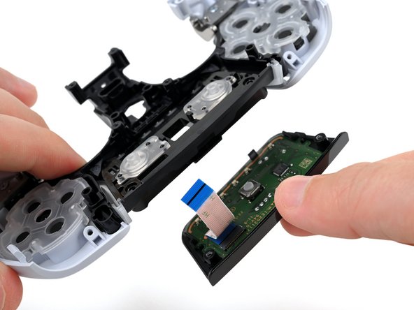

  37. DualSense Edge Touchpad Replacement, Remove the create and option buttons: crwdns2935265:037crwdnd2935265:01crwdnd2935265:03crwdne2935265:0 DualSense Edge Touchpad Replacement, Remove the create and option buttons: crwdns2935265:037crwdnd2935265:02crwdnd2935265:03crwdne2935265:0 DualSense Edge Touchpad Replacement, Remove the create and option buttons: crwdns2935265:037crwdnd2935265:03crwdnd2935265:03crwdne2935265:0
    • Use tweezers or your fingers to lift and remove the Create button and the Option button.
  38. DualSense Edge Touchpad Replacement, Remove the touchpad screws: crwdns2935265:038crwdnd2935265:01crwdnd2935265:01crwdne2935265:0
    • Remove the two 5.5 mm‑long screws securing the touchpad.
  39. DualSense Edge Touchpad Replacement, Remove the touchpad: crwdns2935265:039crwdnd2935265:01crwdnd2935265:02crwdne2935265:0 DualSense Edge Touchpad Replacement, Remove the touchpad: crwdns2935265:039crwdnd2935265:02crwdnd2935265:02crwdne2935265:0
    • Hold the controller in one hand and remove the front of the touchpad with your other hand.
    • The front of the touchpad is securely clipped to the back. You will need to pull firmly.
    • Make sure the touchpad cable does not get caught as it threads through the slot in the touchpad housing.
    • During reassembly:
    • Make sure the replacement touchpad includes a cable. If it does not, transfer the touchpad ribbon cable to the new part.
    • Thread the touchpad cable through its slot in the touchpad housing.
    • Squeeze the two sides of the touchpad together until the snap into place.
  40. DualSense Edge Touchpad Replacement: crwdns2935265:040crwdnd2935265:01crwdnd2935265:02crwdne2935265:0 DualSense Edge Touchpad Replacement: crwdns2935265:040crwdnd2935265:02crwdnd2935265:02crwdne2935265:0
    • Use tweezers or your fingers to grab and remove the back of the touchpad.
