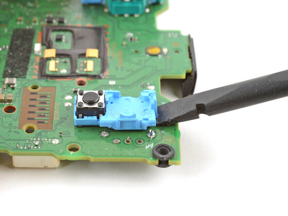

  6. DualSense Controller v2 Joystick Replacement, Remove the L1 button: crwdns2935265:06crwdnd2935265:01crwdnd2935265:03crwdne2935265:0 DualSense Controller v2 Joystick Replacement, Remove the L1 button: crwdns2935265:06crwdnd2935265:02crwdnd2935265:03crwdne2935265:0 DualSense Controller v2 Joystick Replacement, Remove the L1 button: crwdns2935265:06crwdnd2935265:03crwdnd2935265:03crwdne2935265:0
    • Insert the flat end of a spudger into the gap above the L1 button.
    • Cover the button with your thumb to prevent it from ejecting across the room.
    • Pry the spudger upward to remove the L1 button.

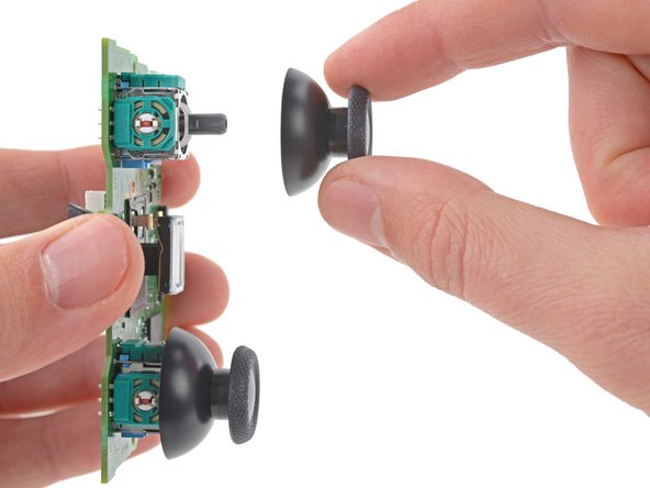

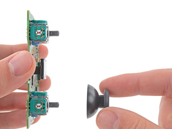

  27. DualSense Controller v2 Joystick Replacement, Remove the joystick covers: crwdns2935265:027crwdnd2935265:01crwdnd2935265:03crwdne2935265:0 DualSense Controller v2 Joystick Replacement, Remove the joystick covers: crwdns2935265:027crwdnd2935265:02crwdnd2935265:03crwdne2935265:0 DualSense Controller v2 Joystick Replacement, Remove the joystick covers: crwdns2935265:027crwdnd2935265:03crwdnd2935265:03crwdne2935265:0
    • Use your fingers to remove the left and right joystick covers from the motherboard.

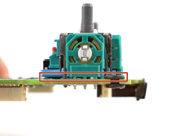

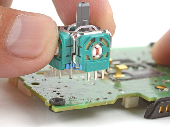

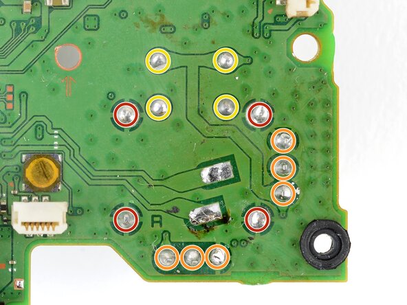

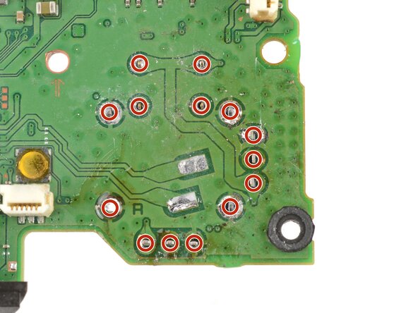

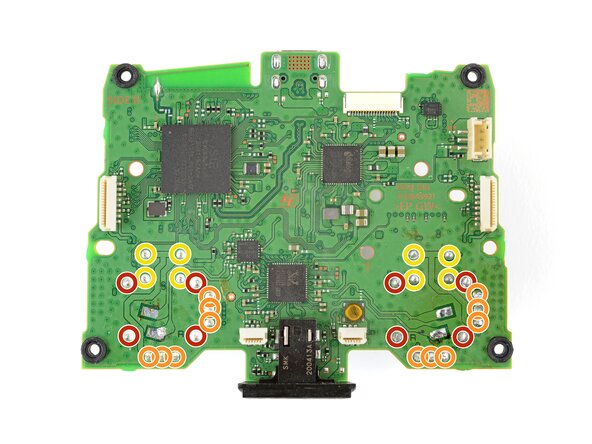

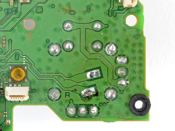

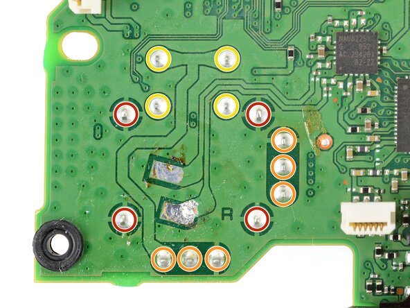

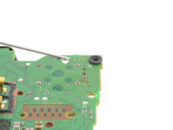

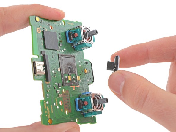

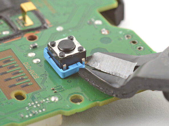

  29. DualSense Controller v2 Joystick Replacement, Solder joint overview: crwdns2935265:029crwdnd2935265:01crwdnd2935265:03crwdne2935265:0 DualSense Controller v2 Joystick Replacement, Solder joint overview: crwdns2935265:029crwdnd2935265:02crwdnd2935265:03crwdne2935265:0 DualSense Controller v2 Joystick Replacement, Solder joint overview: crwdns2935265:029crwdnd2935265:03crwdnd2935265:03crwdne2935265:0
    • Your DualSense motherboard may look slightly different than the images in this guide, but you can still follow the procedure to replace it.
    • Each joystick module is secured with 14 solder joints:
    • Four anchor joints
    • Six joints connecting the two potentiometers
    • Four joystick push-button joints
    • The remaining steps will show how to replace the left joystick (with the controller facing you). You can follow the same procedure to replace the right joystick.

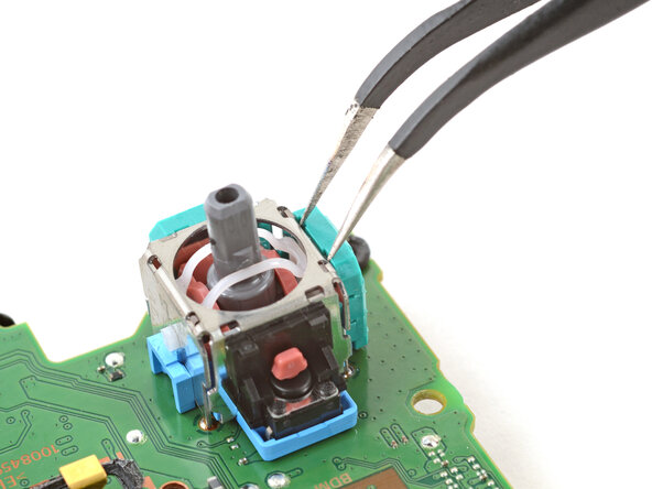

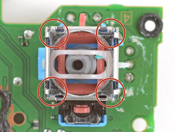

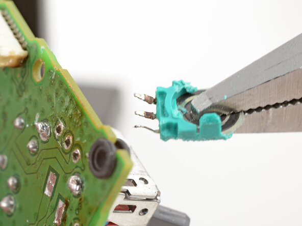

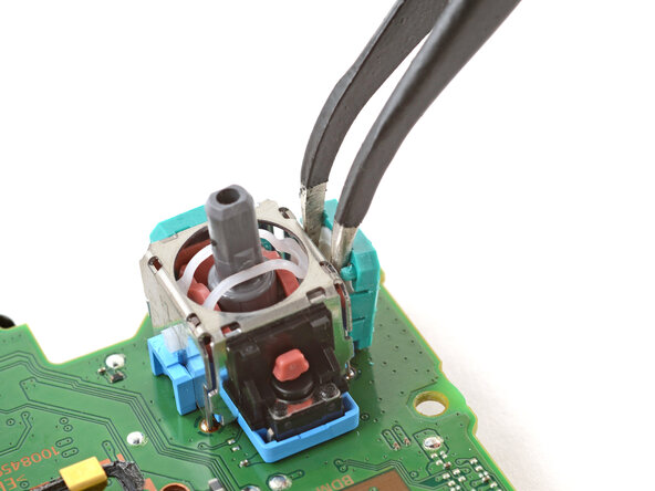

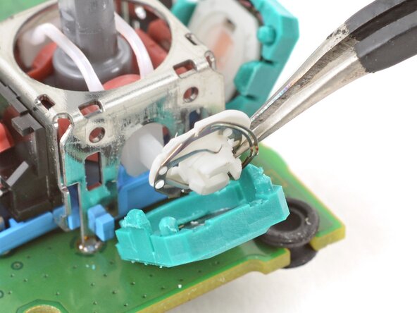

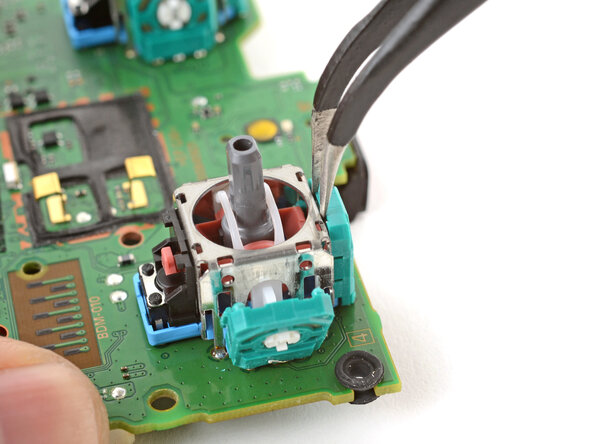

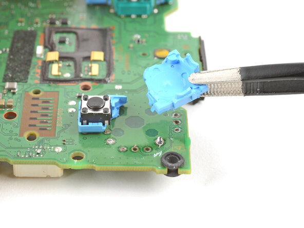

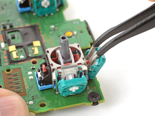

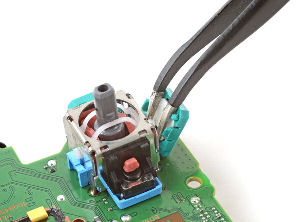

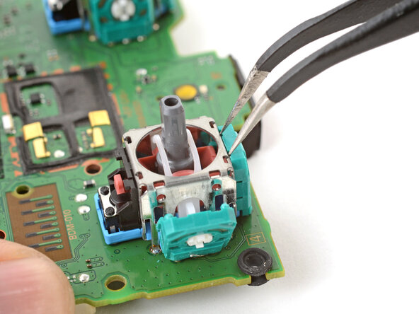

  30. DualSense Controller v2 Joystick Replacement, Prepare the potentiometers: crwdns2935265:030crwdnd2935265:01crwdnd2935265:03crwdne2935265:0 DualSense Controller v2 Joystick Replacement, Prepare the potentiometers: crwdns2935265:030crwdnd2935265:02crwdnd2935265:03crwdne2935265:0 DualSense Controller v2 Joystick Replacement, Prepare the potentiometers: crwdns2935265:030crwdnd2935265:03crwdnd2935265:03crwdne2935265:0
    • Each joystick module has two potentiometers—they're the colored square blocks along two sides of the joystick.
    • Insert the tips of a pair of angled tweezers between the top edge of a potentiometer and the joystick frame.
    • Pivot the tweezers down to bend the top edge of the potentiometer away from the joystick frame.

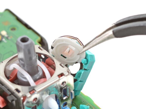

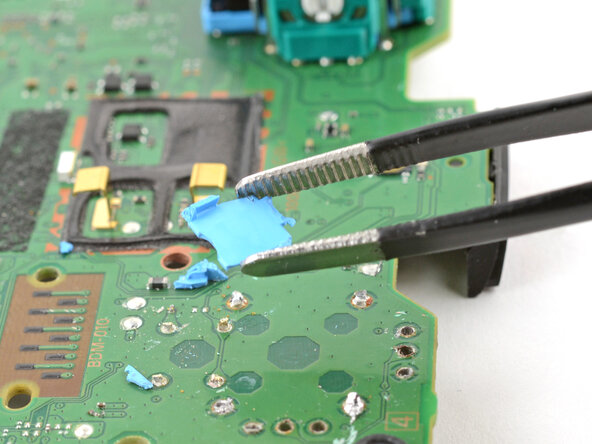

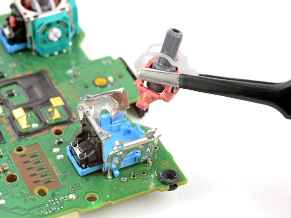

  31. DualSense Controller v2 Joystick Replacement: crwdns2935265:031crwdnd2935265:01crwdnd2935265:03crwdne2935265:0 DualSense Controller v2 Joystick Replacement: crwdns2935265:031crwdnd2935265:02crwdnd2935265:03crwdne2935265:0 DualSense Controller v2 Joystick Replacement: crwdns2935265:031crwdnd2935265:03crwdnd2935265:03crwdne2935265:0
    • Repeat the procedure on the second potentiometer.

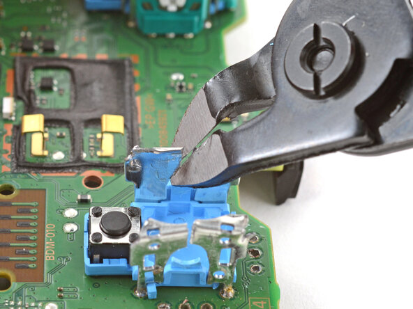

  32. DualSense Controller v2 Joystick Replacement: crwdns2935265:032crwdnd2935265:01crwdnd2935265:02crwdne2935265:0 DualSense Controller v2 Joystick Replacement: crwdns2935265:032crwdnd2935265:02crwdnd2935265:02crwdne2935265:0
    • Use tweezers to remove the wiper mechanisms out of both potentiometers.

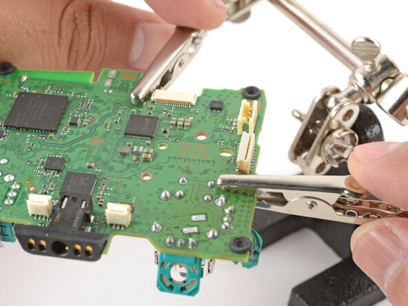

  33. DualSense Controller v2 Joystick Replacement, Secure the motherboard: crwdns2935265:033crwdnd2935265:01crwdnd2935265:01crwdne2935265:0
    Helping Hands
    $9.99
    • Secure the motherboard with helping hands or a similar tool so that the potentiometer solder joints face up.
    • Attach clips to the clear areas on the board to prevent damaging the surface-mounted components.

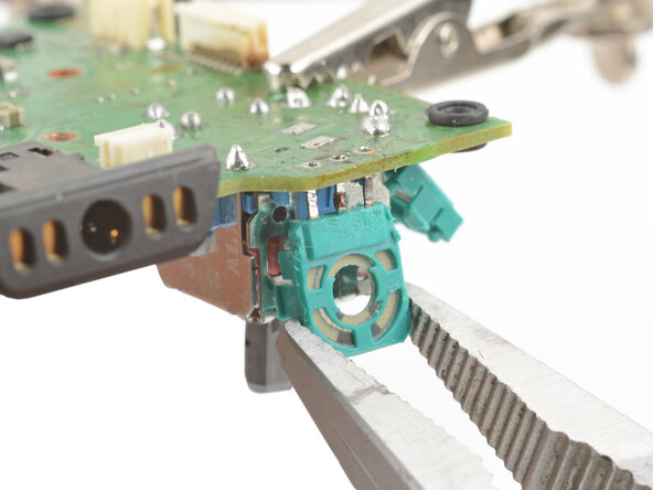

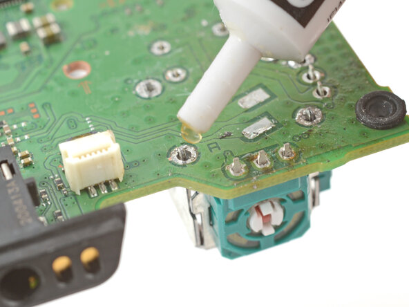

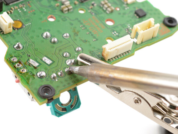

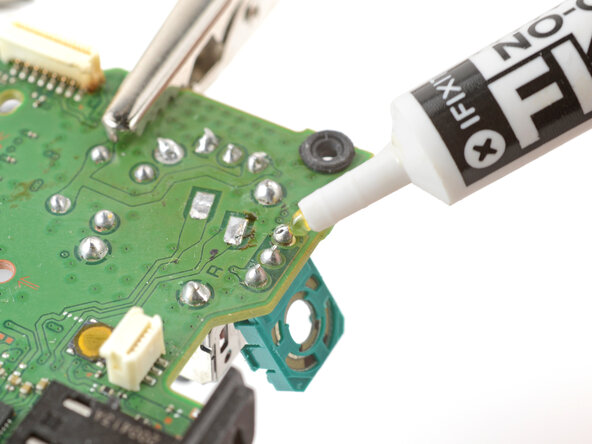

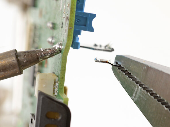

  34. DualSense Controller v2 Joystick Replacement, Desolder the potentiometers: crwdns2935265:034crwdnd2935265:01crwdnd2935265:01crwdne2935265:0
    No-Clean Flux
    $4.95
    • Apply flux to the three solder joints securing one of the potentiometers.
    • Flux improves the flow of molten solder, which makes it easier to work with. If you're having trouble with goopy or sticky solder, apply more flux.

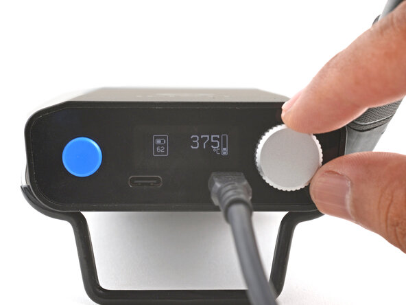

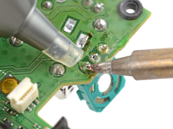

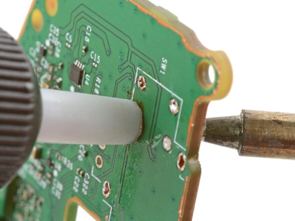

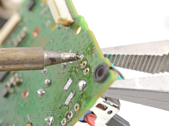

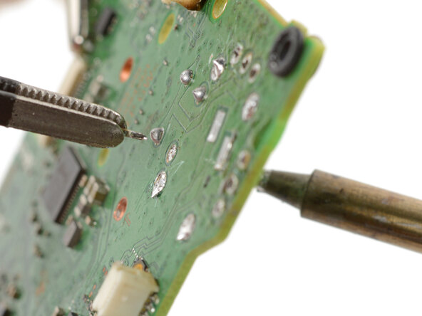

  35. DualSense Controller v2 Joystick Replacement: crwdns2935265:035crwdnd2935265:01crwdnd2935265:01crwdne2935265:0
    • Set the soldering iron to 375–400 °C (~700–750 °F).
    • The DualSense controller has lead-free solder, which requires a higher working temperature than leaded solder.
    • For full instructions on how to desolder through-hole solder joints, follow this guide.
    • Press the soldering iron tip against a potentiometer joint to heat it.
    • Don't heat the joint longer than 15 seconds at a time, or you risk damaging the solder pad.
    • If you're having trouble melting the solder joint, apply some leaded solder onto the soldering iron tip and try again. The leaded solder helps with heat transfer while lowering the melting temperature of the existing lead-free solder joint.
    • Once the joint's molten, use a desoldering pump to suck away the solder.
    • Repeat the heating and sucking procedure a few times on the same joint to remove as much solder as possible. Be sure not to heat the joint longer than 15 seconds at a time.

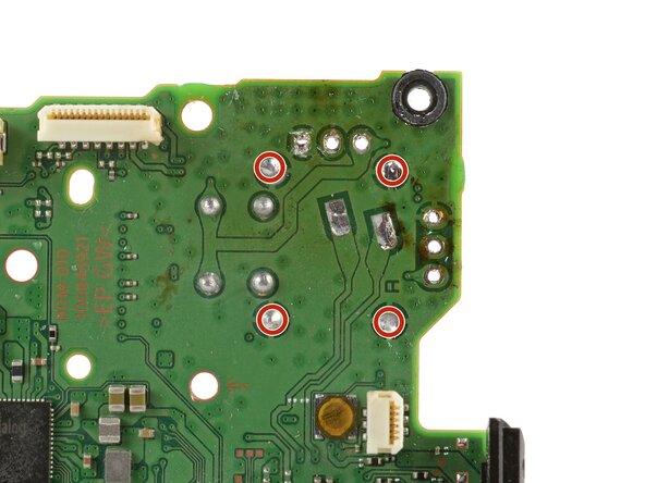

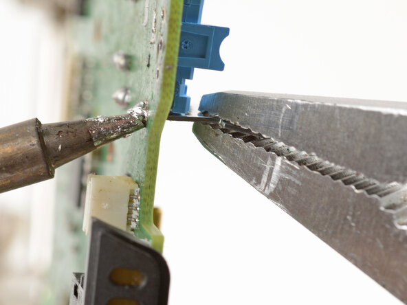

  36. DualSense Controller v2 Joystick Replacement: crwdns2935265:037crwdnd2935265:01crwdnd2935265:01crwdne2935265:0
    • Repeat the procedure on the remaining two potentiometer joints.

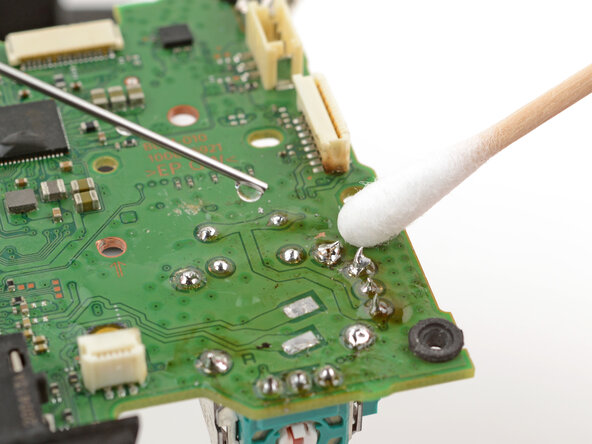

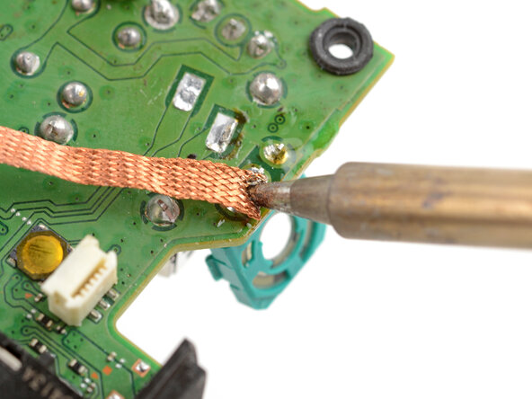

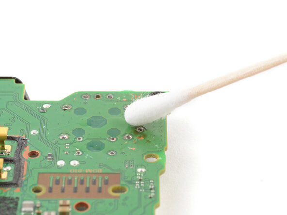

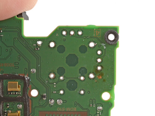

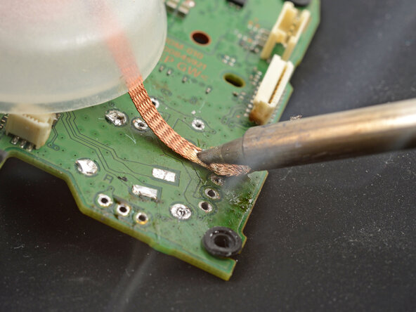

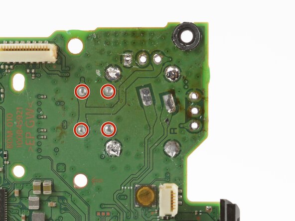

  37. DualSense Controller v2 Joystick Replacement: crwdns2935265:038crwdnd2935265:01crwdnd2935265:01crwdne2935265:0
    • This step shows how to remove residual solder with a solder wick. If the potentiometer feels loose, skip this step.
    • Apply flux to the solder joint.
    • Lay a piece of clean solder wick over the solder joint.
    • Press the tip of the soldering iron over the wick so that the residual solder melts and transfers into the wick.
    • Repeat the process with the remaining two solder joints.

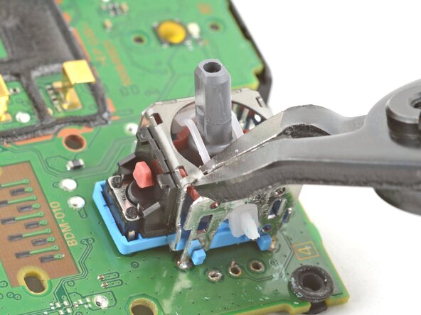

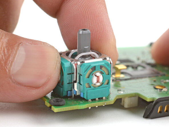

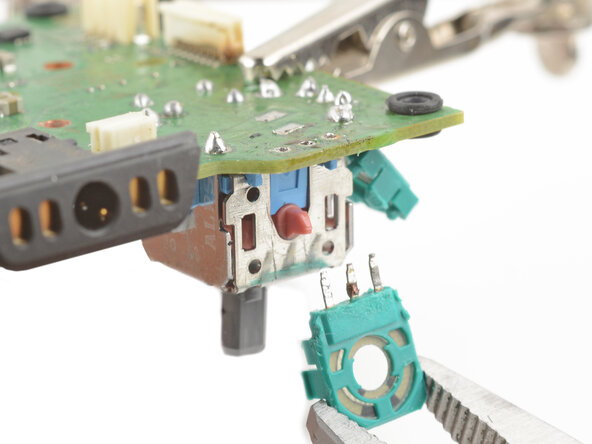

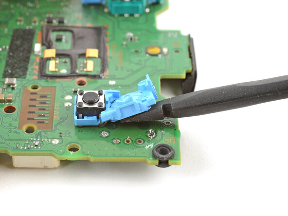

  38. DualSense Controller v2 Joystick Replacement: crwdns2935265:039crwdnd2935265:01crwdnd2935265:03crwdne2935265:0 DualSense Controller v2 Joystick Replacement: crwdns2935265:039crwdnd2935265:02crwdnd2935265:03crwdne2935265:0 DualSense Controller v2 Joystick Replacement: crwdns2935265:039crwdnd2935265:03crwdnd2935265:03crwdne2935265:0
    • Use tweezers or pliers to gently pull the potentiometer away from the board.
    • If the potentiometer feels stuck, repeat the previous three steps to try to remove the residual solder holding the potentiometer in place.
    • You can also try heating each joint as you wiggle the potentiometer out of the board. This is best accomplished with help from a friend.

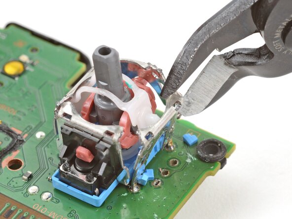

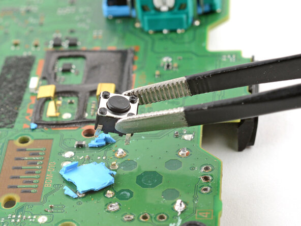

  39. DualSense Controller v2 Joystick Replacement: crwdns2935265:040crwdnd2935265:01crwdnd2935265:03crwdne2935265:0 DualSense Controller v2 Joystick Replacement: crwdns2935265:040crwdnd2935265:02crwdnd2935265:03crwdne2935265:0 DualSense Controller v2 Joystick Replacement: crwdns2935265:040crwdnd2935265:03crwdnd2935265:03crwdne2935265:0
    • Repeat the desoldering procedure to desolder and remove the second potentiometer.
  40. DualSense Controller v2 Joystick Replacement, Cut apart the joystick frame: crwdns2935265:041crwdnd2935265:01crwdnd2935265:03crwdne2935265:0 DualSense Controller v2 Joystick Replacement, Cut apart the joystick frame: crwdns2935265:041crwdnd2935265:02crwdnd2935265:03crwdne2935265:0 DualSense Controller v2 Joystick Replacement, Cut apart the joystick frame: crwdns2935265:041crwdnd2935265:03crwdnd2935265:03crwdne2935265:0
    • The next few steps show how to break apart and desolder the joystick frame.

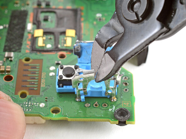

    • Use flush cutters to cut the top corners of the joystick frame.
    • Be very careful not to cut yourself on the sharp edges. Bend any sharp edges down with pliers.
  41. DualSense Controller v2 Joystick Replacement: crwdns2935265:042crwdnd2935265:01crwdnd2935265:01crwdne2935265:0

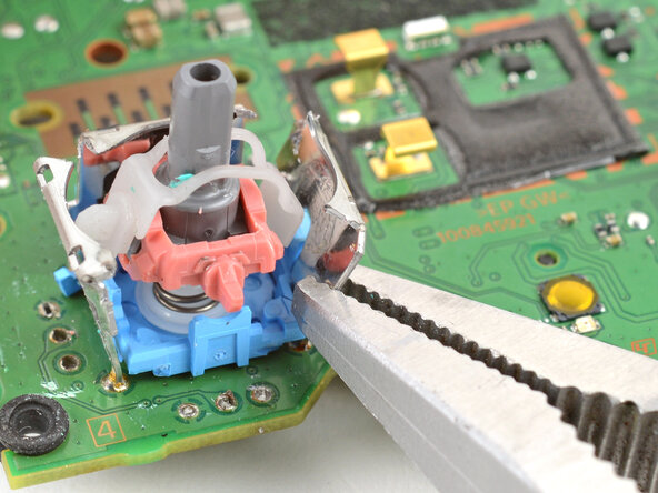

    • Use pliers to bend the metal frame outwards from the module.
  42. DualSense Controller v2 Joystick Replacement: crwdns2935265:043crwdnd2935265:01crwdnd2935265:02crwdne2935265:0 DualSense Controller v2 Joystick Replacement: crwdns2935265:043crwdnd2935265:02crwdnd2935265:02crwdne2935265:0
    • Remove the plastic components from the center of the joystick module.
    • Remove any loose pieces from the joystick module.
  43. DualSense Controller v2 Joystick Replacement: crwdns2935265:044crwdnd2935265:01crwdnd2935265:02crwdne2935265:0 DualSense Controller v2 Joystick Replacement: crwdns2935265:044crwdnd2935265:02crwdnd2935265:02crwdne2935265:0
    • Use flush cutters to cut apart the top sections of the remaining frame walls, separating each wall into two pieces.

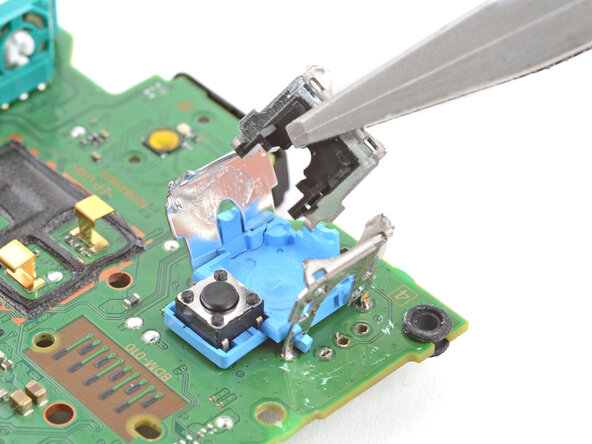

  44. DualSense Controller v2 Joystick Replacement, Desolder the cut pins: crwdns2935265:045crwdnd2935265:01crwdnd2935265:03crwdne2935265:0 DualSense Controller v2 Joystick Replacement, Desolder the cut pins: crwdns2935265:045crwdnd2935265:02crwdnd2935265:03crwdne2935265:0 DualSense Controller v2 Joystick Replacement, Desolder the cut pins: crwdns2935265:045crwdnd2935265:03crwdnd2935265:03crwdne2935265:0
    • Secure the motherboard so that the solder joints face upward.
    • Use the soldering iron to heat a solder joint securing one of the frame anchors.
    • Once the solder is molten, use pliers to grab and pull the frame anchor out of its through-hole.
    • Repeat the procedure to remove all four anchor joints.
  45. DualSense Controller v2 Joystick Replacement, Remove the push-button: crwdns2935265:046crwdnd2935265:01crwdnd2935265:03crwdne2935265:0 DualSense Controller v2 Joystick Replacement, Remove the push-button: crwdns2935265:046crwdnd2935265:02crwdnd2935265:03crwdne2935265:0 DualSense Controller v2 Joystick Replacement, Remove the push-button: crwdns2935265:046crwdnd2935265:03crwdnd2935265:03crwdne2935265:0
    • Slide the flat end of a spudger under the joystick module's plastic base.
    • Slowly pry up the base to bend and break it away from the motherboard.
    • Remove the plastic base.
  46. DualSense Controller v2 Joystick Replacement: crwdns2935265:047crwdnd2935265:01crwdnd2935265:02crwdne2935265:0 DualSense Controller v2 Joystick Replacement: crwdns2935265:047crwdnd2935265:02crwdnd2935265:02crwdne2935265:0

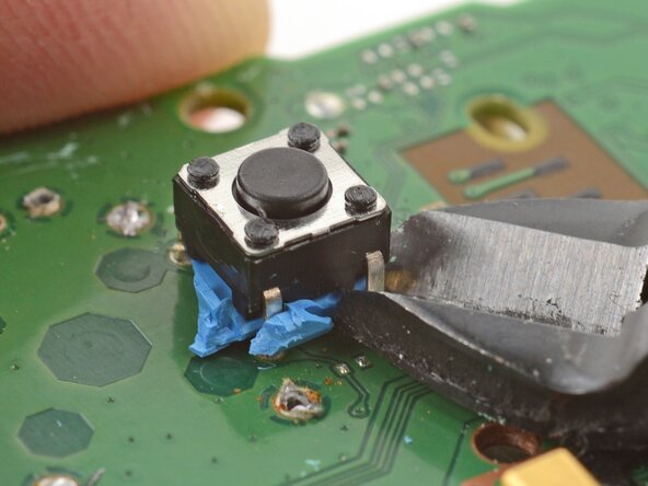

    • Use flush cutters and pliers to break and remove the plastic base remnants from the push-button.
    • Use flush cutters to cut the four push-button pins securing it to the motherboard.
  47. DualSense Controller v2 Joystick Replacement: crwdns2935265:048crwdnd2935265:01crwdnd2935265:02crwdne2935265:0 DualSense Controller v2 Joystick Replacement: crwdns2935265:048crwdnd2935265:02crwdnd2935265:02crwdne2935265:0
    • Remove the push-button.
    • Remove any plastic base remnants.

    • Use the soldering iron to heat a solder joint securing one of the push-button pins.
    • Once the solder is molten, use tweezers to grab the pin and pull it out of its through-hole.
    • Repeat the procedure to remove all four push-button pins.
  49. DualSense Controller v2 Joystick Replacement, Clean up the through-holes: crwdns2935265:050crwdnd2935265:01crwdnd2935265:02crwdne2935265:0 DualSense Controller v2 Joystick Replacement, Clean up the through-holes: crwdns2935265:050crwdnd2935265:02crwdnd2935265:02crwdne2935265:0
    • Secure the motherboard so you can access both sides of it.
    • Use the soldering iron to heat one side of a through-hole.
    • Use a desoldering pump on the opposite side of the through-hole to suck up any remaining solder.
    • Don't heat the through-hole continuously for longer than 15 seconds at a time to avoid damaging the pad.
    • If needed, use solder wick to remove any residual solder.
    • Repeat this for all through-holes and both sides of the motherboard.
  50. DualSense Controller v2 Joystick Replacement: crwdns2935265:051crwdnd2935265:01crwdnd2935265:01crwdne2935265:0
    • Visually inspect each through-hole and make sure they're not blocked by residual solder. If some holes look blocked, repeat the previous step to clear the blockage.
  51. DualSense Controller v2 Joystick Replacement, Clean the surface of the motherboard: crwdns2935265:052crwdnd2935265:01crwdnd2935265:02crwdne2935265:0 DualSense Controller v2 Joystick Replacement, Clean the surface of the motherboard: crwdns2935265:052crwdnd2935265:02crwdnd2935265:02crwdne2935265:0
    • Apply a few drops of high concentration (>90%) isopropyl alcohol to the top side of the motherboard, where the new joystick module will sit.
    • Use a cotton swab or a soft brush and cloth to wipe away the flux residue.
  52. DualSense Controller v2 Joystick Replacement, Solder the replacement joystick: crwdns2935265:053crwdnd2935265:01crwdnd2935265:02crwdne2935265:0 DualSense Controller v2 Joystick Replacement, Solder the replacement joystick: crwdns2935265:053crwdnd2935265:02crwdnd2935265:02crwdne2935265:0
    • Place the replacement joystick module onto the motherboard so that all the pins thread through the through-holes.
    • Gently press the joystick onto the board so that the joystick sits flush with the board surface.

    • Apply flux to one of the frame anchors to prep it for soldering.
    • For full instructions on how to solder through-hole solder joints, follow this guide.
    • Solder one of the frame anchors to the motherboard.

    • Check that the joystick module is still sitting flush on top of the motherboard (as shown). If it isn't, reheat the soldered pin and reposition the module.

    • Solder the remaining joystick module pins (14 total) to the motherboard. Apply flux as you solder to help create good bonds.
  56. DualSense Controller v2 Joystick Replacement, Clean and inspect your work: crwdns2935265:058crwdnd2935265:01crwdnd2935265:02crwdne2935265:0 DualSense Controller v2 Joystick Replacement, Clean and inspect your work: crwdns2935265:058crwdnd2935265:02crwdnd2935265:02crwdne2935265:0
    • Apply a few drops of high concentration (>90%) isopropyl alcohol to the motherboard wherever you can see flux residue.
    • Visually inspect your work:
    • Make sure each solder joint looks well-formed.
    • Make sure no solder joints are shorting each other.
