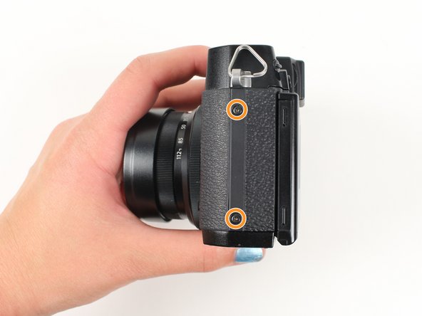

  4. Disassembling Fujifilm X30 Camera, Motherboard: crwdns2935265:04crwdnd2935265:01crwdnd2935265:03crwdne2935265:0 Disassembling Fujifilm X30 Camera, Motherboard: crwdns2935265:04crwdnd2935265:02crwdnd2935265:03crwdne2935265:0 Disassembling Fujifilm X30 Camera, Motherboard: crwdns2935265:04crwdnd2935265:03crwdnd2935265:03crwdne2935265:0

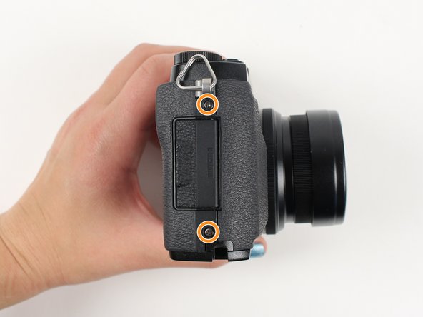

    • Begin by removing the outside screws using a Phillips #000 Screwdriver:
    • Remove the three 3.6 mm silver screws located on the bottom of the camera.
    • Remove all four of the 4.7 mm screws from the sides of the camera.

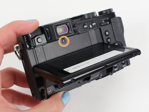

    • Remove all screws below using a Phillips #000 Screwdriver:
    • Lift up the screen and remove the two 4.5 mm screws located in the bottom corners.
    • Remove the 4.0 mm screw that is located behind the screen and directly under the eye piece.

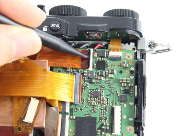

    • Do not pull hard when removing the backing because it could rip the orange strip attached to the motherboard.
    • Gently pull off the back of the camera from the left side so that it is partially open.
    • Use a spudger to lift up the tab holding the orange strip and slide the strip out to disconnect it
    • Refer to the next step to see pictures of how to properly use the spudger when removing a strip.

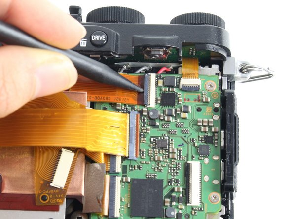

    • For all five indicated orange strips:
    • Use a spudger to lift up the tab holding the orange strip and slide the strip out to disconnect it.

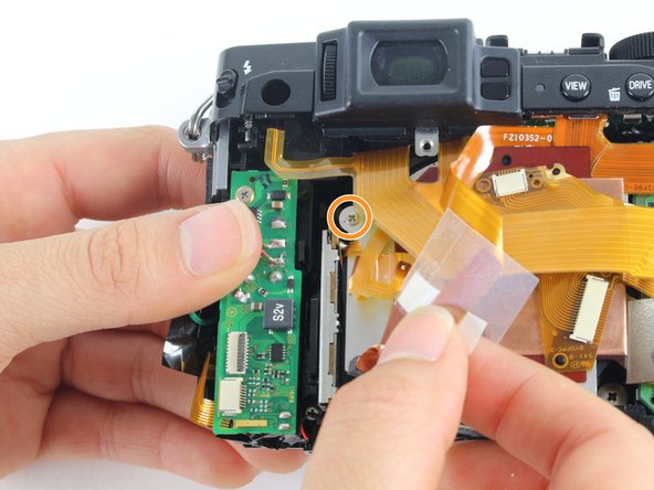

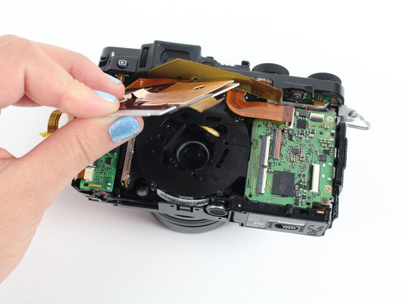

  11. Disassembling Fujifilm X30 Camera: crwdns2935265:011crwdnd2935265:01crwdnd2935265:03crwdne2935265:0 Disassembling Fujifilm X30 Camera: crwdns2935265:011crwdnd2935265:02crwdnd2935265:03crwdne2935265:0 Disassembling Fujifilm X30 Camera: crwdns2935265:011crwdnd2935265:03crwdnd2935265:03crwdne2935265:0
    • Remove all screws listed below using a Phillips #000 screwdriver:
    • Remove the two 3.4 mm screws at the bottom of the silver plate.
    • Hold back the clear strip to reveal a 2.8 mm screw on the left of the silver plate and remove it.
    • Peel back the copper plate.

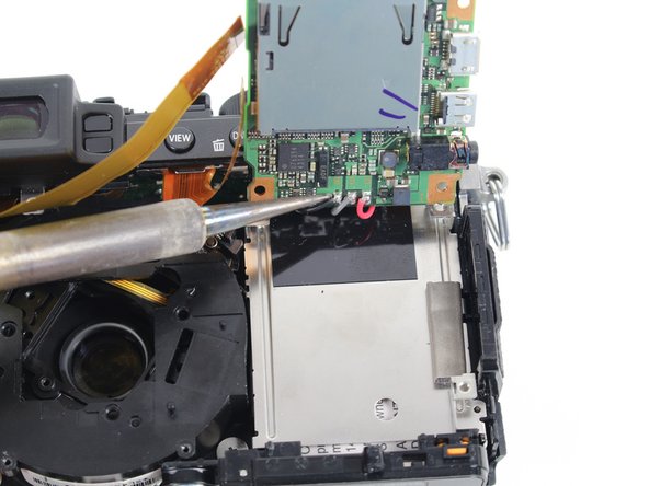

  13. Disassembling Fujifilm X30 Camera: crwdns2935265:013crwdnd2935265:01crwdnd2935265:02crwdne2935265:0 Disassembling Fujifilm X30 Camera: crwdns2935265:013crwdnd2935265:02crwdnd2935265:02crwdne2935265:0
    • Tilt up the motherboard to locate the black, grey, and red wires.
    • Desolder these wires in order to completely remove the motherboard.
    • You can learn about soldering techniques here.

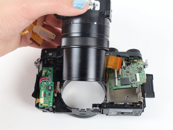

    • Remove the four 4.4 mm silver screws at the corners of the lens using a Phillips #000 screwdriver.
  15. Disassembling Fujifilm X30 Camera: crwdns2935265:015crwdnd2935265:01crwdnd2935265:02crwdne2935265:0 Disassembling Fujifilm X30 Camera: crwdns2935265:015crwdnd2935265:02crwdnd2935265:02crwdne2935265:0
    • Pull the lens toward the bottom of the camera so it can clear the silver tab.
    • Then push the lens with your index fingers from the front of the camera until it is removed.

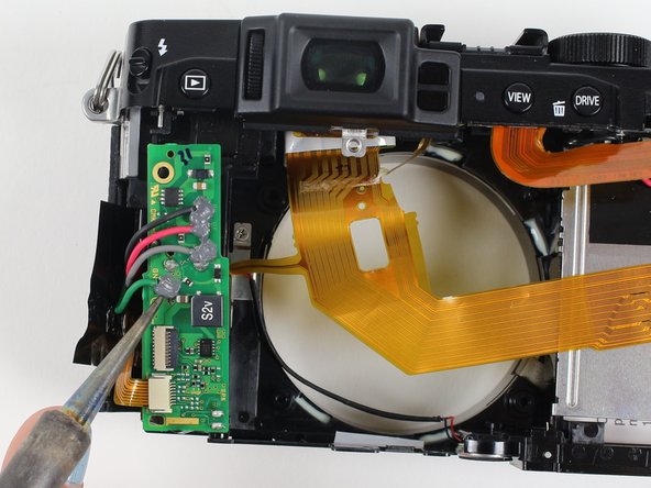

    • Do not touch the leads on the capacitor below the green circuitboard because they can shock you.
    • Remove the silver 3.4 mm screw from the top left corner of the capacitor circuitboard using a Phillips #000 screwdriver.
    • Desolder the red, black, grey, and green wires attached to the capacitor circuitboard so the circuitboard is disconnected and can be set aside.

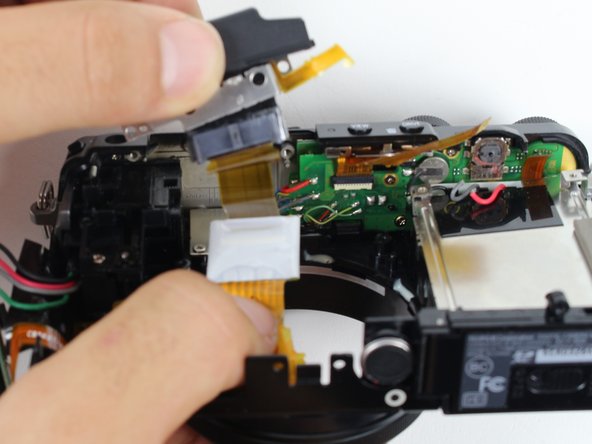

  17. Disassembling Fujifilm X30 Camera: crwdns2935265:017crwdnd2935265:01crwdnd2935265:02crwdne2935265:0 Disassembling Fujifilm X30 Camera: crwdns2935265:017crwdnd2935265:02crwdnd2935265:02crwdne2935265:0
    • Rotate the camera so you are looking at the bottom.
    • Remove the two silver 3.4 mm screws on the silver plate that are holding the eyepiece using a Phillips #000 screwdriver.
    • Lift the eyepiece out of the camera.

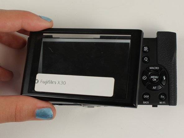

  18. Disassembling Fujifilm X30 Camera: crwdns2935265:018crwdnd2935265:01crwdnd2935265:02crwdne2935265:0 Disassembling Fujifilm X30 Camera: crwdns2935265:018crwdnd2935265:02crwdnd2935265:02crwdne2935265:0
    • To remove the LCD screen, look at the back of the tiltable screen plate.
    • Remove the two black 3.7 mm screws in the back corners of the screen plate using a Phillips #000 screwdriver.
    • Lay the back panel flat to lift off the clear casing that is over the LCD screen.
