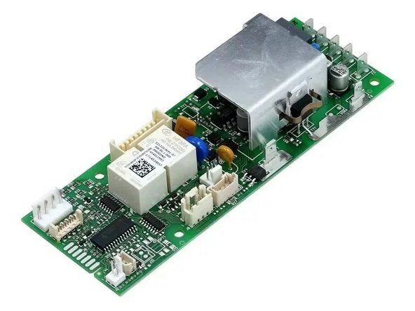

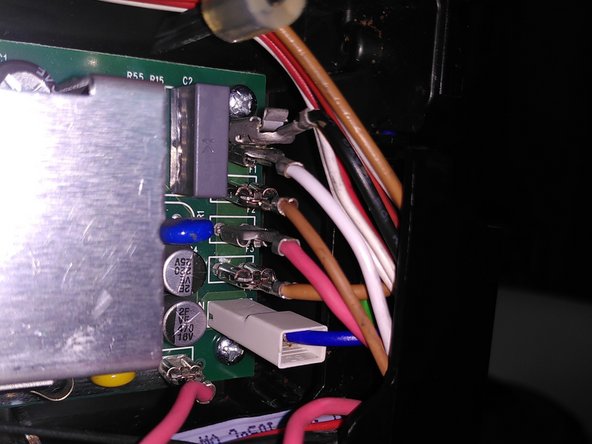

  4. Delonghi ECAM 23.120 Blinking Steam Button Issue, Remove the PCB from the casing: crwdns2935265:04crwdnd2935265:01crwdnd2935265:03crwdne2935265:0 Delonghi ECAM 23.120 Blinking Steam Button Issue, Remove the PCB from the casing: crwdns2935265:04crwdnd2935265:02crwdnd2935265:03crwdne2935265:0 Delonghi ECAM 23.120 Blinking Steam Button Issue, Remove the PCB from the casing: crwdns2935265:04crwdnd2935265:03crwdnd2935265:03crwdne2935265:0
    • Every element separately works, the issue is probably due to corrupt software
    • In order to reflash the software, first unmount the PCB from the machine
    • Follow step 1 to 6 from here: DeLonghi ECAM Series Leistungsplatine reparieren
    • If you need it, you can buy spare boards from the Internet, but then you will need to reflash the right firmware for your model

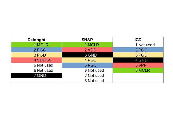

  5. Delonghi ECAM 23.120 Blinking Steam Button Issue, Spot debugger pads: crwdns2935265:05crwdnd2935265:01crwdnd2935265:01crwdne2935265:0
    • The main microcontroller is a PIC18LF2520
    • It can be programmed via the pads at the side of the board
    • Numbered from 1 to 7
    • (1) nMCLR, (2) PGC, (3) PGD, (4) VDD 5V, (7) VSS GND
  6. Delonghi ECAM 23.120 Blinking Steam Button Issue, Borrow or buy a programmer: crwdns2935265:06crwdnd2935265:01crwdnd2935265:01crwdne2935265:0
    • You need a programmer for Microchip PIC-8 series
    • Several models are available: PICKit, ICE, ICD, Snap
    • This tutorial will feature a borrowed ICD, but if you need to buy one the Snap is a cheaper option

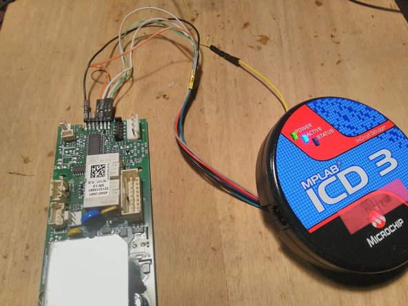

  7. Delonghi ECAM 23.120 Blinking Steam Button Issue, Connect board to programmer: crwdns2935265:07crwdnd2935265:01crwdnd2935265:03crwdne2935265:0 Delonghi ECAM 23.120 Blinking Steam Button Issue, Connect board to programmer: crwdns2935265:07crwdnd2935265:02crwdnd2935265:03crwdne2935265:0 Delonghi ECAM 23.120 Blinking Steam Button Issue, Connect board to programmer: crwdns2935265:07crwdnd2935265:03crwdnd2935265:03crwdne2935265:0
    • Solder a 7-pin 2.54mm header to the pads
    • Use jumper wires to connect to the programmer

  9. Delonghi ECAM 23.120 Blinking Steam Button Issue, Read and save the current firmware: crwdns2935265:010crwdnd2935265:01crwdnd2935265:01crwdne2935265:0
    • Create a new project with "New project -> Prebuilt Project"
    • Select the firmware hex file
    • Select the PIC18LF2520 in the 8-bit PIC section
    • Go to "Window -> Target Memory View -> Program Memory" and click the "Read Device Memory" button. Verify it reads some bytes.
    • In the top menu, find the "Read Device Memory" button, click its drop-down arrow and select "Read Device Memory To File"
  10. Delonghi ECAM 23.120 Blinking Steam Button Issue, Reprogram!: crwdns2935265:011crwdnd2935265:01crwdnd2935265:01crwdne2935265:0
    • Click "Program Device for Production main Project" to flash the new program

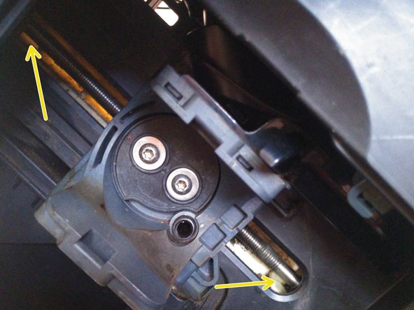

  12. Delonghi ECAM 23.120 Blinking Steam Button Issue, If noise, then lubricant: crwdns2935265:013crwdnd2935265:01crwdnd2935265:02crwdne2935265:0 Delonghi ECAM 23.120 Blinking Steam Button Issue, If noise, then lubricant: crwdns2935265:013crwdnd2935265:02crwdnd2935265:02crwdne2935265:0
    • This machine had a screetching noise coming from the worm screw
    • Open the cache, remove the coffee infuser
    • Carefully drop some lubricant on the worm screw, at its top and bottom
