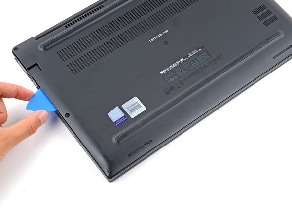

  4. Dell Latitude 7490 CMOS Battery Replacement, Insert an opening pick: crwdns2935265:04crwdnd2935265:01crwdnd2935265:03crwdne2935265:0 Dell Latitude 7490 CMOS Battery Replacement, Insert an opening pick: crwdns2935265:04crwdnd2935265:02crwdnd2935265:03crwdne2935265:0 Dell Latitude 7490 CMOS Battery Replacement, Insert an opening pick: crwdns2935265:04crwdnd2935265:03crwdnd2935265:03crwdne2935265:0
    • Plastic clips secure the back cover to the frame. You'll hear and feel them release as you work.
    • Insert the long side of an opening pick between the top right corner of the back cover and frame.
    • Pry the back cover up to release the clips securing the top right corner.

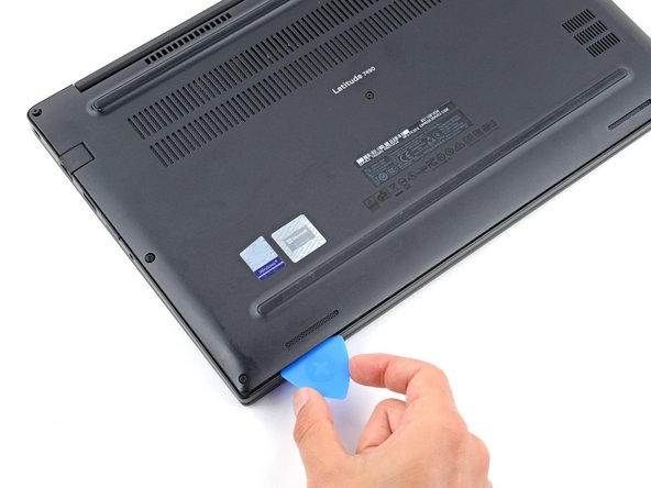

  5. Dell Latitude 7490 CMOS Battery Replacement, Release the clips: crwdns2935265:05crwdnd2935265:01crwdnd2935265:03crwdne2935265:0 Dell Latitude 7490 CMOS Battery Replacement, Release the clips: crwdns2935265:05crwdnd2935265:02crwdnd2935265:03crwdne2935265:0 Dell Latitude 7490 CMOS Battery Replacement, Release the clips: crwdns2935265:05crwdnd2935265:03crwdnd2935265:03crwdne2935265:0
    • Slide the opening pick down the right edge and around the bottom right corner to release the clips.
  6. Dell Latitude 7490 CMOS Battery Replacement: crwdns2935265:06crwdnd2935265:01crwdnd2935265:03crwdne2935265:0 Dell Latitude 7490 CMOS Battery Replacement: crwdns2935265:06crwdnd2935265:02crwdnd2935265:03crwdne2935265:0 Dell Latitude 7490 CMOS Battery Replacement: crwdns2935265:06crwdnd2935265:03crwdnd2935265:03crwdne2935265:0
    • Slide the opening pick along the front edge and up to the top left corner to release the remaining clips securing the back cover.

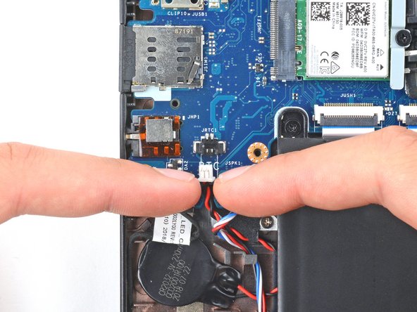

  9. Dell Latitude 7490 CMOS Battery Replacement, Disconnect the CMOS battery: crwdns2935265:09crwdnd2935265:01crwdnd2935265:03crwdne2935265:0 Dell Latitude 7490 CMOS Battery Replacement, Disconnect the CMOS battery: crwdns2935265:09crwdnd2935265:02crwdnd2935265:03crwdne2935265:0 Dell Latitude 7490 CMOS Battery Replacement, Disconnect the CMOS battery: crwdns2935265:09crwdnd2935265:03crwdnd2935265:03crwdne2935265:0
    • Use clean fingernails to pull the CMOS battery connector out of its socket on the motherboard's bottom left corner.
    • If your fingernails aren't long enough, use a spudger to push on alternating sides of the connector to "walk" it out of its socket.

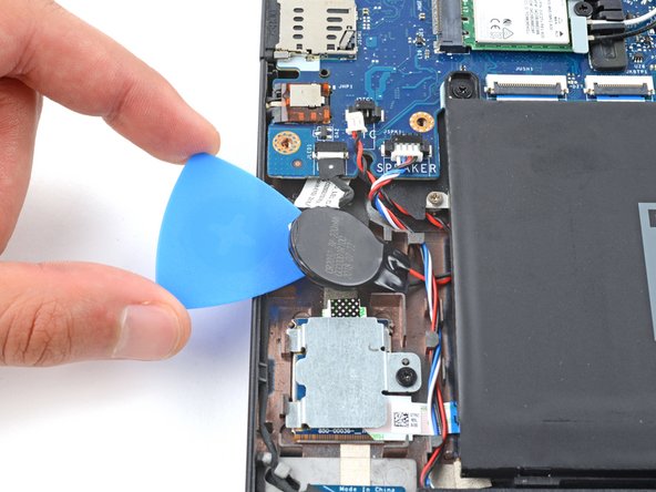

  10. Dell Latitude 7490 CMOS Battery Replacement, Pry up the CMOS battery: crwdns2935265:010crwdnd2935265:01crwdnd2935265:02crwdne2935265:0 Dell Latitude 7490 CMOS Battery Replacement, Pry up the CMOS battery: crwdns2935265:010crwdnd2935265:02crwdnd2935265:02crwdne2935265:0
    • Adhesive secures the CMOS battery to the frame.
    • Insert an opening pick between the left edge of the CMOS battery and the frame.
    • Use your pick to pry up the CMOS battery and separate the adhesive securing it.
    • If you're having trouble, heat an iOpener and apply it to the battery for two minutes. Alternatively, you can use a hair dryer to heat the battery.

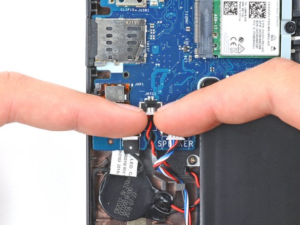

  11. Dell Latitude 7490 CMOS Battery Replacement, Remove the CMOS battery: crwdns2935265:011crwdnd2935265:01crwdnd2935265:03crwdne2935265:0 Dell Latitude 7490 CMOS Battery Replacement, Remove the CMOS battery: crwdns2935265:011crwdnd2935265:02crwdnd2935265:03crwdne2935265:0 Dell Latitude 7490 CMOS Battery Replacement, Remove the CMOS battery: crwdns2935265:011crwdnd2935265:03crwdnd2935265:03crwdne2935265:0
    Tesa 61395 Tape
    $5.99
    • Remove the CMOS battery, using your fingers to guide its wires out from under the speaker wires.
    • During reassembly:
    • Reconnect the CMOS battery.
    • Apply double-sided tape such as Tesa Tape to the battery and press it into place on the frame.
