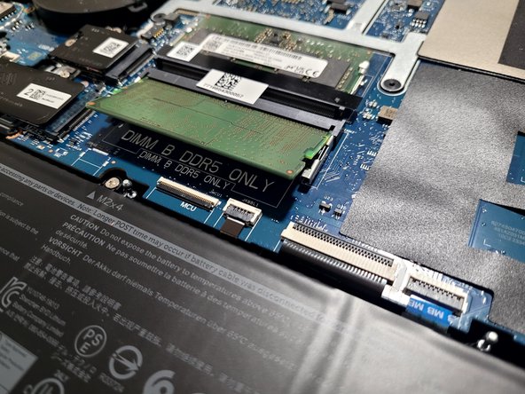

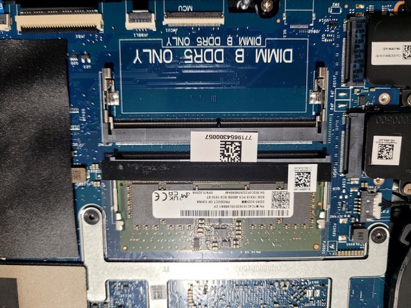

  3. Dell G15-5530 RAM Replacement: crwdns2935265:03crwdnd2935265:01crwdnd2935265:03crwdne2935265:0 Dell G15-5530 RAM Replacement: crwdns2935265:03crwdnd2935265:02crwdnd2935265:03crwdne2935265:0 Dell G15-5530 RAM Replacement: crwdns2935265:03crwdnd2935265:03crwdnd2935265:03crwdne2935265:0
    • Use your fingers to pull the metal arms (located on both sides of the RAM stick) away from it slightly to release the existing RAM module(s) and carefully remove them.
    • The RAM will pop up by a few millimeters.
    • Remove it at an angle and not straight up so you don't damage the socket.
    • Align the new RAM module with the slot, matching the notch on the module to the key in the slot. Firmly press down until the clips on both sides snap into place, securing the RAM.
    • Reassemble your device, and follow the above steps in reverse order.
