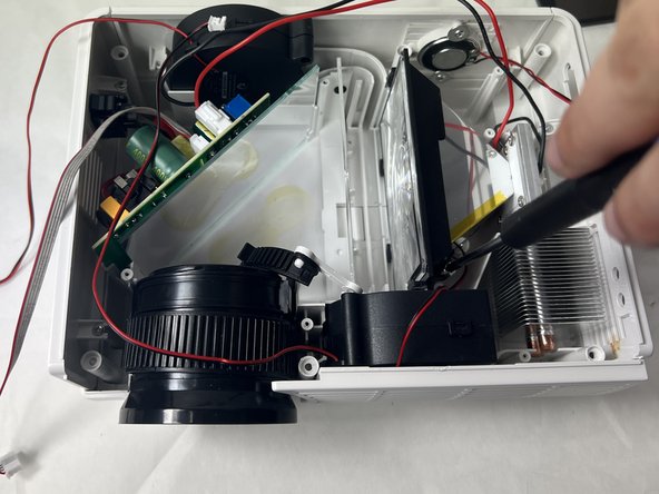

  11. DR.J Professional HI-04 Lamp Replacement: crwdns2935265:011crwdnd2935265:01crwdnd2935265:02crwdne2935265:0 DR.J Professional HI-04 Lamp Replacement: crwdns2935265:011crwdnd2935265:02crwdnd2935265:02crwdne2935265:0
    • Use a Phillips #0 screwdriver to remove five 10.0 mm screws.
  12. DR.J Professional HI-04 Lamp Replacement: crwdns2935265:012crwdnd2935265:01crwdnd2935265:03crwdne2935265:0 DR.J Professional HI-04 Lamp Replacement: crwdns2935265:012crwdnd2935265:02crwdnd2935265:03crwdne2935265:0 DR.J Professional HI-04 Lamp Replacement: crwdns2935265:012crwdnd2935265:03crwdnd2935265:03crwdne2935265:0

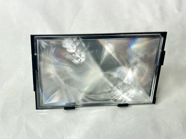

  13. DR.J Professional HI-04 Lamp Replacement: crwdns2935265:013crwdnd2935265:01crwdnd2935265:02crwdne2935265:0 DR.J Professional HI-04 Lamp Replacement: crwdns2935265:013crwdnd2935265:02crwdnd2935265:02crwdne2935265:0
    • Remove the glass object with the orange ribbon cable connector.
    • Be careful removing object as it is fragile and can easily break.
